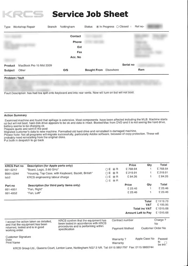

I have the job sheet with what it need etc..

what does the job sheet say? work out how much the parts will be, and take that plus a couple of hundred off so its worth someone repairing
You must have completely miss-understood the fact that the insurance deemed it to be an un-ethical repair !
Labour on the job sheet was a mere £80 IIRC.

post up the job sheet, as suggested, its akin to repairing a car. Many people will simply state replacing an entire panel instead of repairing it as they feel it is easier labor wise, people like making things easier for themselves in all job genres, computer tech is no different.
As stated, post up the job sheet and that will be a big indicator. I would presume they are replacing the entire mother board and some of its peripherals due to liquid damage.

Jobsheet as requested.
The question is, what would YOU do ? In my situation.
You have to remember that apple tax is added to all those parts. So to get them from elsewhere will probably come in cheaper than that. To be honest it looks like it should be repairable.

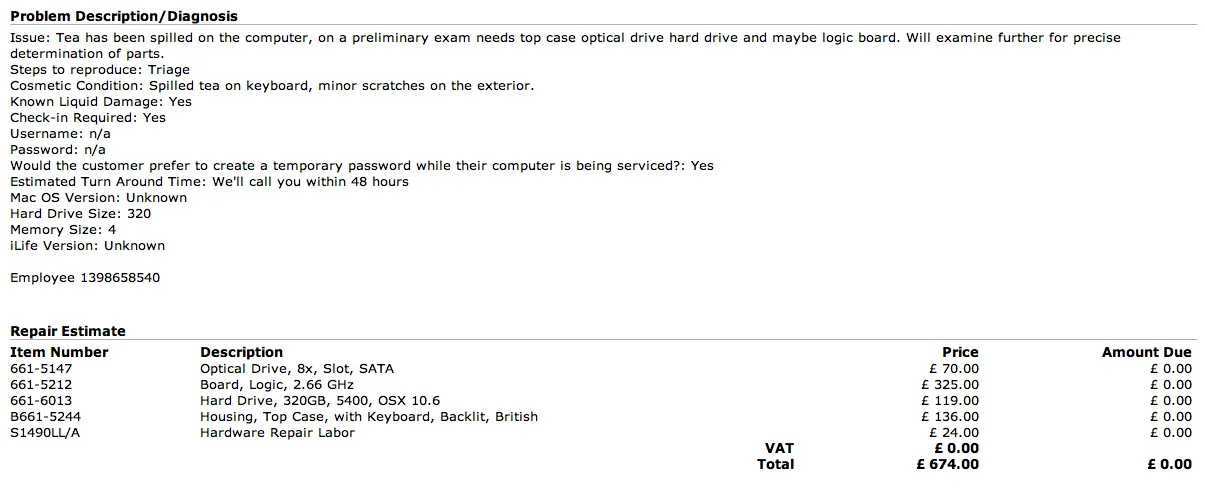

However I took it to the genius bar and tried to get them to repair it through Apple Care, as I've had friends do the same, although clearly their logic board wasn't fubared.
So here is the bill from Apple, they said they would subsidise the labour ONLY. Have part prices gone down in one year ? Or is this bill pre-"Apple Tax".

Well looking at the two quotes. Apple is £674 minus the £24 labour so £650.
Is that really that bad for a practically brand new 2.66 15inch MBP.
Can I minus the £119 for a HD as the first job sheet says I don't need one.
So potentially £530 ?

They normally replace everything the liquid touches. Regardless of it still working. So you don't have more troubles with it.
From that list and the previous diagnosis, they managed to get the computer to boot using the disc drive but couldn't get the computer to recognise the HDD but they managed to copy data from the HDD and they said it appeared to be fine. Which would mean that the keyboard does work still, the optical drive works, the HDD works, so all you would really need is the logic board replacing to have a functioning macbook.
Keyboard is f**ked. Every key you press stays stuck in, lol. Was a FULL cup of tea with 2 and half sugars. It's sure sticky. Although I agree with HDD.
Well then that's just the sugar sticking, surely (forgive me if I'm wrong as I've never tried it) remove the keyboard section, bathe in alcohol (don't mean beer or wine!), leave to dry completely, see if keys are unstuck, repeat process if not completely unstuck.
