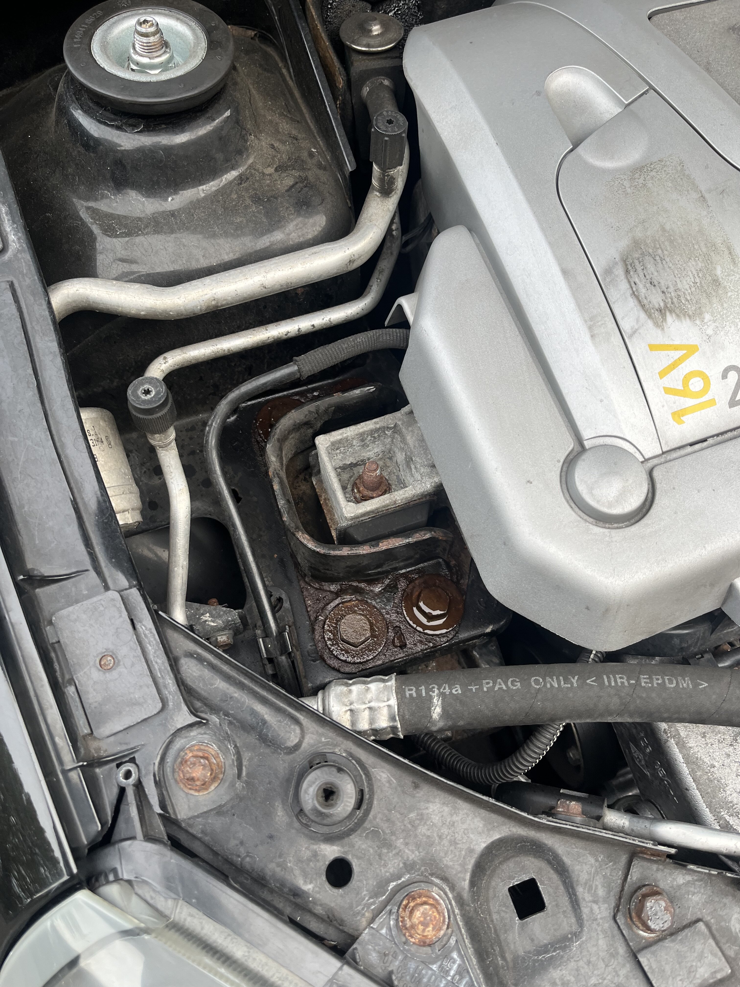

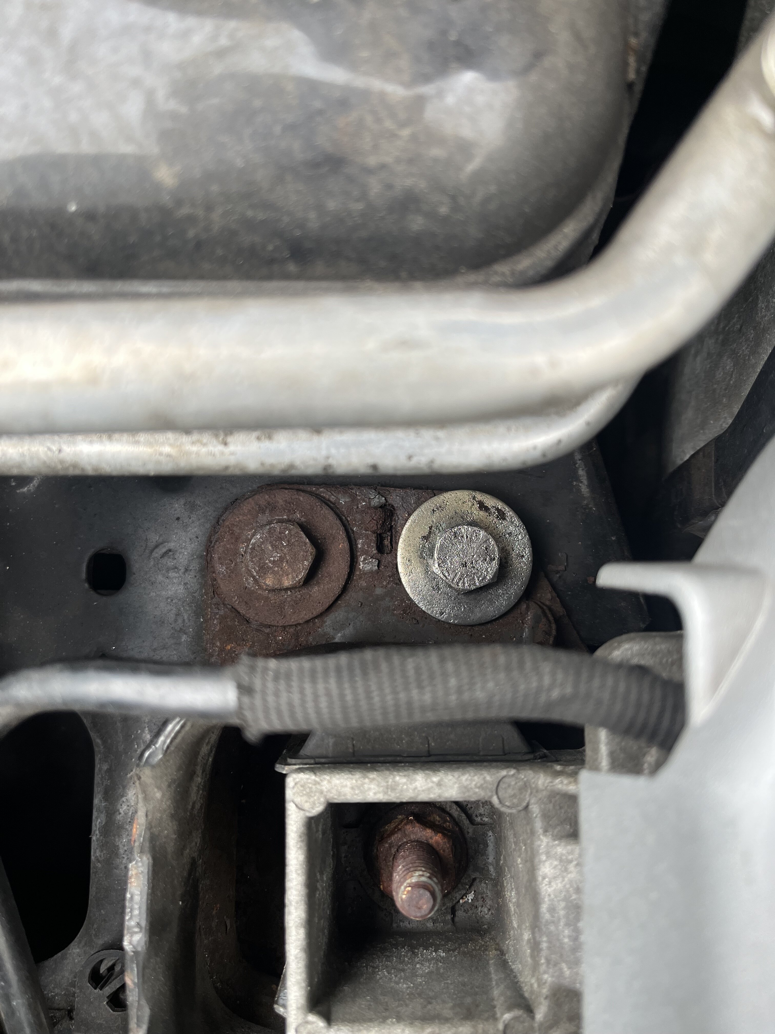

Looking to replace/refresh the 4 bolts that hold the engine mount to chassis.
Thought about soaking but don't fancy leaving the engine up too long.
Anyone know a good replacement bolt or any such thing as a fast acting soak?
Cheers
They’re an M10 hex bolt - 45 mm in length. You’ll need a heavy duty washer mind, otherwise they’ll bend when you torque them down. Here’s the part number 7703019198 but NLA I’m afraid.
plees
  S/C Iceberg 172 Cup
Also a high tensile 10.9 bolt from memory so just bear that in mind if you go aftermarket replacement 👍🏻
Tin.tin
  Clio 182
Nice one , think I’ll message for one of those washers soon if they’re still going?
Tin.tin
  Clio 182
Cheers will try cleaning if no good I’ll start searching!
Tin.tin
  Clio 182
Take them out and stick them in a tub of citric acid mixed with water. Will be clean of rust in a day or so, paint and refit.
Maybe a bit daft but would I be correct in thinking I can take the 4 bolts out without engine falling ? With jack under of corse but don’t want to rely on jack for an extended period.
Brigsy
  T.Turbo
Absolutely fine removing the 4 bolts holding the mount to the inner wing without supporting the engine. Engine wont move anywhere aslong as its not driven.
Brigsy
  T.Turbo
Paint best mate, they will prob rust again with just oil as protection. Coat of zinc galv or whatever.
