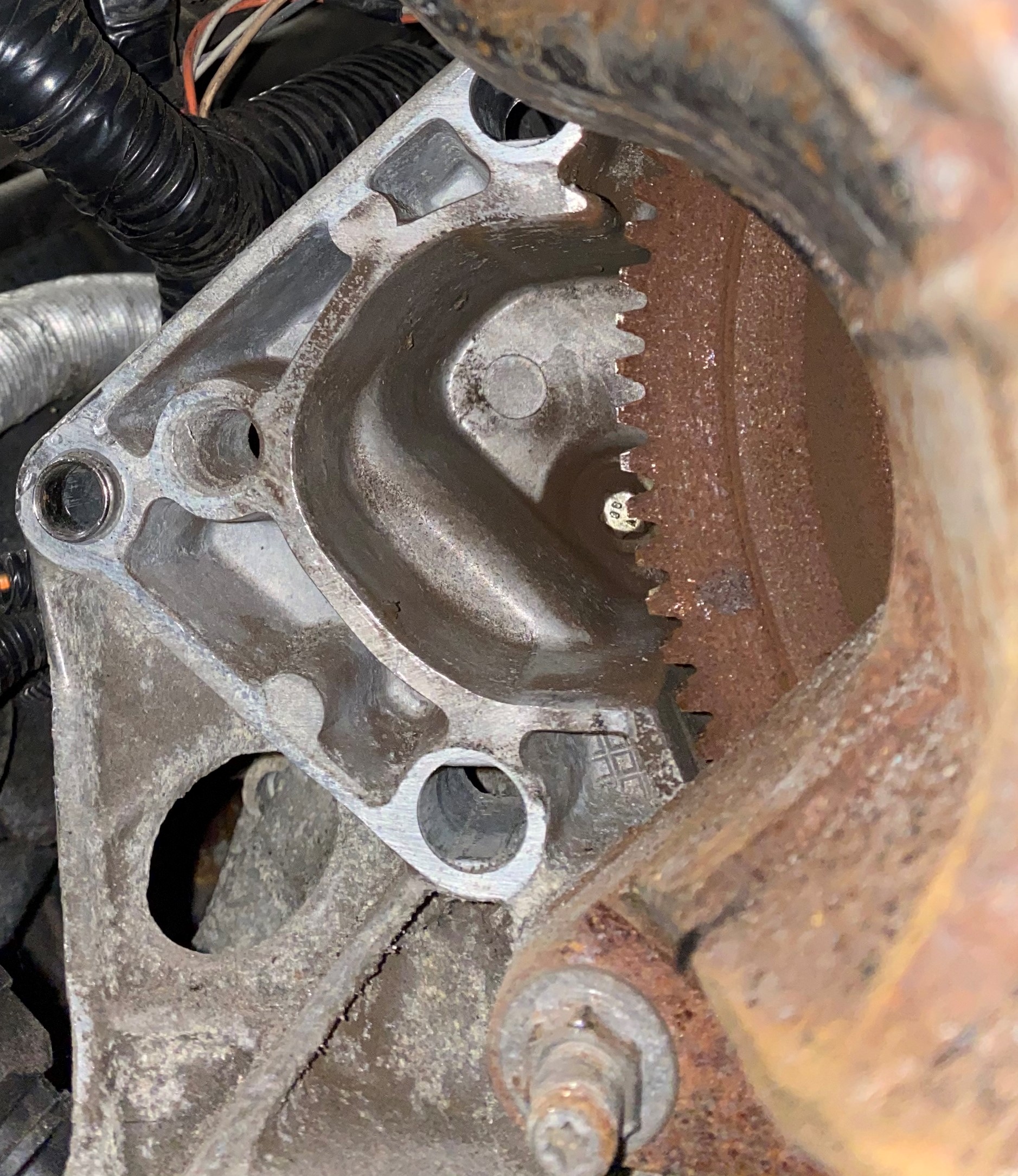

The flywheel does look do have some markings (behind all the rust) where potentially it might have tried to engage from the new one weirdly, hopefuly i can get it sorted!
