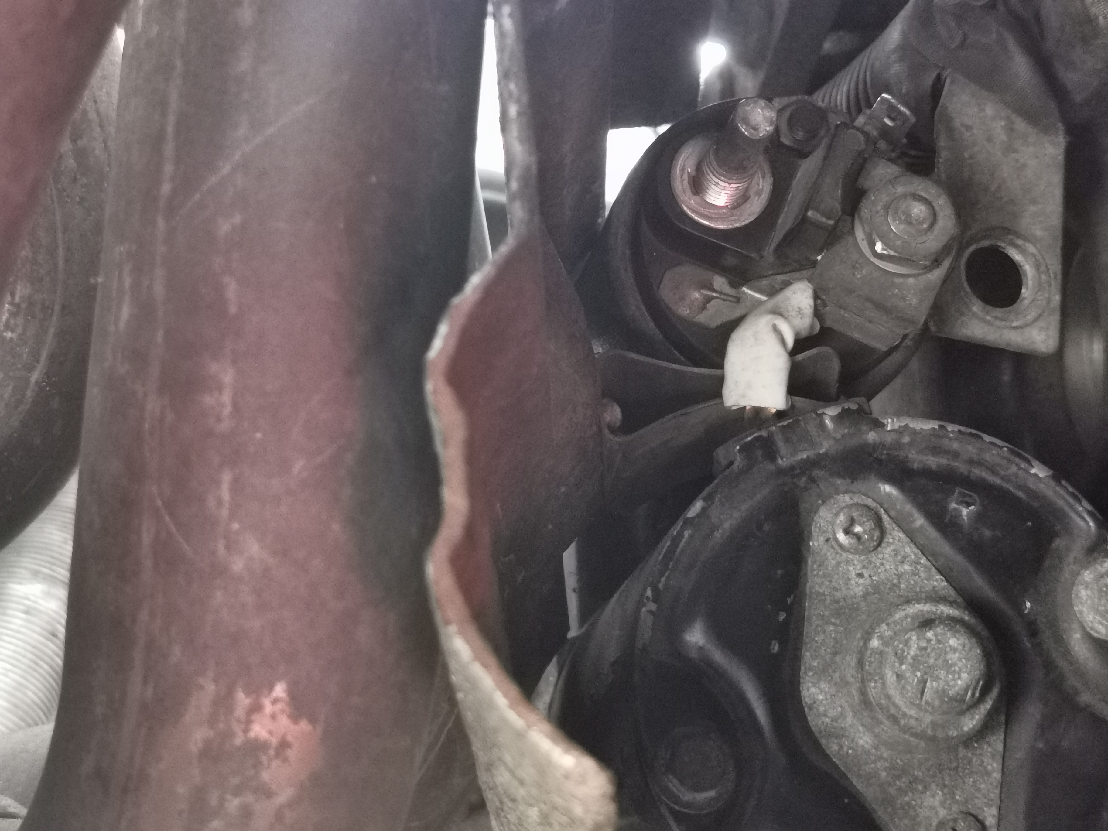

OssPoop
You shouldn't be able to see the starter from above because the heat shield should be covering it. This is it from the drivers wheel arch (arch liner removed) and on the left is the exhaust manifold and the wiggly bit is the heat shield that is clipped between the starter motor and the solenoid.
  R5gtt, 182, volvo...
16 years old, 93,000 miles subjected to a short work commute for many years and on its original starter motor..
it’s defiantly all about the heat shield and keeping the starter & wiring covered.. I’ve had friends with failed starters and got start issues due to wiring damage from heat.
the Renault 5 gtt’s have the same problem, people ripping through starter motors and no one’s got heat shield on. I’ve actually fitted a clio 182 starter heatshield on my Renault 5gtt as it’s more modern and fitted nice and tight.
