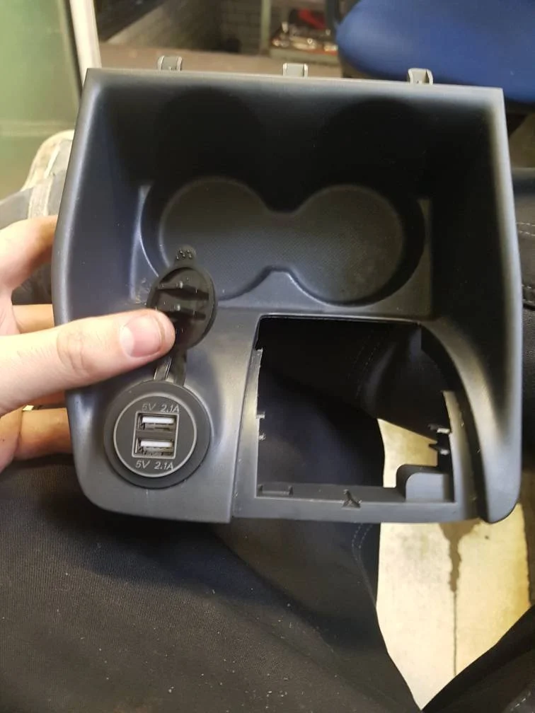

Bought everything that I need and think I know what needs connecting to what other than the blue wire - do I just tape that up out of the way or does it need connecting to something?
Blue wire for illuminating the cigarette lighter? If so I'd just tape it up, been a while since I had a centre console in mine though
I just got this from Amazon https://www.amazon.co.uk/gp/product/B01C4IFSZM/?tag=cliospnet01-21

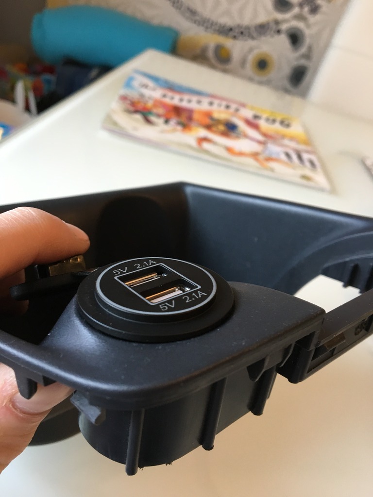

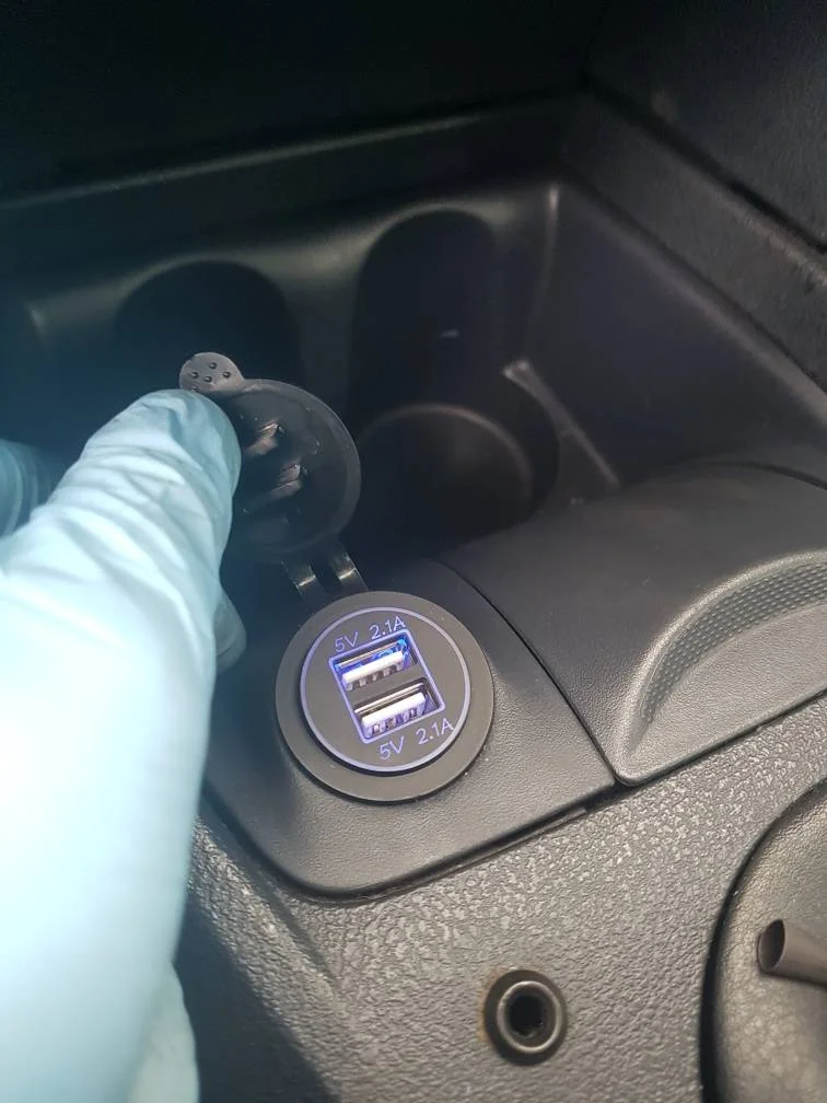

Hopefully that link works. I'm on my phone so if it doesn't I'll correct it tomorrow at work. I had to file the hole down a bit after I took the cigarette lighter out but this let me get a really good tight fit.
I'm quite happy with the finish and it's working great. Also the rubber cover will stop it getting filled with dust and dirt etc when not being used.

I had to file down the hole that the cigarette lighter came out of to make the usb ports fit so if youve bought the same one you'll have to do the same.
Managed to get a really good tight fit so i didnt bother screwing the plastic ring on the underside after as it wasnt budging anyway

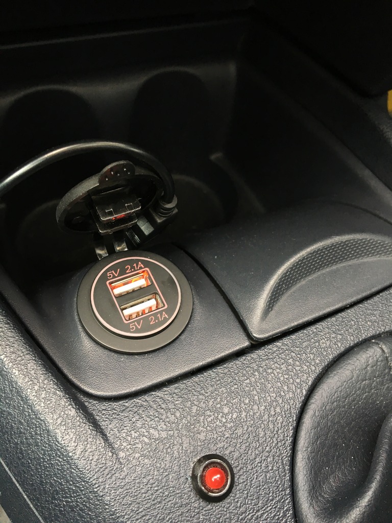

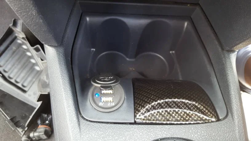

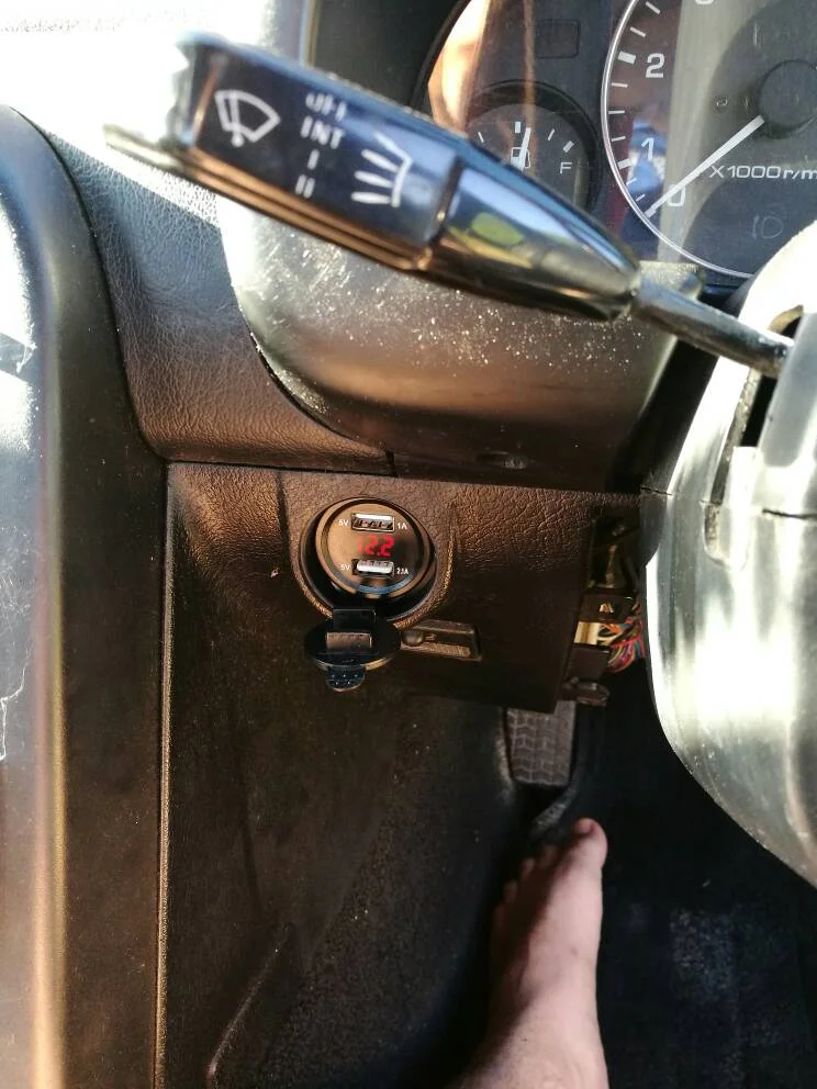

Here’s the red one installed. The brightness is hard to gauge during the daytime, but it looks like it won’t be super bright at night, which is ideal really.
I think it’s worth saying that they supply a screw-on collar to affix the whole unit, but the underside of the cup holder tray doesn’t allow room for it. Just go easy on the filing and it’ll be a tight fit so won’t need the collar anyway. Also, if you didn’t want the rubber cover, that’s easily removable too.

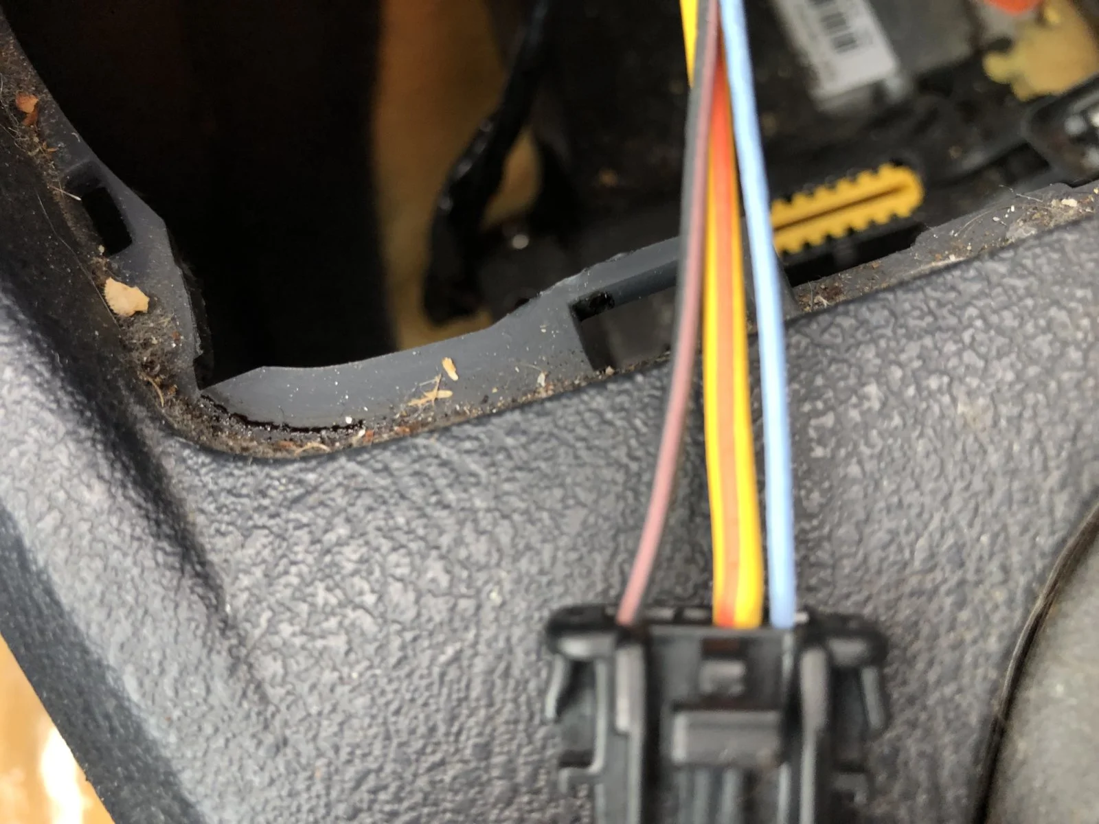

Sorry to open a new thread, just wanted some advice on wiring, original lighter wires look like this:
1430070
New usb has 2 terminals, positive and negative, so question is which wires go to which terminal?
Is this correct?
Positive to yellow/pink
Negative to black/pink
Tape blue up
Cheers!
Yes that sounds right. The blue one is for the cigarette lighter illumination.
