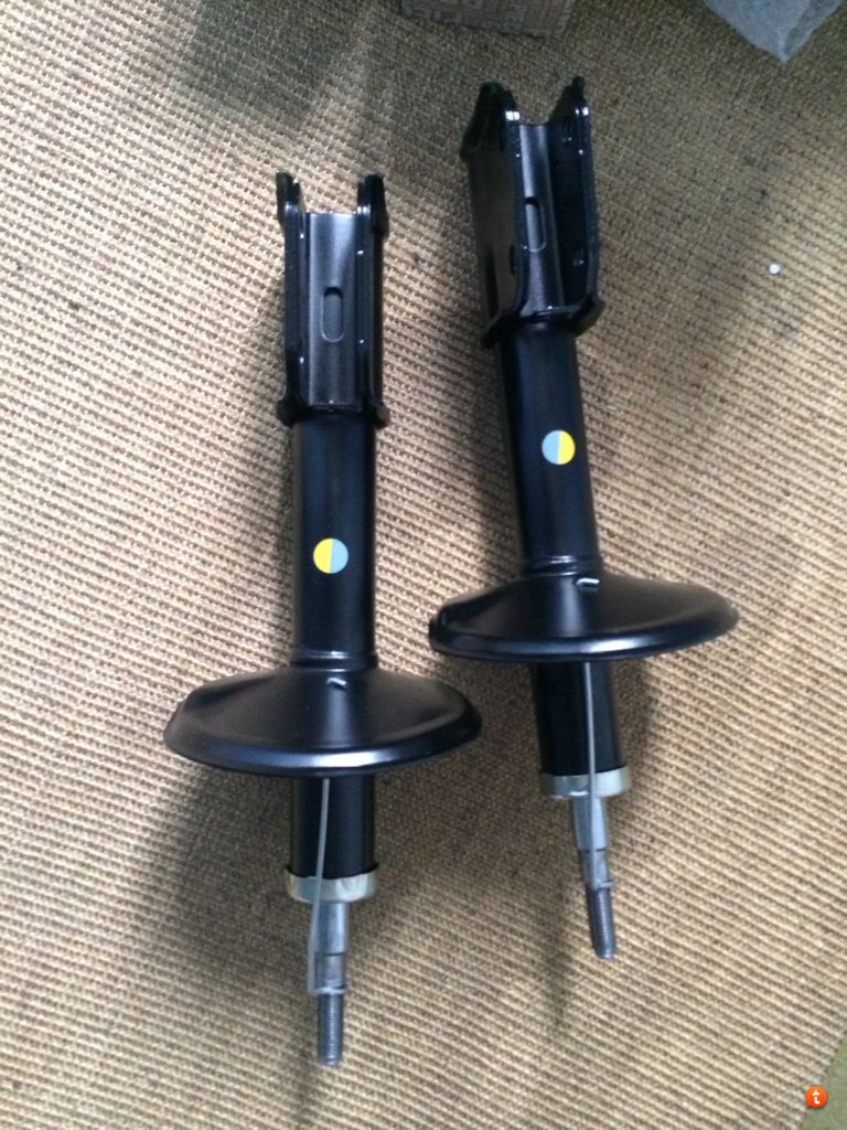

So today my parts arrived
However they look a little odd like there's something missing? Am I supposed to change over a bit from my old shocks to the new shocks?
Also, I have cooksports on the way due to a snapped spring, along with spring compressors. Do I fit the springs before I swap bits over, or after?
I presume I need to remove the bar that I believe is holding the shock down, is that going to cause it to pop up badly?
I've not replaced shocks and springs before so I'm a little lost lol :(
  182 Cup
So I had a search failure, couldn't find a guide but found it now. Still wouldn't mind some advice for a a relative noob though. Lol
  330i. E30 Touring.
Yep, you need to remove that bar. Won't jump up harshly, no.
No need for spring compressors, so can save yourself a few quid there.
Basically, once the shock and spring assy is off the car, undo the thin 17mm nut on top of the old shock, lift everything from the upper spring cap off the old shocks and springs, and swap onto the new shocks with the cooksports already in place.
Make sure you keep it all in the right order too.
