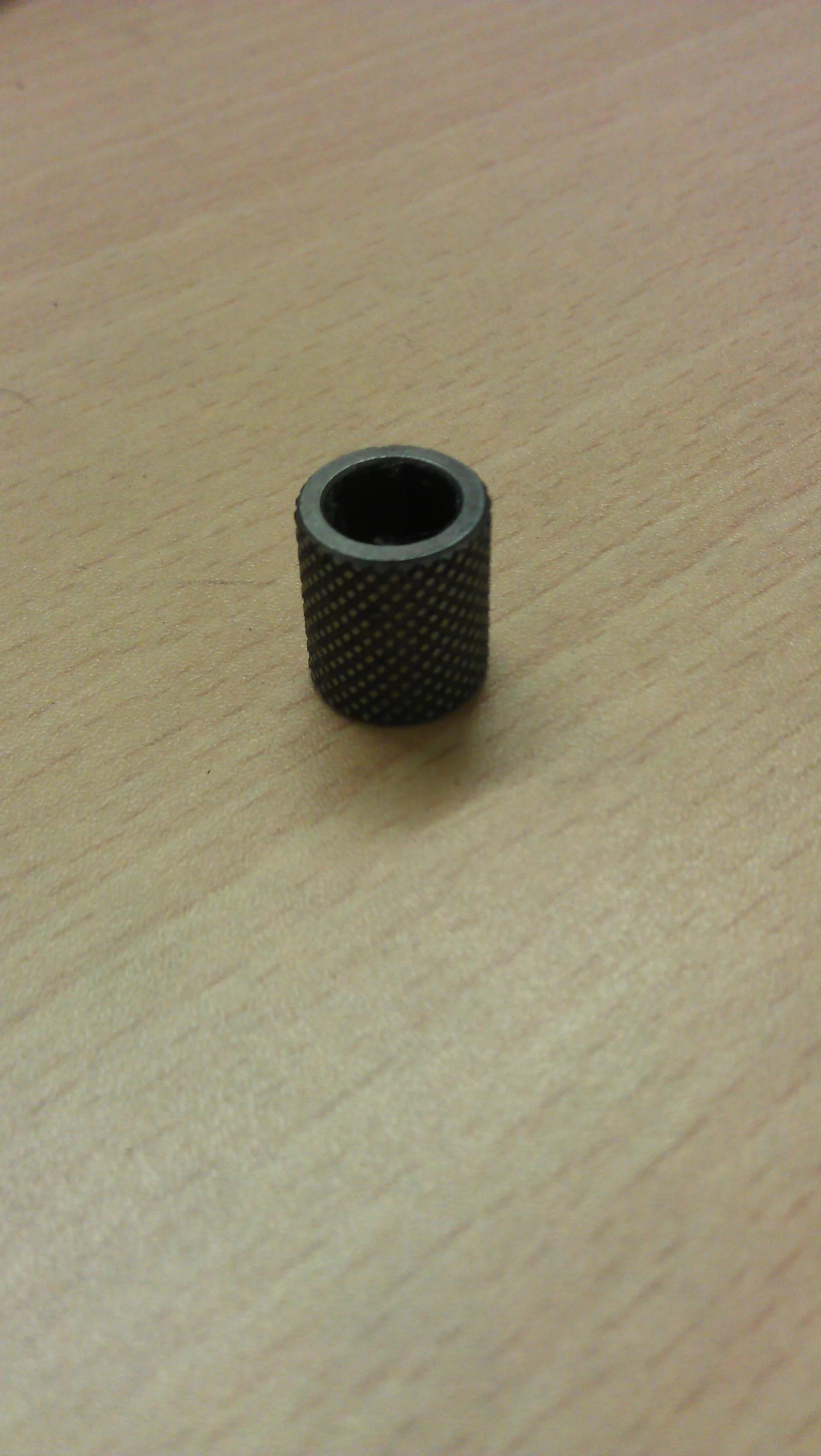

probably needs one of these (depends on year of car if it has this part)
Yanoo
  Clio Williams
This bush is often worn in a Clio gear linkage. Additionally this small part is combined with a rubber spacer. The snapped rubber spacer causes excessive play. A redesigned version of this bush is included in my gear linkage conversion kit.
