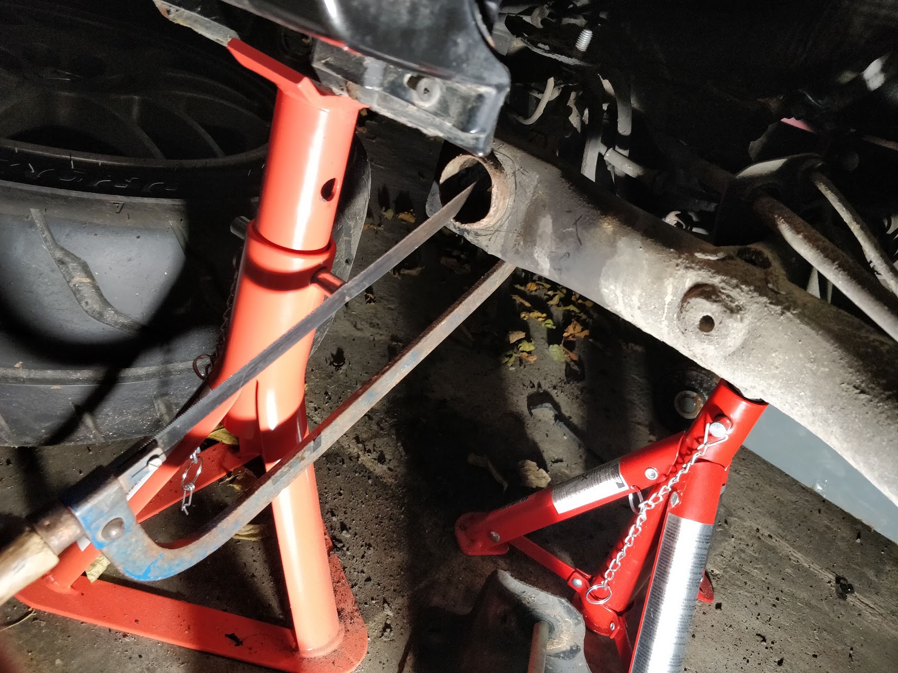

The trickiest bit is getting the old bushes out, drill them, then hacksaw the outer race to take some of the pressure off then knock them out, knock the new bushes in

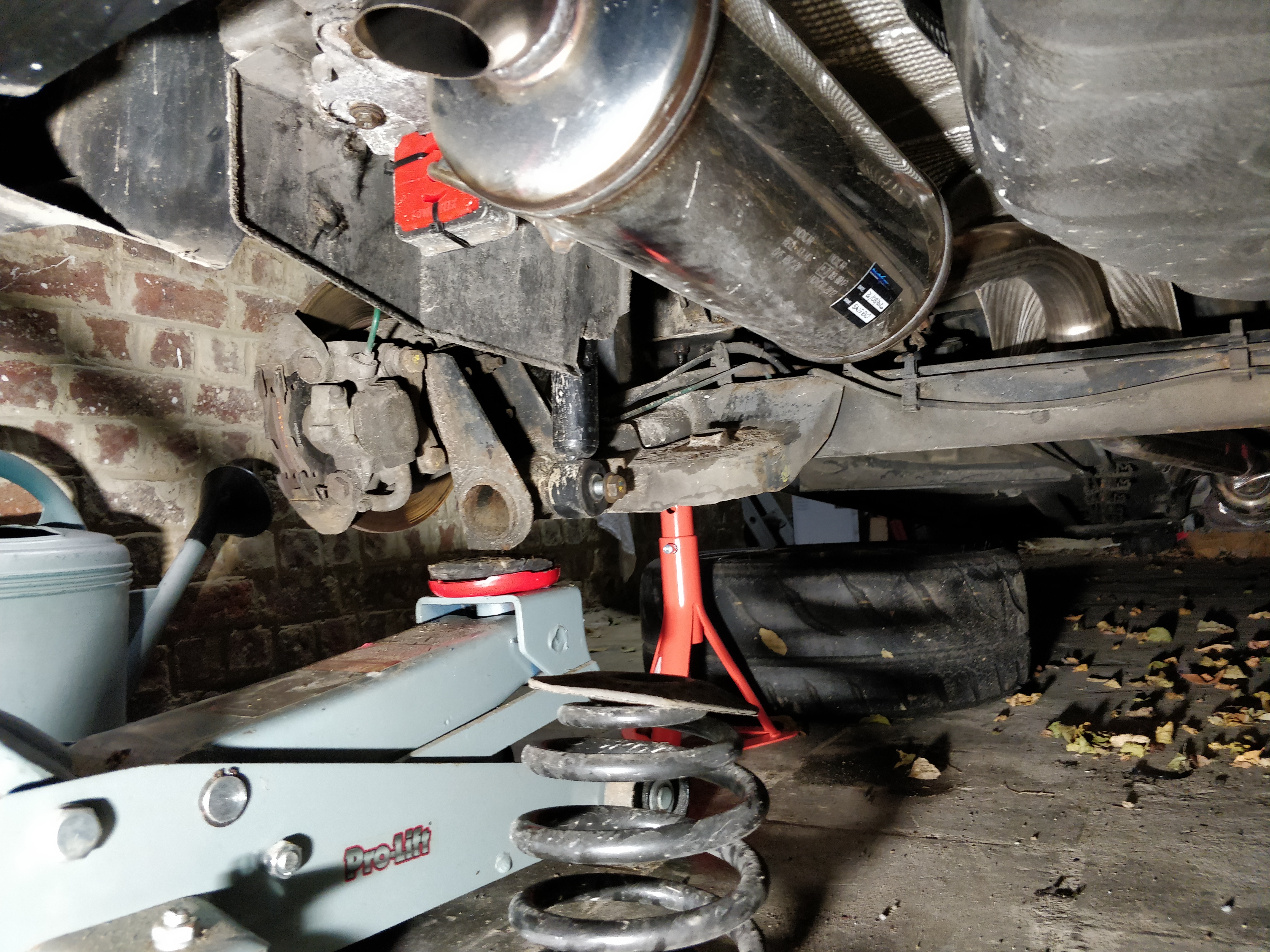

Finally had an hour to do some work. car on stands and springs are out. Shocks loosely attached again.

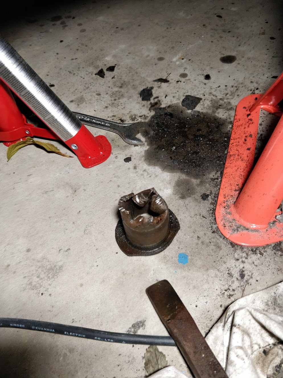

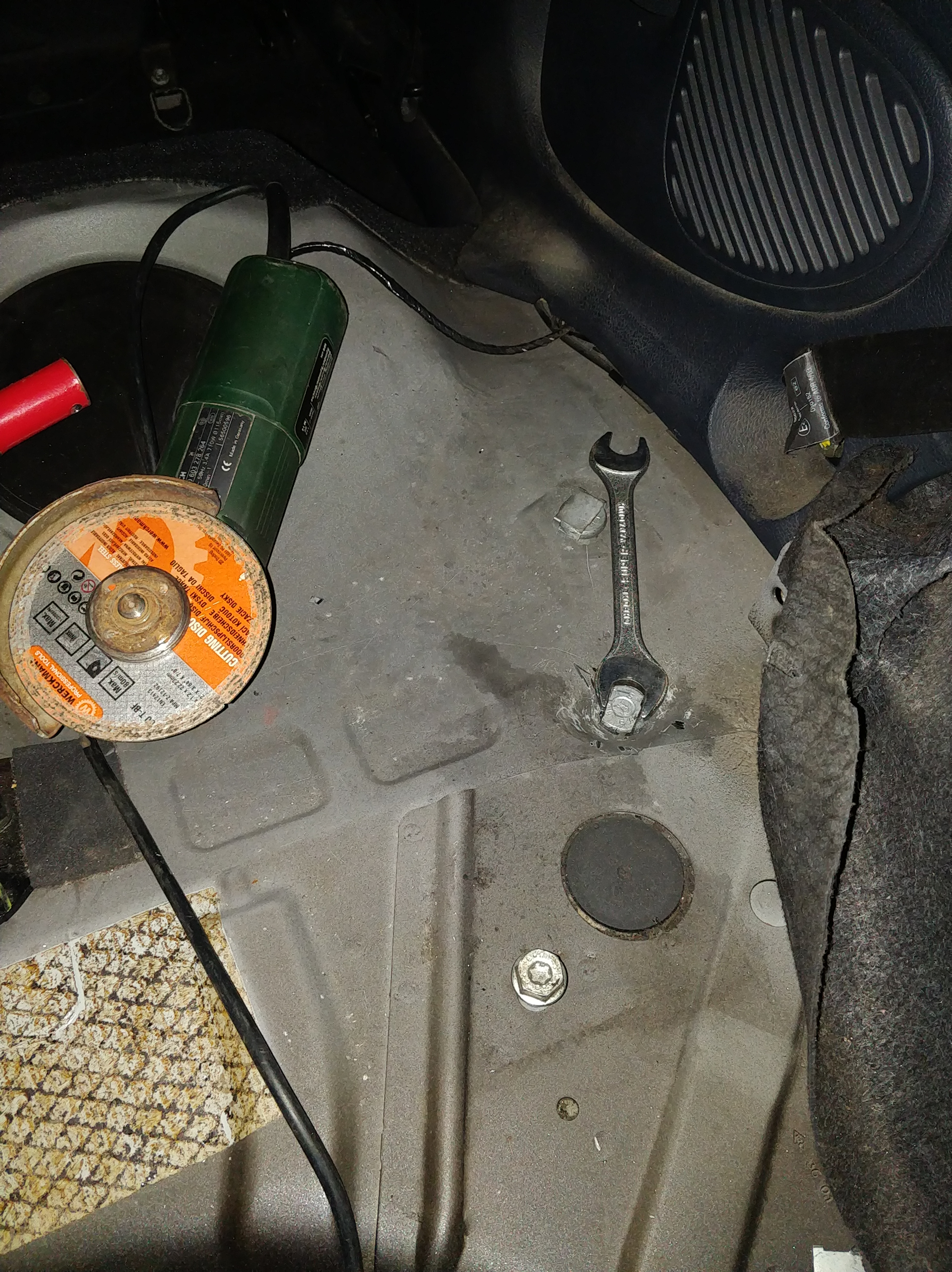

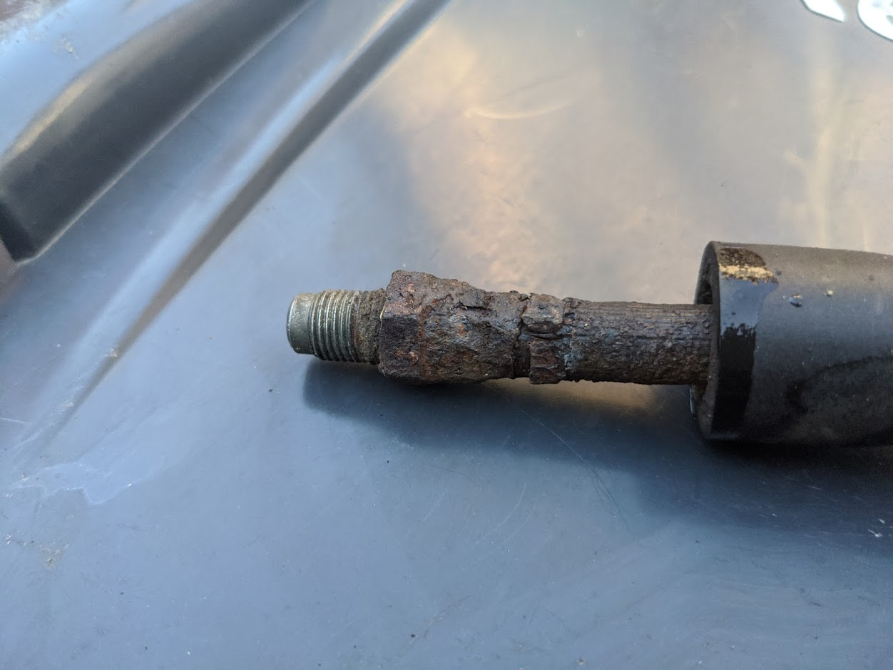

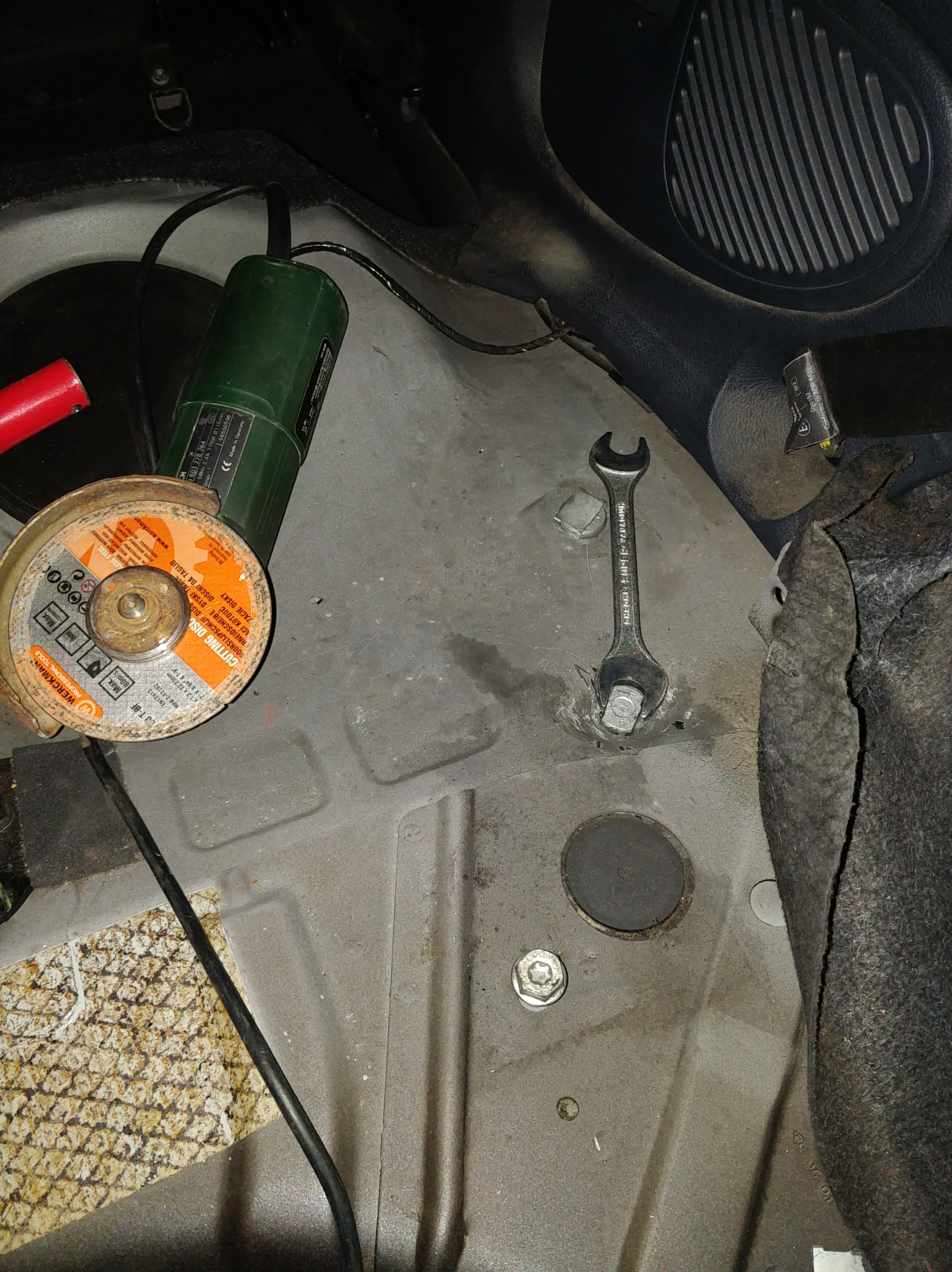

Beam mounts are lose! 5 of the 6 bolts went super smooth. Until the last one...
2hours and an angle grinder later it was out.

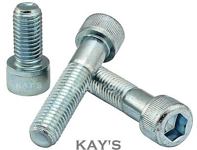

I used high tensile m10 capheads with a washer to spread the load and a washer and nyloc on the underside
120mm from memory
Unless you're a bolt pervert dont waste your money on genuine Renault bolts, I priced them and the nuts up at something like £65!
kayfast on ebay I got the capheads etc for circa £15
120mm from memory
Measure the length of one that you have removed, as Dom says they're 110-120mm M10 from memory.

You can lower the tank to get access to the bolt and leave beam brackets in place. I just undid the rear tank bolts and dropped the tank by an inch or so.

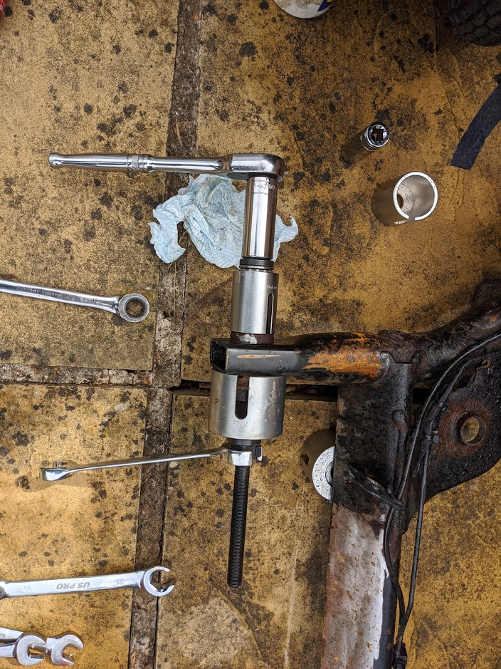

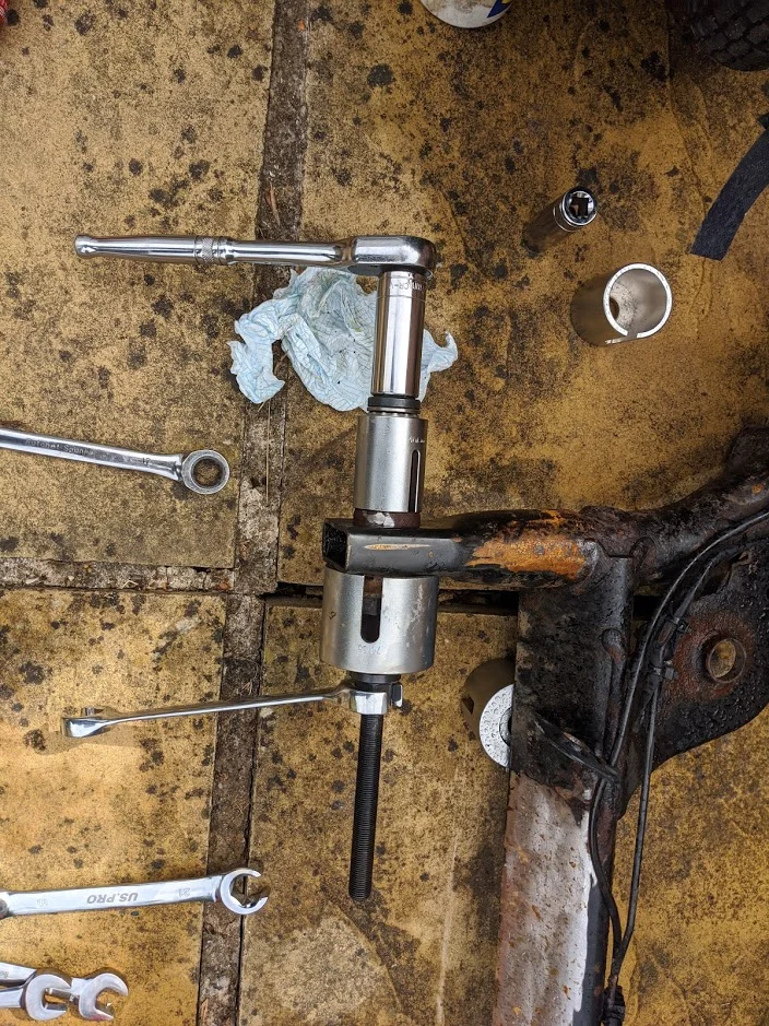

I would personally just have the beam out - if they are the OEM brake hoses and lines I would put money on them being basically done by now too. I used the threaded rod and cup puller set you get on eBay, it removed the bushes quickly (no cutting or burning required lol) and got the new ones in. With the beam out the car its a 20min job with the set.

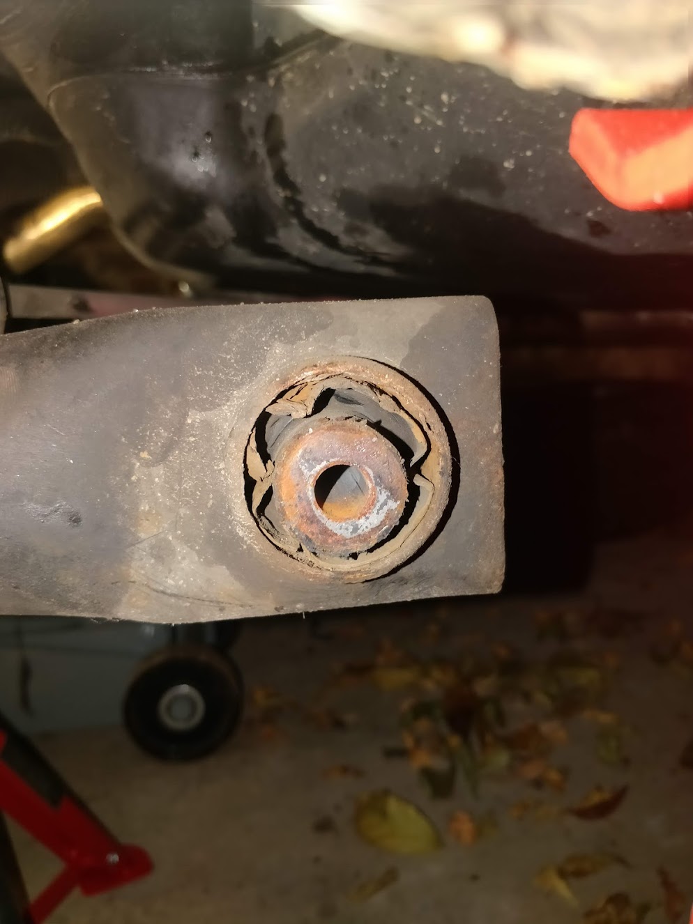

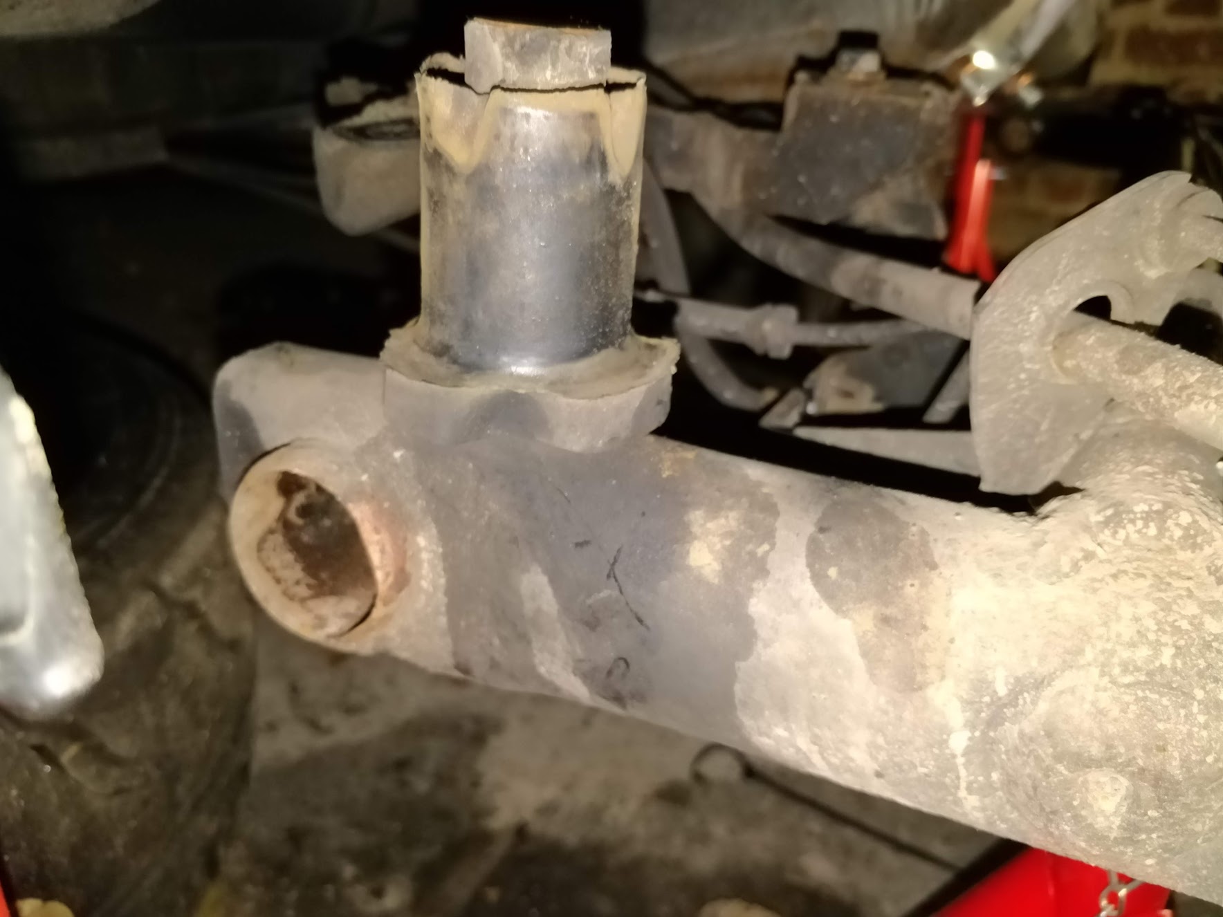

Getting the bushes out was easy enough with some taps with a hammer, no burning or cutting needed. i guess mine were done...
The sleeves on the other hand... get youself some proper tools if you want to takle this but doing with a hacksaw and a chisel also worked.

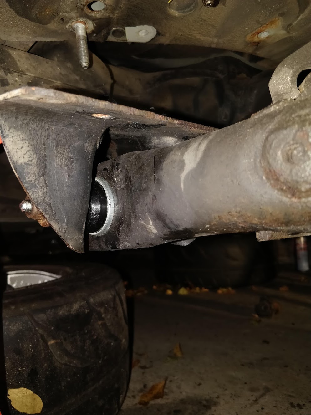

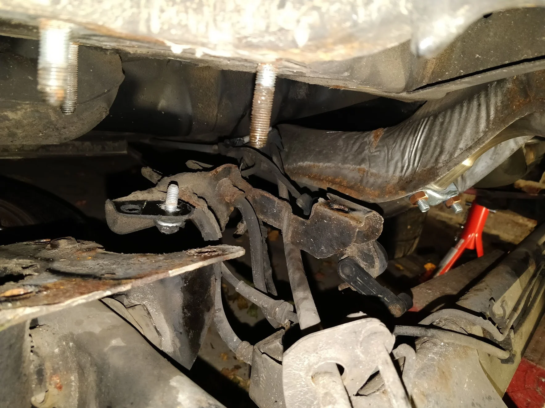

New bushes in. Still waiting for the new bolts...
Just remember to undo this bracket where the the brakelines pass through. Otherwise you will not be able to lower the beam far enough.
sorry for all the pictures and the long post but I guess this couldbe usefull for others trying to do the same.
