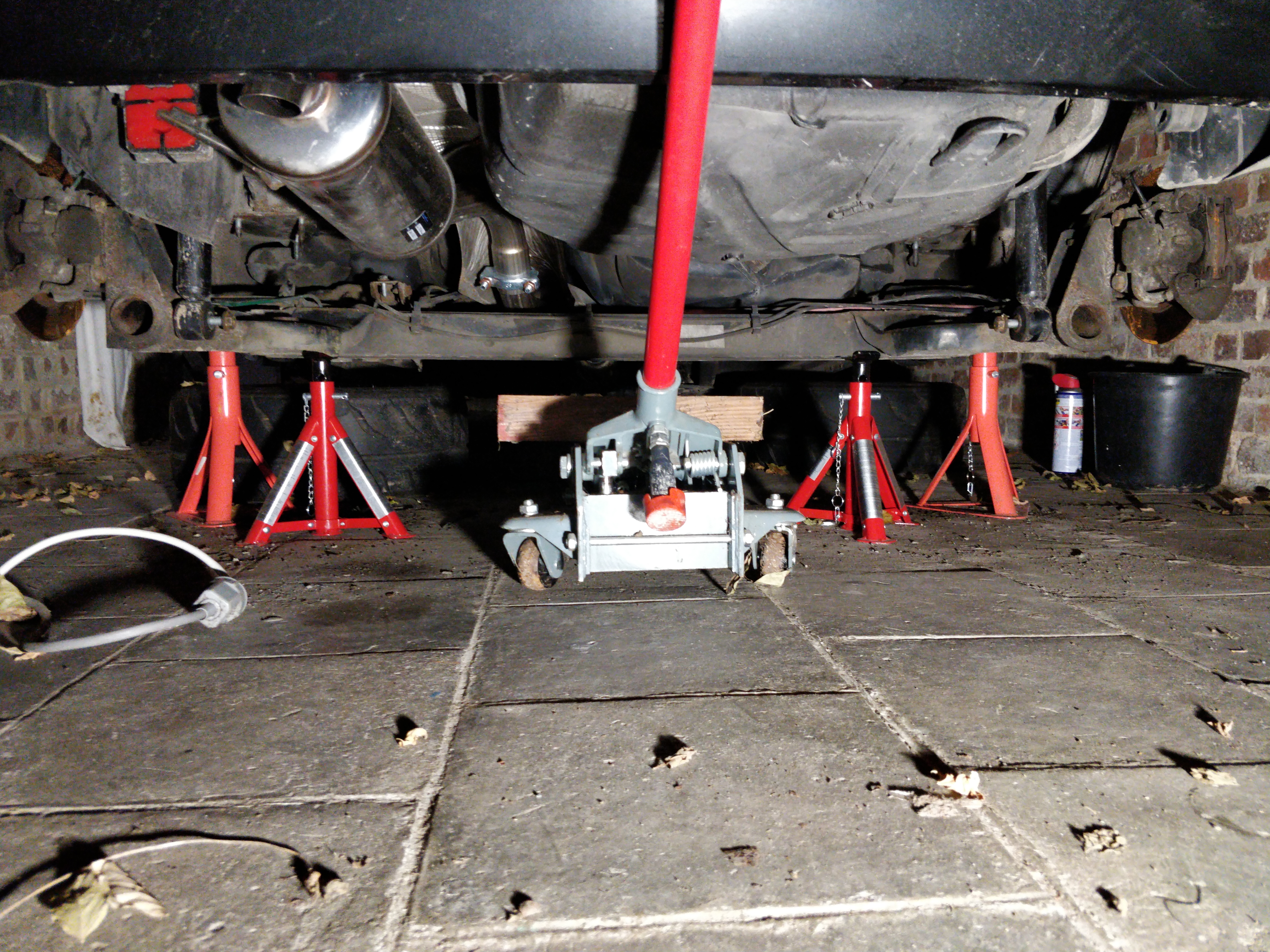

Have you still got the opposite side bolted up to the car while that one has been dropped?
  clio 172 ph2
Not sure of its clear in the picture. Both sides dropped onto a second set of axle stands. They are still hanging by the shocks.
