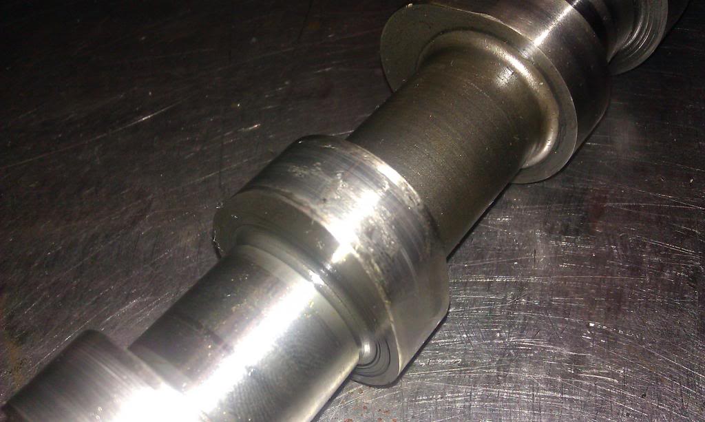

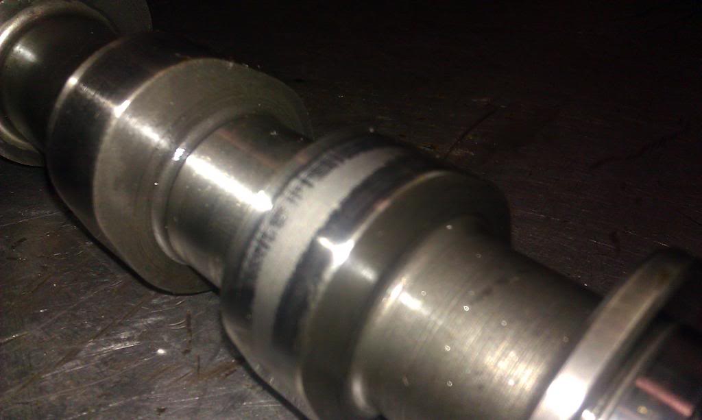

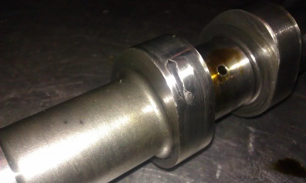

So in your cases the cams must have also been unscaved? My cams looked like this on some of the lobes:
Hoping that just replacing some of them will be allright, do'nt know if they wear differently which could mean all of 'em have to be done..?
Tbh if it was my personal engine if probably use them again, just as its only my labour/money I'm playing with. I'd probably micro polish the cams to get them as smooth as possible.
^^the cams are shot , these pics do'nt really show the damage. I'm wanting to go with some new Schricks as they come pretty close to the C&B spec that i was running. My mechanic only warned about the rockers feeling "rough" and was afraid these might mark up the new cams.. he's wanting to replace them.
