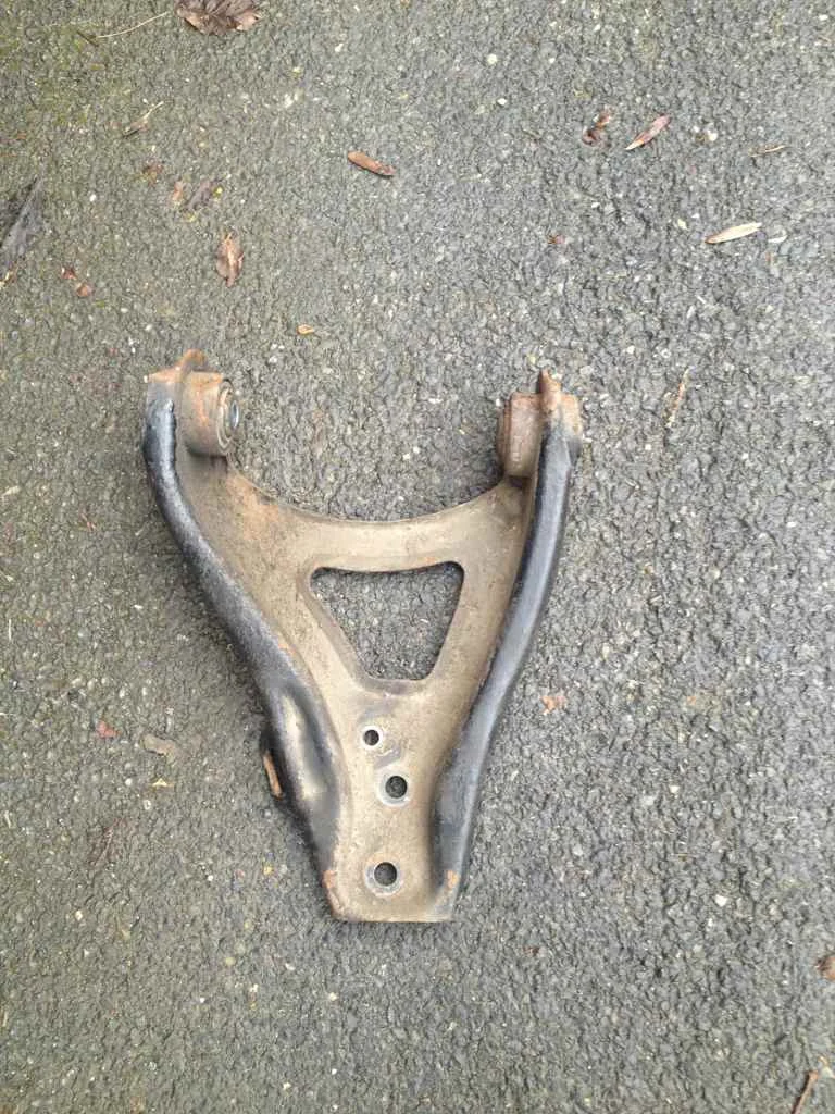

So removed wishbones to see if anythings bent today .
Thats the wishbone doesnt look bent to me ?

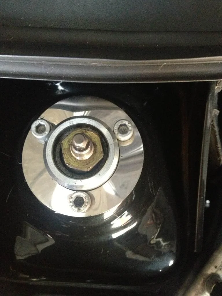

Heres the top of the strut i was talking about .
Note how close the nut is to the top mount body .

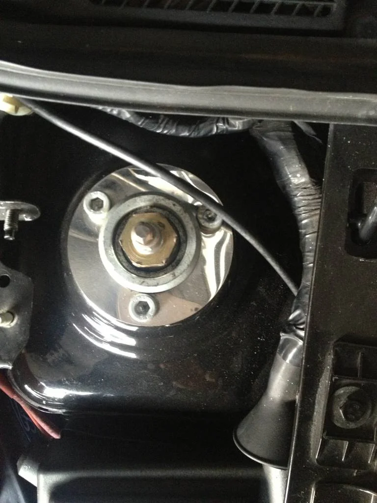

This is the passenger side perfectly straight no lean on the nut .
