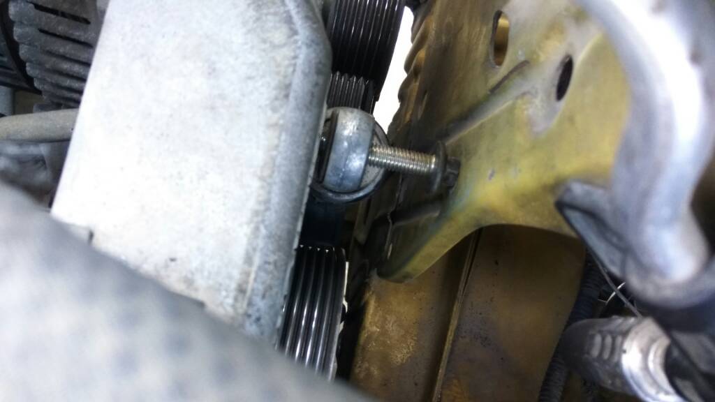

removed the belt, there is a chance that the bolt of the tensioner is longer ? it get stuck between the engine and side frame...
