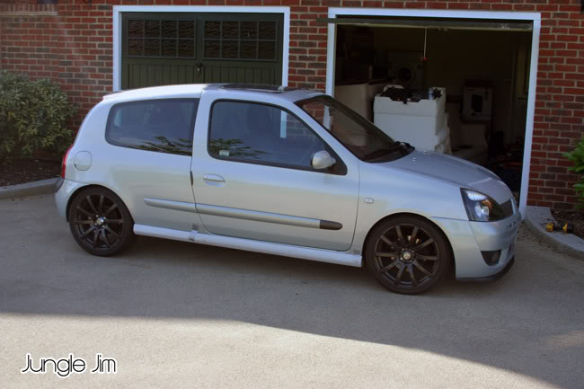

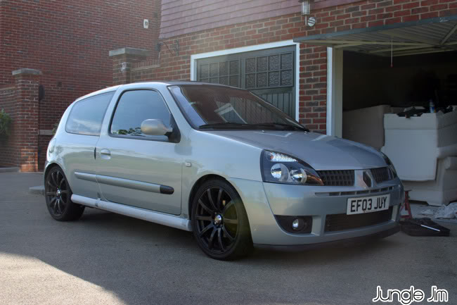

as for self tapping screws, i did one in each end and about 5 underneath. i did a dry fit, drilling all the holes before painting the skirts. this is what they looked like on on the test fit.
They look smart mate, have/can you get some pics of where you did the 5 self tappers underneath?
Also did you use any C cups from Renault that the 172/182's seem to have?
Cheers
yeah mate sure i will get some tomorrow. but basicly the are about an inch in from the back for the skirt (car sill), going straight up into the textured bit of body work.
to get a screw in to the rear end one i had to take the wheel off, also as my car was lowered i had to jack it up to get the drill to fit, luckily i was able to borrow some axels stands and a trolley jack
and nope i didnt use the c cups, i dont think you need them mate only on genuine RS skirts
no worries mate, i would recommend having someone else there to help you as it can be quite fiddley. i used the standard jack to raise the skirt up into place as a base starting point. the screws will hold it in place but the skirt will still require 'pushing in' to the car along the top edge. on reason i picked that adhesive over others its that it drys quicker.
the c clamp things carnivous was talking about are what is normally used for standard 172/182 side skirts, plus some pop rivets on the bottom of the skirts. the c things are just flexible plastic things like what hold the door bump strips on.
