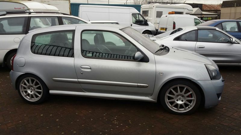

New member saying Hi and some pics of my project car.
Just a bit of of background. I bought this car a fortnight ago and am getting it roadworthy again - its been lying in the sales yard of a friend of mines this past nine months or so, and i felt a bit sorry for it. I negotiated a "fair" price for it, with the aim being to MOT it, service it, and perform some tidy up on it, then maybe buzzing about in it for a little while, then sell on.
Spec wise, its a 2002 Clio 172, fitted with Cup (?) alloys. Other upgrades - added 80 miles ago (but 9+ months) are
=> GAZ Gas adjustable suspension front and rear
=> Strut braces front and rear
=> Induction Kit
=> Decat
=> Big bore exhaust. Need to check exactly whats happening there, but it has a four branch manifold (not sure if this is standard on these?) and at least a stainless steel back box. Will know more tomorrow when i get a closer look at the car underneath.
=> Brembo ventilated, grooved discs and pads.
=> Four brand new tyres
=> New battery

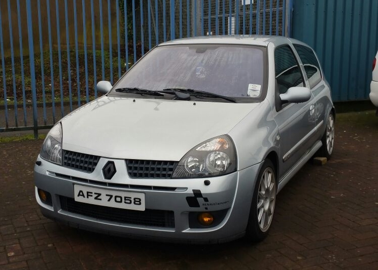

Has it been damaged at some point?
It should have xenon head lamps but it appears to have normal halogen ones?
Thanks for the warm welcome ;)
Yes, its had previous damage that i am aware of.

Xenons are around £100 so not overly dear to put back if you wanted mate! Don't have them posted if you can avoid it, though..

Yellow fogs would be the first thing I'd remove, looks incredibly tacky.
