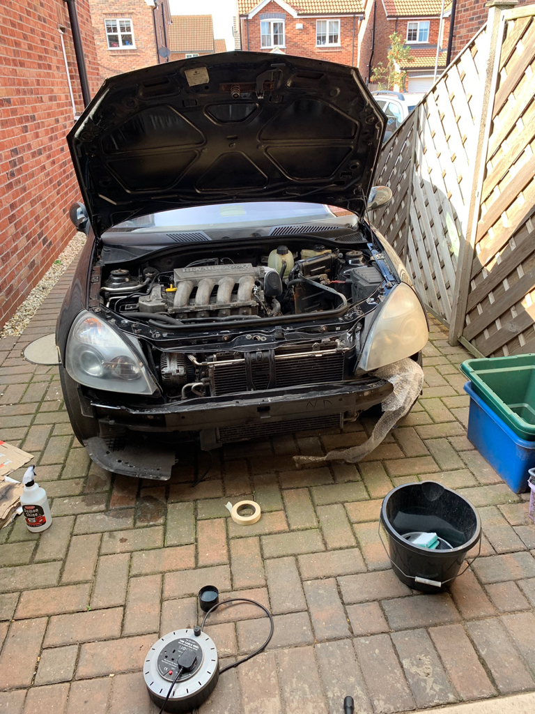

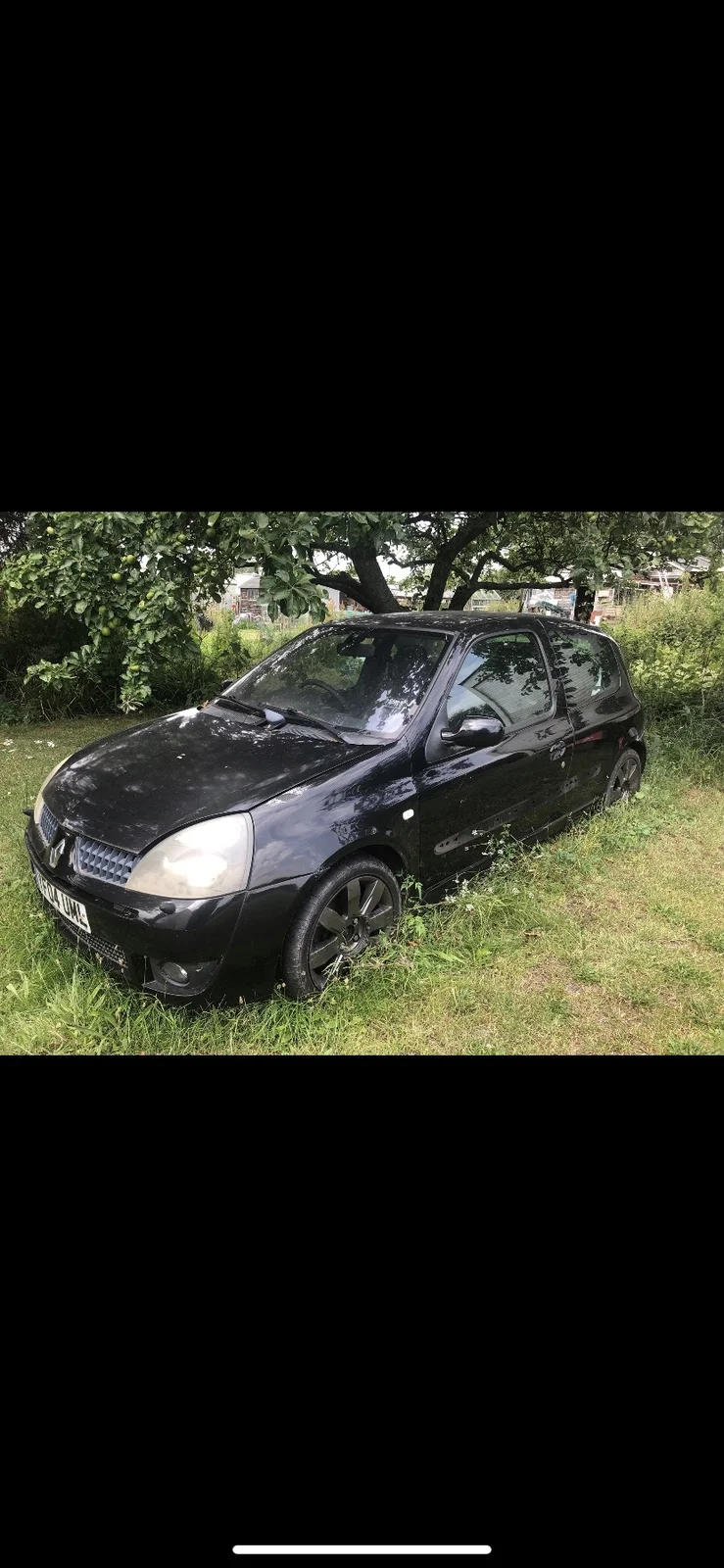

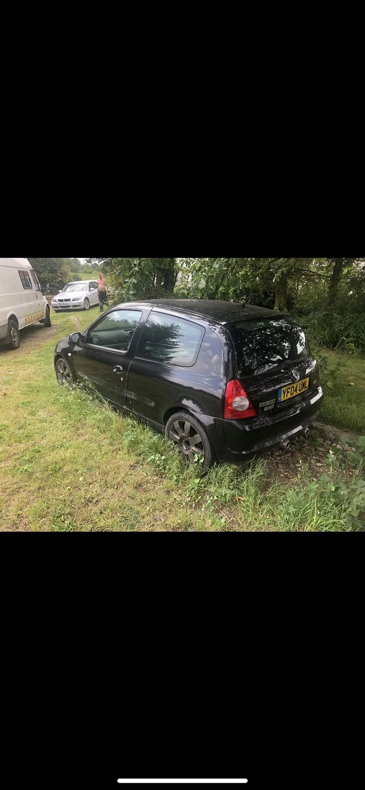

Hi all bought another Clio after selling my 172 over a year ago. Been looking for a while but this come up cheap been stood a while advertised as head gasket gone, thought nice little project. Here are some pics of it .

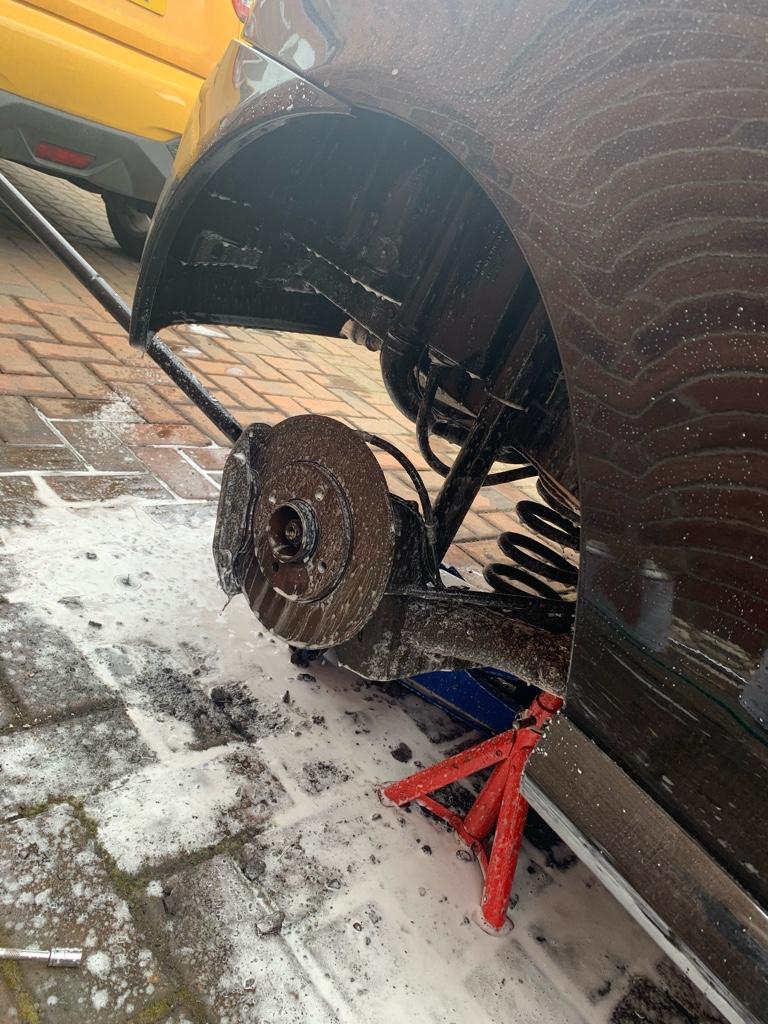

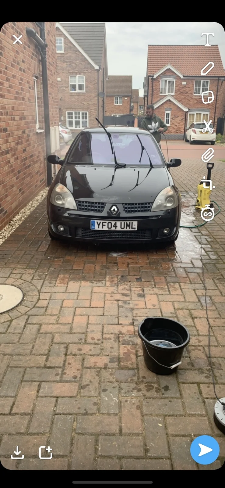

Got her home and treated to a wash

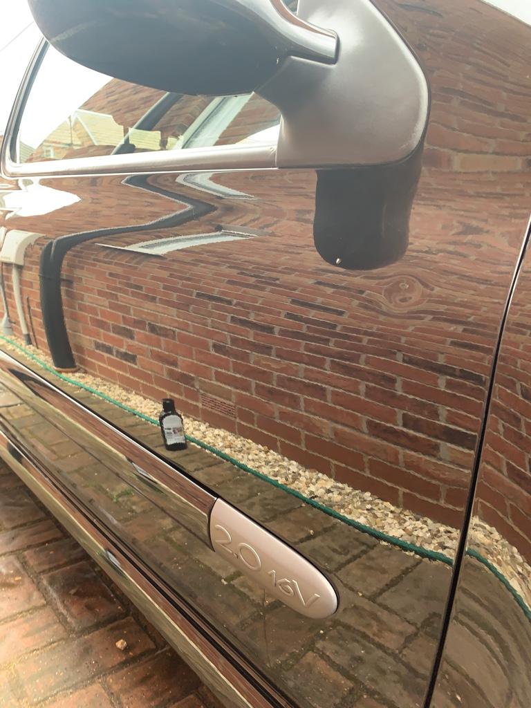

Paintwork didn’t come up to bad . Just could do with a machine polish on my to do list .

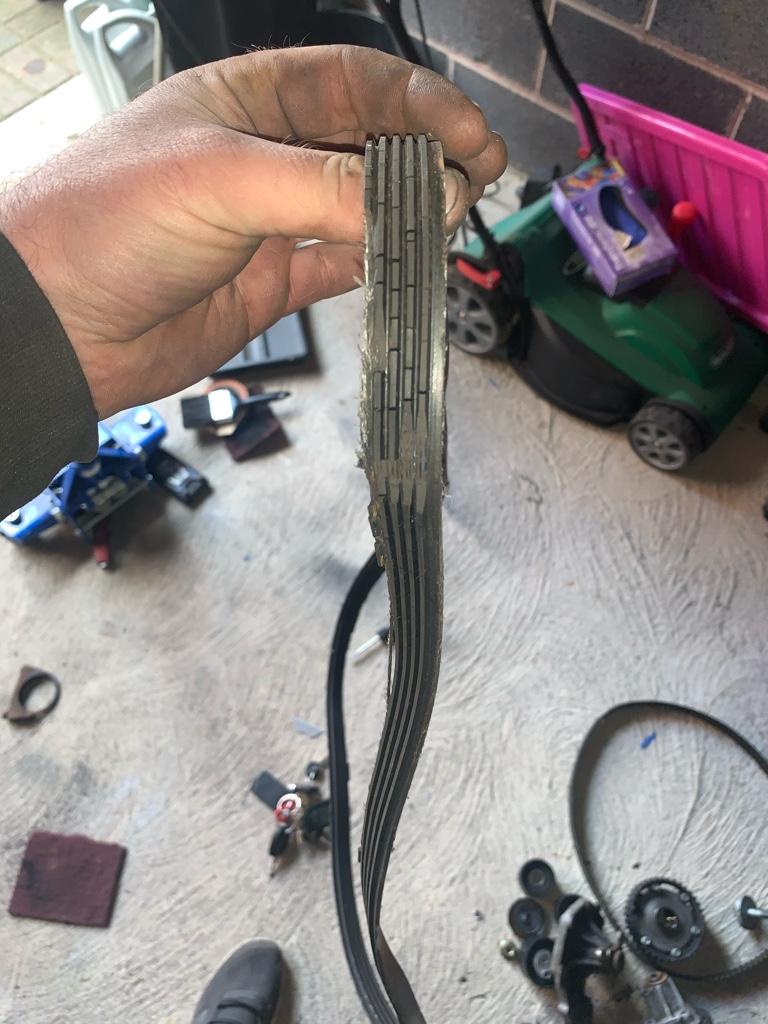

Looked into the head gasket issue . Vehicle was misfiring but started ok . Carried out compression test all above 150 psi on a cold engine. Didn’t run the engine for to long as belts were overdue and aux belt was badly deteriorated . Traced the fault to a dodgy injector lucky enough had one in my garage from previous 1*2 .

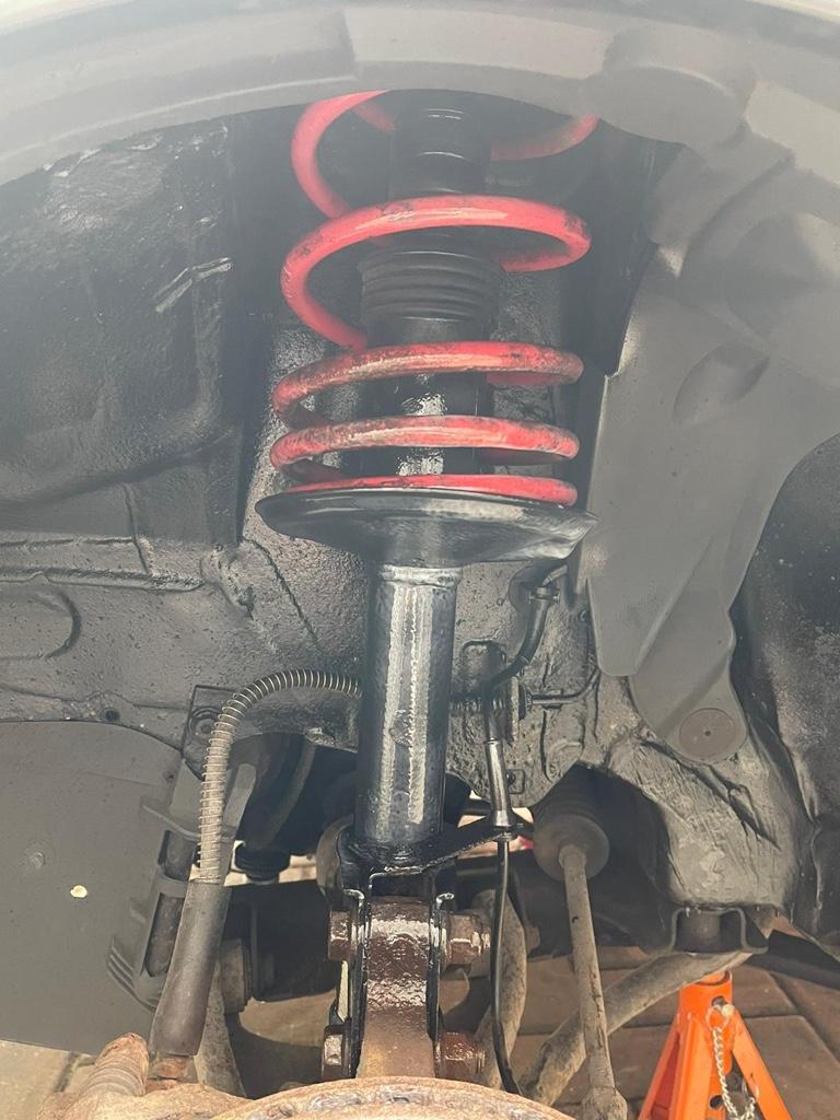

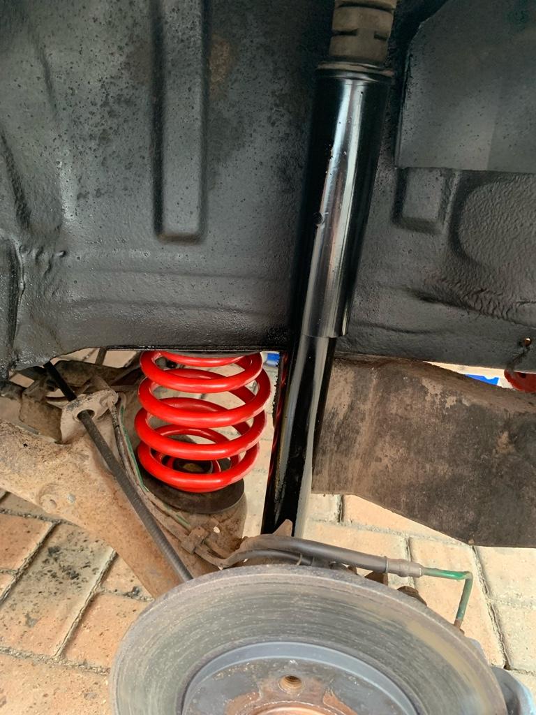

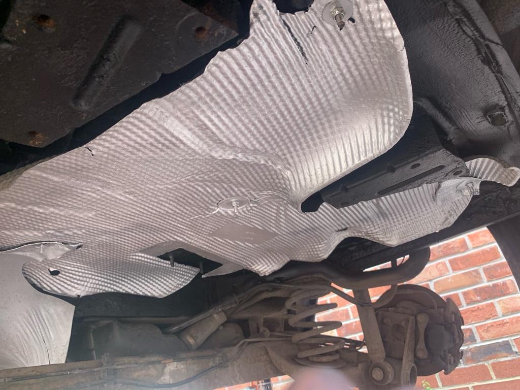

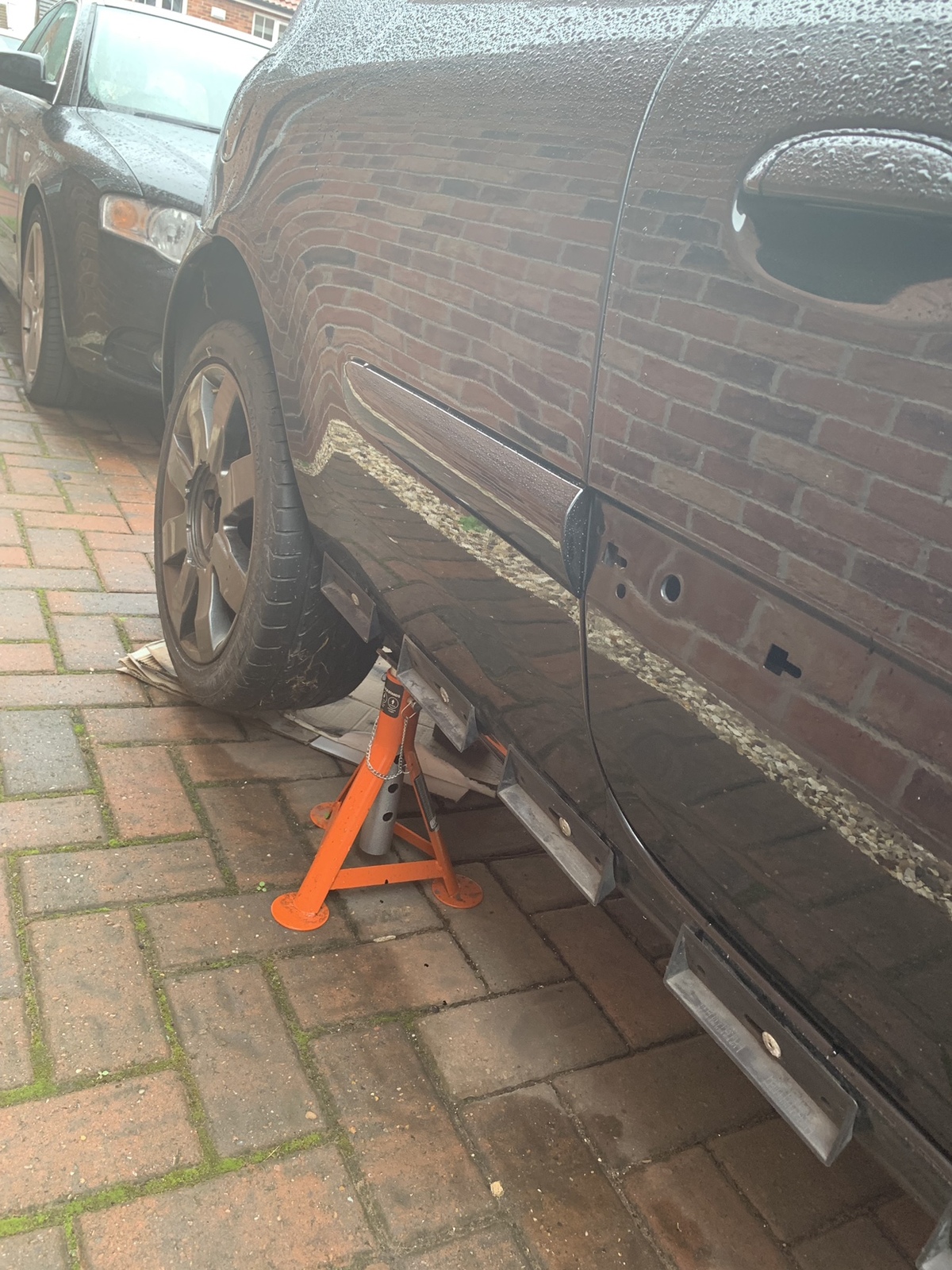

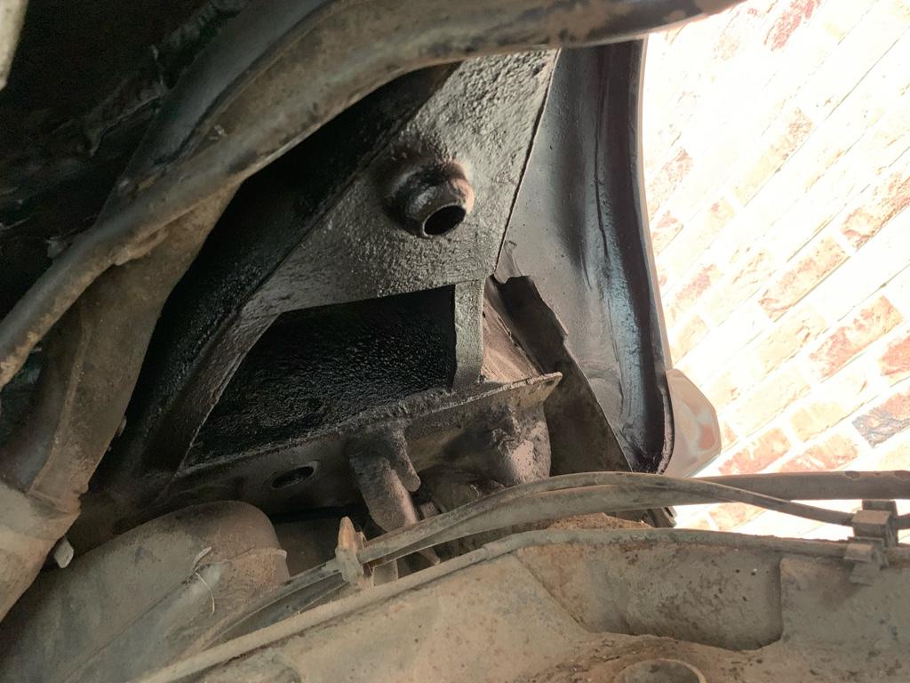

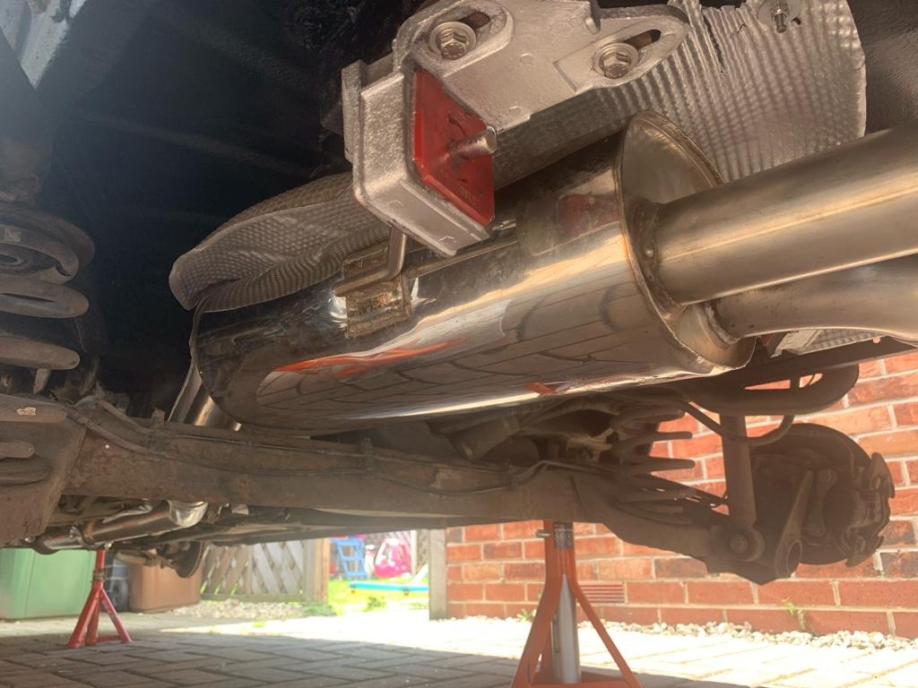

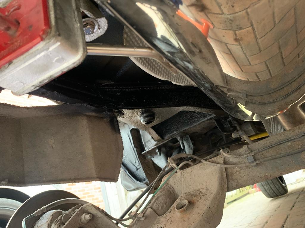

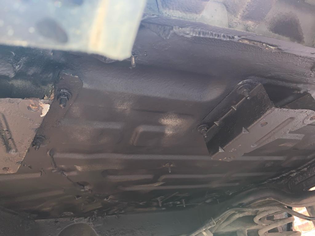

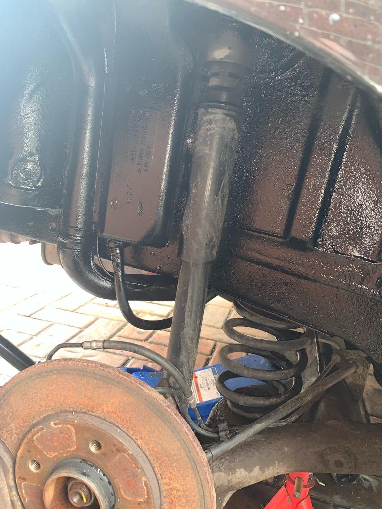

How long had it been in the grass for ? What's the underside like ?

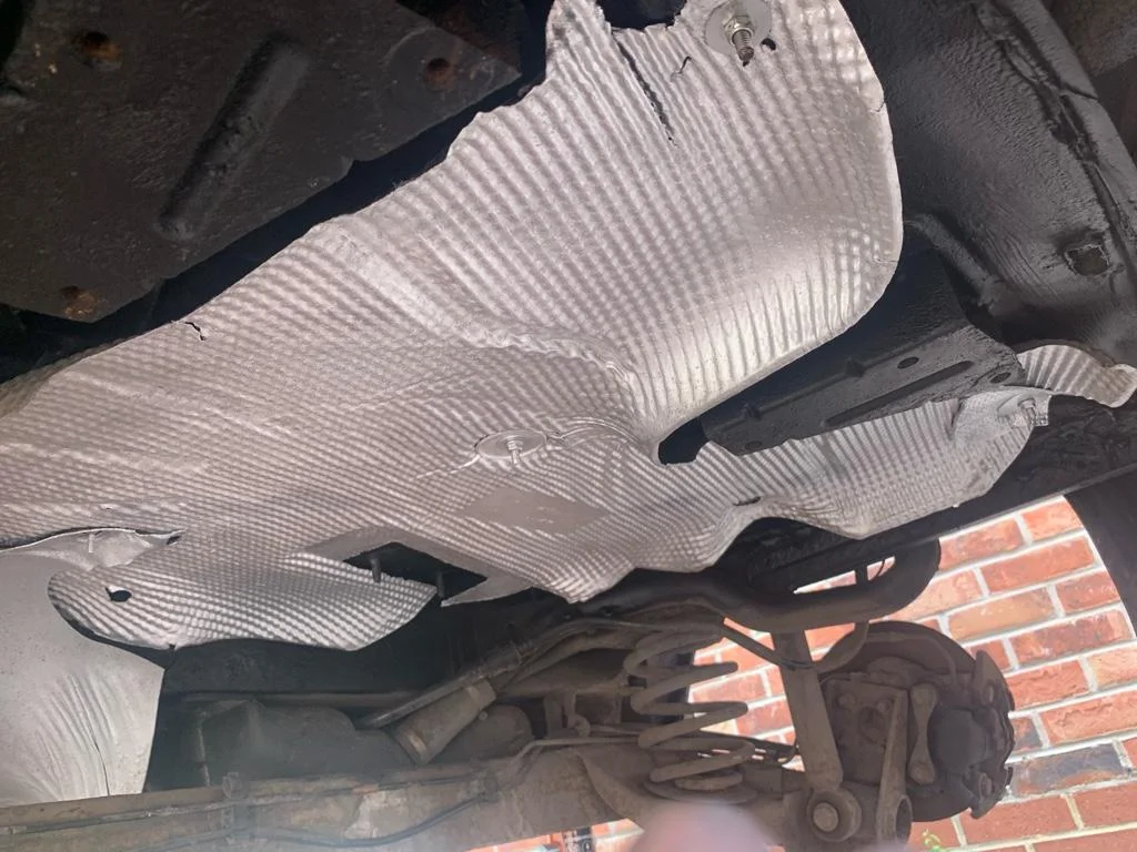

Unsure how long but to be honest not bad at all it’s on jacks down my drive side skirts removed all good going to give it a good underseal before winter tho

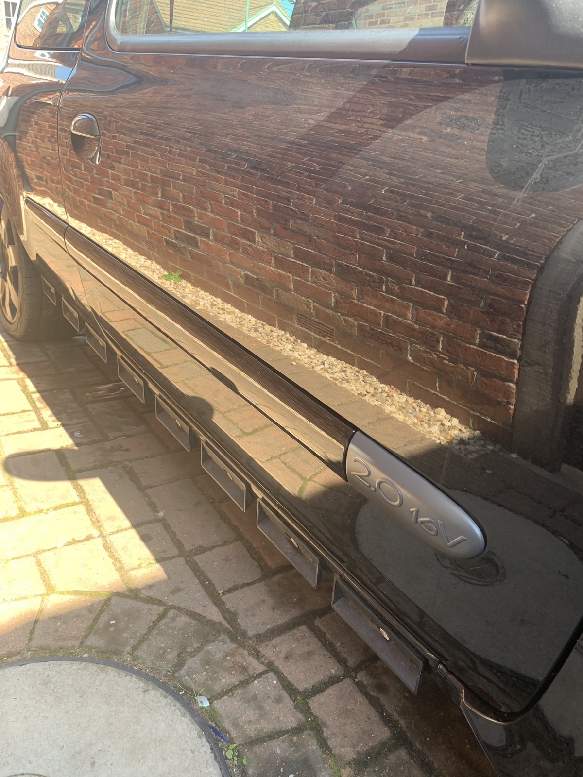

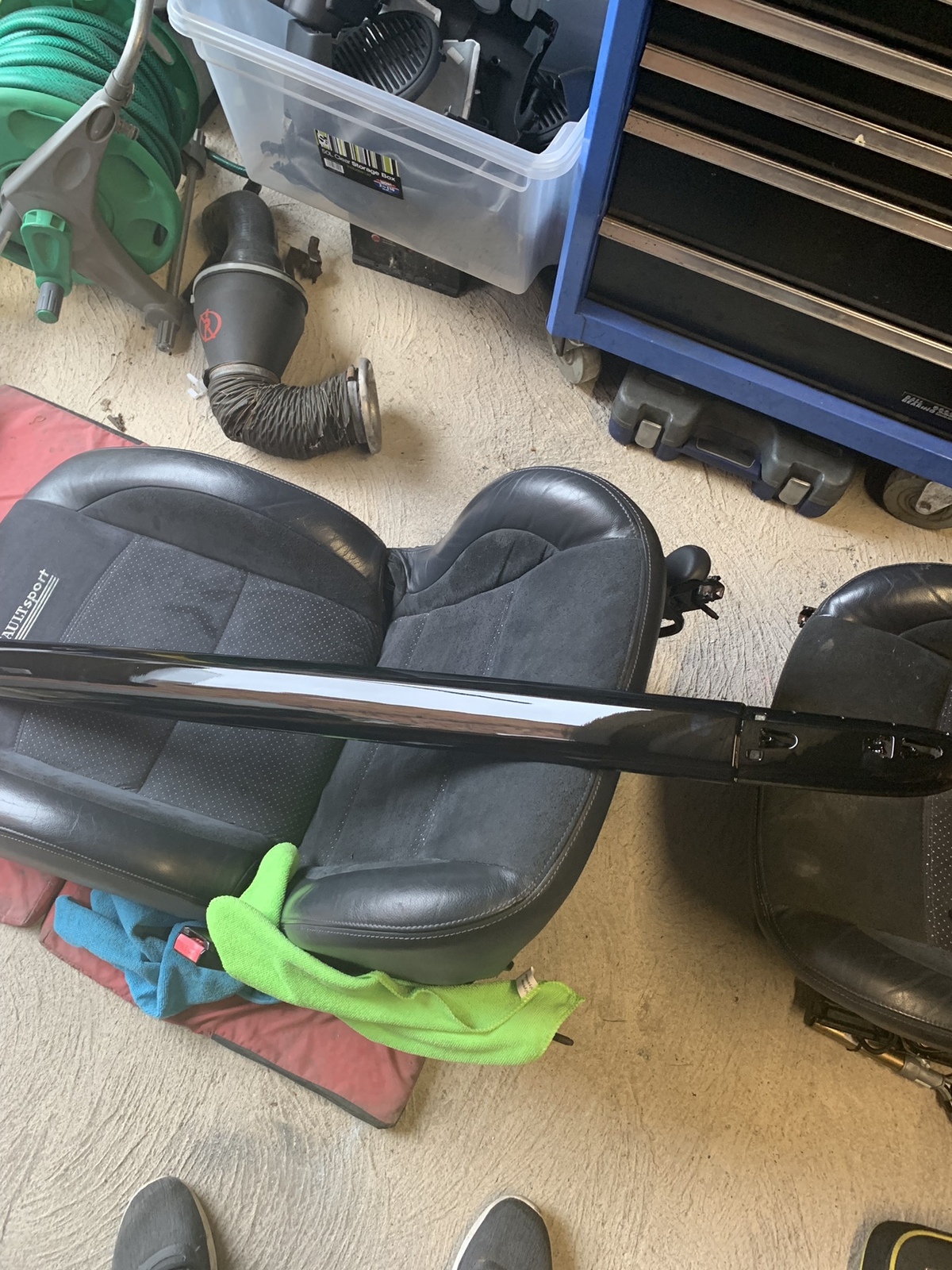

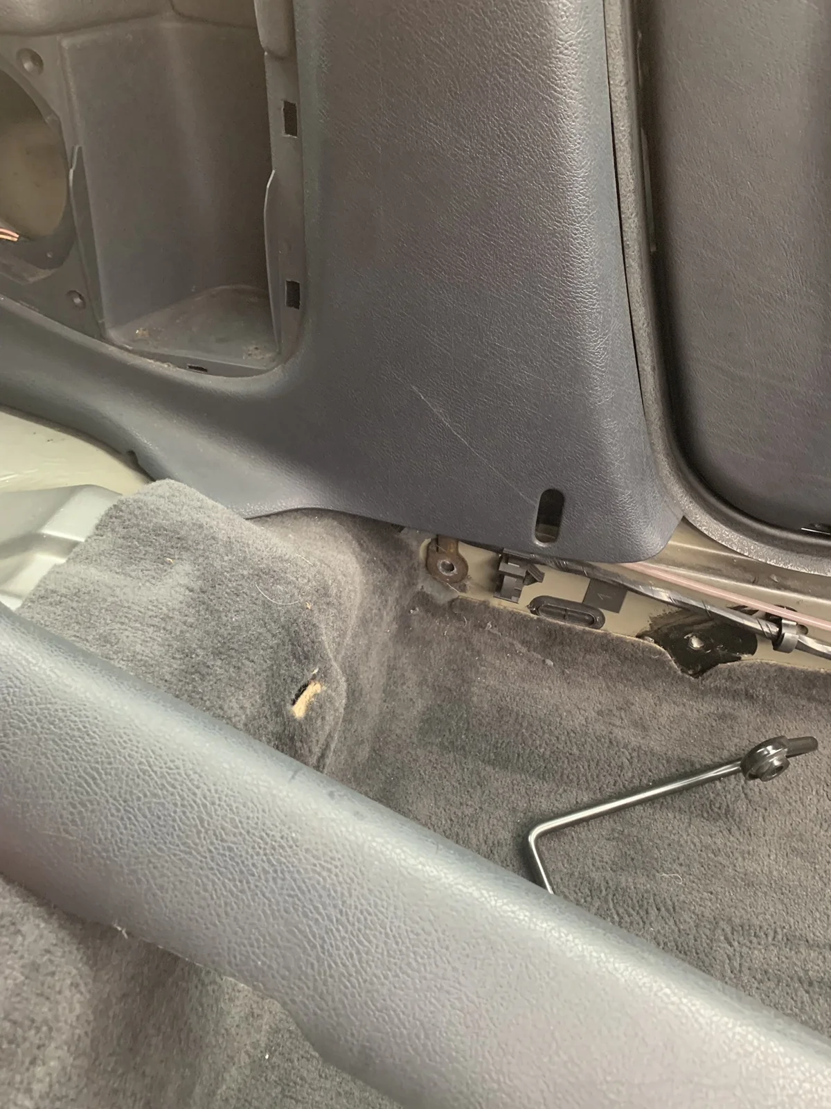

Rear side trims fitted . Missing when I got it . Fronts have been painting just deciding what to do with the bullets

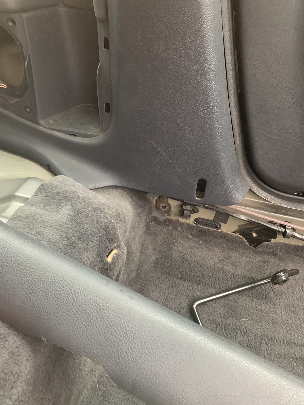

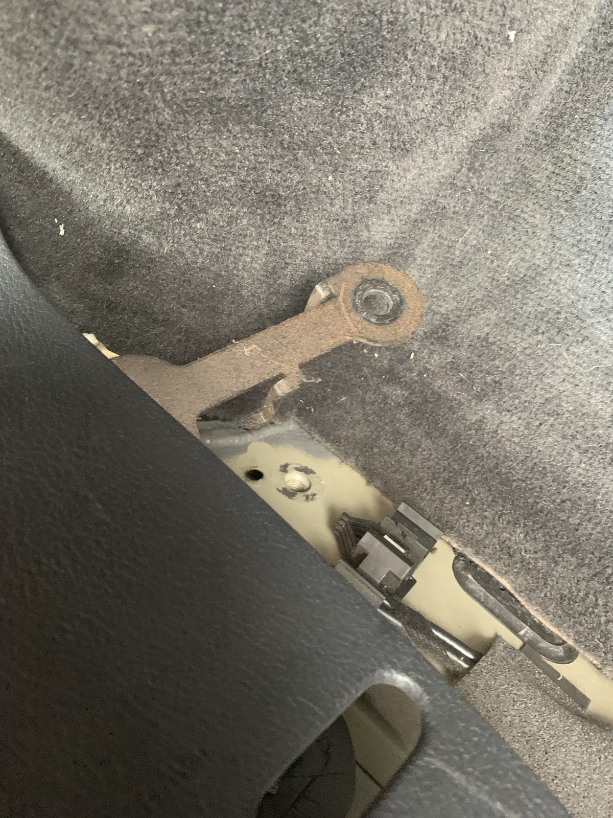

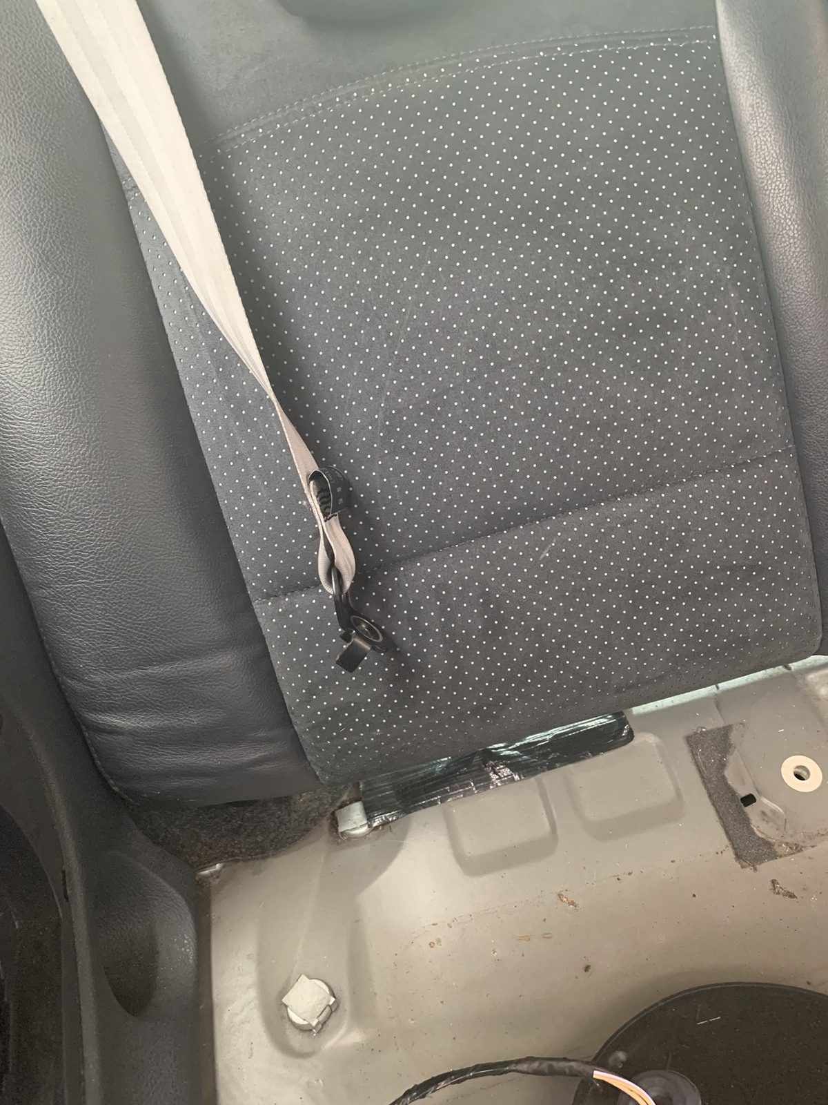

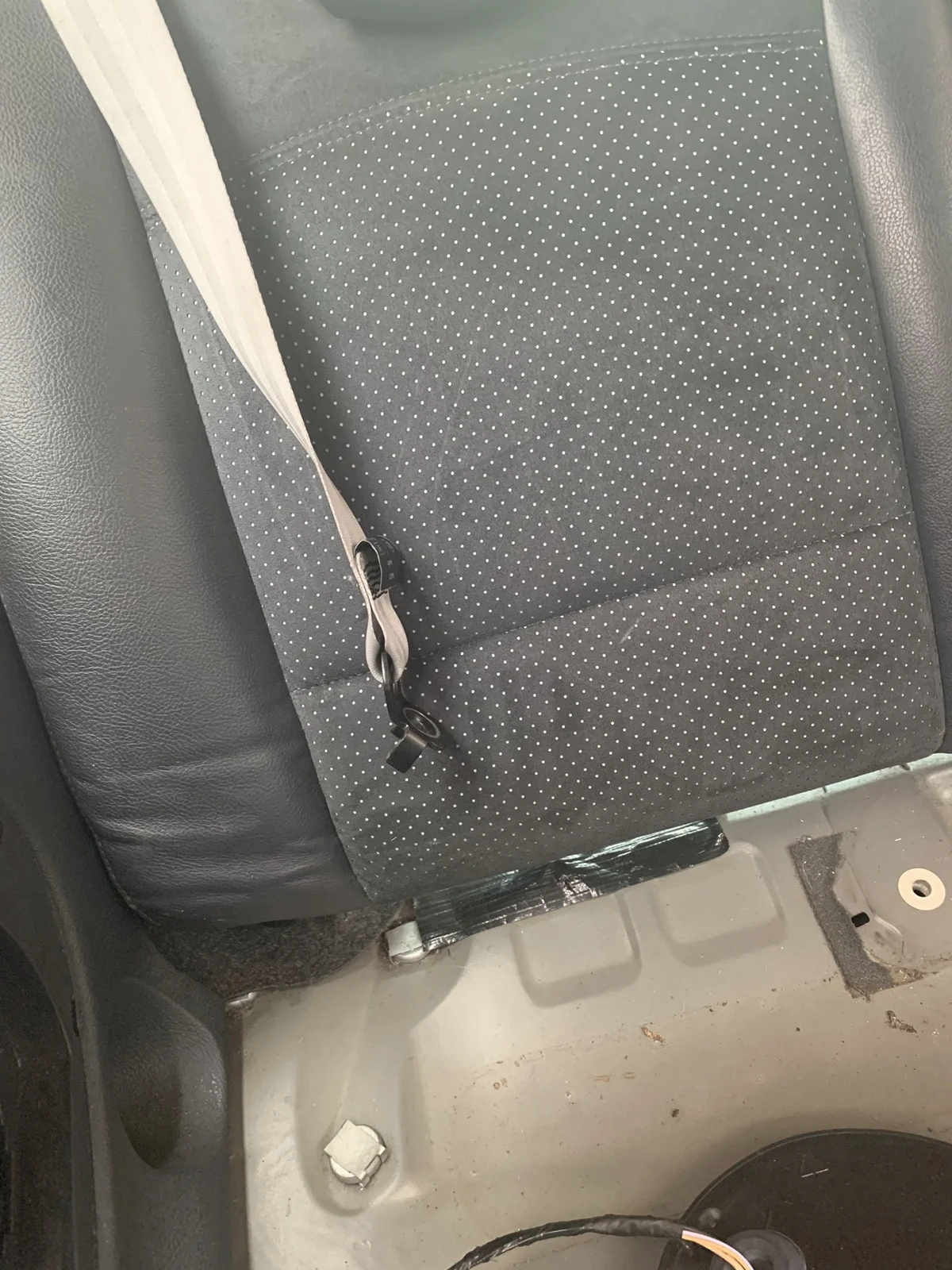

Also got a bit done to the interior today . Was a bit damp/mouldy inside . Cleaned up better than expected forgot to take some before pics will upload the after when complete. Also found bolts missing from the front and rear seat belts , if anyone breaking or has pics / knows what bolts I need hit me up

Head gaskets never go on these so was always going to be something different. They must have taken it to a rather inexperienced garage! An injector is the best result by a mile!

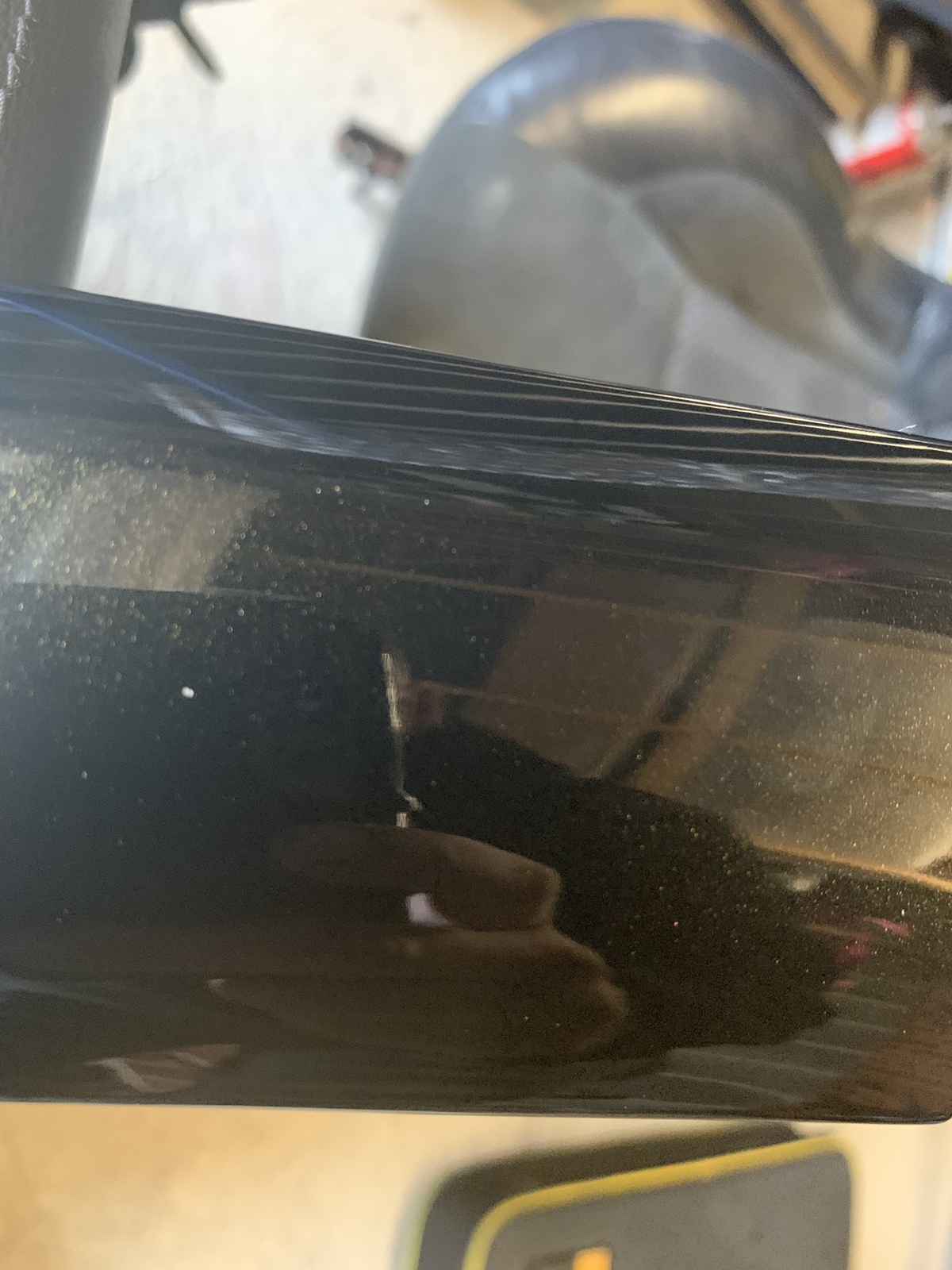

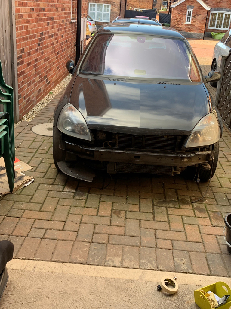

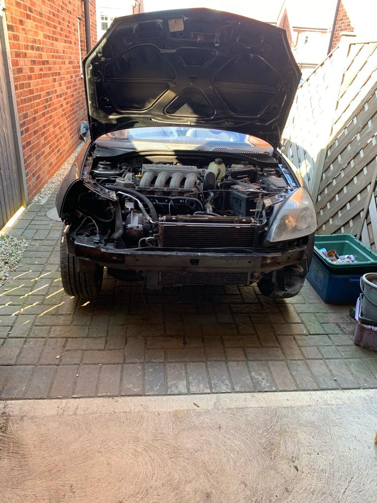

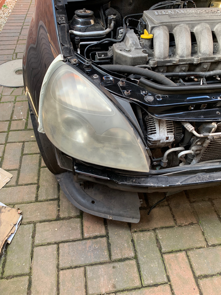

The old girl got a bit of love today , fitted n/s wing just been painted as you can see in the first pic being stood in the sun destroyed the lacquer . Also gave the headlamps a polish not the best but will do. Will give them another go when she road worthy .

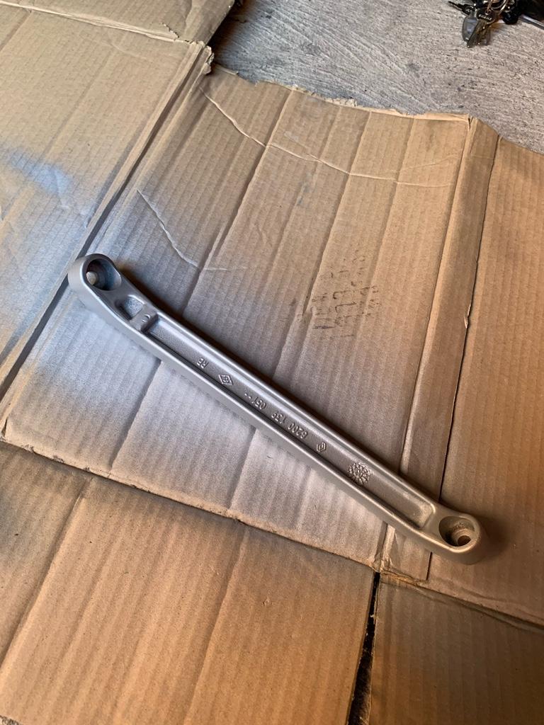

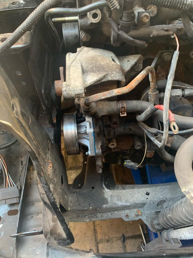

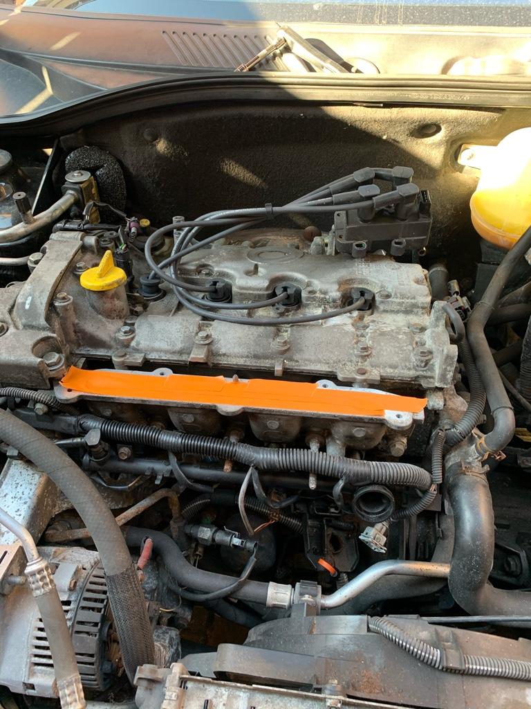

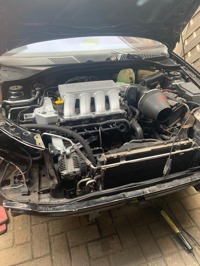

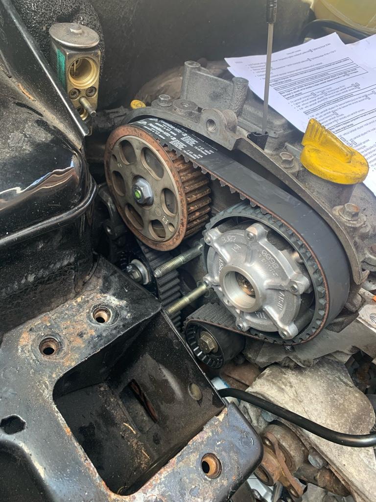

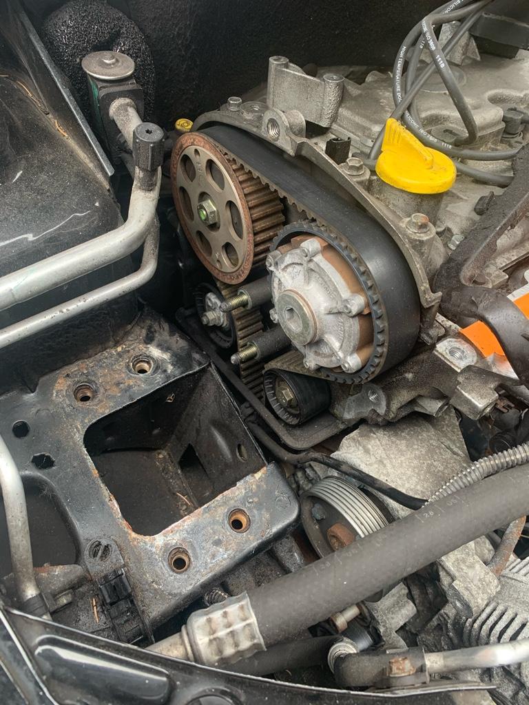

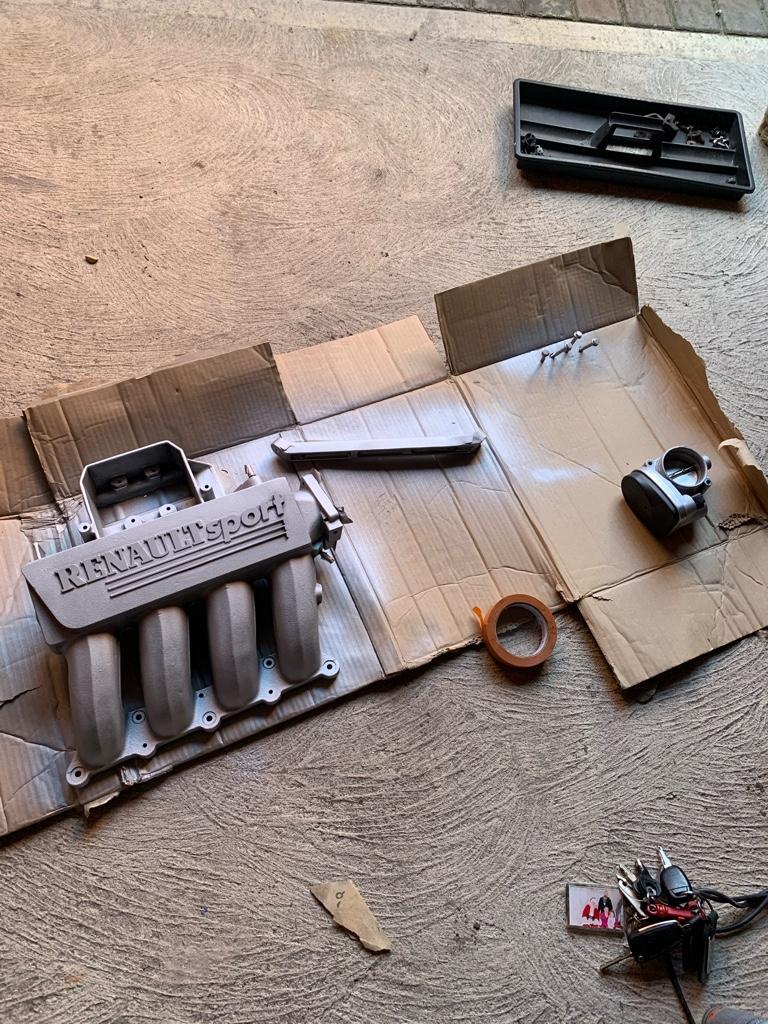

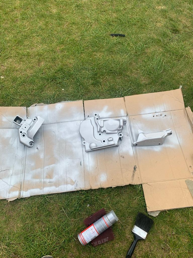

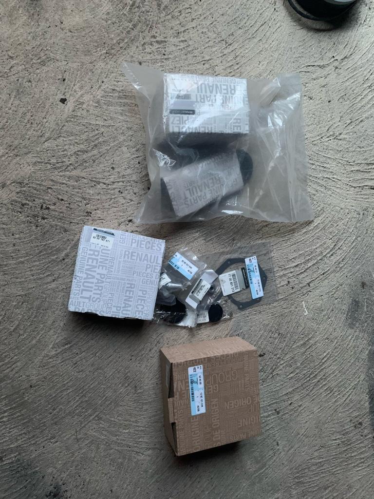

Had the day off so kicked my arse into gear and dragged her out of the garage. Cam belt etc have arrived so prepping for belt change. Cleaned a few items and gave a lick of paint. Will b doing belts on Wednesday hopefully my work decides to shut end of the month
