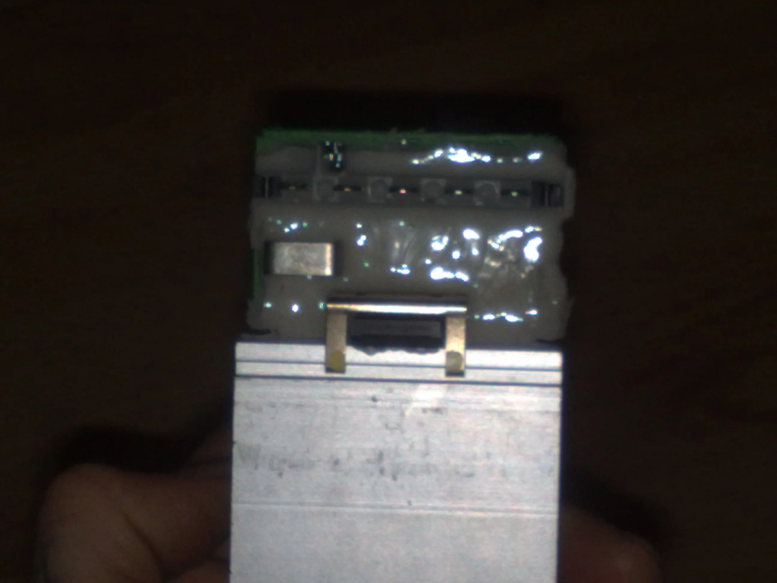

yeah i have the unit opend. it has got a white glue type stuff over the front of it. and it looks like it will come off.
i need some more information on the resistor pack i.e what the chip people replace on it is called and where i could find one.
