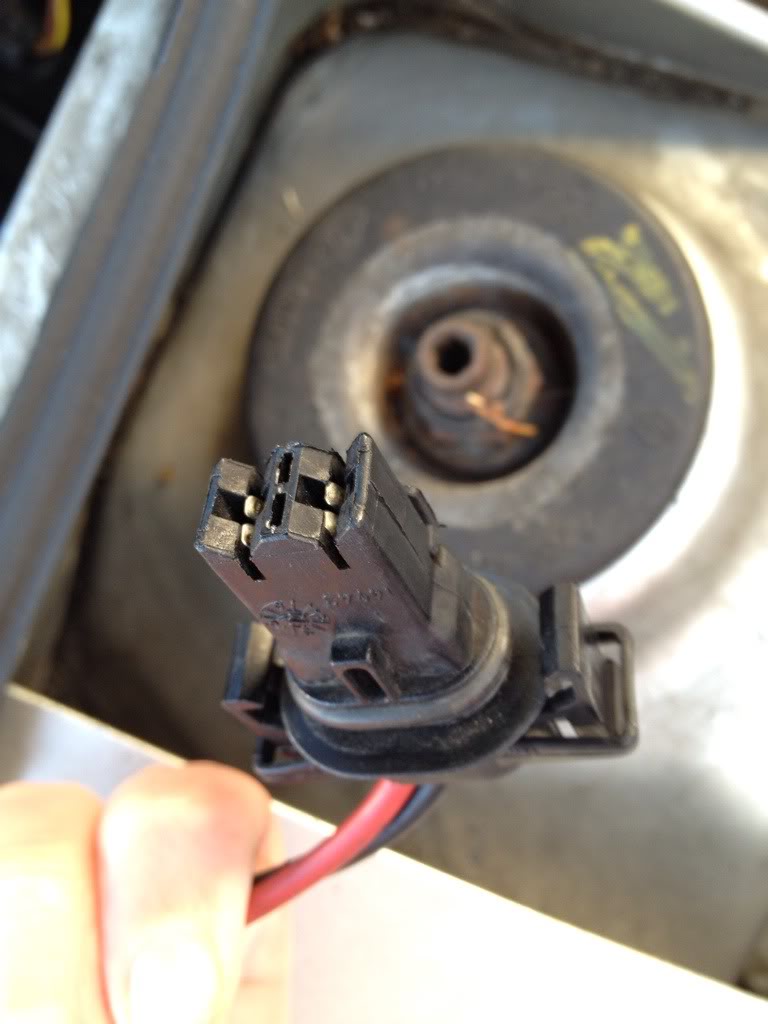

Still haven't fixed this :eek:
That's the connection that's causing the problem. Is there anything there that's obviously wrong that I'm missing? It sort of clicks in but before it clicks, the blowers work but you have to really push that clip to get maximum blower strength. Turn the car off. Next time I drive it, they don't work again.

dunno if its the same on the clio but on the megane/scenic the terminals actually burn out but you cant tell on that plug, on the meg/scenic you can clearly see it has melted the plug away... perhaps check it for continuity

I keep seeing about 'bridging the connections' but tbh, I'm not really sure what that achieves :eek:
This picture..
And then people say do something with 1 & 5 and then the fans should come on? But if not, then it's the resistor pack? But if they do come on? Then what?

The bridging 1 and 5 is for the ph2 resistor pack, that has a different pin arrangement.
Erm, you may be able to work it out by pulling apart a resistor pack and working out which pins go where but thats maybe not for you?
Maybe send the resistor pack to a willing ph1 owner to test for sure?
