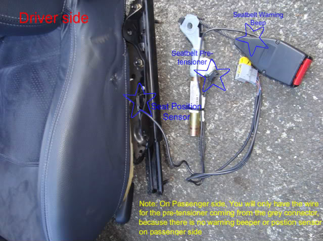

Quite hard to explain lol, but you can see on here:
On the drivers side, the grey connector just plug it in as normal to the car. As you can see, it is the wires for the pretensioner, warning beep, and sensor for how far forward/back the seat is. So leave that one plugged in as normal, and just leave a resistor in the black connector.
What's it look like on the passenger side?

So to clarify, drivers side, you've got the grey connectors joined, and all the relevant parts wired as they should be, ie. wire going to pretensioner, wire going to seat position sensor, and wire going to buckle warning beep, as seen in my pic?
Then passenger side, you've got the pretensioner plugged in, and wire connected (probably not a connector, just a wire coming straight from the car)
Then resistors bridging the correct coloured wires in each of the black connectors (so you use one resistor each side)?
