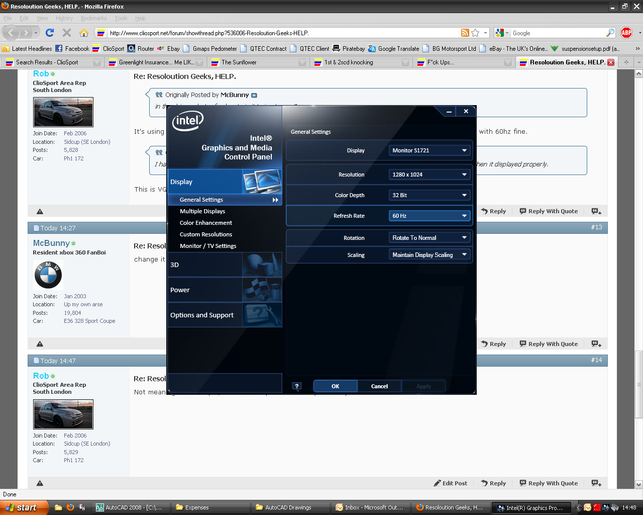

Graphics Driver options:
When plugged into the tv, there are no options but 60hz available on the drop down menu.
