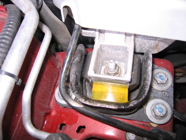

Don't know if this is any help but a common problem seems to be the upper (drivers right) engine mount. It tends to move a lot especially during hard track driving and hard cornering. This make the driveshafts bottom out causing sounds similar to what you describe.
This may be a solution:
