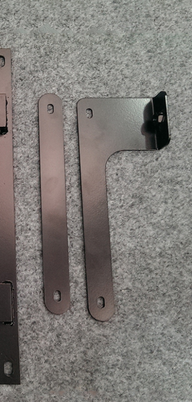

Hi there, how have you got on? I've got my seat belt extension thingy, just wondering how folk are attaching to the seat,assuming drilling and bolting through the side mount?
I have one of these for drivers side if it helps? Came with cobra subframe (for 172) but as I'm running full harnesses it's just sat around collecting dust
Sorry buddy just seen this, I haven't got it all in the car yet, I need to pull my finger out and get it sorted :)
No worries, got mine fitted, particular thanks to @Ads29 who supplied the seat belt bracket which made the job a whole lot easier.
Wish I'd gone for one of the x-low sub frames though, on runners the seat still sits too high for my liking.
Would ideally like the seat belt webbing to be slightly longer. Fired off an email to a company who make custom ones but no reply as yet.
