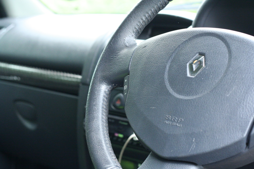

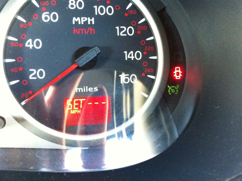

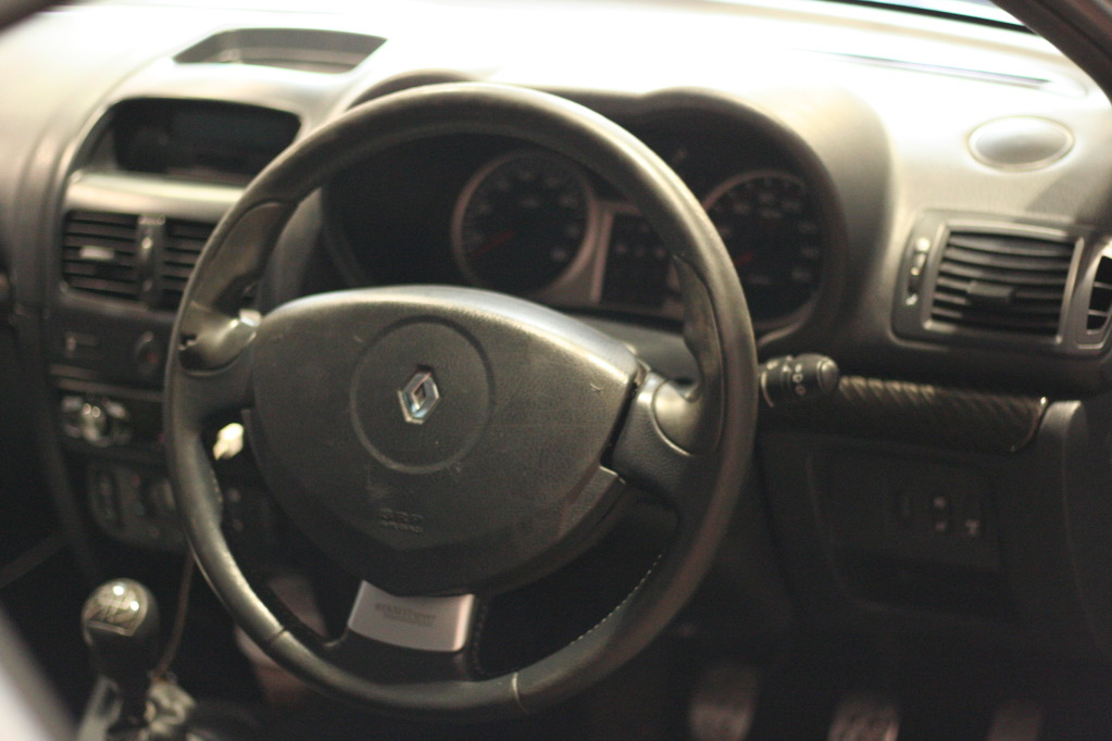

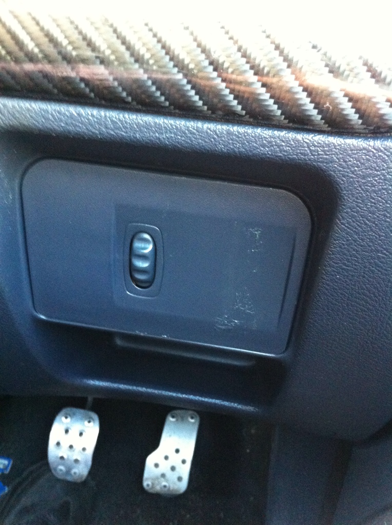

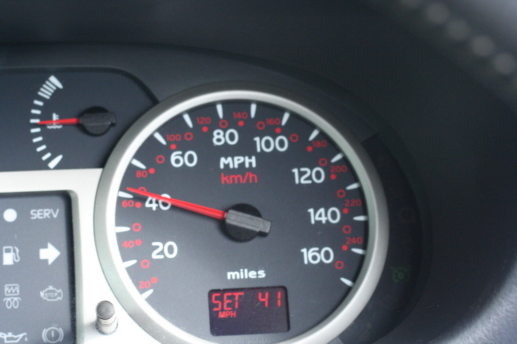

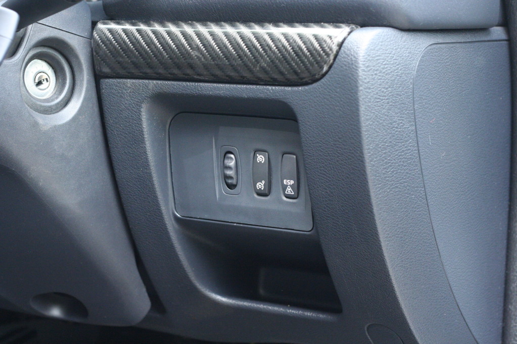

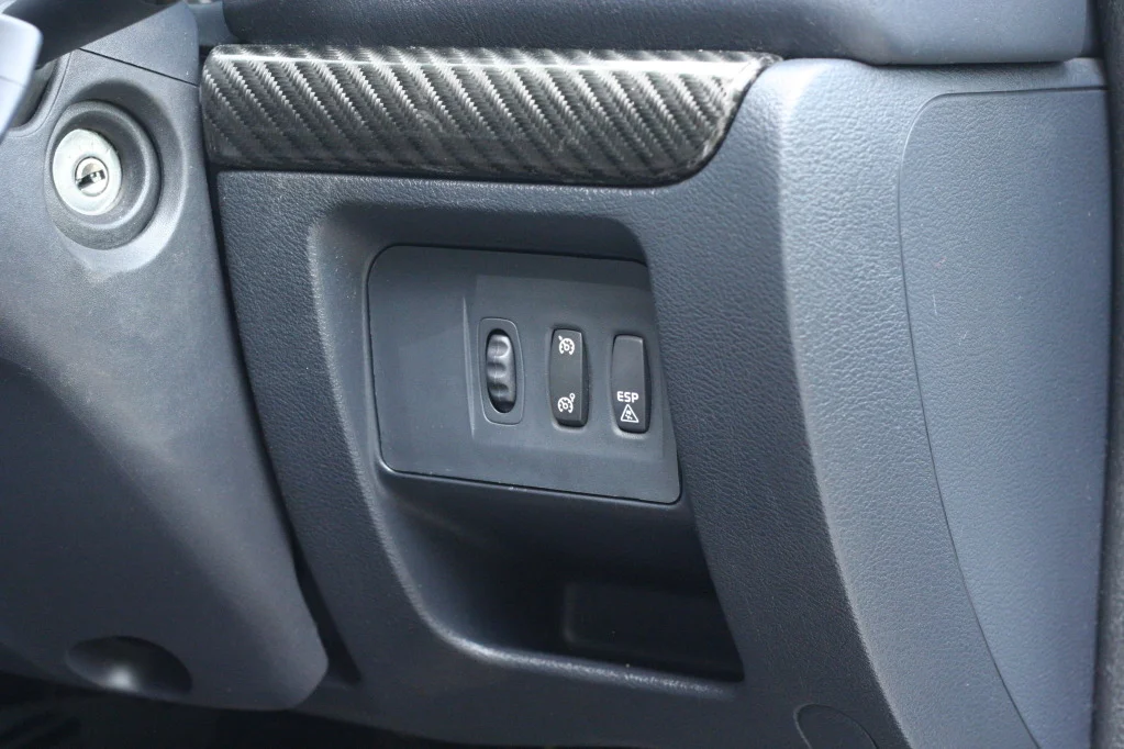

On a ph2:New switch panel

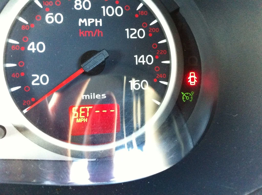

Then a new steering wheel and squib fitted today:
Which then enabled:
Cruise control :D
ESP isn't needed. Nor is any time on CLIP.

I have a 2002 Ph2 172 which doesnt have cruise. I assume from your post above I can fit those two components and then it will "just work"?
Is the plug for the cruise buttons behind that dash panel?
What about the plug for the steering wheel? What do they look like?
Cheers
MicKPM
ClioSport Trader
  Clio16v/Zoe Z.E.50
It depends on your cars loom... Some early cars weren't wired for it, so check.
