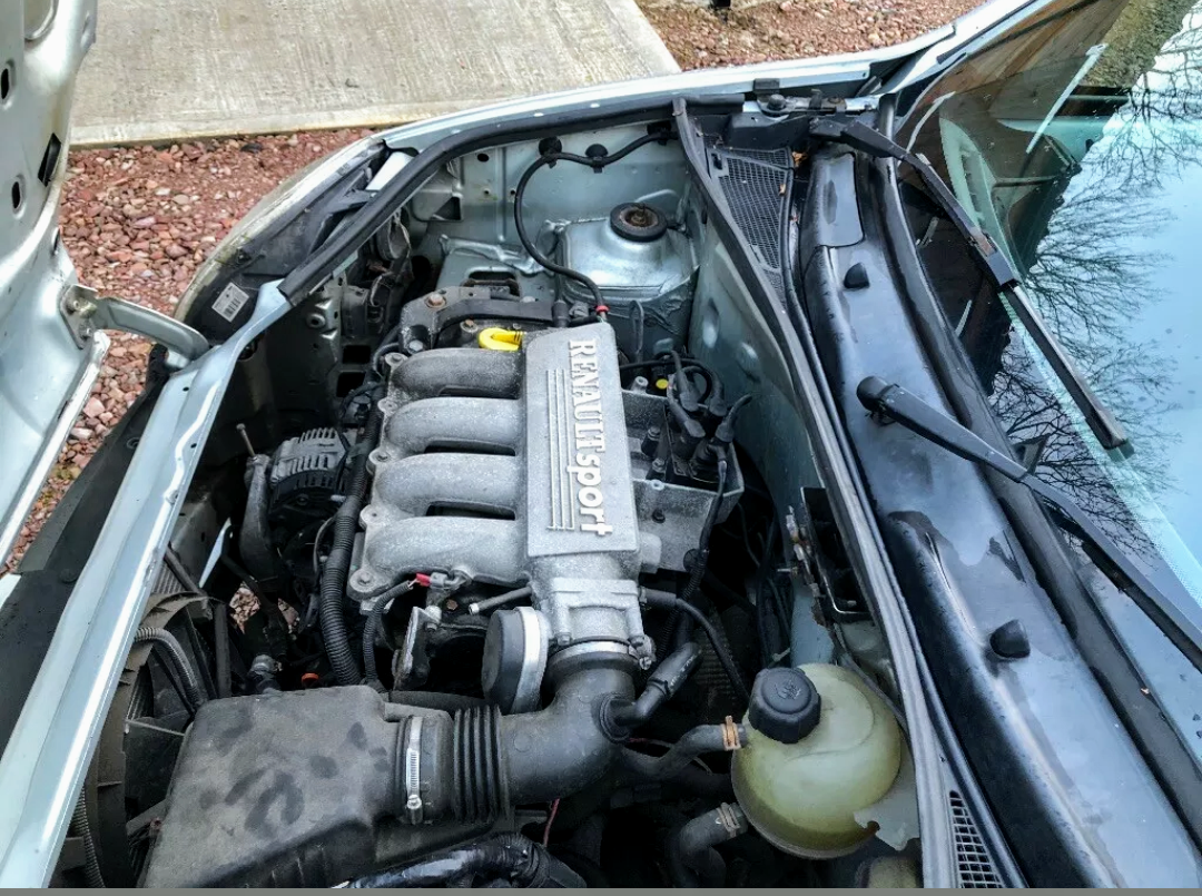

It's always been at the back of my kind to have one of these, I missed out on a yellow converted Primastar a couple of years back and thought it looked pretty cool. The whole idea of having a work van with a Clio lump dropped in just appealed to me, over a long period of time I've toyed with buying another cheap car to have fun with but when the Kangoo came up in eBay I just knew it had to be done.
It works for me, I just don't have time to do a complete conversion but enough spare time to play about with it making it my own along the way. It runs, drives, it's complete. 2 jobs it will need doing is a crunch in 3rd gear when tanking it so a replacement box and the power steering has a leak so either a pump or pipe.... We'll see. I'll go through everything mechanically just to make sure it's all in order.
Aside of that I'd like to add a sound system, a sub box, it's always been a thing for me to play Drum n Bass or dance music and have it sound decent. I know it sounds random but with the van I can do that but keep it simple. Door speakers, speakers behind the seats and a sub box.

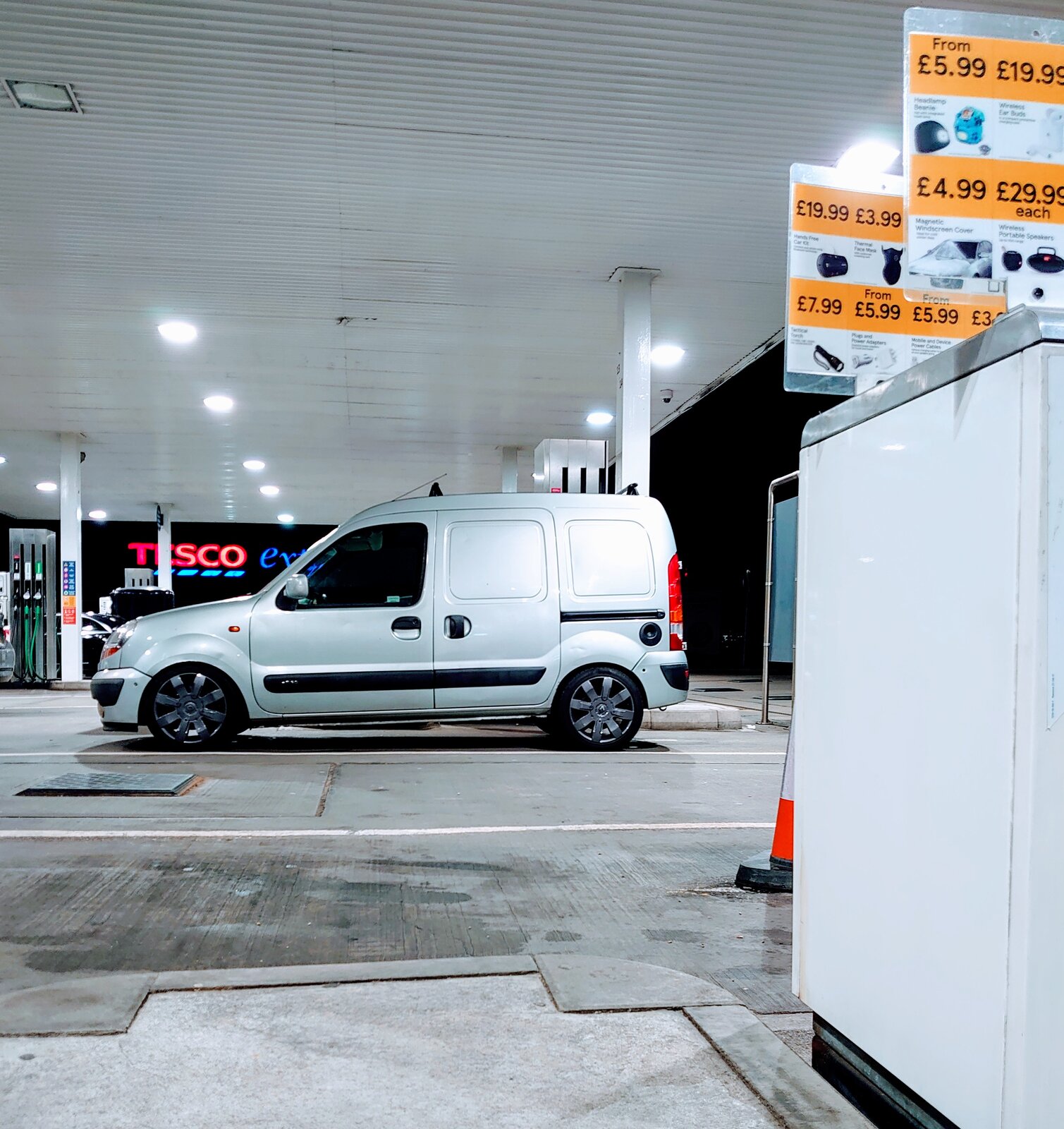

Top up of Tesco finest 95 and a couple of photos this evening. I've also arranged to take it down to Ashford in Kent this weekend so Chris King the Renaultsport specialist can give it the once over and look into the erratic speedometer and fuel sender problem.

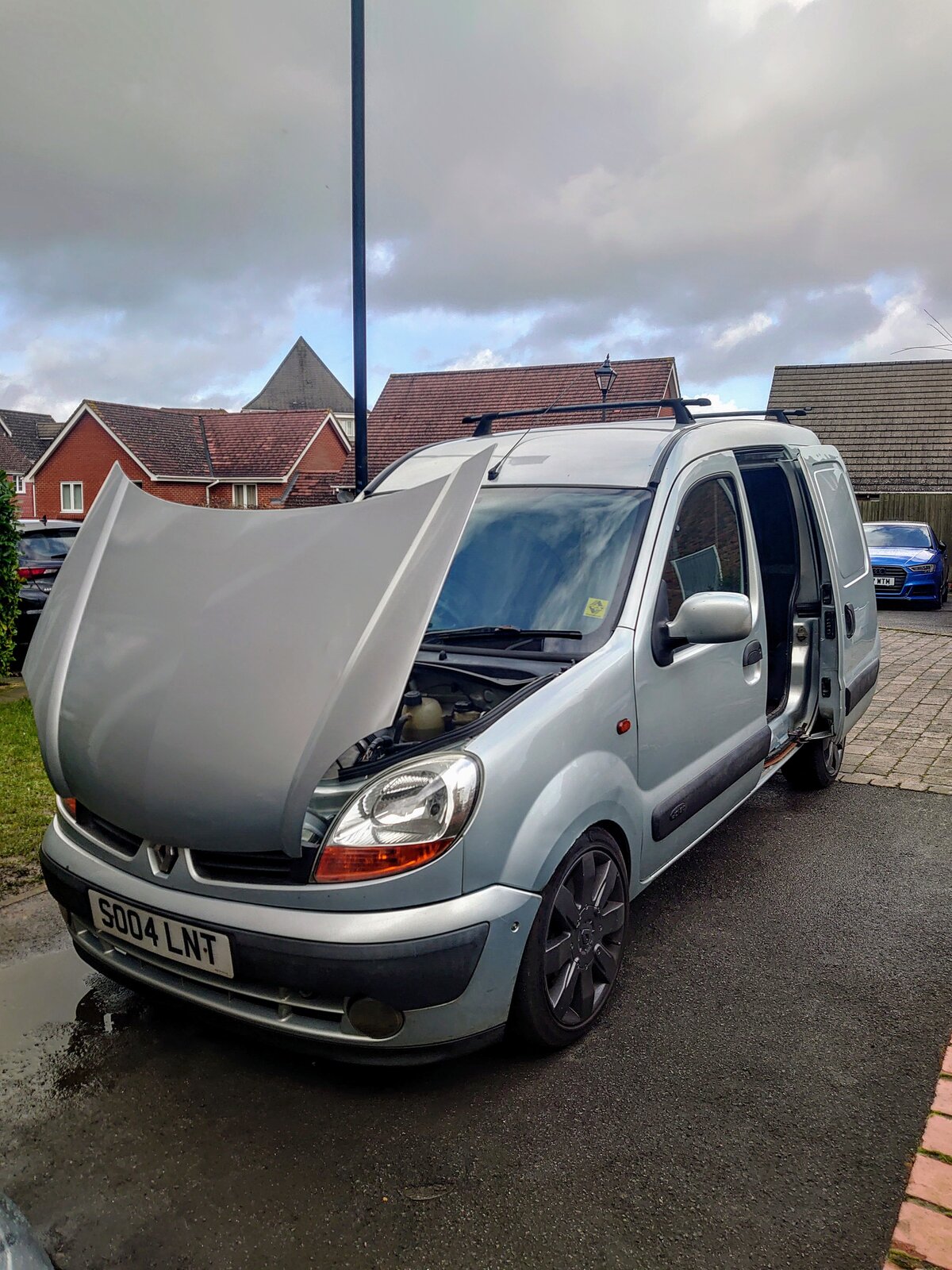

Front wheels off and had a nose about, definitely NOT K Tec coilovers as they have damping adjustment on the shock top, not silver and his hunch is maybe GAZ.... But no stamps. Also confirmed as 54mm centres so NOT 60mm 182 cup as was mentioned. So it looks like a late 172 was used as a donor as there's no speedo drive in the box but a signal coming off the sensor in the hub. Only 1 sensor mind you as the drivers side is cut so they've tried to use a signal from the passenger side. It all seems intact hub end, no cracks in the ABS ring so Chris is thinking dash clocks?

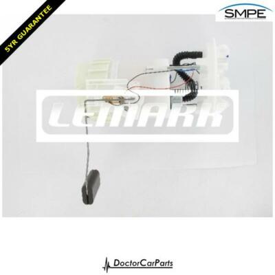

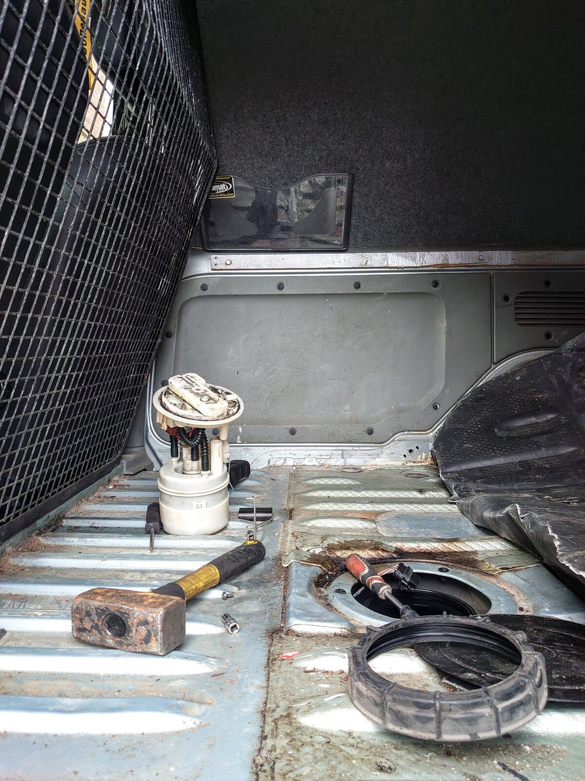

Second issue, fuel gauge. It uses the 172 sender and float so we swapped out the float for a Kangoo item which is noticeably different... Good. BUT, if anyone has a photo of a Clio 172-182 sender up close it would be appreciated as we think where the top half prongs go into the bottom, half the tabs are broken so effectively the bottom half of the sender is hanging off the springs and sitting too low. The gauge read halfway but when we took the sender out the tank was almost full.
The plan is to get a second hand sender, swap the float to that and drop it in. That's all we could do really today.

I’ve literally torn all my hair out trying to sort out my fuel gauge.
It works from half a tank and under and that’s the way it’s staying until someone gives me a definitive solution.
Mine read half a tank, swapped the float, driven 70 miles, needles gone up to full 🤷 @Brigsy was saying to use the Clio sender and a Kangoo petrol float for it to work. I still need to see another sender to at least see if the housing is broken.
Kangoo sender. No issues with reading. Clio senders dont sit on the bottom of the tank as it should. Also there's no tank breather if it's the diesel tank. Mine read 1 bar from the top when full. I'd be tempted to try get petrol tank and sender
So buy a Kangoo sender and drop straight in, and the pump will be ok to use too?
Yeah I've had mine in the daily and just done its 1st 4hr track time last weekend no issues in the diesel tank. Will see if I can see it on ebay and pm you
It should. Get a multi meter onto the sender and see if the level circuit is working. Or try new speedo. I doubt it will be wiring
