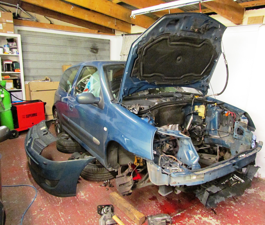

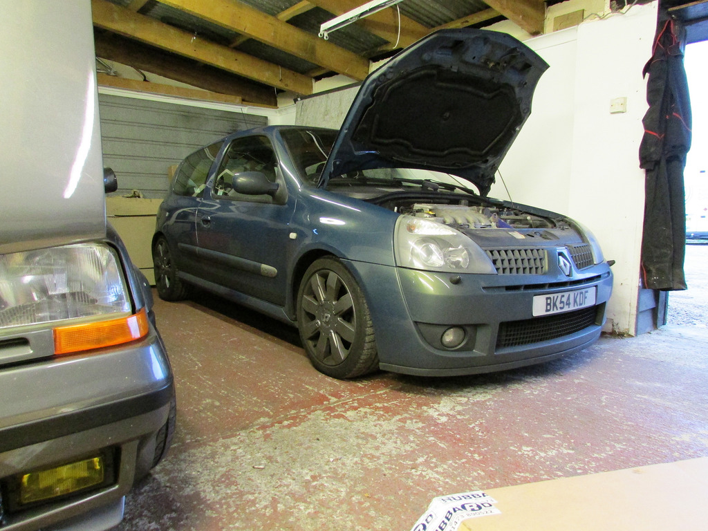

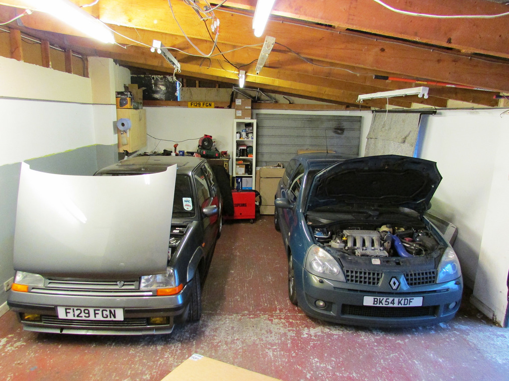

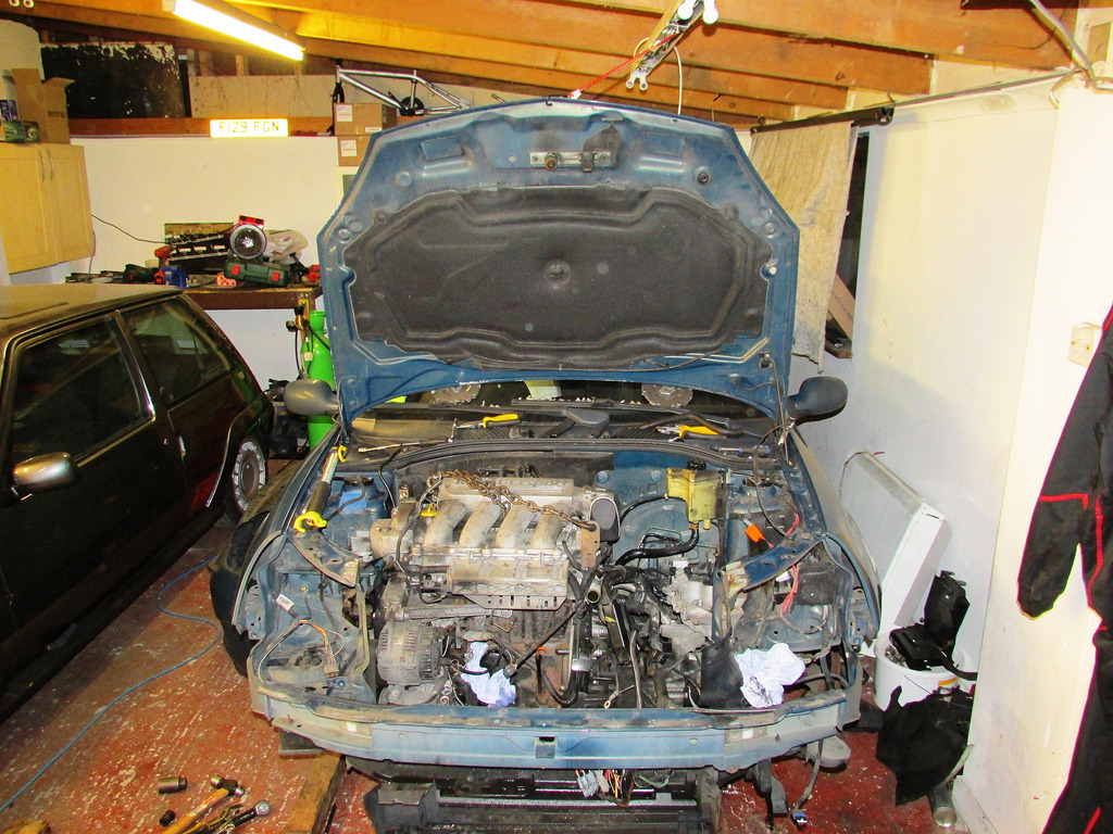

So after 5 weeks of waiting and parts buying the day finally arrives for the Clio to head to the workshop where the supercharger conversion will take place. All the boxes of parts are loaded up this morning, and after a days work I head up to where the Clio will stay for the next 2-3 weeks. Tonight was all about running through how it's going to be, what parts I've bought, what other parts I'll be needing to get it finished. Not much in the way of practical jobs were done this evening, the main thing is the Clio is now in place. The 1st job however was to degas the aircon system, I've now left the Clio in capable hands and hopefully by tomorrow night the engine will be out. I'll be popping up to assist and take photos of the progress. I'm just so glad that's it's finally happening.
. by Ricard o1, on Flickr

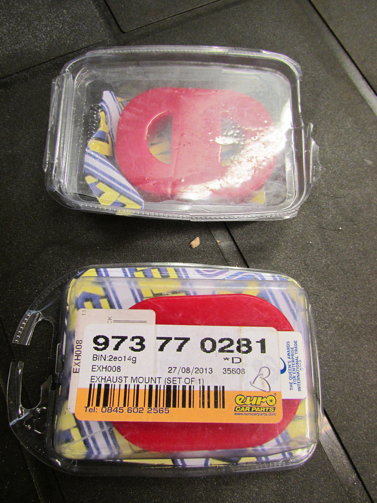

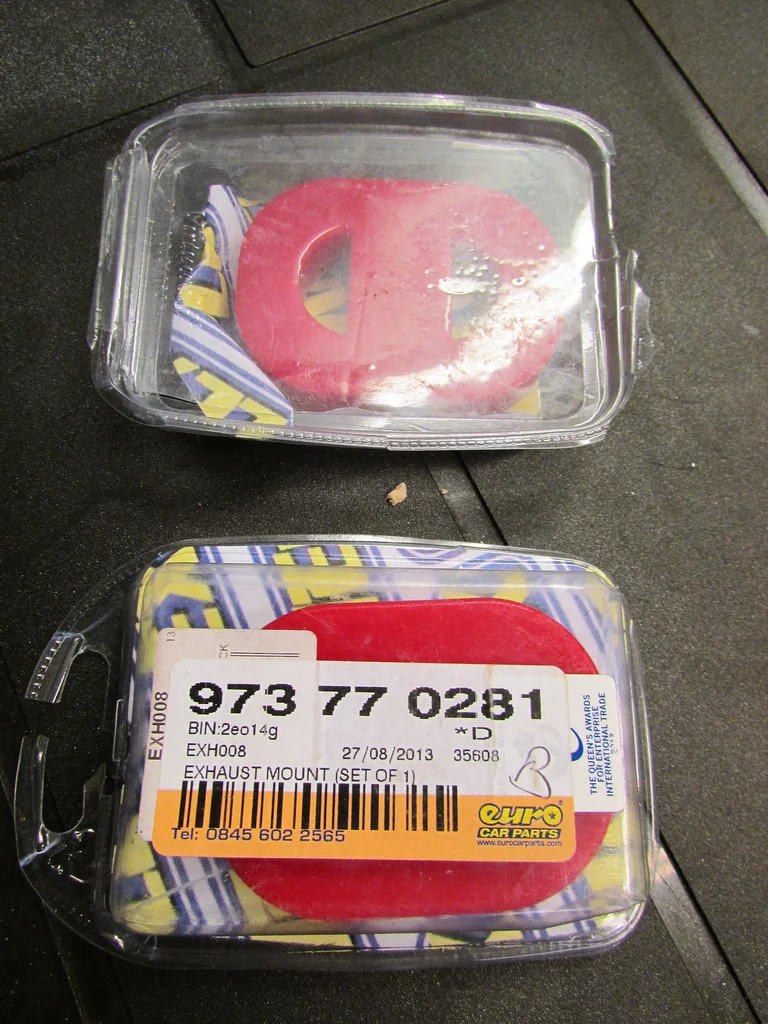

Also bought new uprated exhaust rubbers to replace the tired OE rubbers in the exhaust hangers

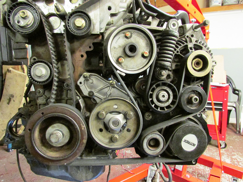

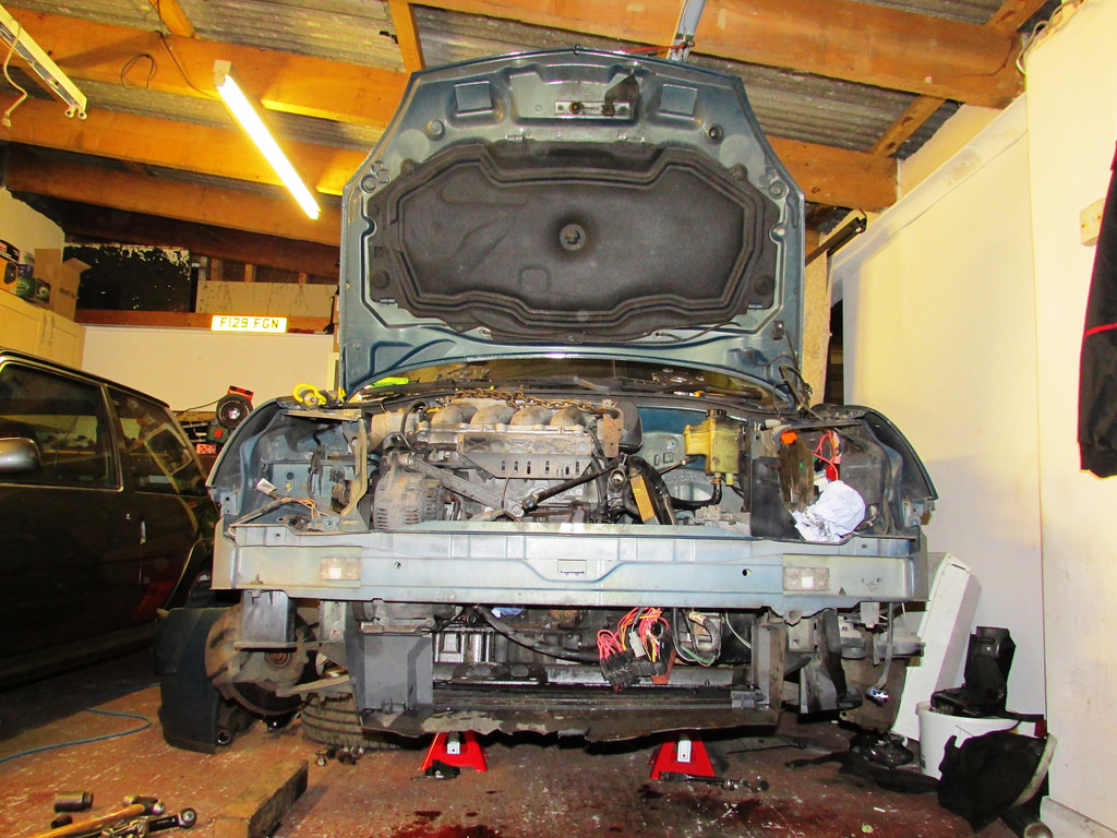

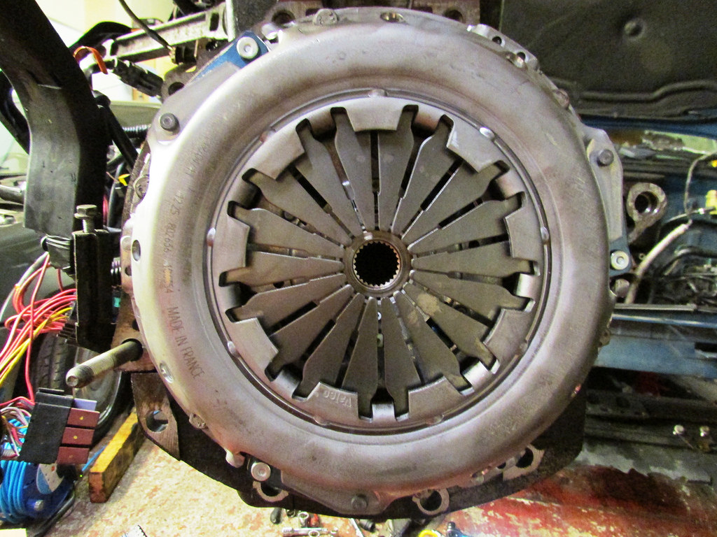

OK, so Monday night the work begins after I leave the workshop. I have someone doing the conversion for me, I'm there to make the coffee and do small jobs while my friend tackles pretty much everything else. Tuesday night the engine is lifted out and Wednesday all the service parts are changed as well as bolting the supercharger into place. Nothing will be done until next Monday, this now gives me time to sort more parts out like the jubilee clips for the Forge coolant hoses, paint some engine parts. I've ordered some Megane 225 spark plugs which I'll pick up from Toomey Renault Southend. Next week the engine goes in and it all gets plumbed back up.
Engine ready to come out

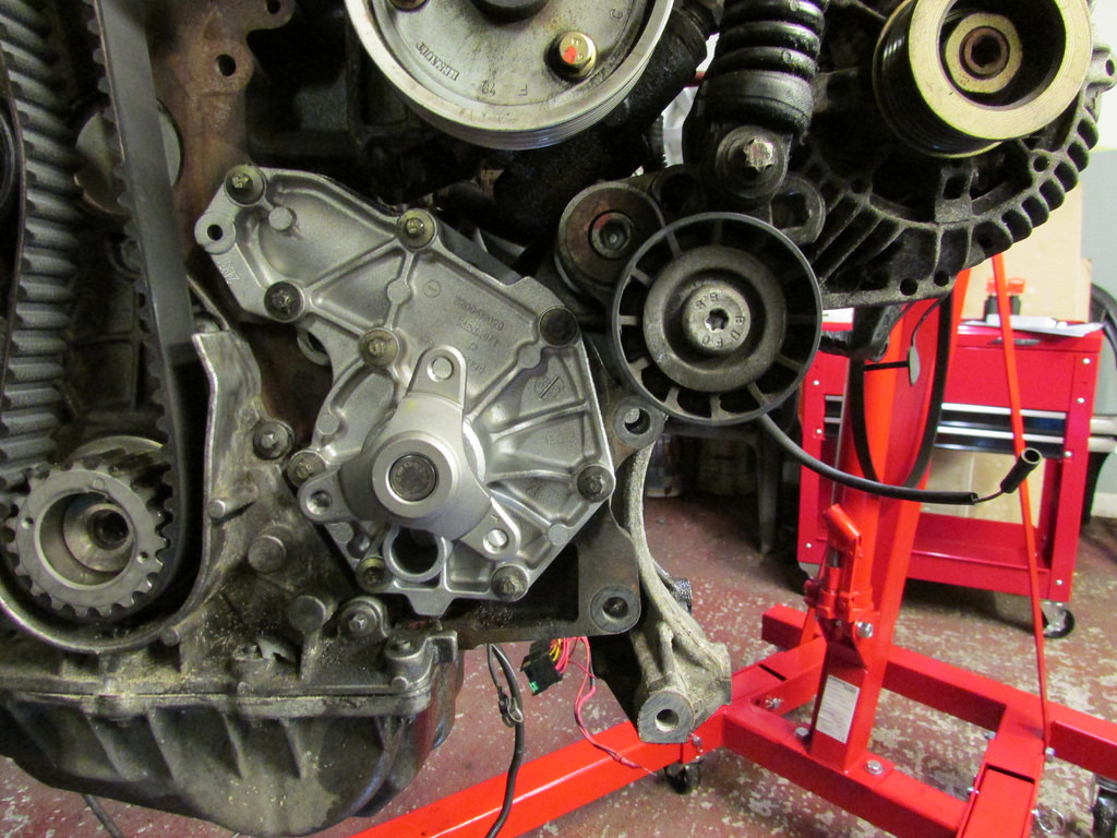

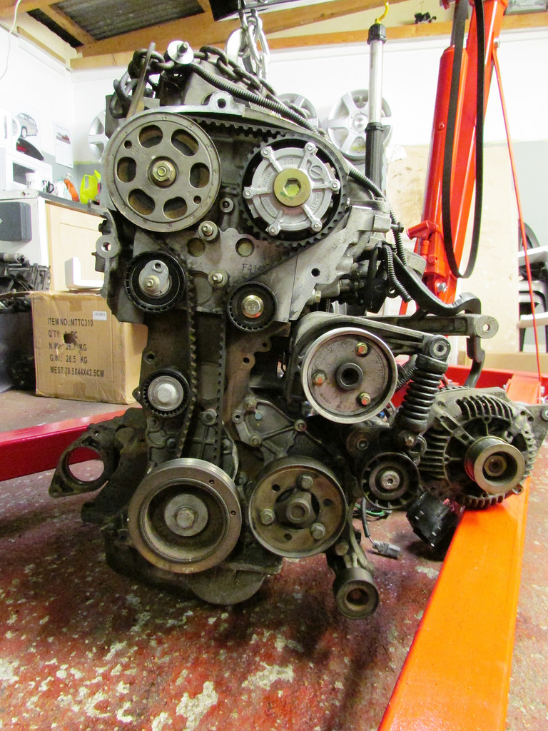

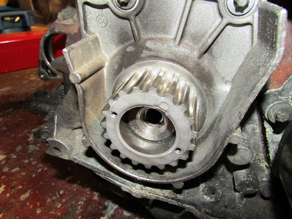

Engine out and showing that the depasher had indeed been fitted along with genuine cambelt and aux belt

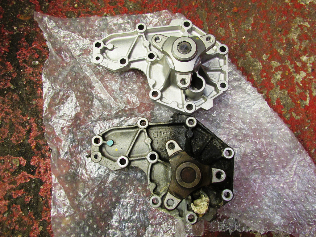

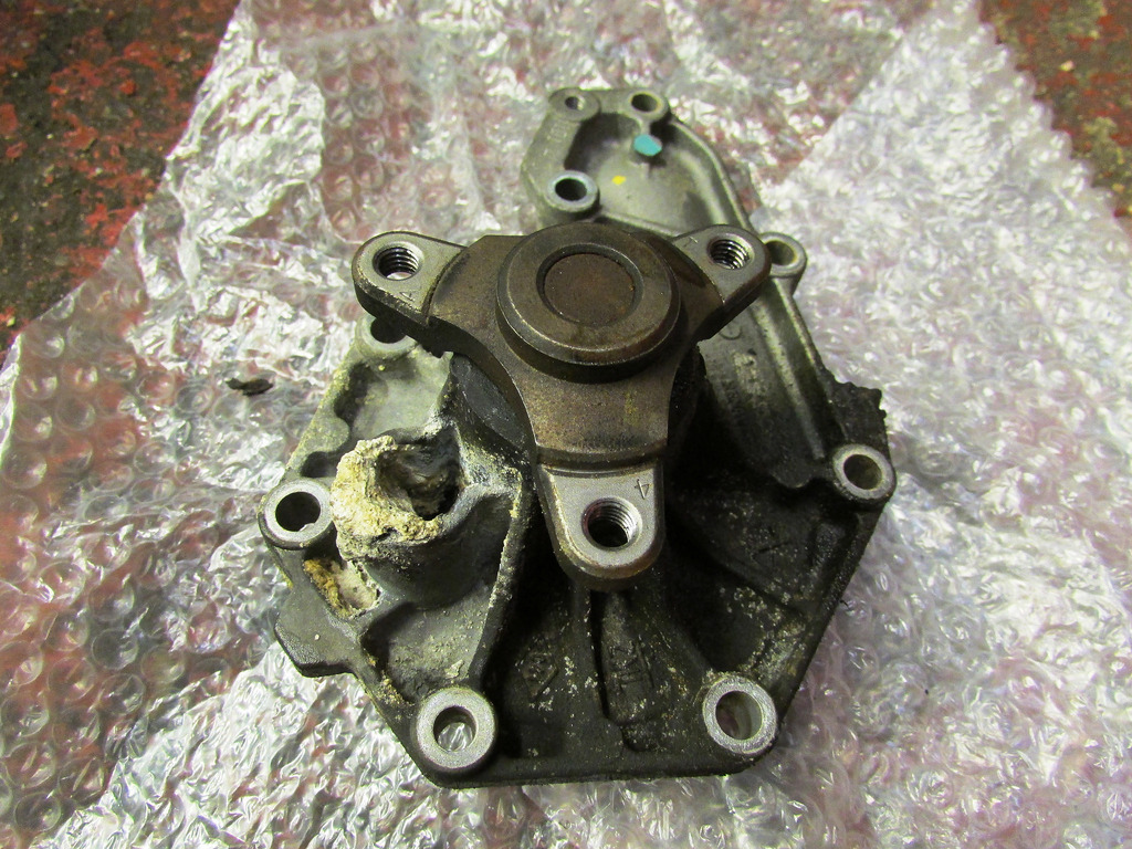

Old waterpump, showing signs of leaking
Old and new, big difference
Gasket cleaned off and ready for new pump

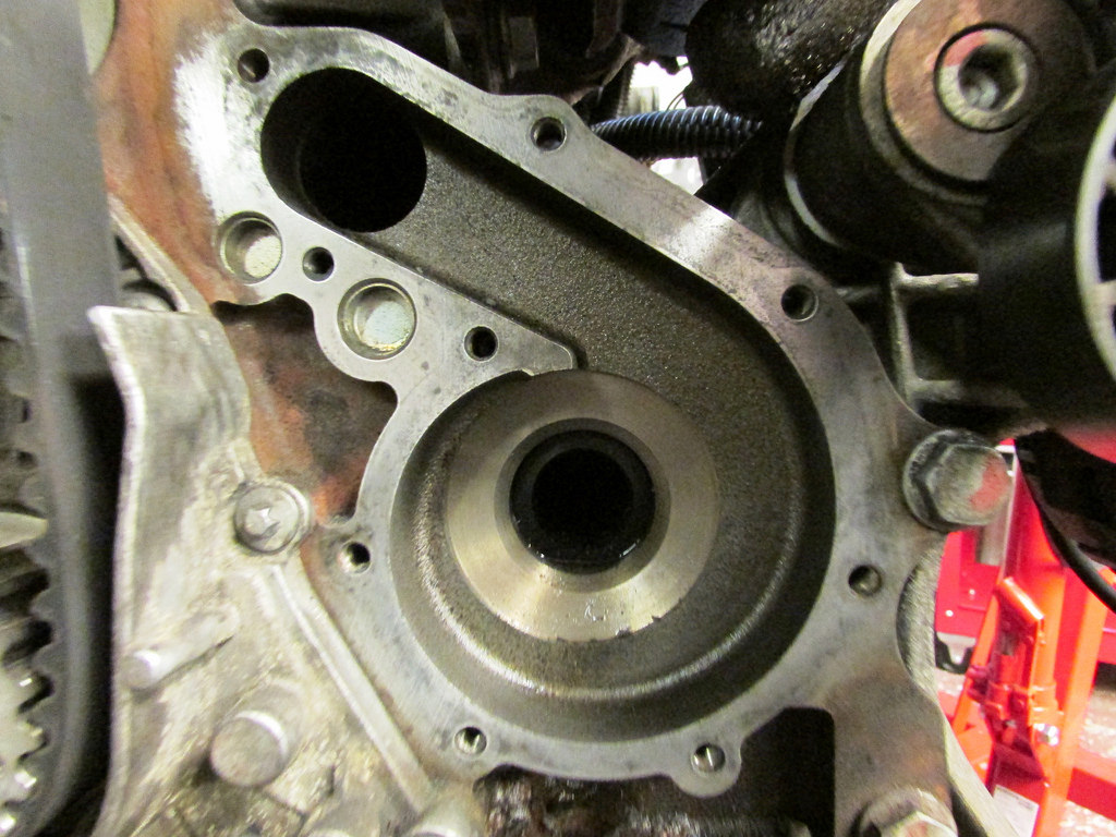

Pump fitted
IMG_1211 by Ricard o1, on Flickr
Megane 225 crank pulley fitted
Valeo clutch fitted

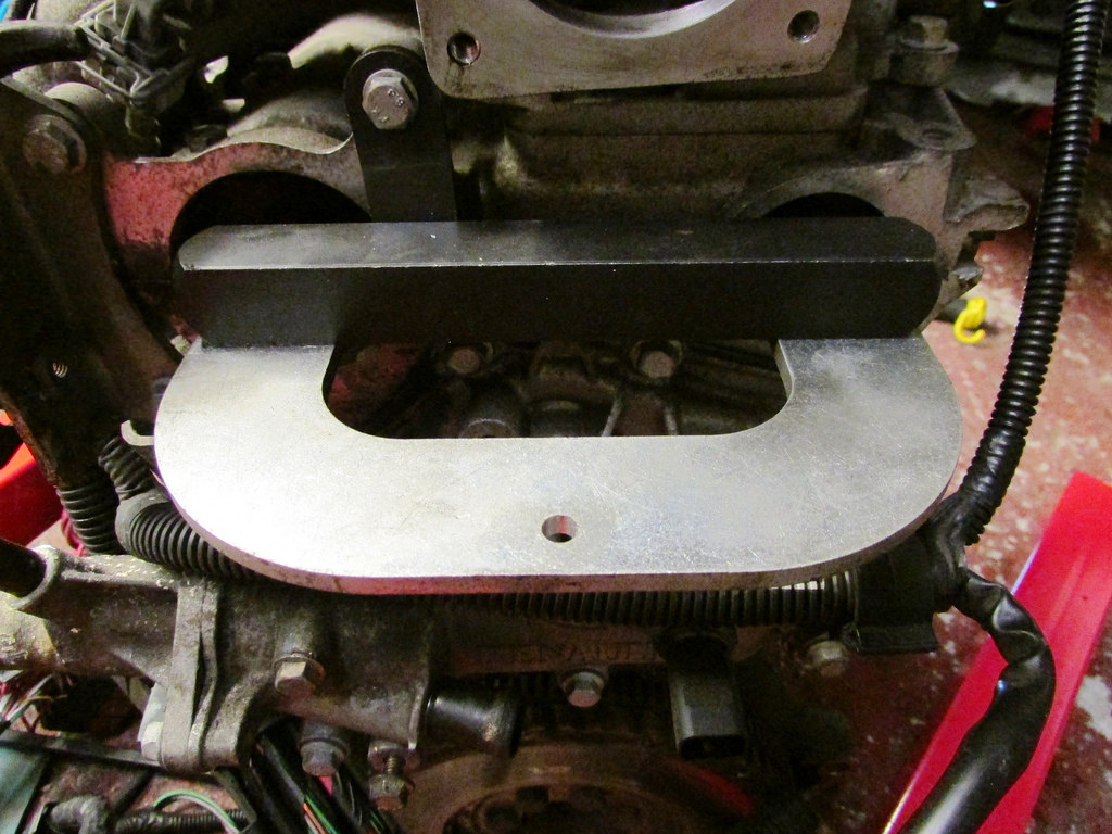

Cams locked

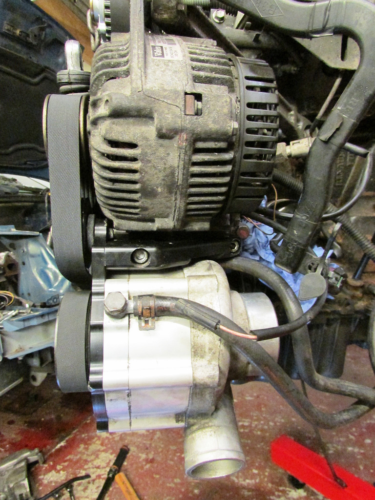

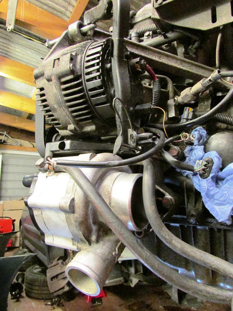

Supercharger bolted up
Aux belt run, camblet and aux belt not fully finished and tensioned

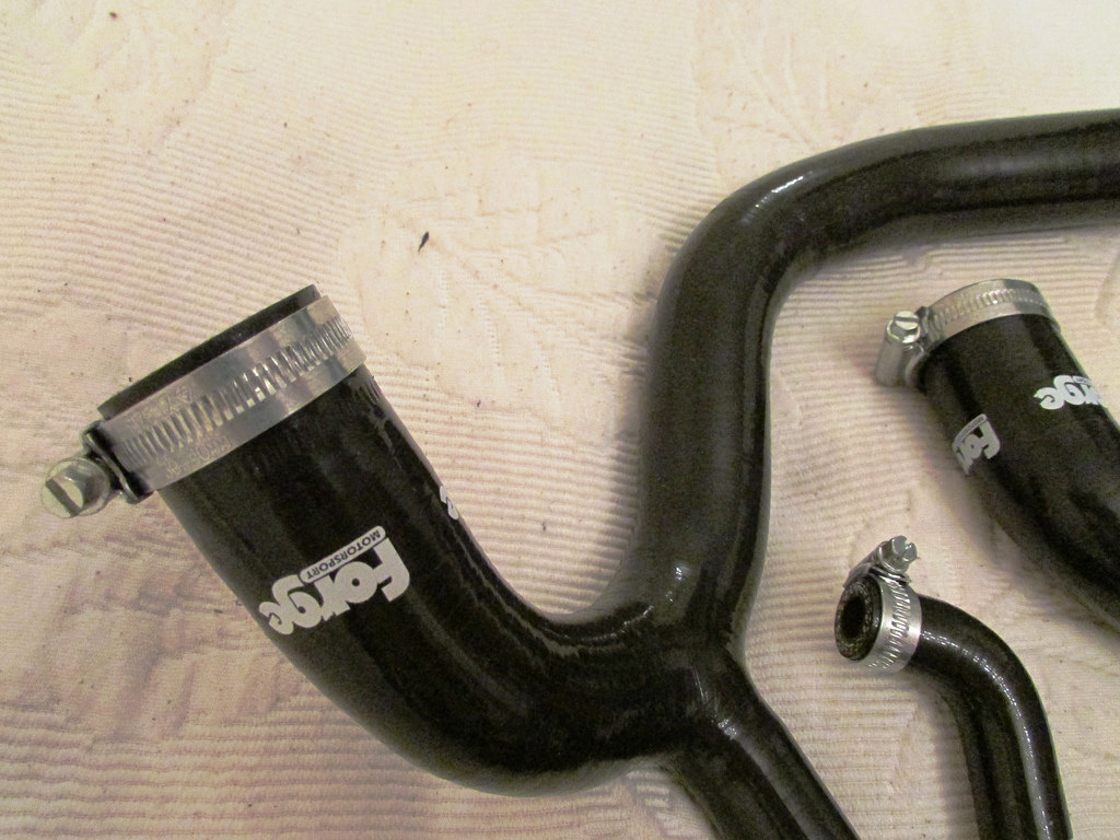

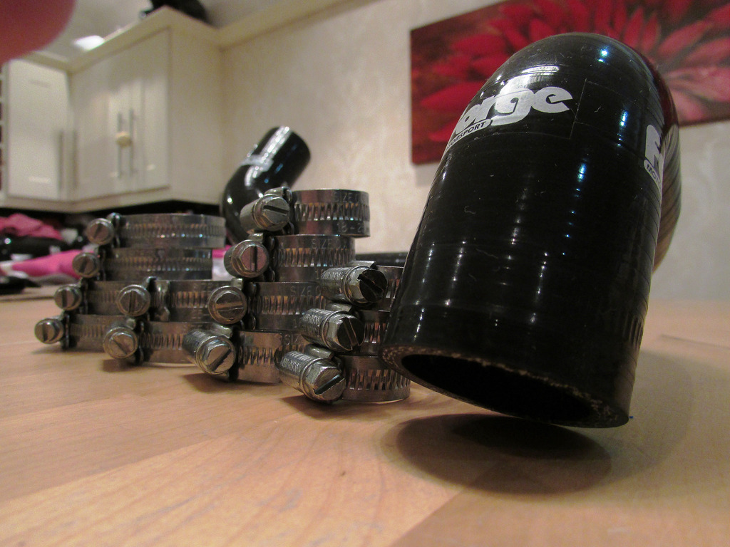

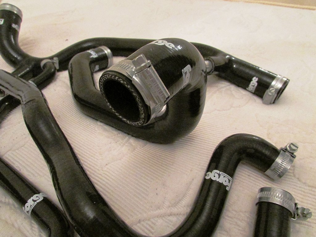

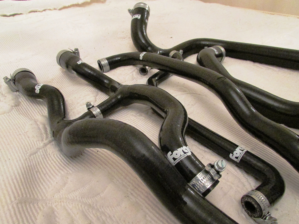

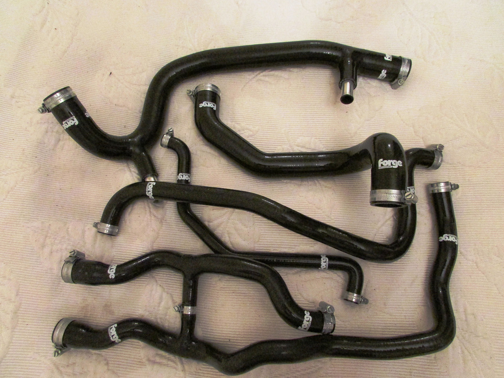

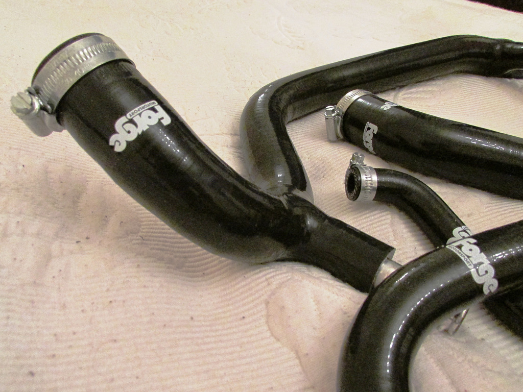

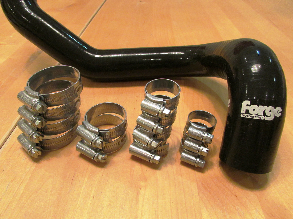

Appreciate the comments so far. I popped into Jewsons builders merchants on the way home to purchase all the jubilee clips for the coolant hoses. Buying the jubilee clips was a job I preferred to do in person rather than over the internet so I could make sure each clip was right for each hose end. I then gave all the hoses a little clean up with hot soapy water and fitted the clips in place. I also sold the K Tec induction kit so that will pay for the new induction filter and hose run.
  A special one.
Nice hoses ;)
Make sure all of the hose clips face the same way when you fit them.
I have a feeling you will. :)
Ricardos
  LY 200 EDC
Nice hoses ;)
Cracking hoses :)
Once they're on the car I'll know which way round they should be, another pet hate is having different clips so I had to make sure today they had every single size there and then in stock otherwise I'd have walked away with out any. At least they're the actual Jubilee clip in name too.
  A special one.
I could tell they where going to be fitted the correct way around.
Great choice on the hose clips. :)
