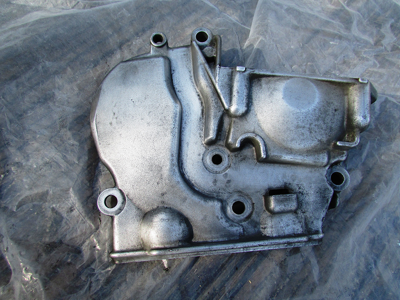

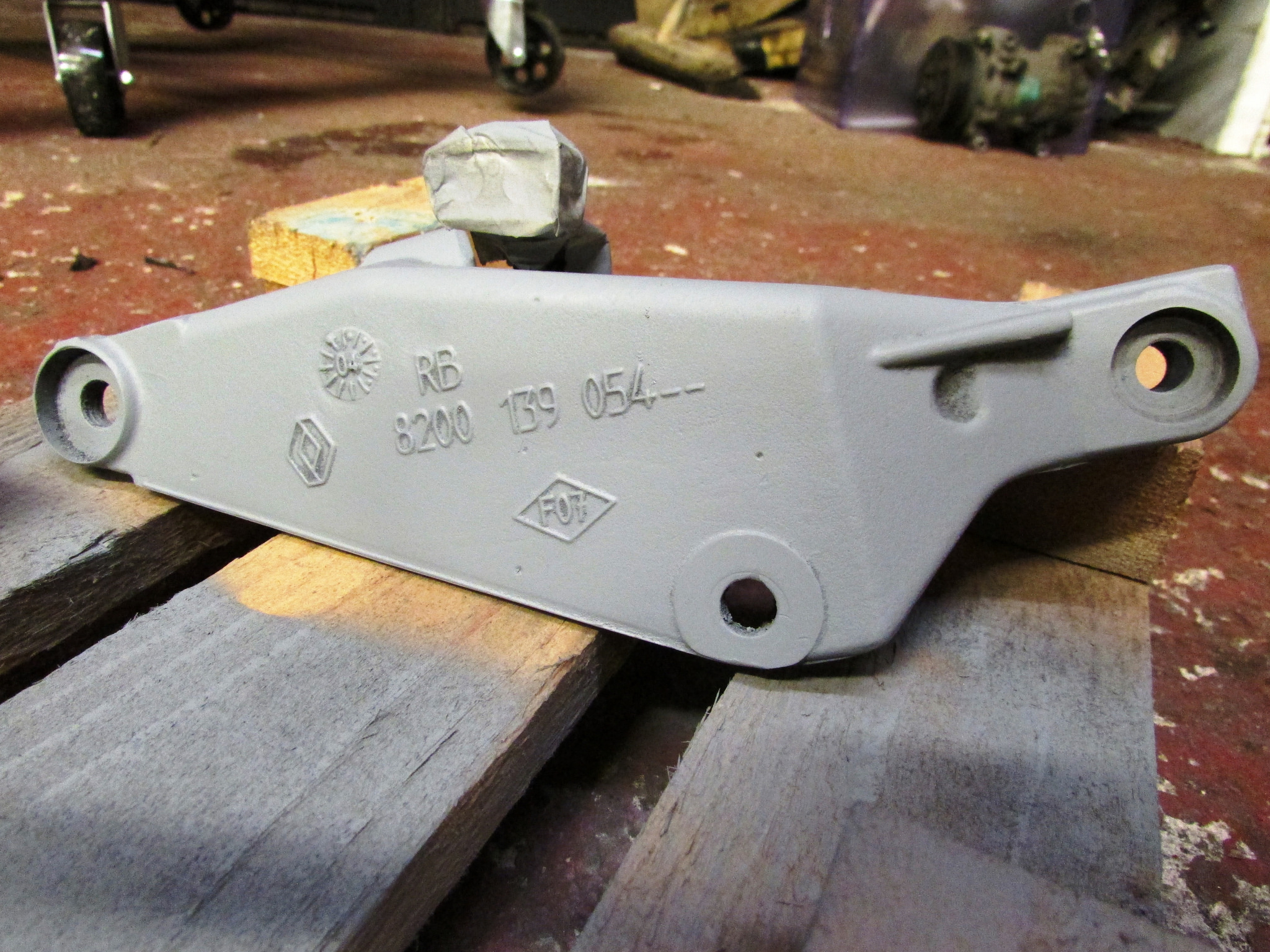

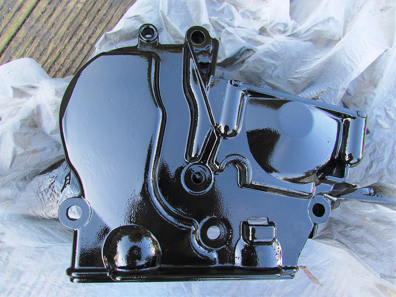

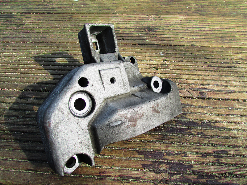

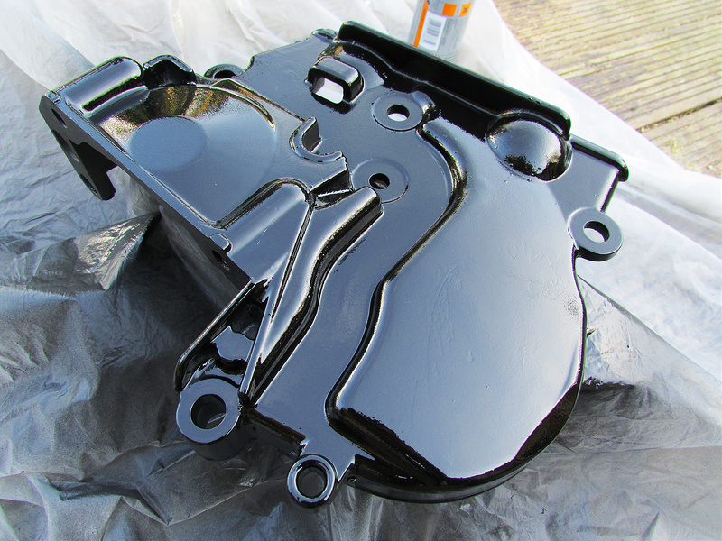

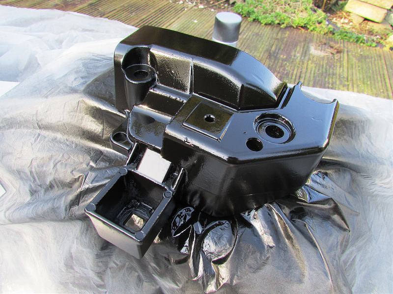

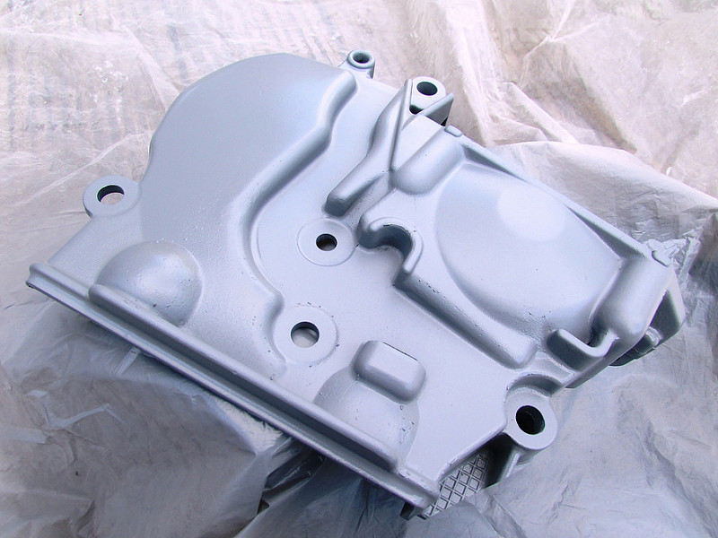

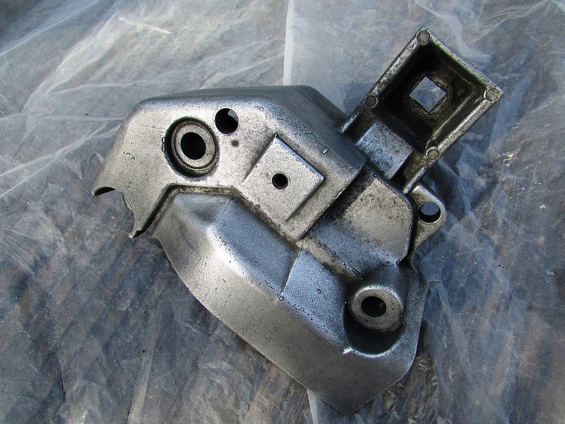

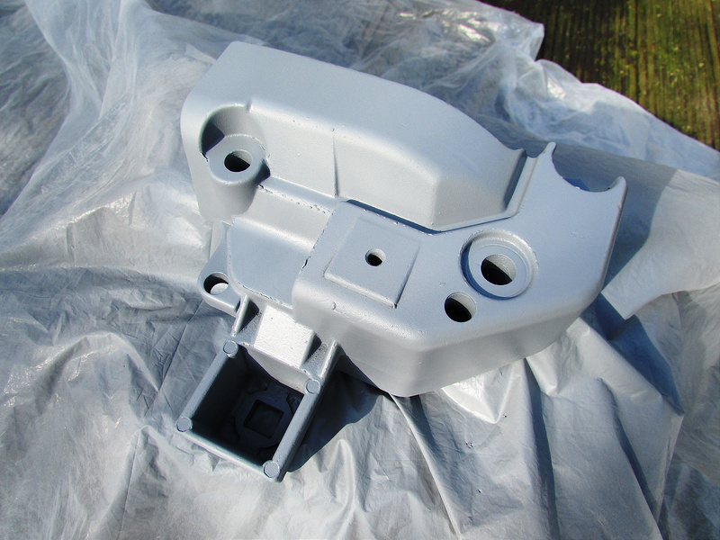

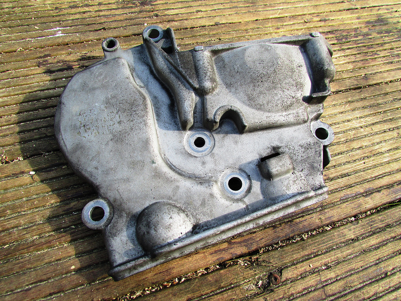

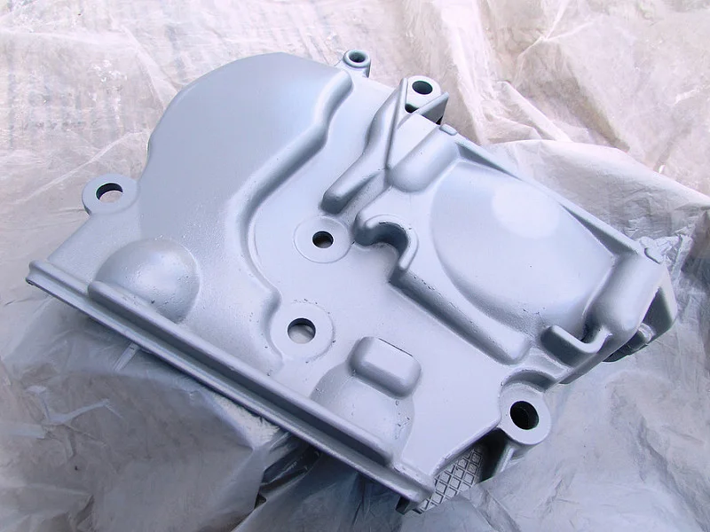

I thought I'd paint a couple of bits as the weather's nice today, it should be enough drying time for when they go back on the engine the early part of next week. I'm also going to paint the rocker cover and inlets in satin black too to match the satin black hard boost pipe and intercooler. It probably won't look exciting but it tidies up the bay a little bit. Rocker and inlets painted Tuesday or Wednesday. Paint finish obviously won't be in the same league as powdercoating but it will do for me.

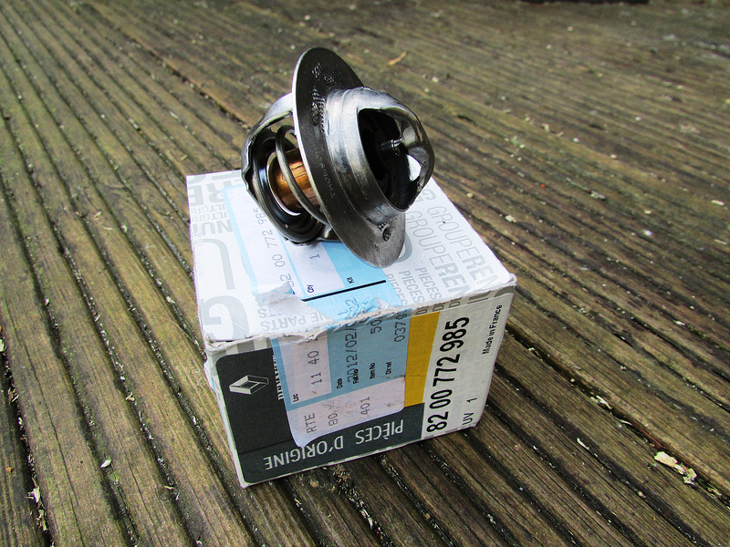

Also while I was in the shed I found a load of bits I can sell to help buy other parts for the project which I'll put up in the classifieds. I also found a new thermostat and O ring which I bought for the RB 182 so I'll fit that on the PB.
. by Ricard o1, on Flickr
Flatted back a little
Primer going on

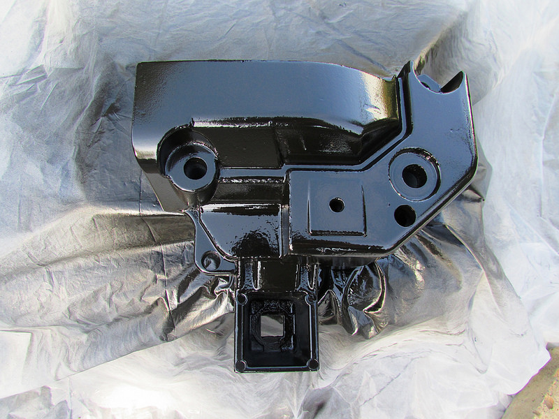

Satin Black going on
New thermostat and O ring
IMG_1253 by Ricard o1, on Flickr

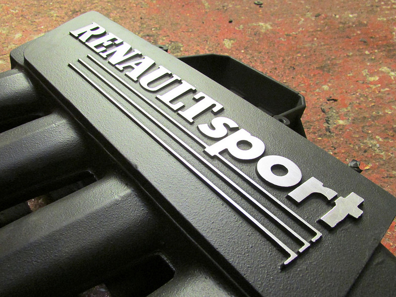

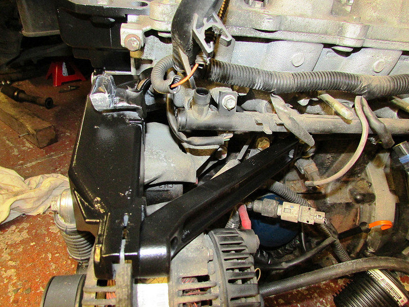

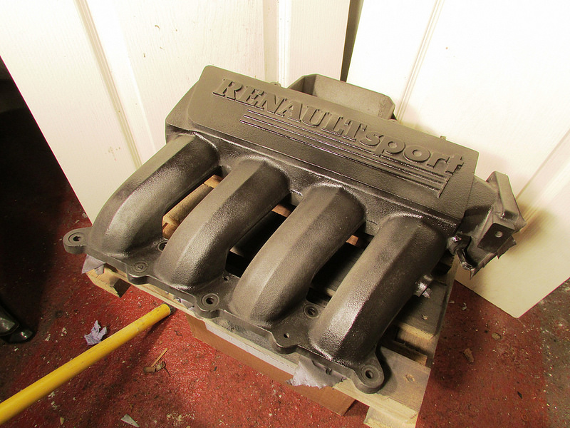

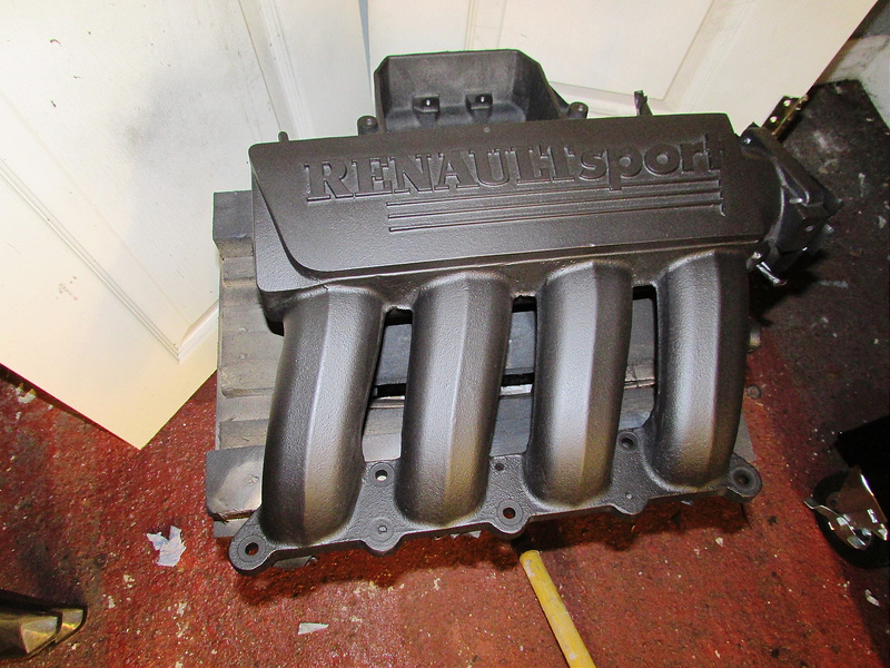

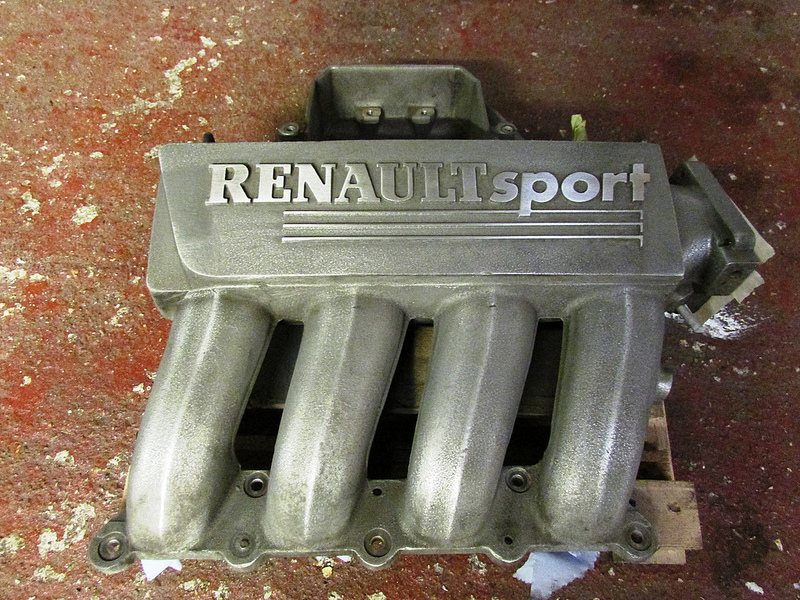

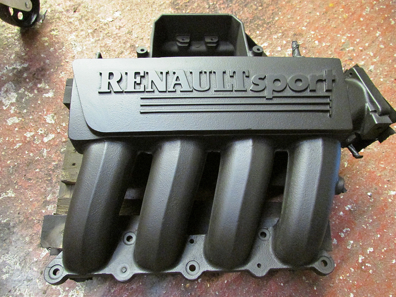

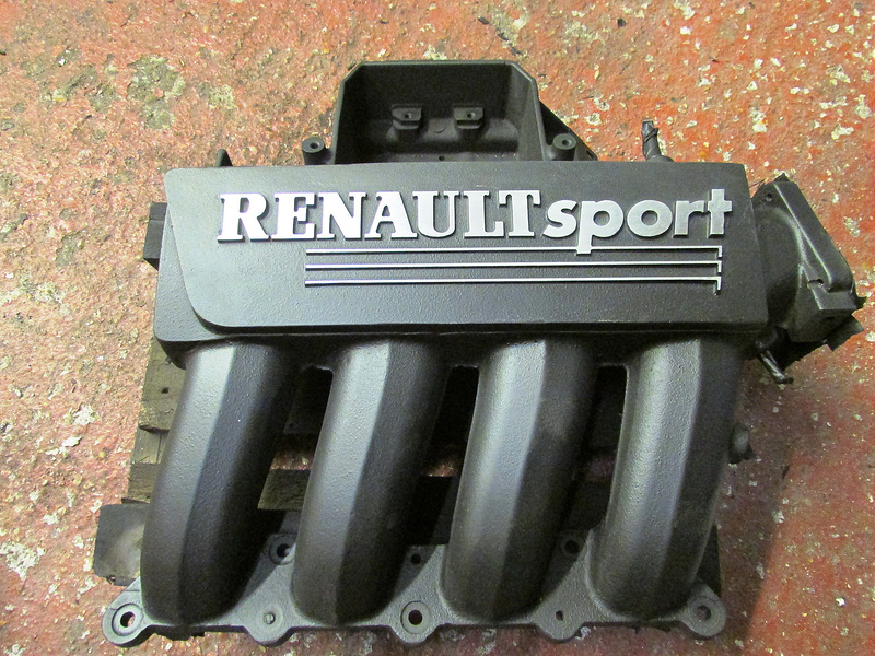

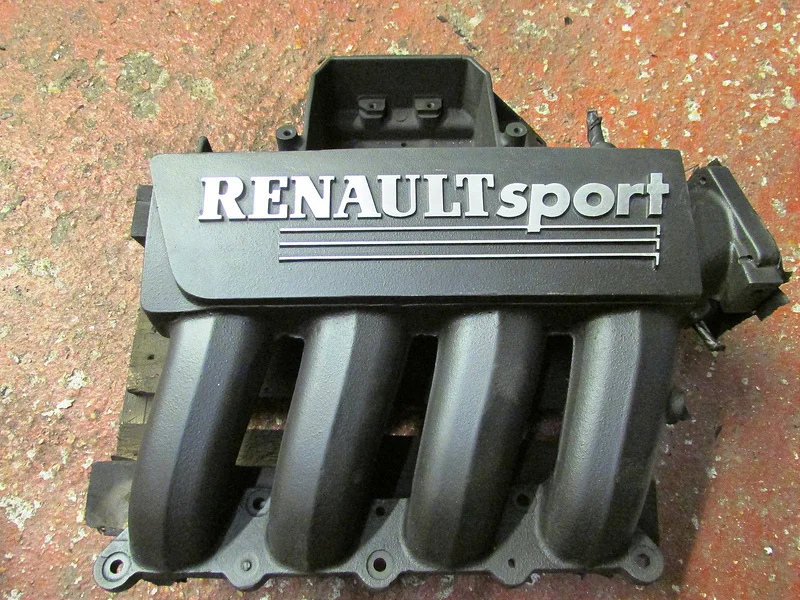

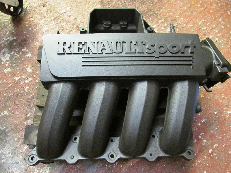

So another evening spent up at the workshop. While the proper work is being done like the engine going back in I'm tucked away in the corner spraying a couple of brackets and the top inlet. A little rub down, primer and satin black on the alternator brackets. The top inlet rubbed down a little then layers of VHT paint sprayed on, nothing exciting but hopefully tidies up the engine bay a little. I've gone with the satin black theme with everything to match the boost pipes and intercooler.
Tonight the engine goes back in, all the mounts back on and driveshafts fitted. It's not a late night tonight, once the engine's in place we're going the to do list along with what parts we're still needing. There's also a basic mock up of how the boost run will go, intercooler position and so on, these won't be fitted until things like the coolant hoses, radiator, ECU, battery etc are in. I'm looking forward to more progress tomorrow night with plenty of pics.
Primer
Brackets in satin black
Rubbed down

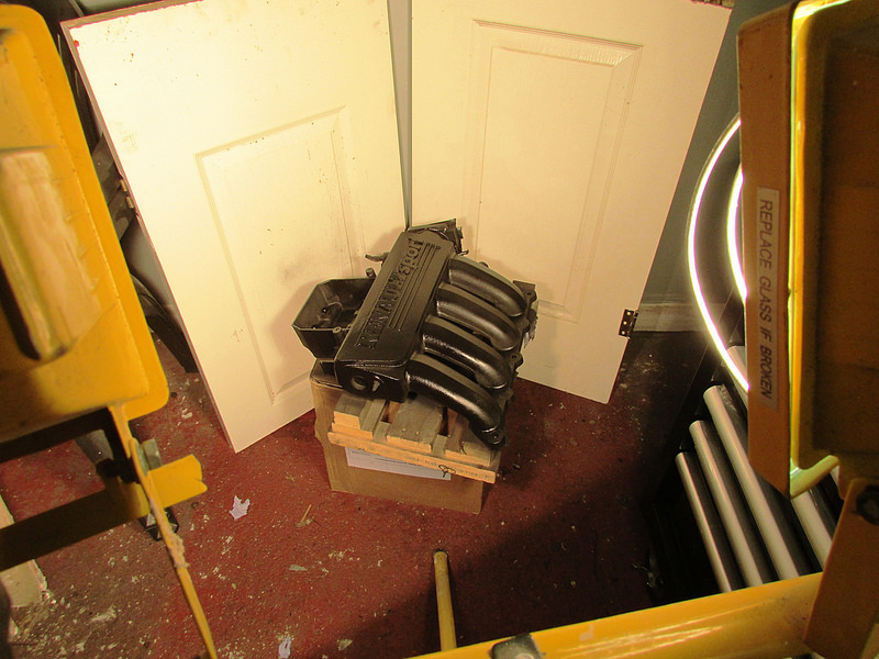

VHT coats applied
Heat from the twin Halogen lights on the inlet
Done and drying

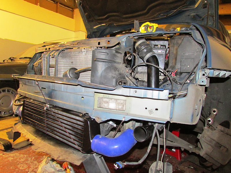

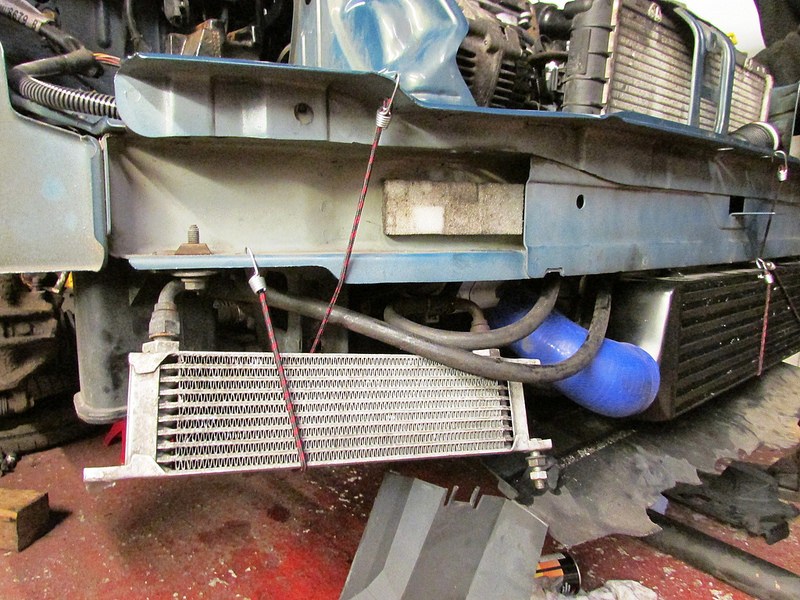

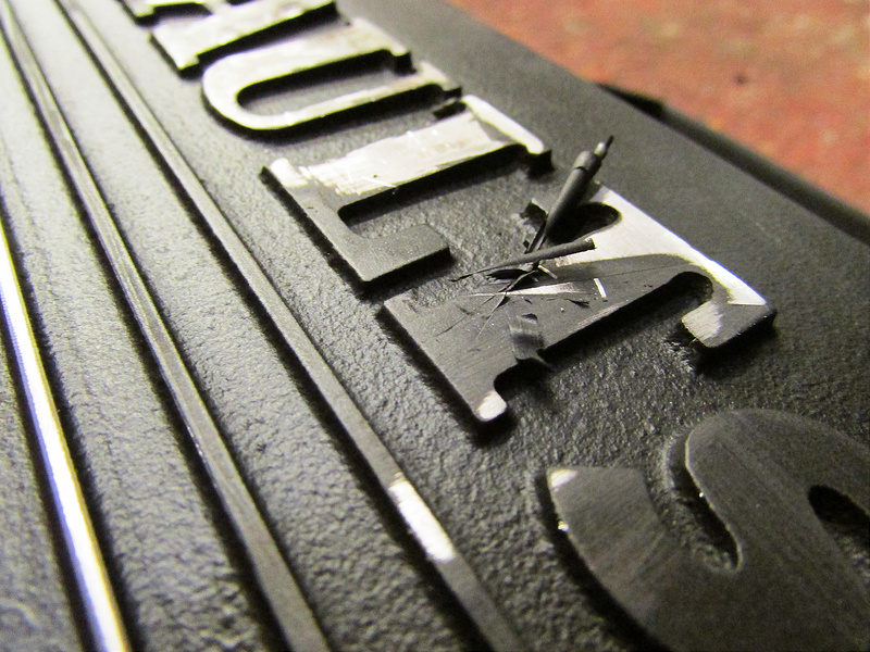

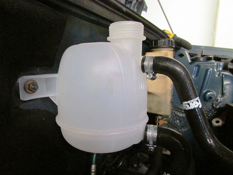

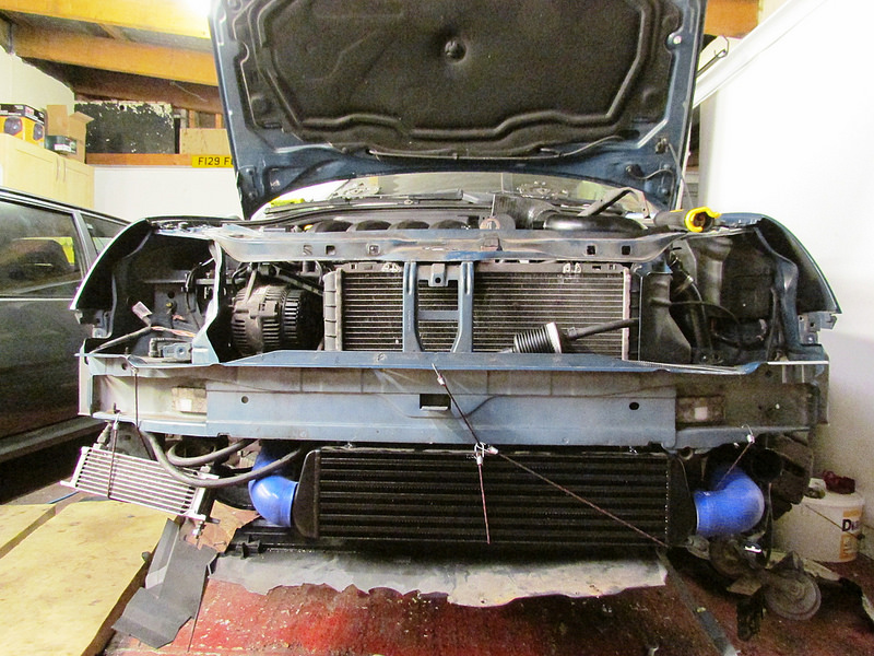

A few more bits done in the time allowed this evening. Coolant hoses on, radiator in. Finished off the top inlet, thought I'd make it look a little different by sanding back the Renaultsport letters back to a half polished effort. Also mocked up the intercooler and pipe run, this should be all done next Monday. Once that's done the headlights and bumper can go back on, it should then resemble something like a Clio again. By the end of next week it should be back on all 4 wheels and rolling. It looks worse than what it is and there's no real graft to do, there's no rush in getting it there.
I now need to source a phase 1 Clio 172 fuel sender unit and fuel lines, I have the phase 1 fuel rail just need everything else.
Blue boost hoses purely for mock up, I have the black hoses just not cut to size yet
Bungee cords holding things in place to get an idea of locations

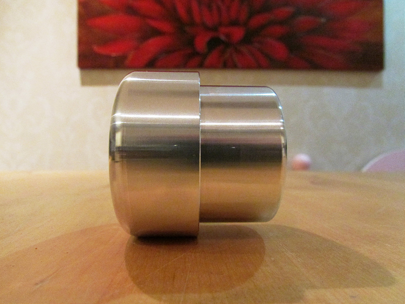

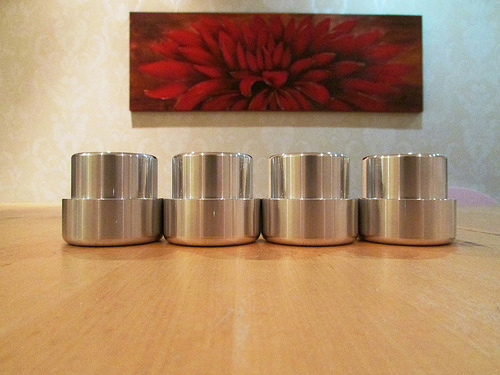

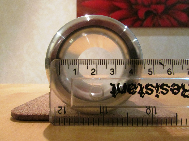

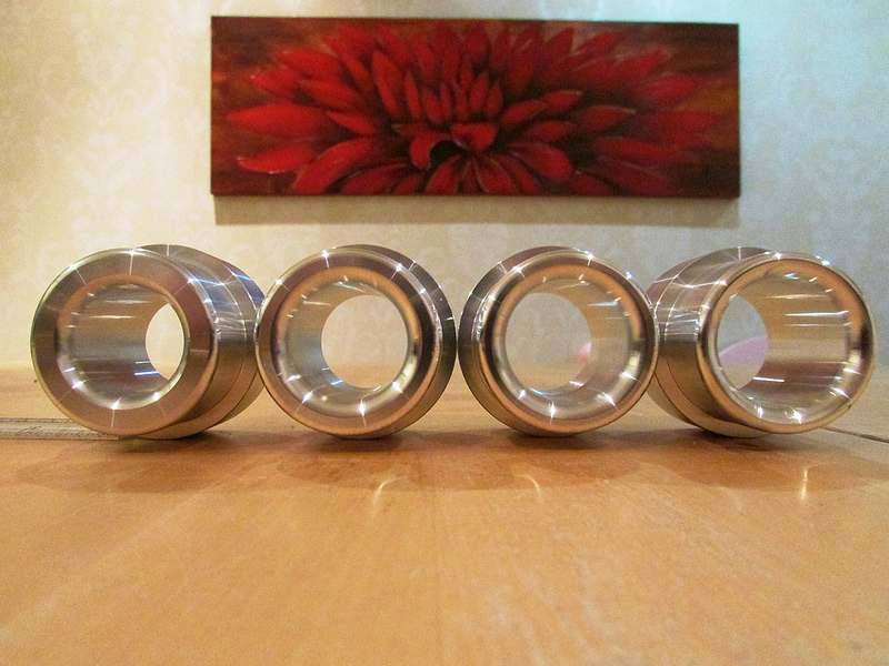

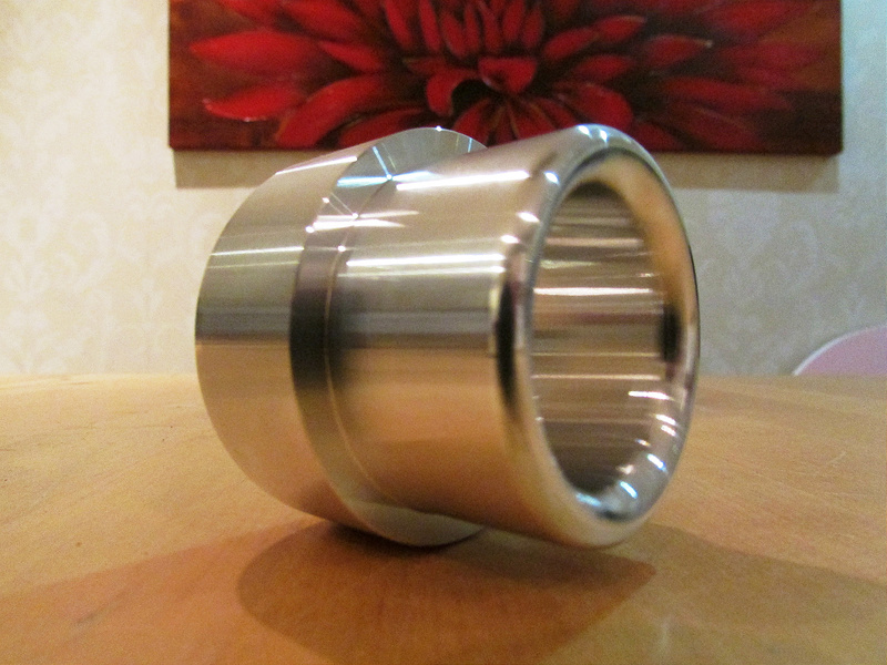

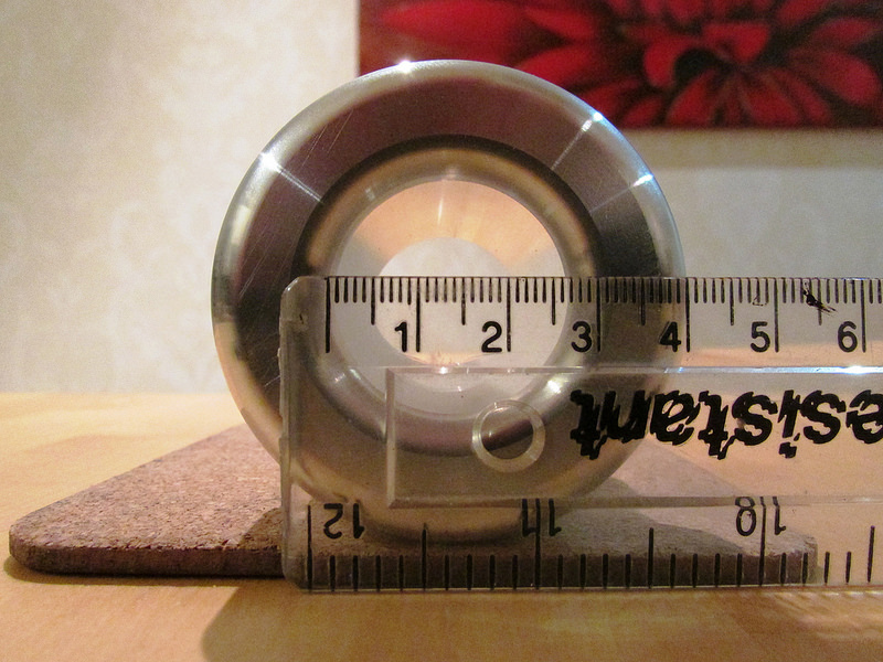

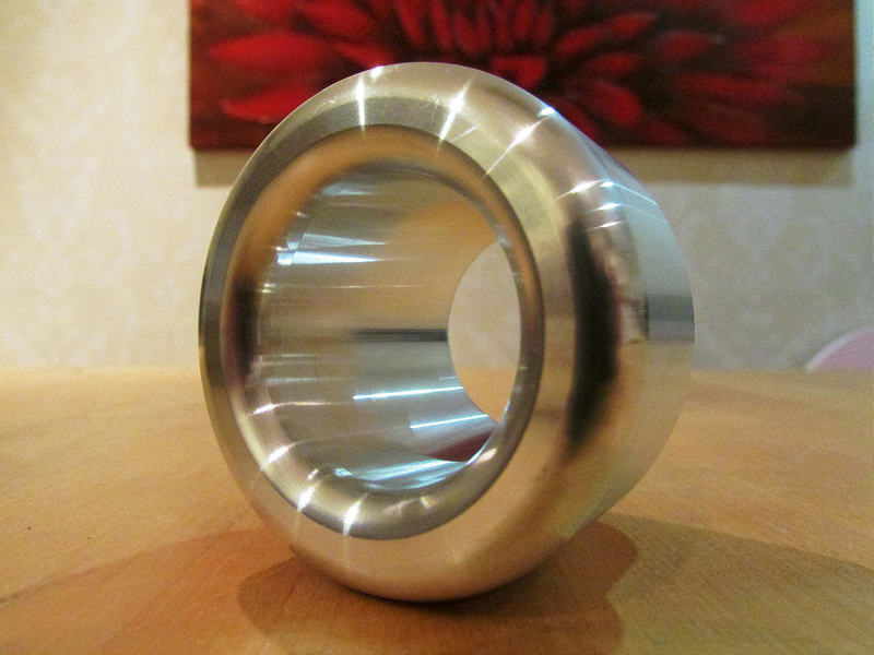

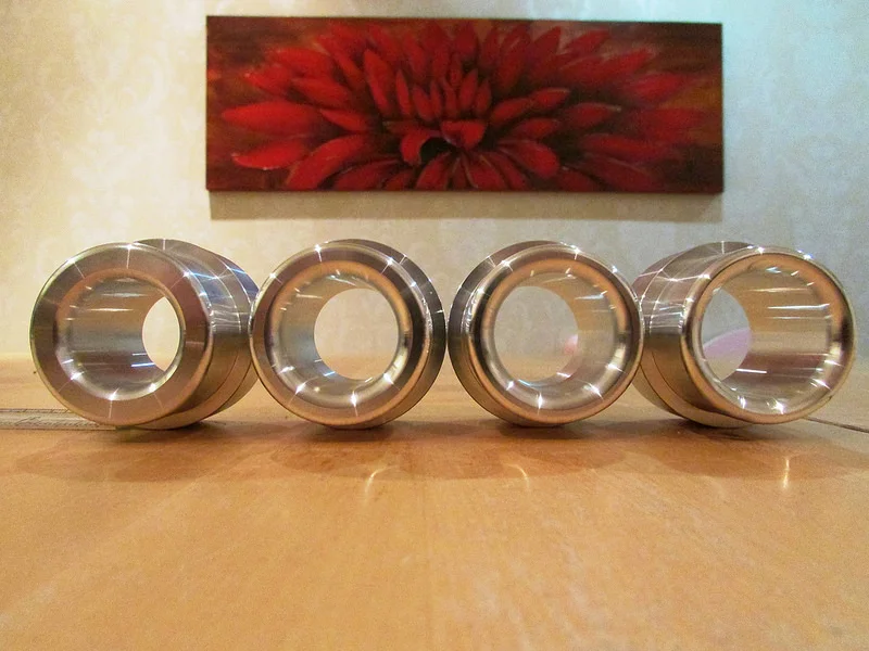

A small update, restrictors.
My understanding of a restrictor is something needed to hold the power at a certain bhp. The restrictor has an internal hole at a certain diameter to achieve the bhp level, the bigger the hole the more power. The other way from what I've been told is to change the pulley size, in this case to create more power it's down to the restrictor internal hole diameter.
I've been Pming Craig as he's running a supercharger as well so he's given me a diameter of hole to work with. What I've done is have 4 restrictors made all with different diameter holes, this will give me scope to get the right power of hopefully 250bhp. I've spoken to Paul at RS Tuning in Leeds and he says 250bhp is achievable on a stock engine so I'm happy with that. So I'll fit the smallest diameter hole restrictor first to see how it goes, then swap them if needed to up the power.
Again when speaking to Paul he said to fit the restrictor after the supercharger and before the intercooler. The restrictor has been made so the small diameter fits inside the intercooler outlet, the bigger diameter is the same size as the silicon hose internal diameter so the silicon hose slides over the restrictor then onto the intercooler outlet. I had a friend draw the design then have an engineering company machine them up.
I have photos and uploaded them to FlickR but they've now changed the way you copy and paste the links to get them on here :rolleyes: and me not being computer know how don't know how to get them on here..
  R5 gtt, R27 F1 team
Looks tidy mate!
i share the thought of different pully sizes though. Now when you restrict the airflow you're basically throwing energy away because of the restrictions. If you would fit a bigger sc pulley the sc will eat less energy from the crank while still being able to provide enough air to the engine. This is way easier to adapt though!
