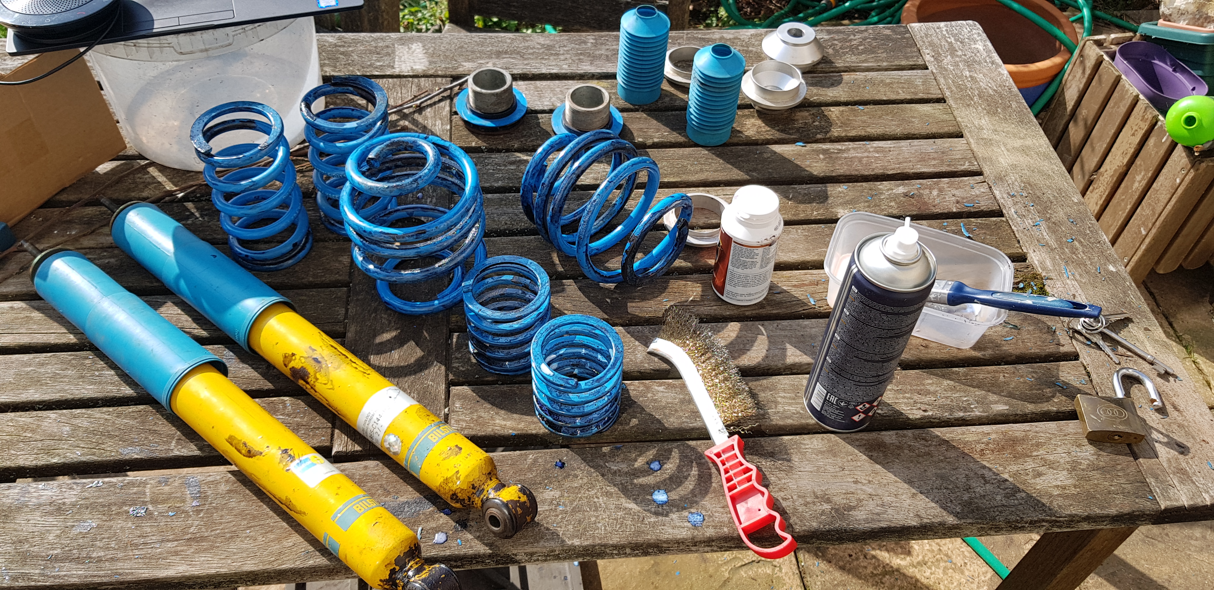

I've just fitted some B14 coilovers to my clio. They're all currently sitting about mid point on the height scale while they settle, which is about 60 cm from the ground to the top center of the wheel arch.
Does anyone have any tried and tested ride heights they recommend? Back higher than the front? Driver's higher than passenger to compensate for fuel and my hairy backside?

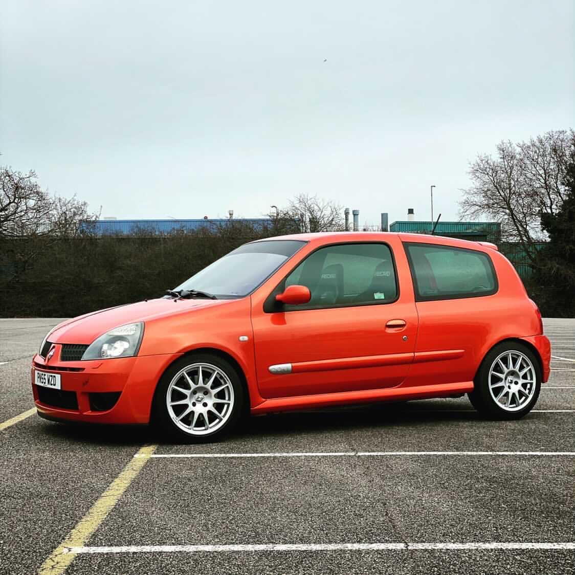

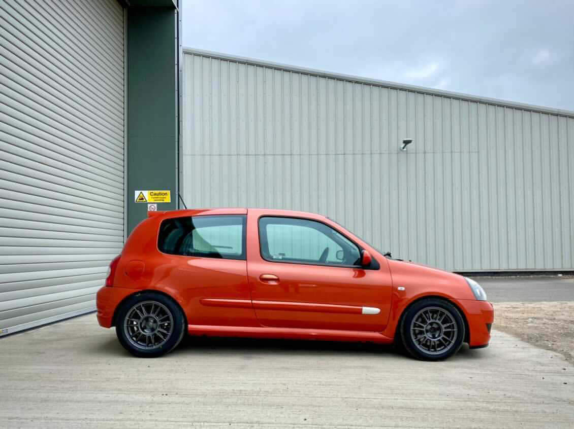

Not sure what my exact heights are without measuring but my front control arms are parallel with the ground and the rear is slightly higher.
i use mine both on road and track and this allows a decent bit of wheel travel still. Ideally it wants corner weighting but I haven’t pulled my finger out to get it done yet.
Not sure if these pics help but you can see it on both 15s and 16s.
