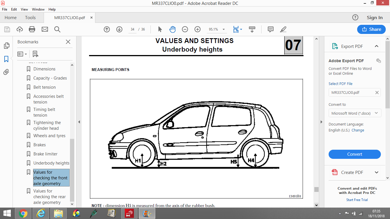

I found this in the manual, should have looked there first!
Seems a strange way to measure height, I assume subtracting the two measurements removes the effect of tyre inflation, but using hub centre to arch does that with a single measurement. Although the position on the arch is always a bit random.
Very useful information thanks @STEVE.M the only thing I can't tell for sure from the chart is the rear H5-H4 value for the 182 it could be either 0mm as per 172 Mk1 or 5mm.
It seems to work out at 5mm, and it appears my car despite the weight loss is pretty much spot on at the rear, but needs lowering at the front.
I now appreciate the measuring method as it gives 'rake' as well as ride heights.
H1 is front ground to hub. Mine is 282mm. This is obviously a fixed value with correctly inflated tyres.
H2 is front ground to subframe. Mine is 180mm. This is the value that varies with ride height setting.
H4 is rear ground to hub. Mine is 287mm
H5 is rear ground to centre of swinging arm bush. Mine is 282mm
There are 3 relevant values:
H1-H2 front height indicator..............should be 118mm..................actual is 102mm
H5-H2 rake indicator...........................should be 118mm..................actual is 102mm
H4-H5 rear height indicator................should be 5mm......................actual is 5mm
So if I lower the front by 16mm H2 will become 164mm, which means:
H1-H2 front height indicator..............should be 118mm..................actual is 118mm
H5-H2 rake indicator...........................should be 118mm..................actual is 118mm
Spot on!
So now I just need the new suspension!
