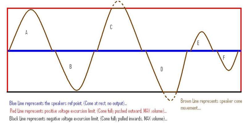

Most importantly you should make sure your amplifier input sensitivity or gain control is set to match your head units pre-out voltage, this will guarantee there is no chance of any 'clipping'....
Clipping kills coils rather quickly....
An amplifier has two voltage rails, one is +ve voltage, the other -ve voltage....
+ve voltage pushes the cone outwards
-ve voltage pulls the cone inwards
Too little gain = lost output
Too much gain = Clipping, Extended period of time at full power, cone motionless and rapid heat build up, heard as distortion... Unhappy amp & Unhappy hot coils
Correctly set gain = Happy amp, Happy coils, full output
