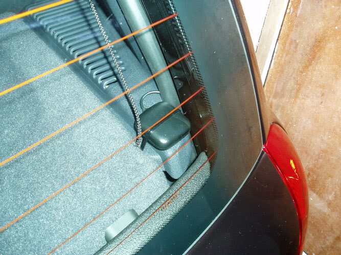

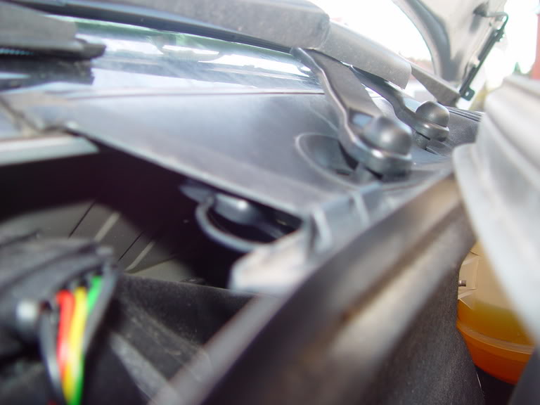

Mine was hit a miss in the centre windscreen square. You need the additonal attenna, this does not mean it needs to be outside the car. The 3 meter one can be put under the wiper scuttle panel, or in the rear quarter light window. Myself - a 5 meter one on the ledge next to the parcel shelf through the rear window.

Mine was fine some days in the screen other days never ever would find signal, and always feel out of signal on the move. To get it to work it was almost on the dash meaning the Laser sensor would be no use either.
10 min job to fit - cable is pushed behind the dash in the gap between the screen and dashboard with a credit card, then down the side of the dash, (hardly visable) then put behind the door rubber all the way down and along the sill, under the flap of plastic on the floor by the rear quarter panel trim into the boot. The Antenna is then Zip iied onto the plastic trim.
To do this you need to ask Blackspot for the 5m cable, 3m is sent be default but will only reach the rear quarter light glass. 5m is the same price.
No fitted start up is instant most days, no signal loss on the move, works aswell as it did in non UV screen cars.
