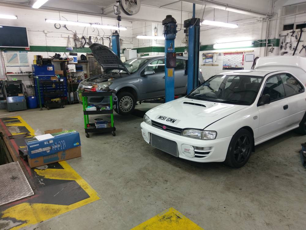

Random photo after making the paintwork white again! [emoji23]
Turned around whilst locking up the workshop, and thought it looked pretty smart.
Sent from my HTC 10 using Tapatalk

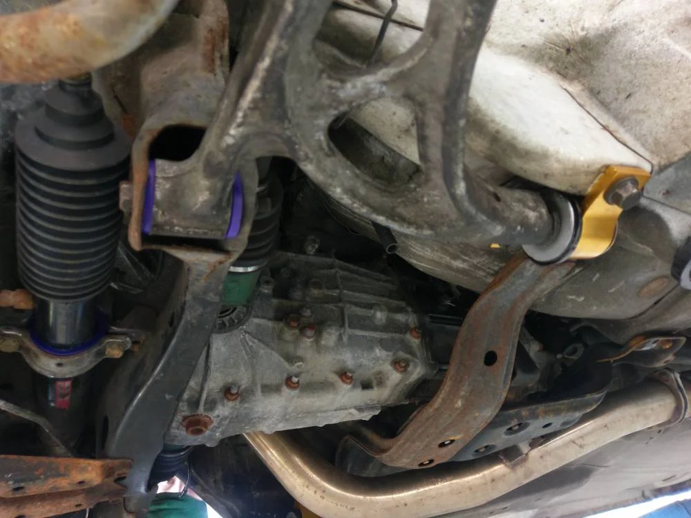

*Update*

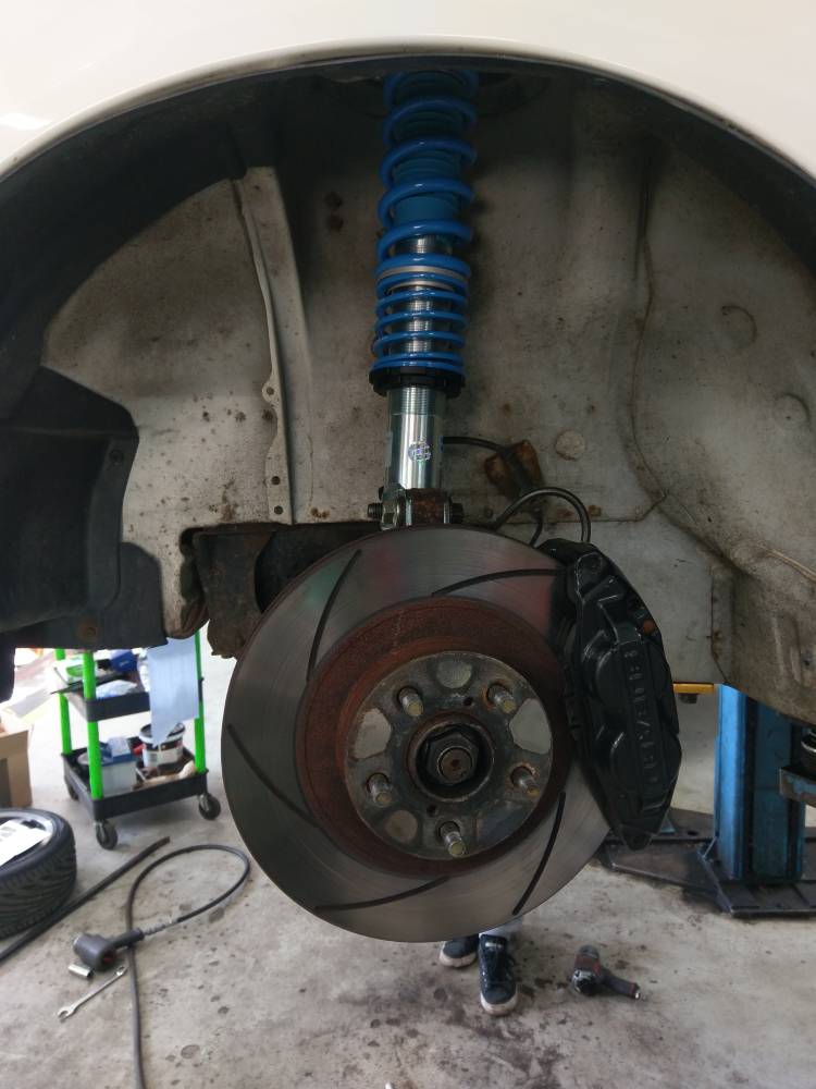

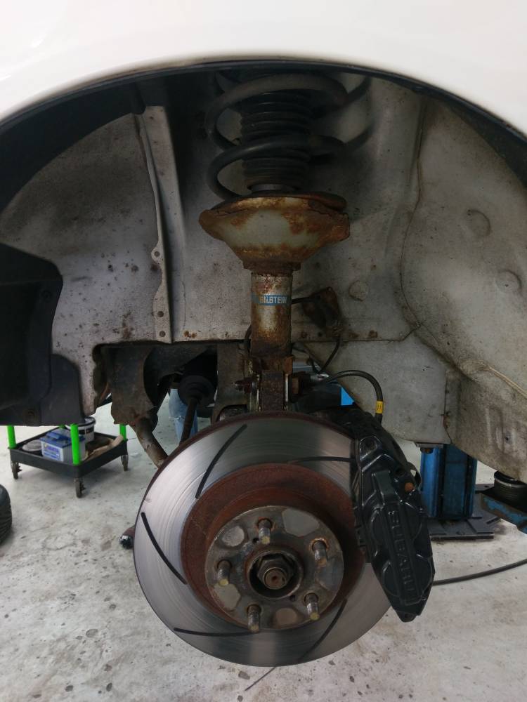

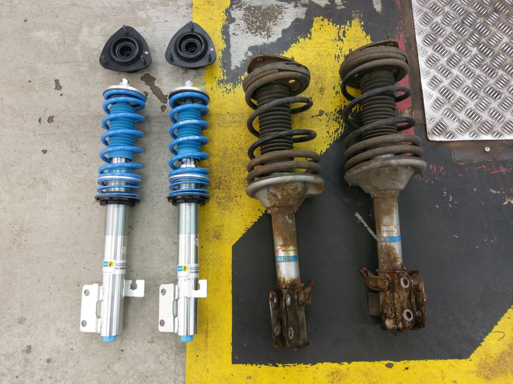

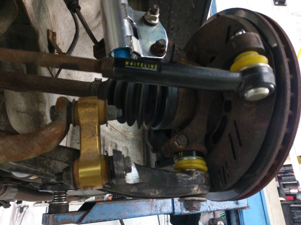

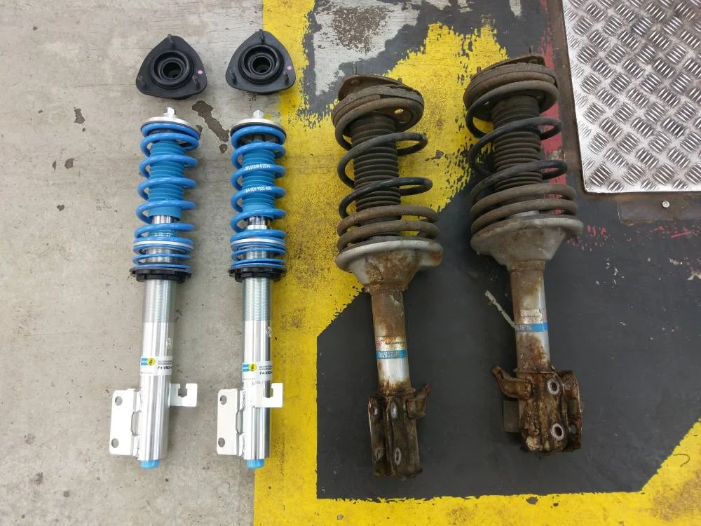

So last Sunday, me and a couple of mates tackled more suspension work, and managed to get a fair bit done!
* Bilstien B16's and STI group N top mounts fitted
* Powerflex camber bolts front and rear
* Whiteline anti lift kit fitted
* Whiteline bump steer kit fitted
Followed up by a tracking session to set things up after all those changes.
It all went really smoothly, and the only issue we came up against was not realising we had to reuse a little tapered washer that sits underneath the front top mounts... This caused the front end to knock like crazy, and we had to remove both the front struts to rectify it! [emoji30]
I managed to get a few pics whilst we were working on the car, but haven't got any of the finished product! (I'll take some later)
Safe to say that the car looks much more purposeful at its new height, and the handling is incredible! Granted I've only driven it on the road so far but the turn in is fantastic! It feels like a much newer and agile car, I'm over the moon!

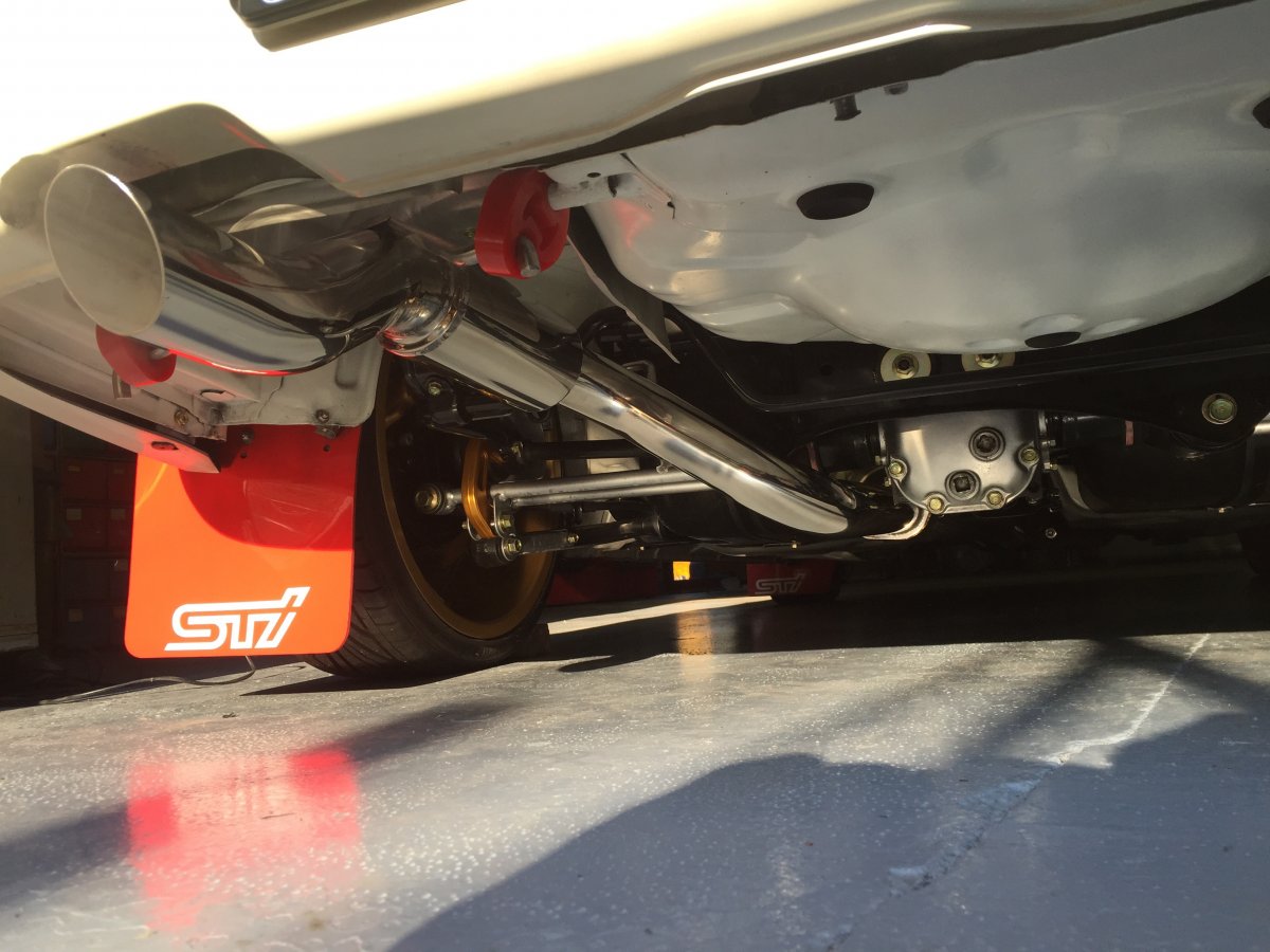

I've been suffering with a horrendous rattle from my exhaust for quite a while, and have ignored it because it's been so far down the list of priorities, but on the Sunday we fixed it! Great you must say!?
Well yes and no... The exhaust noise has gone, but it's revealed another, and further investigation has confirmed my rear differential is whining like f**k! [emoji23]

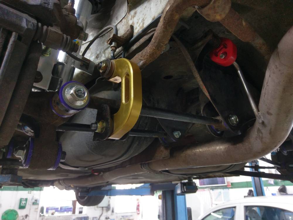

With the diff removed and currently at the specialist awaiting his diagnosis... :sweat:

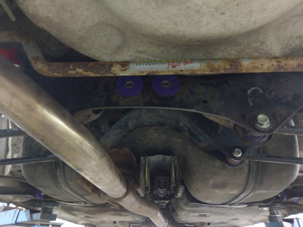

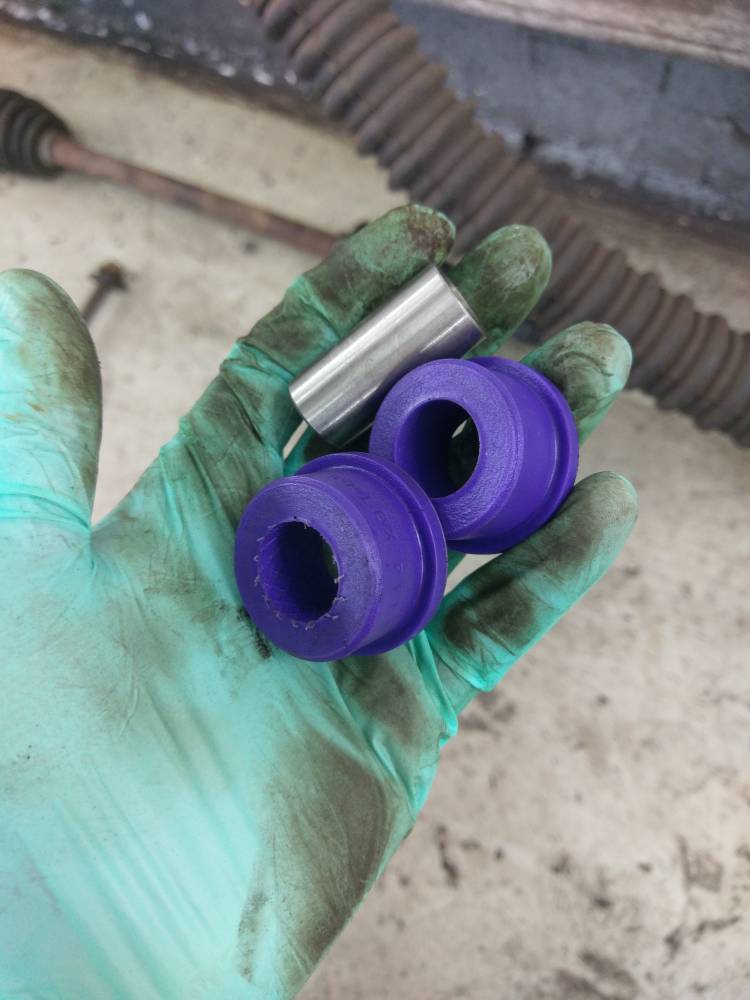

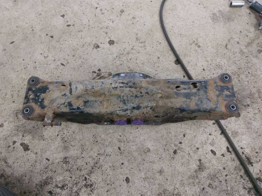

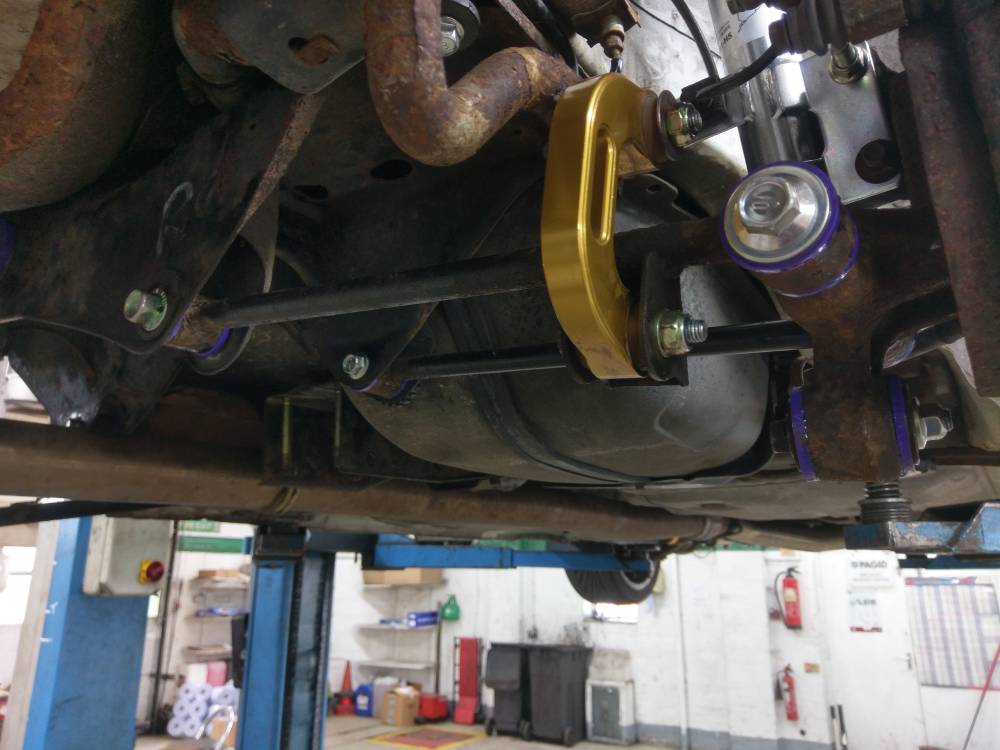

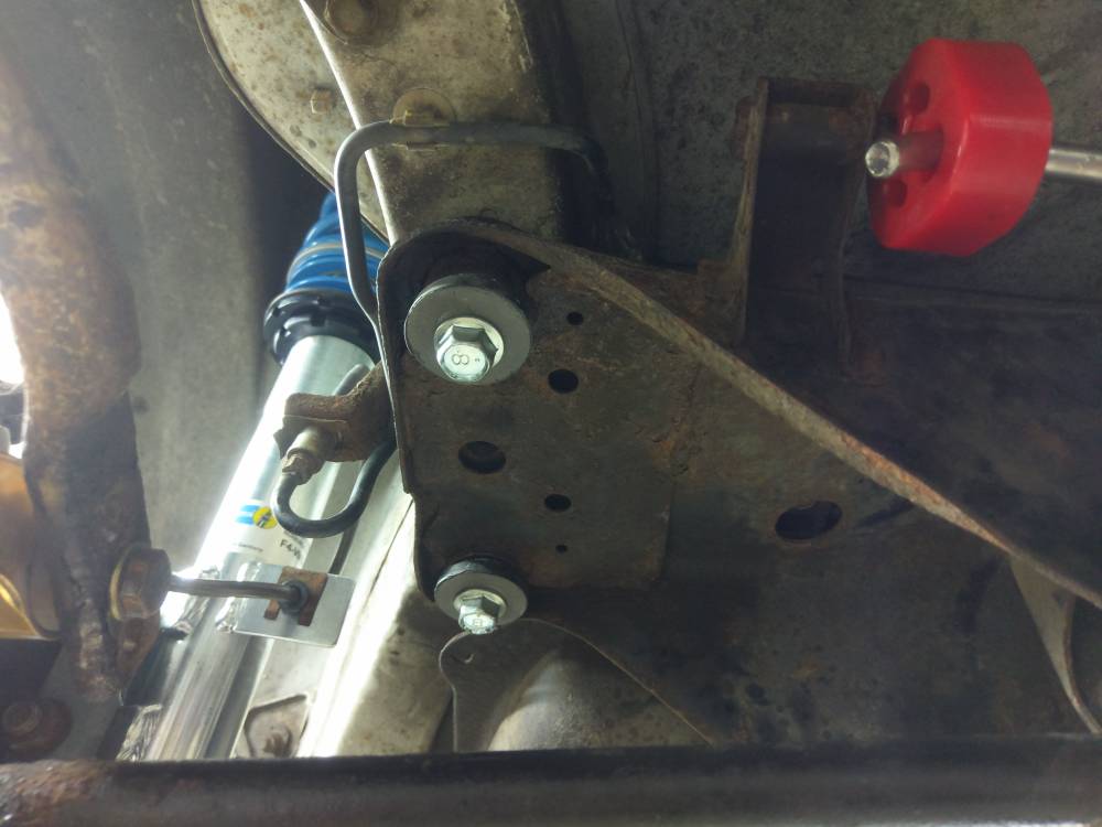

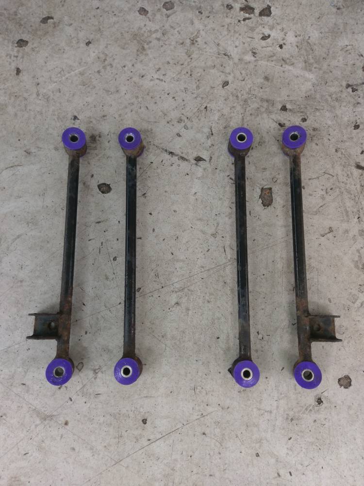

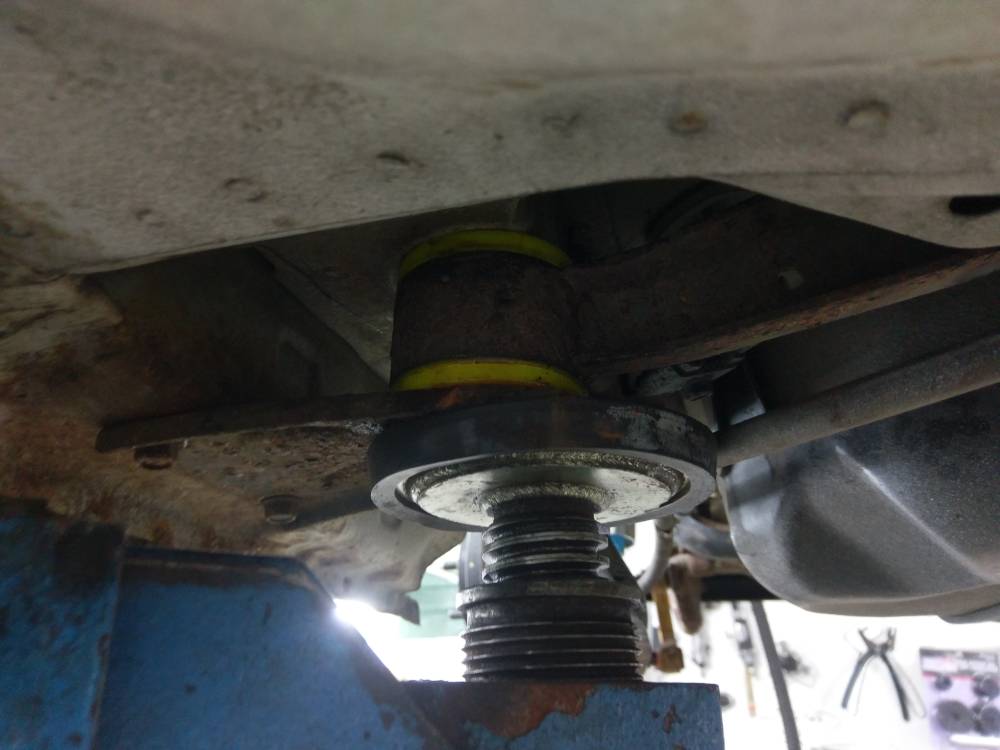

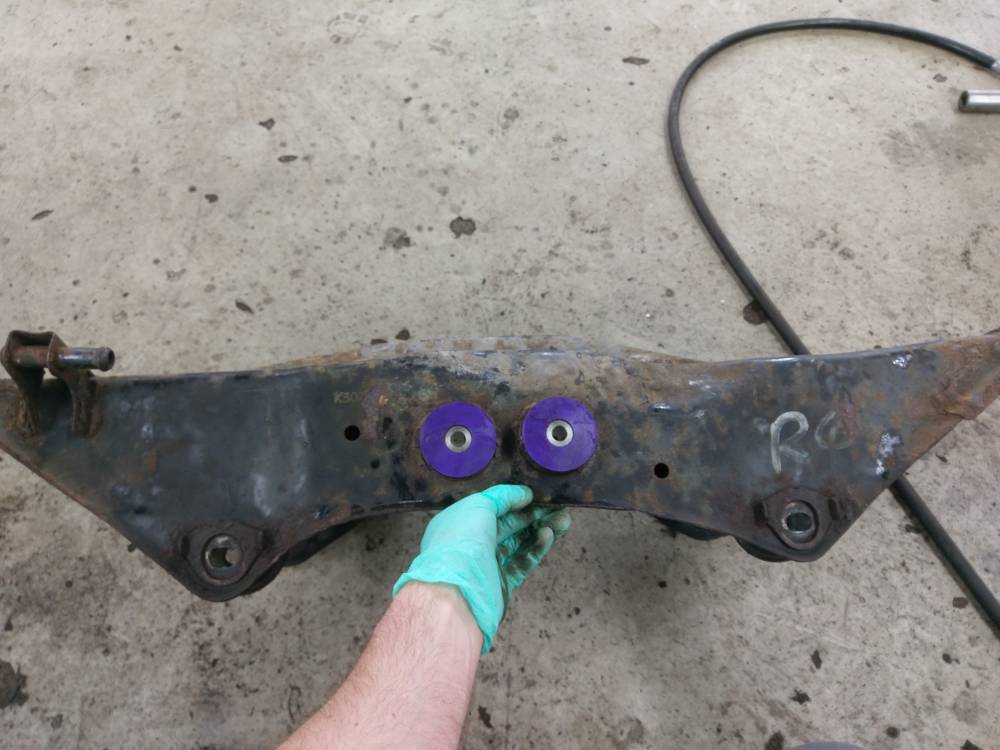

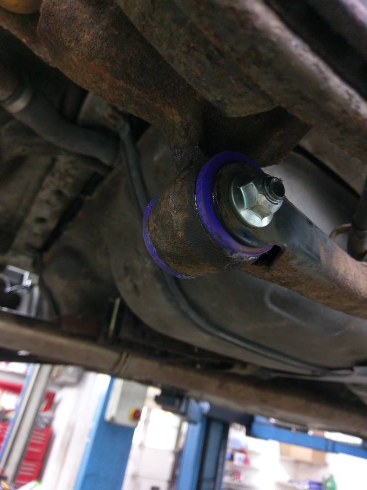

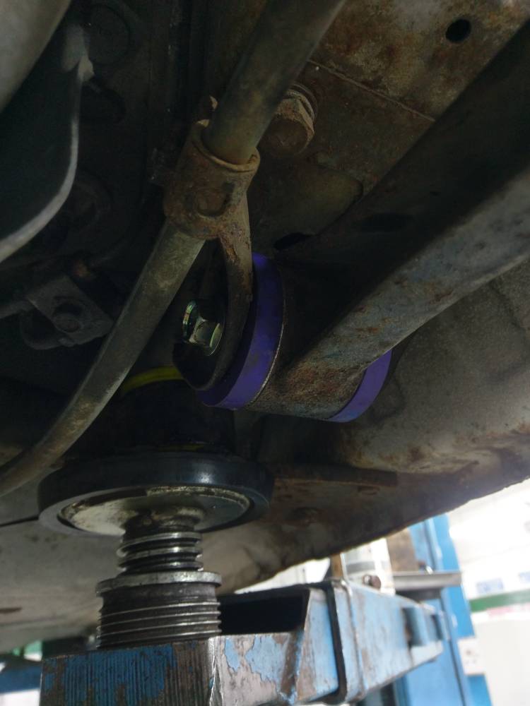

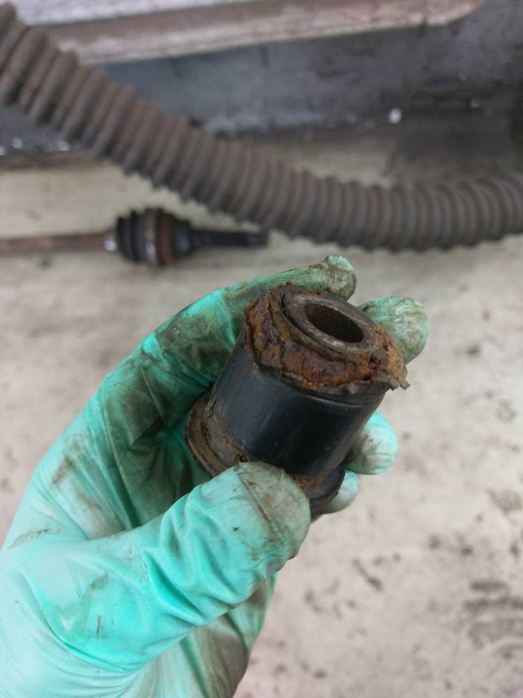

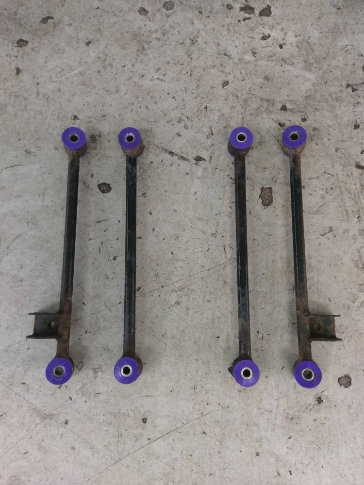

An early start allowed me to make great progress this morning by renewing all the bushes on the rear end with with either 'Powerflex' or 'STI Group N' bushes. Essentially the entire car now has renewed and up-rated suspension components front to rear! [emoji2]
Please be aware that the underside of my Impreza doesn't resemble anything like @Phase1sr masterpiece! I would of loved to of been able to send various components off for blasting/painting etc but unfortunately the perks of being able to use a two post ramp whenever I like has the con of being attached to a garage, and customers car's take priority and I can't have mine stuck there for days on end...
I've done the best I could for example where I'm unable to get my nuts/bolts plated I have just replaced them with genuine items so future adjustments will hopefully be much easier.
Whilst everything was stripped I also adjusted the rear anti-roll and set it to it's 'medium' setting as apposed to it's 'hardest' so I will see how I get on with that.
Interesting to note that my diff carrier/bushes are housed into the rear subframe as apposed to a separate bracket like Scott's bugeye. Although they are very similar suspension wise there are some subtle differences.
More updates to follow when I get the diff back! :up:

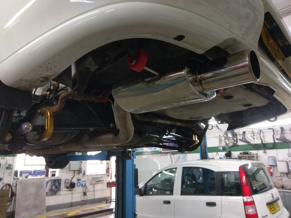

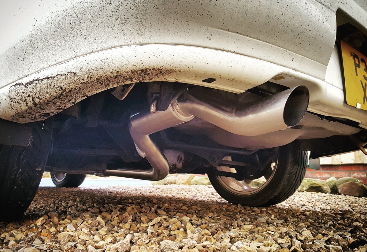

What do we think of this 'Group A' replica rear silencer chaps?
Personally I think it looks fantastic! However I doubt it's going to be track day friendly, especially as mine would need to be 3" pipework and my current centre pipe has no silencer...
Another issue (although not major :wink:) I will have to deal with a wife that already thinks the 'scoob' is far too loud! 😂
The pics aren't working again mate.
loggyboy
Considering Thruxton is our local and most frequently visited I think that answers the exhaust. Go for that style - not the silly 5inch jap cans - but with silencers for practicality/wife/trackday reasons.
yeecup
  mk8Fiesta ST,172 cup
that group a silencer is really loud, somebody was selling one recently and quoted something like 108 db.

What was the out come on the diff mate?
It was the best I could do buddy! Not quite up to 'Scott Spec' :wink:
Ah yes the lovely diff...
Specialist stripped it down, and found nothing wrong whatsoever. In-fact he said the bearing's look brand new, and I should just leave it as it is. (Fortunately he didn't charge me a penny)
Whilst the diff was out I took the opportunity to check the rear wheels bearings, and they're both spot on. So I refitted the diff along with some new driveshaft seals as the offside was leaking slightly then refilled with some 'Motul 90 PA' and as I thought the noise is still there.
It's strange as its quite audible at lower speeds 40mph or so, but then when your on a motorway doing a steady 70mph it's gone!? It sounds bad but I'm not going to pursue it any further. The car is rock solid, everything is poly or uprated, and being the RA it has no sound proofing whatsoever! Also the DCCD / short ratio gearbox is known to whine and it's quite normal.
I can only think that maybe the introduction of all these bushes etc have added more vibration/resonance into the cabin at certain speeds?
If it all goes tits up and something breaks at least it will be easy for me to diagnose! 😂
I just want to enjoy the car instead of constantly chase possible faults. On the plus side the new bushes etc have totally transformed the car in so many ways! It's incredible and I can't wait to get out on track with some sticky tyres! CSF17 is going to be loads of fun! :laughing:
