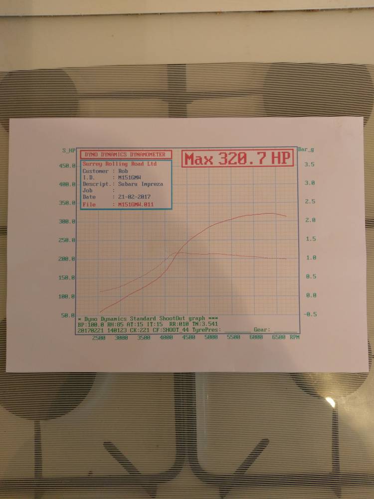

The results are in!
Better than its last session on the rollers (312) but it drives so much better! The way the boost comes in is fantastic! Duncan has also tweaked the anti-lag which is hilarious oh and if I get bored of that he's also added launch control... More importantly however is that the engine is strong, and I can just get on and enjoy the car, and get a track day booked.

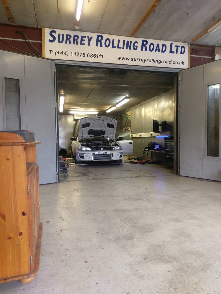

Unfortunately I couldn't get many photos/vidoes because they closed the booth door, but here's the all important money shot!

Bet that goes well in what is a pretty light car by modern standard, especially with that gearing.
Just needs the bumper sorting and it's spot on!
Mate, proper made up for you after all of the hassle you've been through.
I bet it's fcuking epic on the road?
Nice result. What is the torque figure?
Stupidly I completely forgot to ask... I've messaged him to let me know what it was. If I recall the previous owner mentioned the torque figure was similar to the bhp. I'll find out though! [emoji5]

Great news. Smooth graph too.
Be sure to get some anti lag/launch control videos up etc to celebrate.
I'm waiting for some decent weather on a Sunday, and I'm going to head out for a blast with the GoPro!
Nice work Rob! Conservative rollers, too
Thanks mate, I'm really pleased!
Nothing until 4500RPM, must be like having a big Clio! :up:
Lovely smooth graph too.
It does a have a very old skool turbo lag feel to it! [emoji23]

I'm going to guess 1.2bar.
Great to see it back up and running.
Yeah about that bud. Pretty sure he said 1.3 bar
