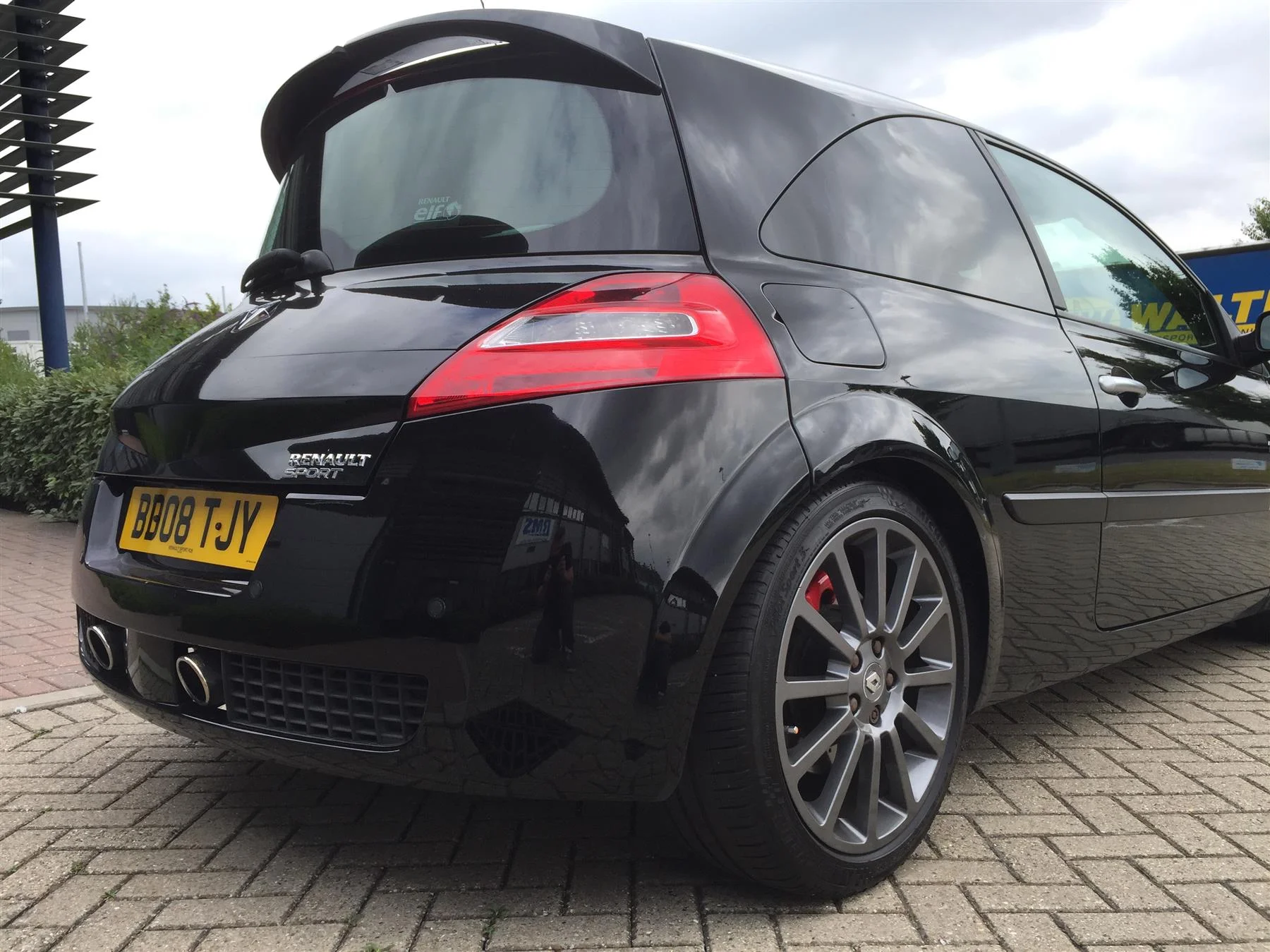

R26R rear spoiler
Scorpion silencer

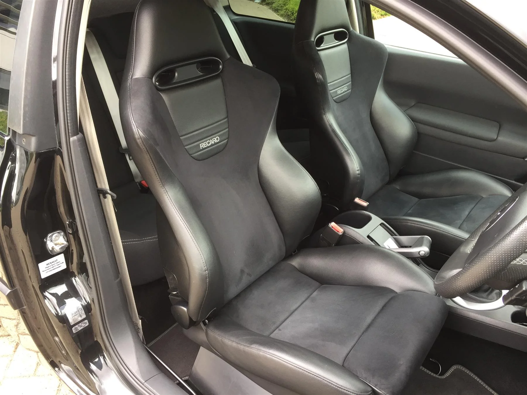

Recaro Trendline seats with no rips or tears to bolsters

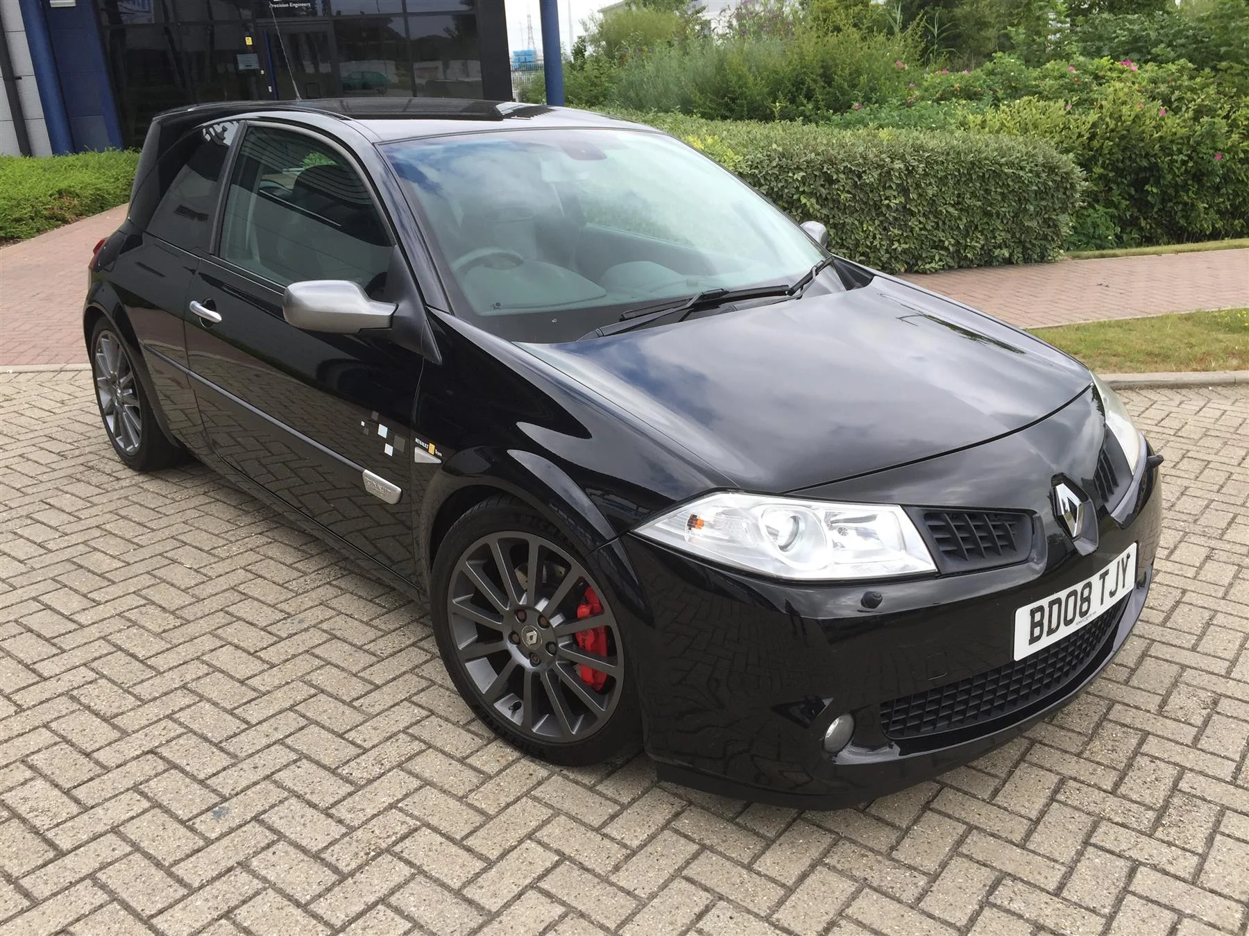

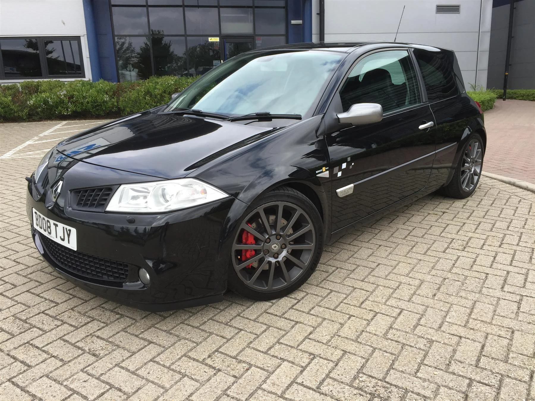

Overall the car is in well looked after condition. There is the odd small age related mark on the car but nothing that stands out as offensive

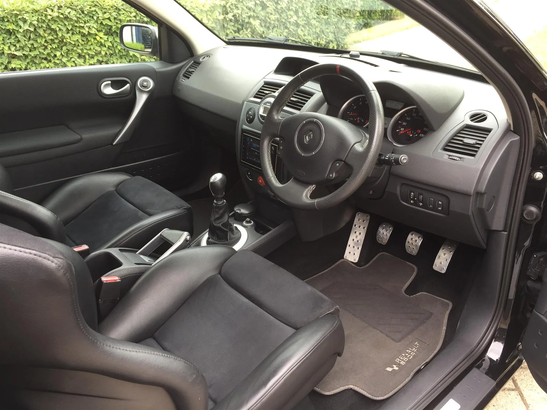

Another problem (or it might just be me) is the poor gear selection. I'm often selecting 5th when I wanted 3rd and when I want 5th it can be tricky, and don't even get me started on selecting 6th! It's quite shocking that Renault didn't put a gate on reverse as I imagine you could easily make an expensive mistake! (Unless they do and mines already broken!) 😂
Any advice on gear selection problems would be most appreciated!

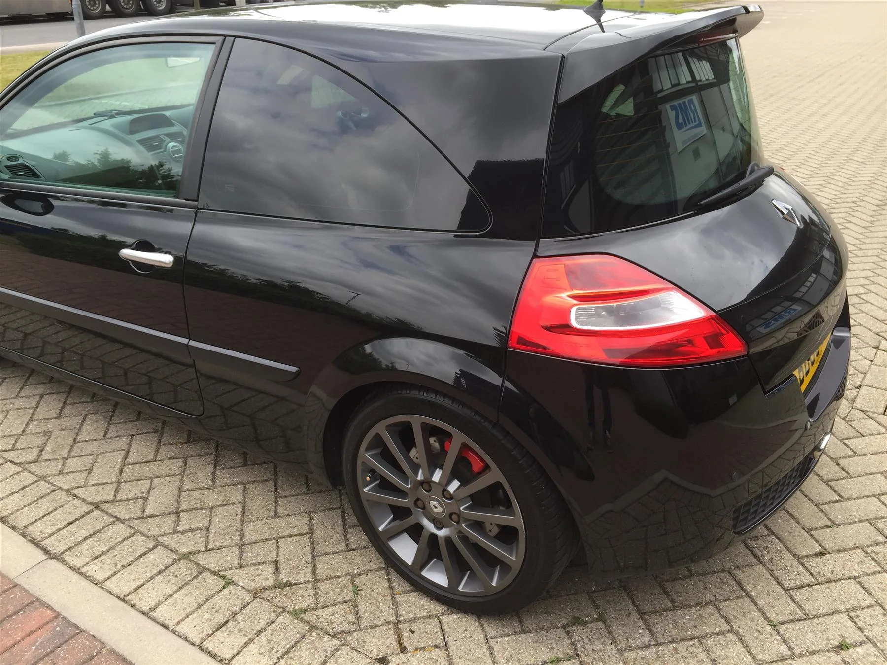

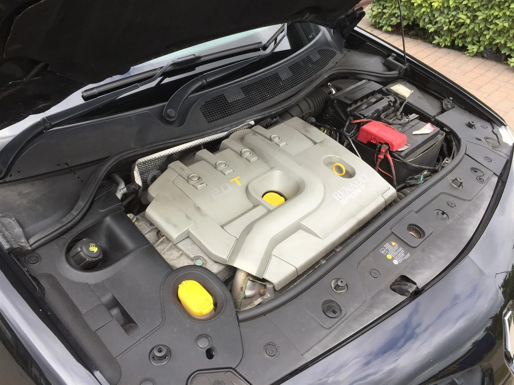

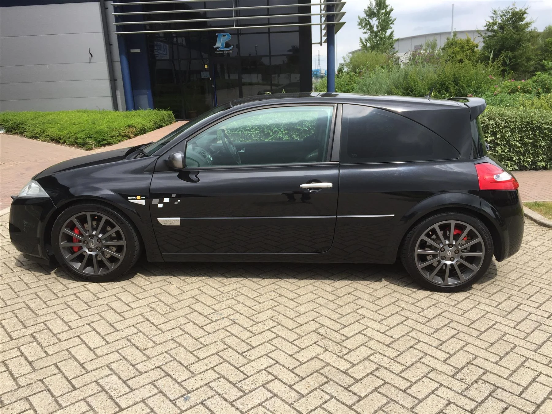

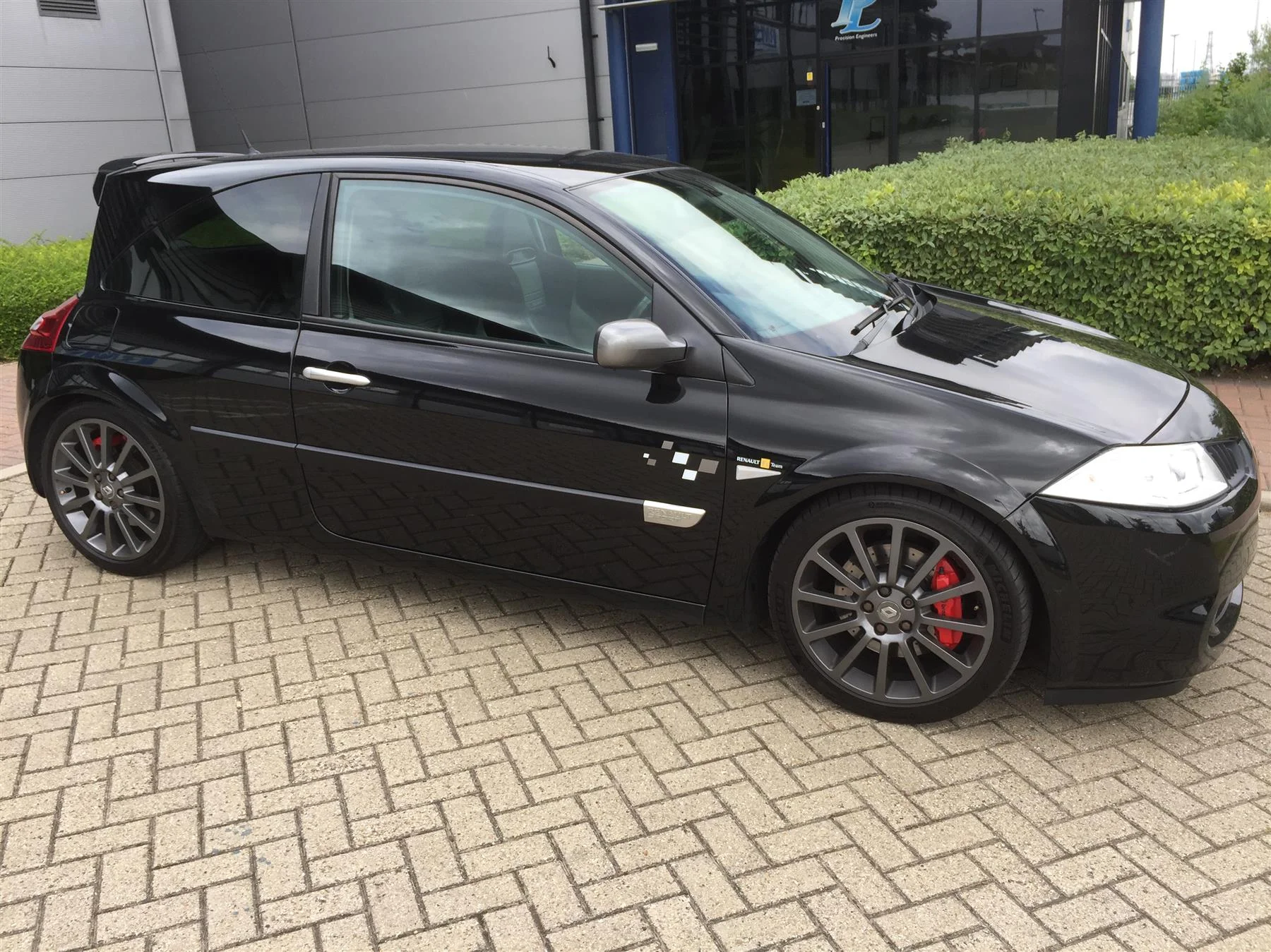

For now the only photos I have are from the advert, and I will let them do the talking!

Looks great, what do you need to look out for on these apart from the usual?

That looks really great, especially given the mileage. You'd never think it had nearly 100k on it judging by the pictures! Great car for the money.

Looks great R spoiler makes such a difference! As well as the short shift I'd look at putting new engine mounts on too, the gear change should stiffen up if the current ones are quite worn :)

The gear selection is a bit wishy washy I've noticed too.
Luckily it's a lift up reverse so selecting an accidental sixth shouldn't happen.
My dmf is on its last legs so gear selection even trickier if pushing on.
I agree mate. I'm glad this one already has the R spoiler as it would of been an essential purchase!
Mine came decated and with a scorpion exhaust and induction kit which makes lots of nice noises!
Now this worries me... My gear selector doesn't have anything to lift whatsoever!
You can put it straight into sixth gear! I assume that means I've got a problem with me gear selector!

@RMDavis unless the r26 has a different gearbox. I've got a 2004 225 with the Nissan 6 speed box they came with. My reverse is a lift up same style as the 172's.
How do you get reverse in yours?
Well I know the R26 has the diff do maybe it's a different gearbox also?
To select reverse I just straight across to the right and down next to sixth.
@Feirny is this the same as yours?
Sent from my HTC 10 using Tapatalk
RMDavis
Wonder if the lift mechanism is stuck in the lift position allowing you to just throw it across.
Might be someone with more meg experience to enlighten us soon.
Pull yer knob off and see if the spring is broken or there at all. It should just twist off, I swapped mine yesterday so it's all fresh in the mind.
Nope, it's a collar up reverse.
Cheers guys! I've fixed it!
I remember Lee saying he replaced the gear gaiter recently.
So stripped it down and found the plastic shaft not positioned correctly and it had jammed the lift up.
Now refitted it's working perfectly!
