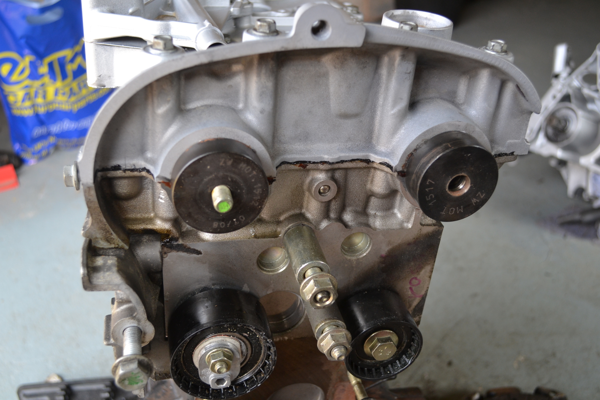

Looking for advice/info on refitting the rocker cover. Specifically the best method of ensuring it seals properly, obviously clean mating faces etc. I removed the cams for inspection and cleaning
, so will be replacing both seals on the cams (at pulley end). What is the best way of fitting these seals, should I fit and seal the rocker-then push in the cam seals once sealant has set? Or push them in whilst the sealant is not cured?
Also after the torque figures for rocker cover bolts? And the order in which to tighten them-start at middle and work outwards evenly?

cams in, horse shoe in cams, rocker on, then seals (DO NOT PUSH THEM ALL THE WAY IN! THEY SIT FLUSH TO THE OUTER FACE, NOT ALL THE WAY IN!!!!)
i do middle 4 and outer 4 on the rocker, like small box big box
12nm give or take for the rocker bolts IIRC

Ok, thats great cheers. Loctite gasket sealant from halfords or similar ok to use?
Yeah have all the proper Renault tools
Just to add.....assemble as you've said above......Should I tighten down the rocker and then fit the seals or put them in place(flush as you've said) and then torque it down?
Loctite stuff from Halfords is fine. I'd torque it down first, let it go off overnight and then put the cam seals in the next day. As Fred said DON'T push them all the way in. I made that mistake...

Just take ya time when applying the sealent on the head. It only has to be a very flat bead and make sure all the right bits have silicone on.

They make it easier, but not essential by any means.
