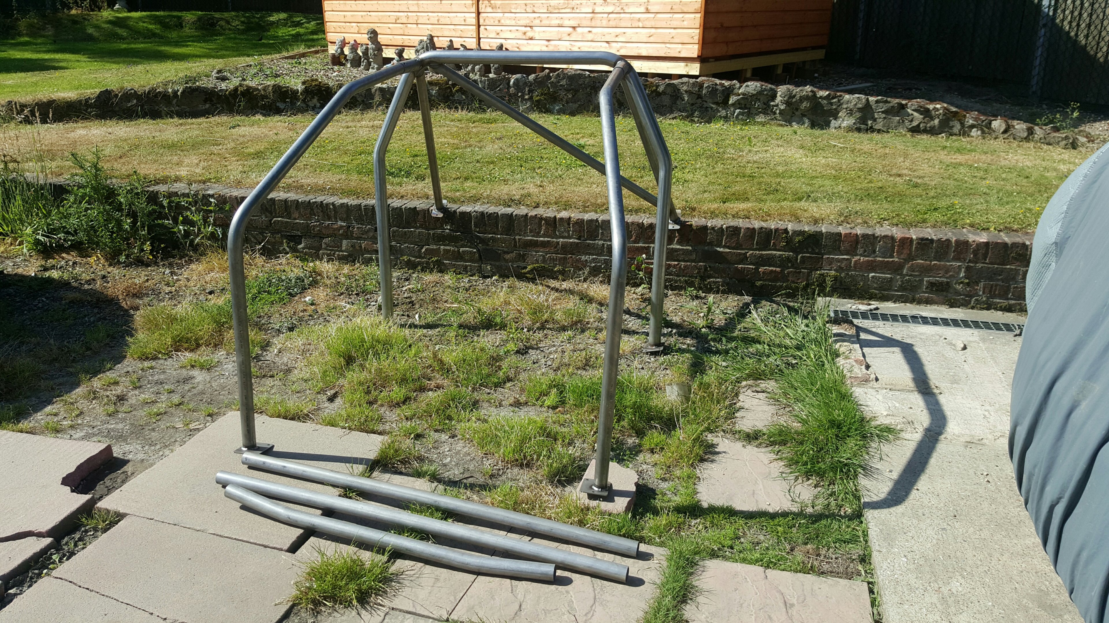

  dan's cast offs.
can sort you with cage as well ?

  dan's cast offs.
i always say you might as well go full rather than just a half cage, half won't really do much to protect you when compared to a full. also full stiffens the car up as well.

If I interpret the MSA Blue book correctly circuit racing up to 2000cc only need a basic rollbar or cage complying with drawing K1 or 2, which are 'half cages'.
In practice though I don't think I've seen a race car without the front legs and secondary bar.
We have just bought a Sparco FIA compliant 6-point bolt in cage for the 182, This has front legs legs and hoop, and door bars which you don't have to fit.
It was £672 from DT, but bolt-in this case does still mean a fair bit of welding!

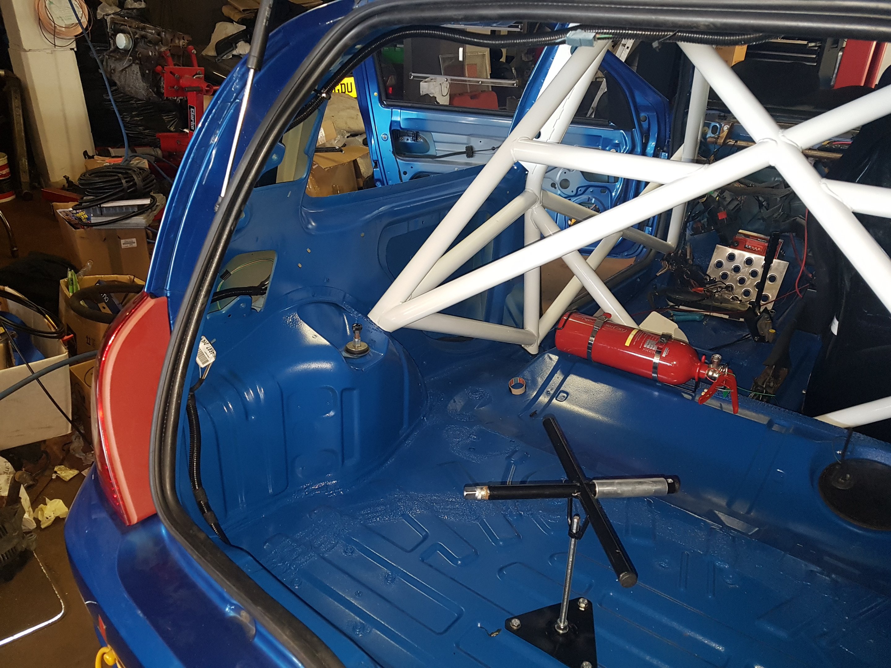

Hello James
Why not give us a call.
We are the authorised supplier of Safety Devices roll cages.
Mark has raced and prepared many Renault Clio's for customers for a number of years now and he can explain the pros and cons of each type of cage.
He will be able to help you decide which cage would suit your purposes.
Our number is 01279 431628, or his mobile 07775 752675.
