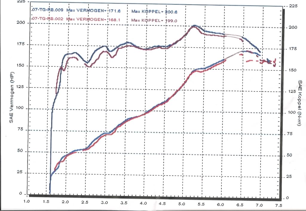

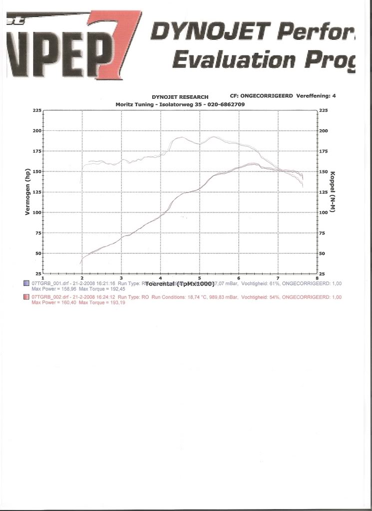

before :
After colombo & Bariani cams, 182 manifold, inlets matched, v6 airbox + custom remap by Fastchip
Good results !? (power is at the wheels)

Damn thats hurting my eyes, whats the before and after bhp, can hardly see it....
With the cams etc is that saying 200bhp, pretty good result to be fair
  lift number 1 @ btm
200 at the wheels?
is that hp or ps, and what losses did you show?
sounds like a very good result to me!

:D nono believe me it's at the wheels. We have torque in Newton meters. Torque increased around 10 NM
press the bar above the pics for full view. (Fossie, :cool: because your eyes hurt trying to find out ..)
Generous RR ? This is one of the RR's that has Henk's approval , his home base dyno where he does all his maps . Plus the first one (before) was done in Amsterdam, although on the same brand/type/make of Dyno.. maybe this one was off but i do'nt believe the second one was , no way
Really, the car flies !! i just got back from an evening thrash; temp below zero (cold is best) and i'm finding it hard to keep her on the road as hard as it pulls..
Henk was seriously surprised and pleased with the results, we matched the graphs to his 197 Clio and they were almost the same.. it's genuinally making around 200 @ the fly
Maybe Henk will come around to verify , anyway i'm extremely happy :approve:

Hav'nt you just said its at the wheels, and then said its at the fly at the bottom? I may be wrong?
  Nippy white cup
I don't think it is too far fetched just under 200bhp with cams, inlets, manifold and exhaust/decat and custom map?
168bhp at the wheels I reckon to be around 197bhp at the fly

The torque is the 200 on the graph in NM...the bhp is the one just under 170 at the wheels

I'm confused by this and the graphs.
So if its a genuine 200bhp @ wheels, that would make about 235bhp at the fly wheel....I don't think so!!!!
The top line is torque, the bottom line is power.
people must have been drinking :D Not 200 at the wheels ! probably around somewhere 200 @ the fly (when you throw 15% equation on the 171,6 wheel-power stated in the graph) .. Only thing mentioned on these graphs is power at the wheels
And yes the top curve is NM , the torque (which is a nick over 200)

thats got to be fly figure surely, why else would people spend 4k on ITB's and cams to get close to 220-230
  172 cup
just been looking at the graph does it not say max output is 160? that would be a sensible wheel figure

this is the readable version..
@Riley ; surely not. It's power at the wheels ! :D And the first one shows 160,.. at the wheels yes, the second one shows 171... We even got a run just before that was higher ; almost 175 !! This was due to the cooler situation , later was a "warmer" run
Henk Fastchip called me later and again said that this setup (C&B cams, exhaust manifold+inlets) was the best working he's ever encountered.
We held the graphs of his 197 next to mine and they were identical.. Making the exact same power + torque as his tuned 197 (only mine is a small 300kg lighter . He could'nt believe it himself:cool:

I have the same mods plus a filter and I make just over 200 at the fly on a very accurate dyno!!
I find 200 ATW vey hard to get my head round as you seem to have 30 odd BHP more at the wheels with the similar mods!!
