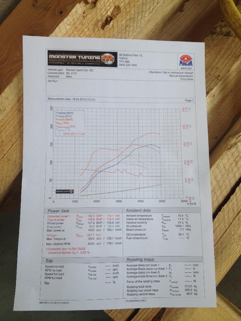

Just thought I'd post up my rolling road results from today at Monster Tuning in Telford. No idea if the curves on the graph are good so over to the tech guys on here ;)

It was a Dyno day for the "No smoke no poke" forum... I think the torque figures may have been glorified to keep the dirty diesels happy

I'll drop them an e-mail and see what they say. I'm really not bothered as it's all a bit of fun but would be nice to see it with slightly realistic figures lol

All graphs are supposed to have the torque and BHP line cross over at 5252rpm...... Something about all this doesn't quite add up, there must be more to this than what's been posted

Send them a link to this thread mate, Have they given you the right graph?
Looks more like a diesel graph to me.
Only if they are plotted on the same scale though, which that doesn't appear to have been.

It was a diesel dyno day so it could well have still been setup for diesels? No idea how they work to be fair!
