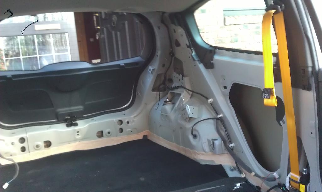

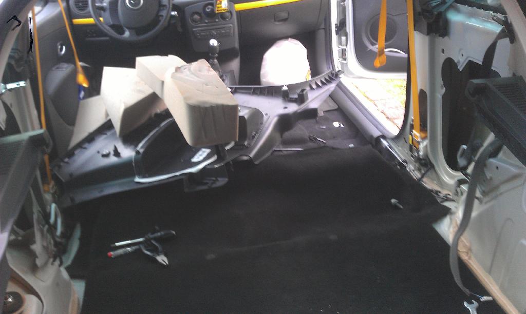

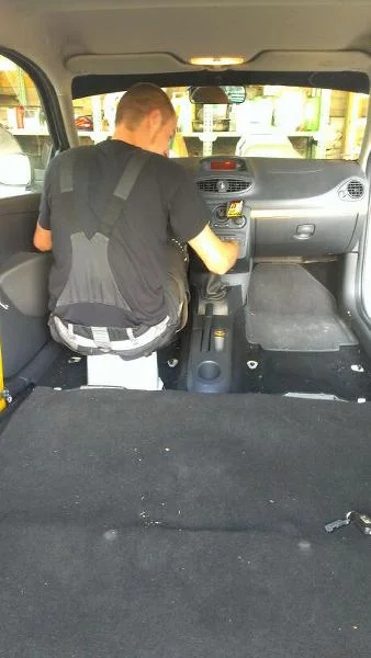

First, the rear seat was removed and relocated a decent carpet.

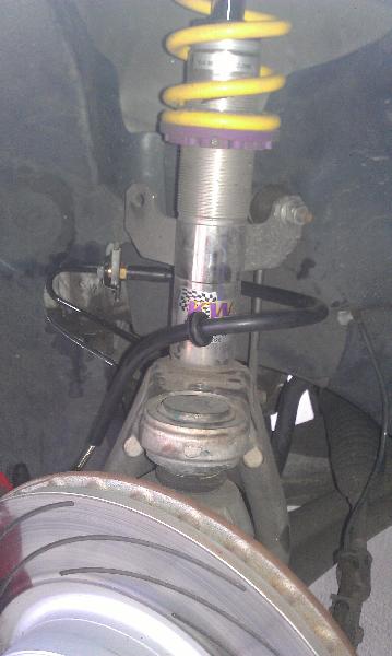

Shortly thereafter came a KW V1. Again thanks for the install to Tobi and Cassy! This will also soon a club sport soft (Who saves buys twice)

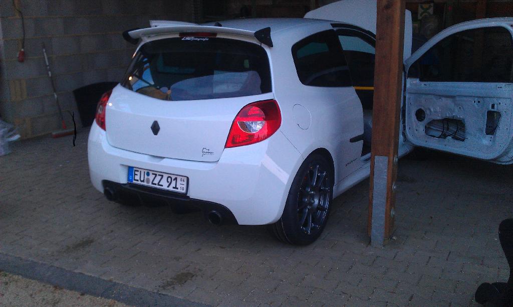

It was followed by the cup spoiler. My feeling after the tail is now a little calmer. But certainly he takes top speed by about 20km / h (speedometer)
But since I also put emphasis on look he just had it. When painting, he has but so so warped that I first thought that is not the spoiler.
Then overnight he had with the help of weights sag so you could mount it at all.

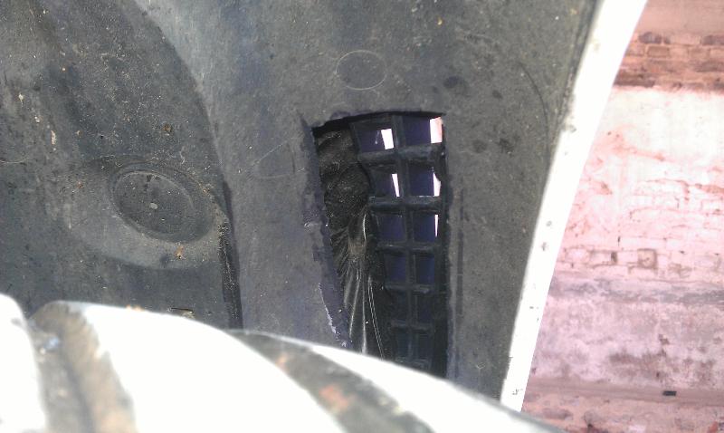

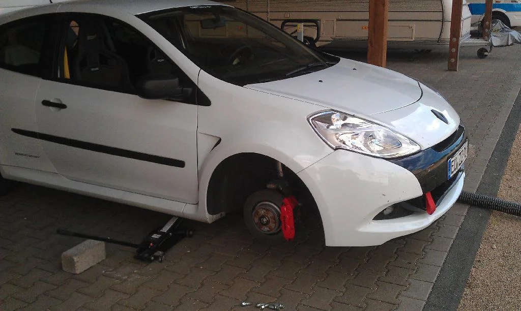

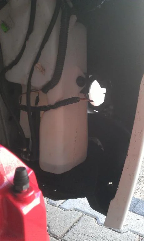

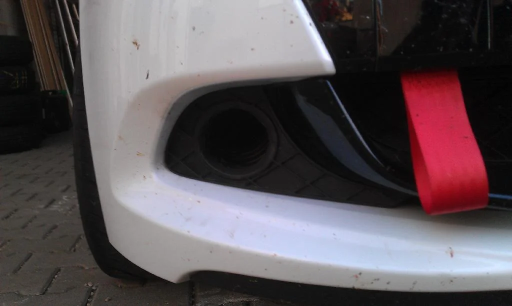

Thereafter, a brake ventilation was crafted for little money. Probably looks more professional than it actually brings what.
But the recess was cut quickly and the tube was inserted. Toward the front only to fixed pressure, so you can remove the bezel.
In the wheelhouse he was a shot and then there glued to mounting adhesive. More sense would do it if the hose blows directly onto the disc.
But this involves a significant overhead.

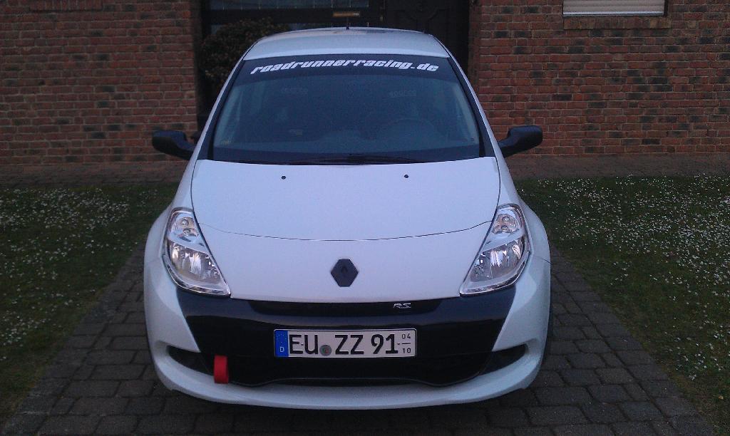

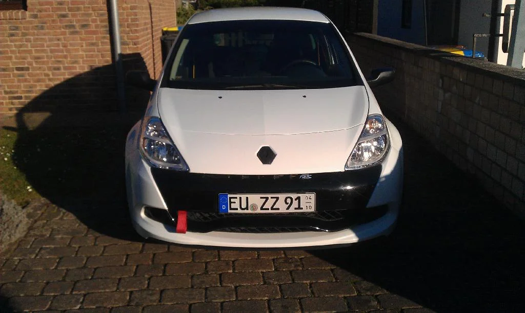

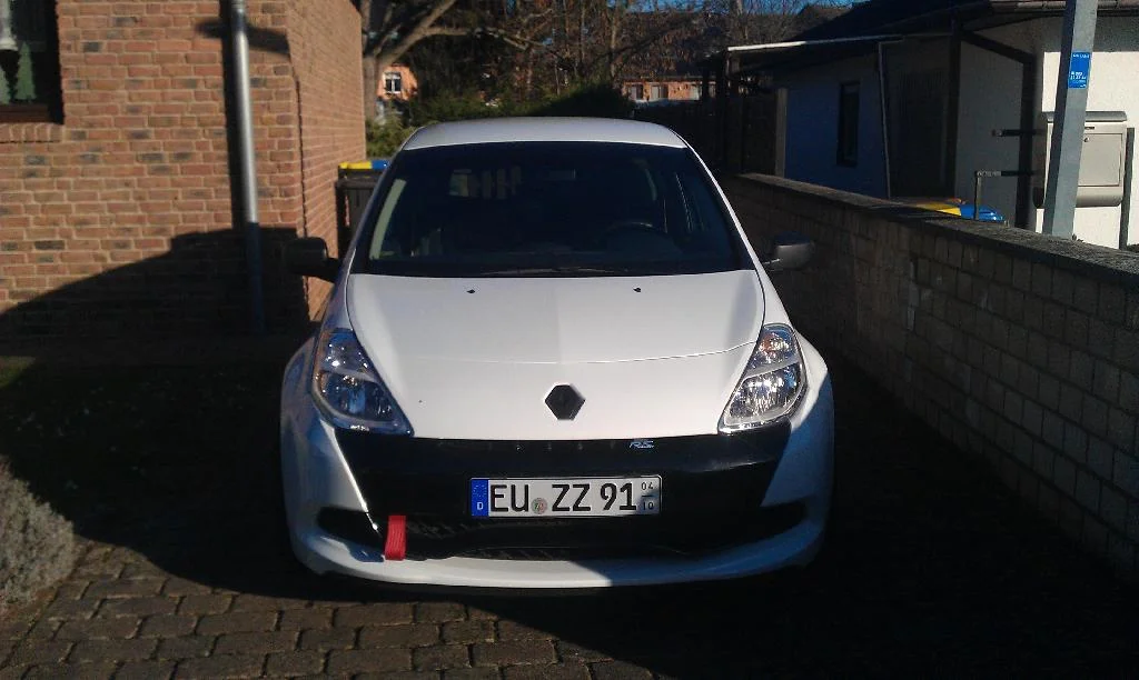

After that, I have been looking times to the functionality of the tow strap:

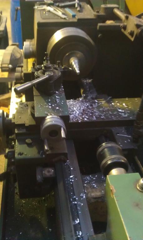

I used a 20cm loop. A Stoffschekel (2t) and the standard tow hooks. The latter, I've missed a Longer thread. 20mm thread cutter I had by luck there. But had to on the lathe to make because there is no support in this size was present.
Thus it can be quite comfortable screw to the desired length standard tow hooks now. If it goes deeper he pushes forward with the eye against the plastic. But can still rotate far enough loose with some force.
For Stoffschekel; was initially not very convinced. But plays with our Defendern at work. The thing keeps better and tears in the event of the case and not as unpredictable as a Metallschekel.
Go here to buy: http://www.allradteile24.com/index.php?c…l-Schaekel.html
In the following pictures you can still see how I use a dremel the plastic to the bumper slightly've edited so that the strap through fits nice and the cover can include plan. This thread has been extended to 9cm. but it should be enough for 8 cm.
With this solution does not weaken after all, the original hacking. For if the car is stuck right rather not keep the other designs and you can hack the original in case of emergency still continue to turn and get out.

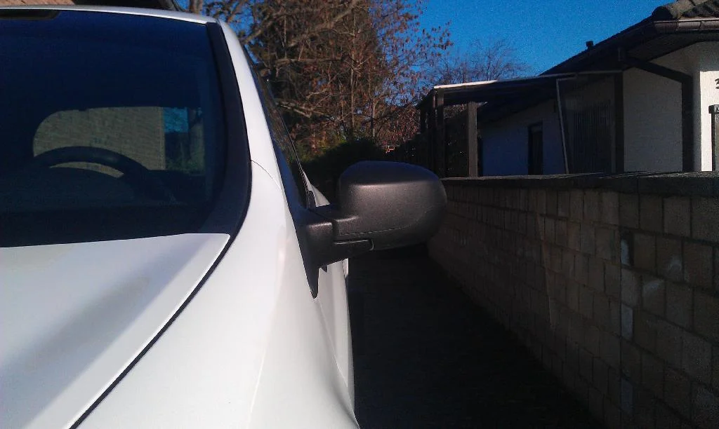

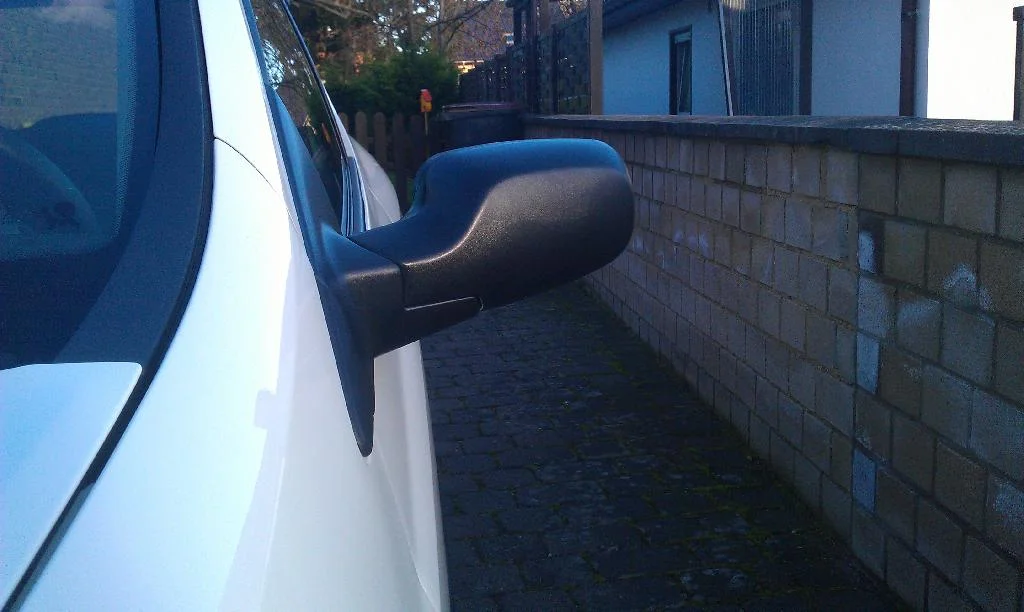

This was followed by the mirror of Ph 1 (about 600g weight saving, this here are some pictures to compare.:

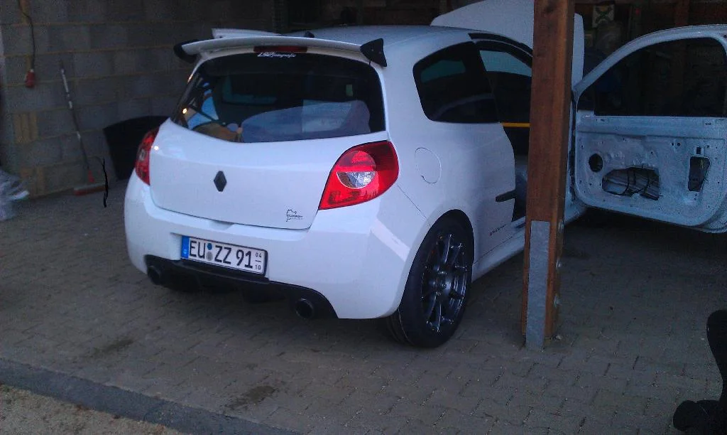

  Clubsport Clio 3

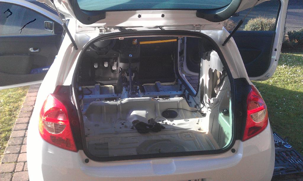

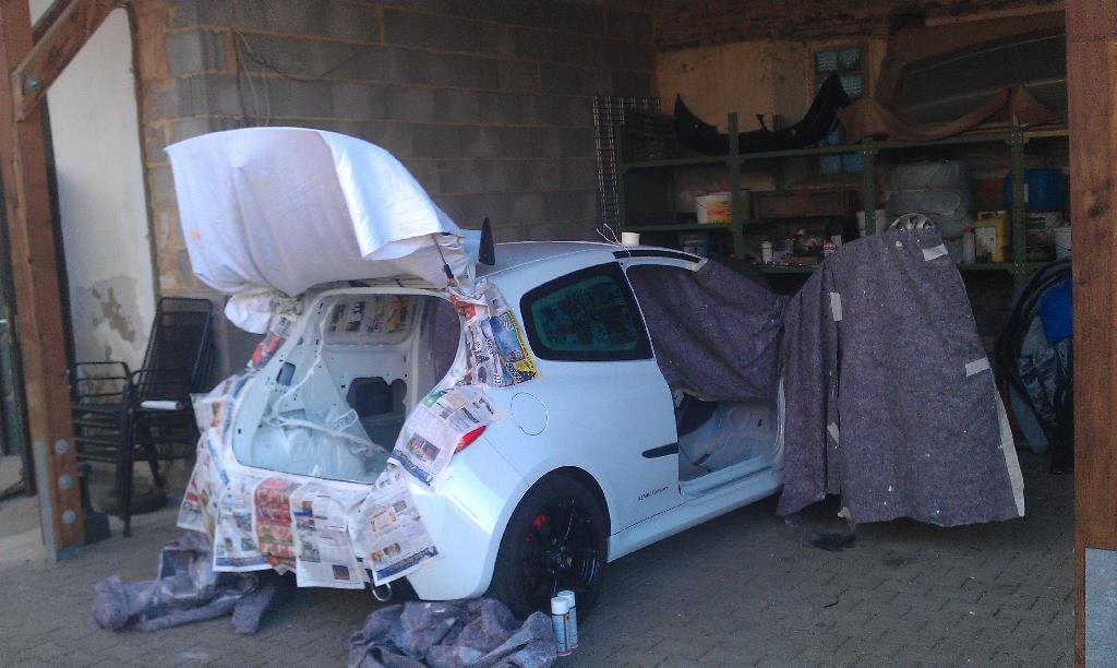

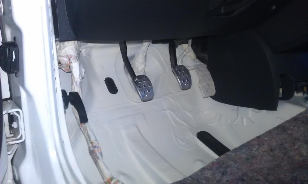

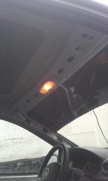

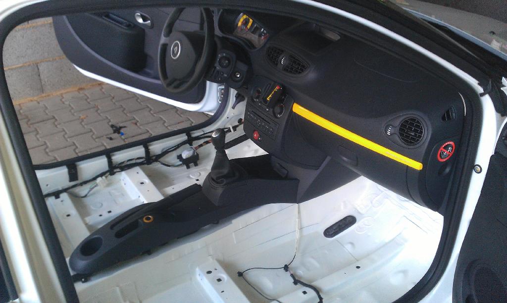

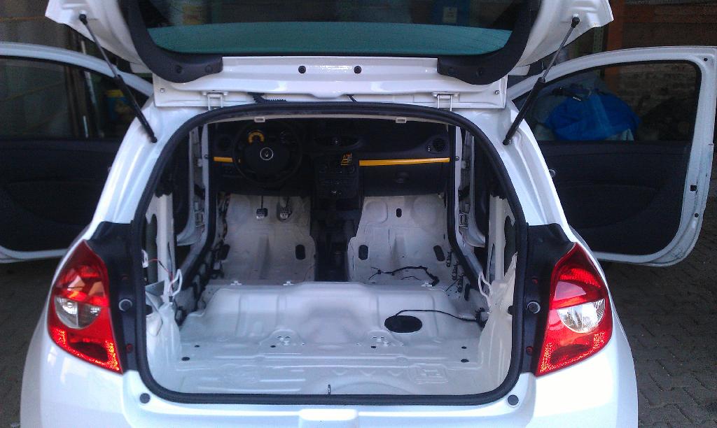

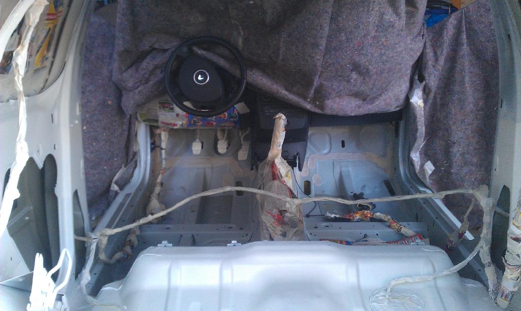

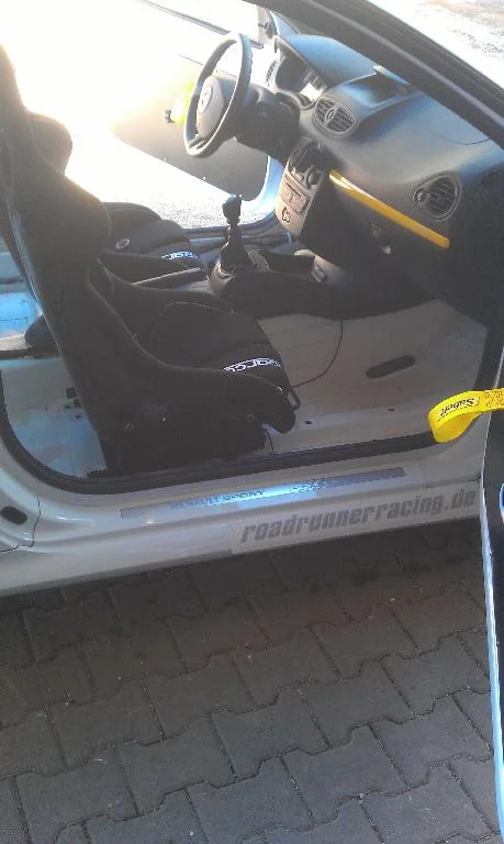

Now we set off correctly; In winter, the car was almost completely eliminated. Only the headliner and dashboard were there.

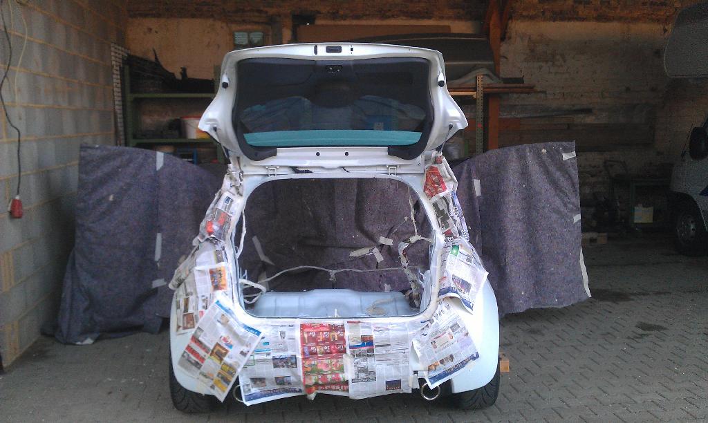

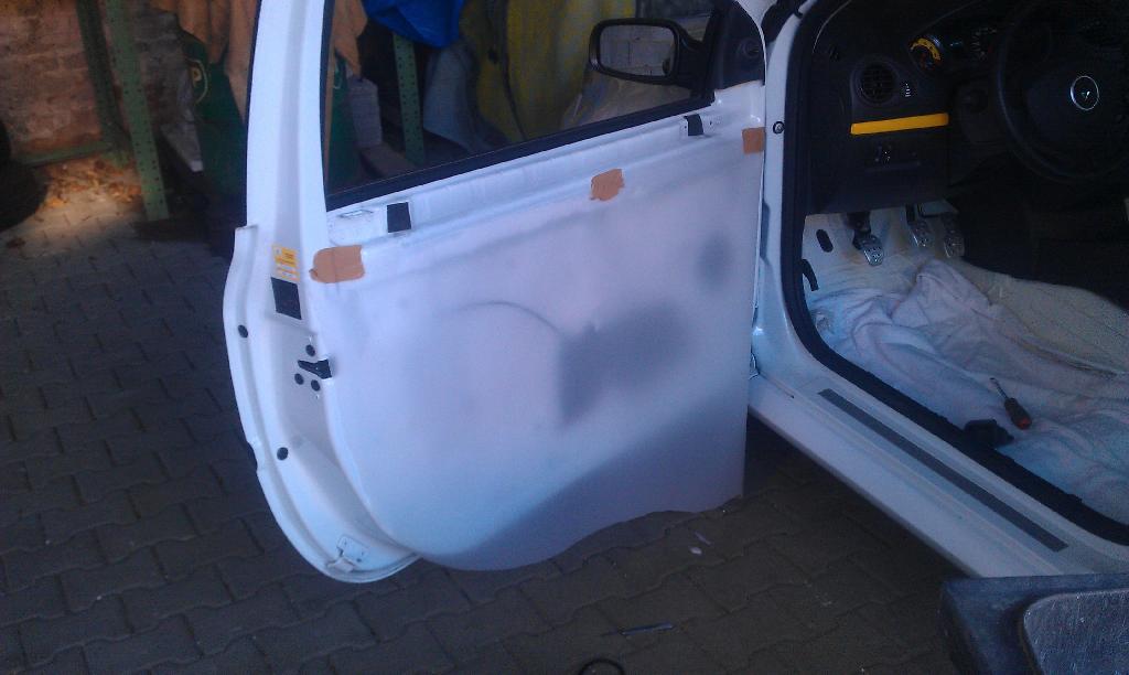

The car was painted matt white on the inside. Course work it prepared only taping and remove Selbiger: wacko:

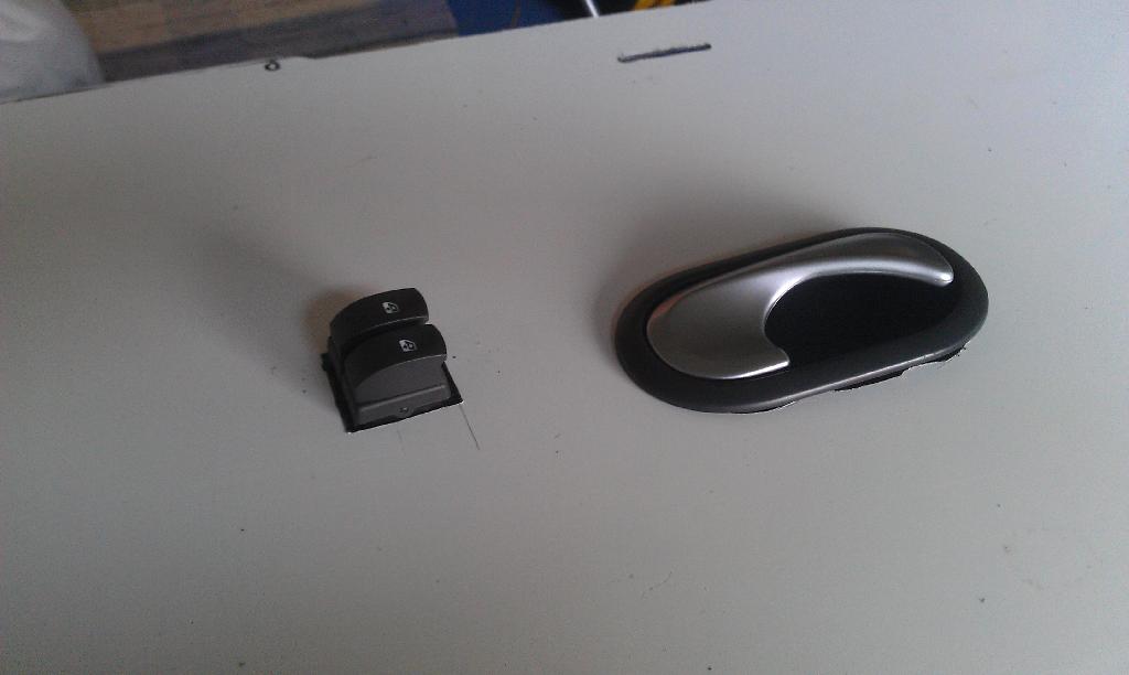

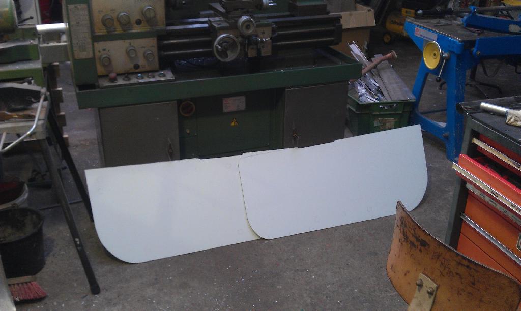

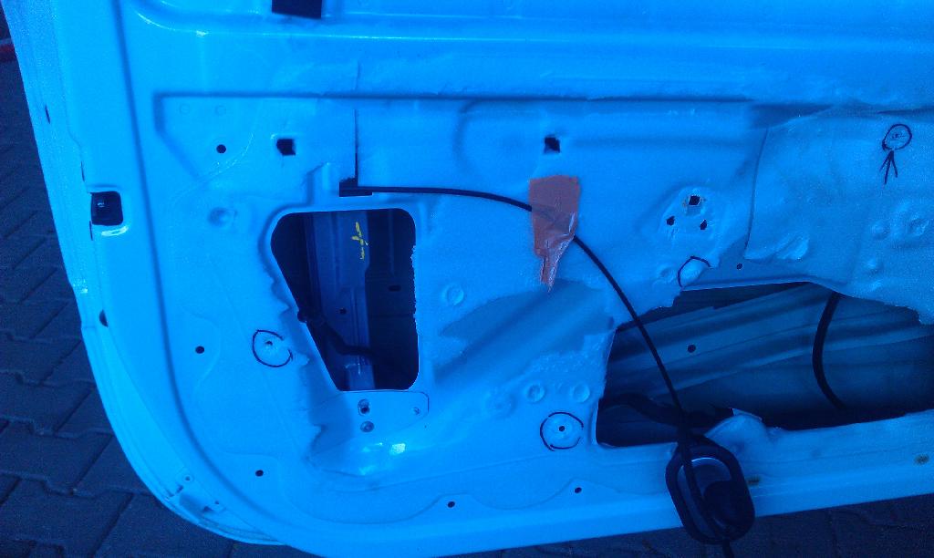

With a donation of Uli door panels and boards were produced for the holes under the rear windows Dibond. Those who are required degree can login like to have stencils made. In addition there were tow loops and the originals door opener and windows.
In the course Meanwhile, the radio flew out with all the boxes.

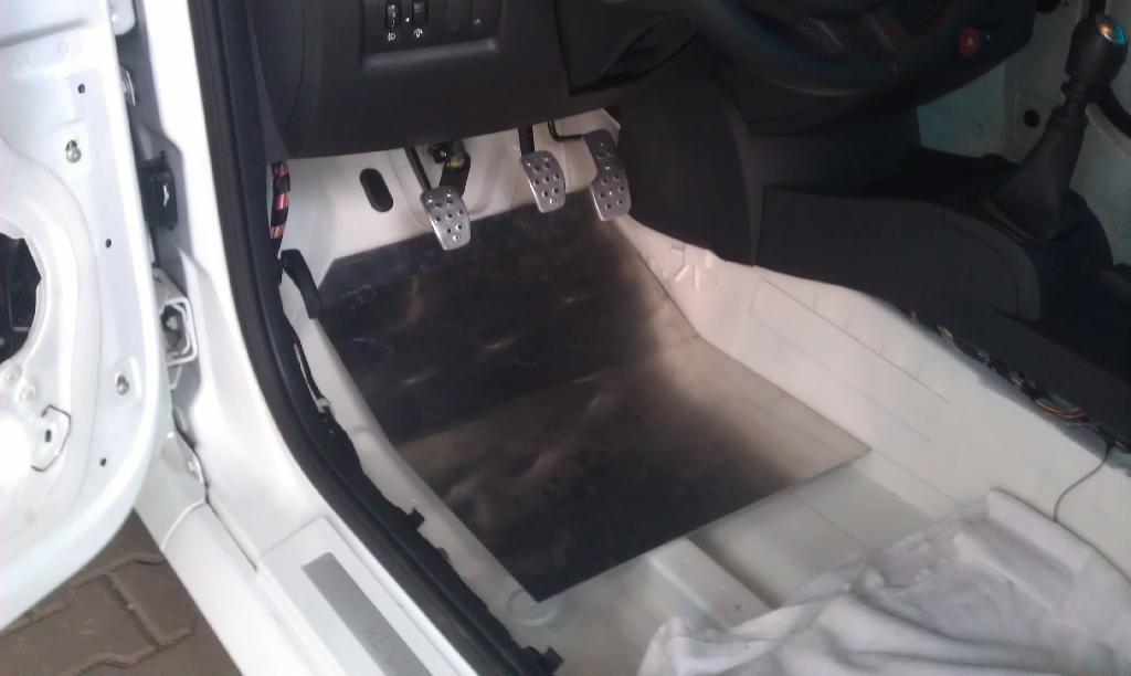

Also, I have saved me 250 € for the footrest of Renault Sport and simply get tinkered a bit, so I also have a unified picture on both sides.
2mm aluminum sheet twice bekanntet screwed with four screws in the bottom, between aluminum tube to compensate, on a normal indoor carpet.

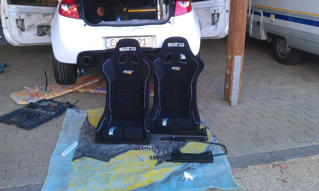

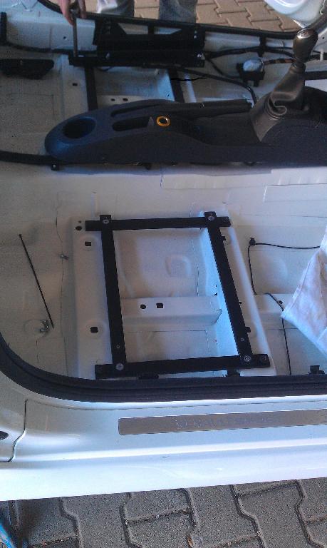

between unleashed a package one after another. Schroth Profi II ASM fe with boltfitting and expand into six-point seat belts with grommets.
From France came a new helmet and the helmet box Sandtler was the right one.

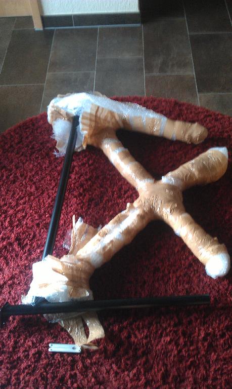

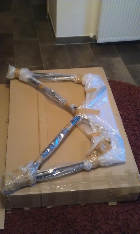

A temple of Wiechers strut came with H and had half again to Wiechers back because the harness bar was missing.

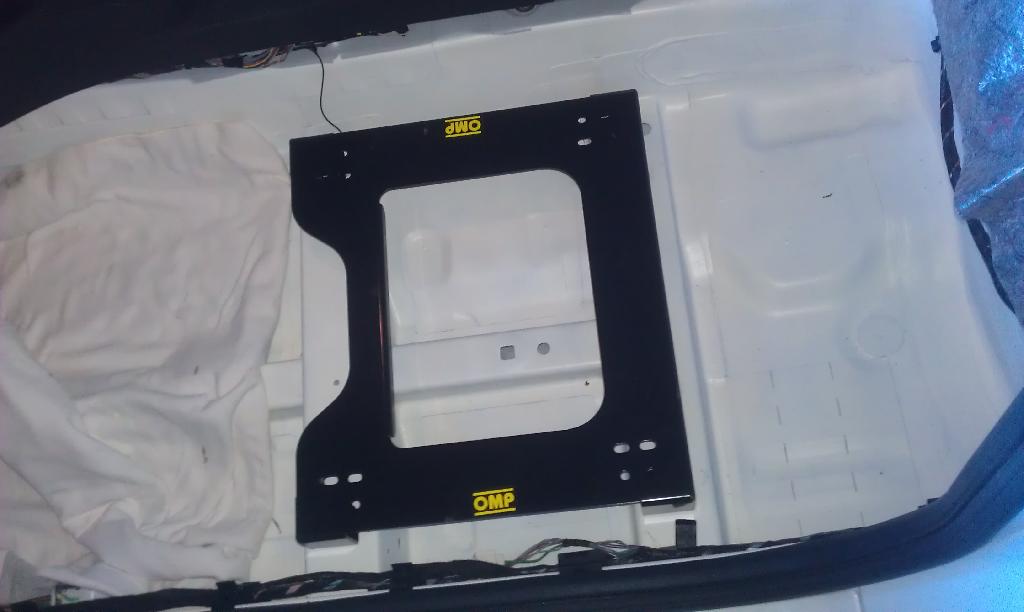

The ordered OMP consoles went back and once again Overbeck has helped me out of trouble. The brackets fit properly.
On my Sparco EVO II and EVO unfortunately I had to wait a little longer.

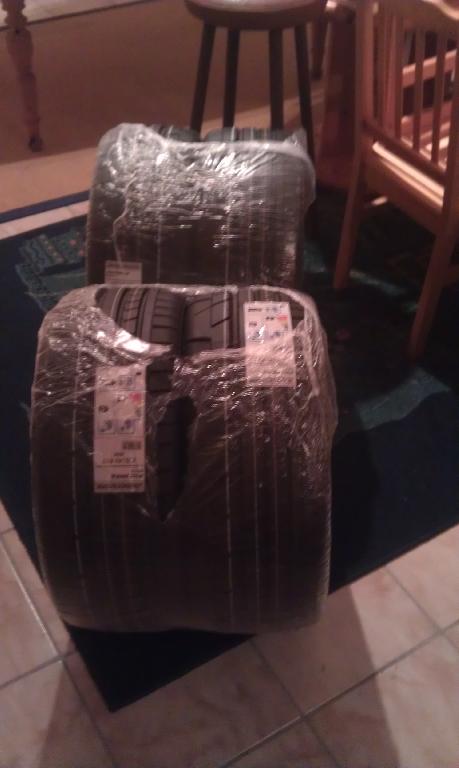

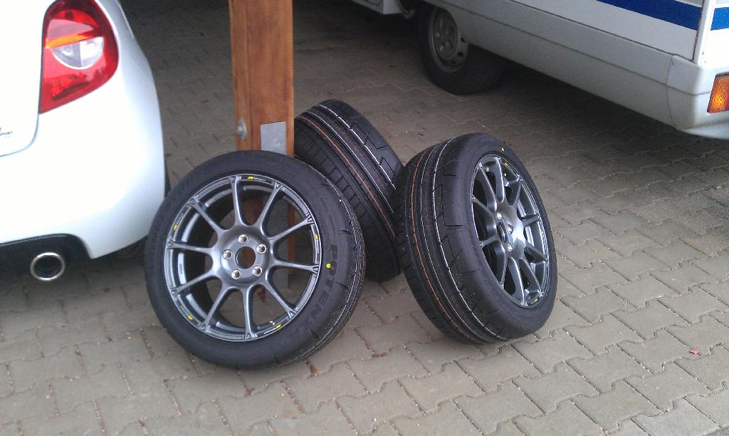

The end of February it was clear that it will not do the Federals long anyway. So were needed new tires. Since I am also instructed abundan on the Clio in everyday life make Semis no sense.
Especially since I've always just a KW v1. So I had to resort to the size 225 Bridgestone
Unfortunately, this was inevitable grind. So new rims. still drangehangen the right time to place an order from Gerrit and ordered NEN handsome set of ATS GTR

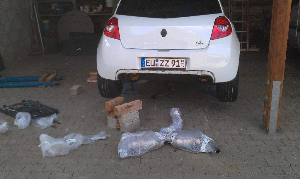

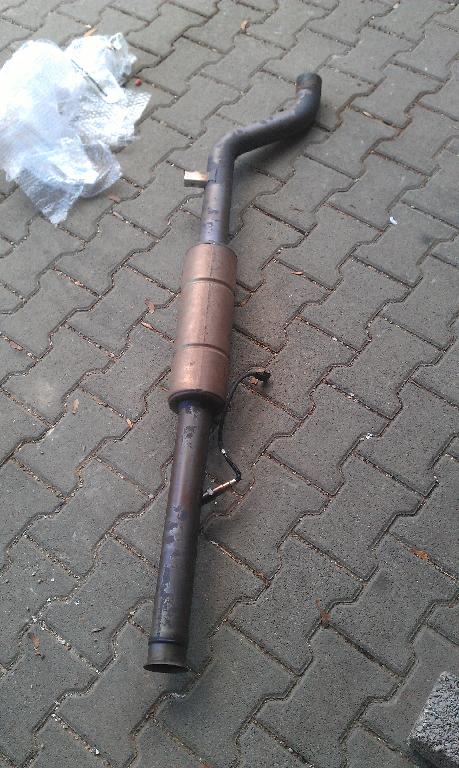

In between I bought from Overbeck ne Akra. What can I say. I'm very satisfied

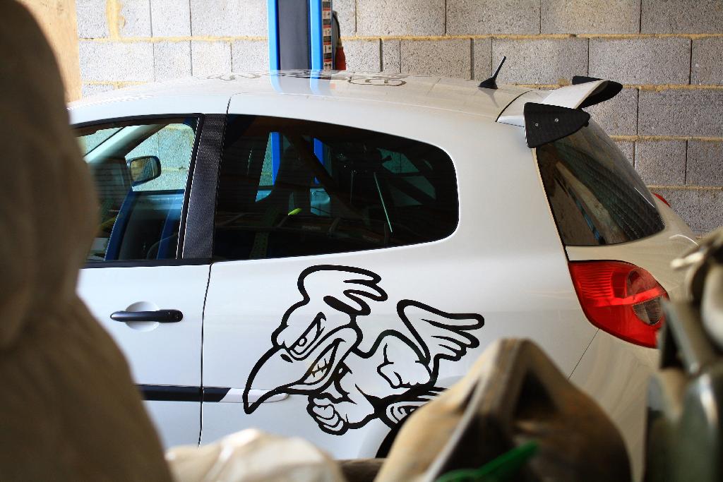

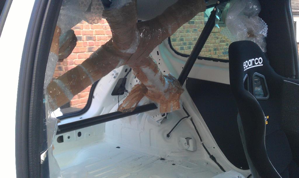

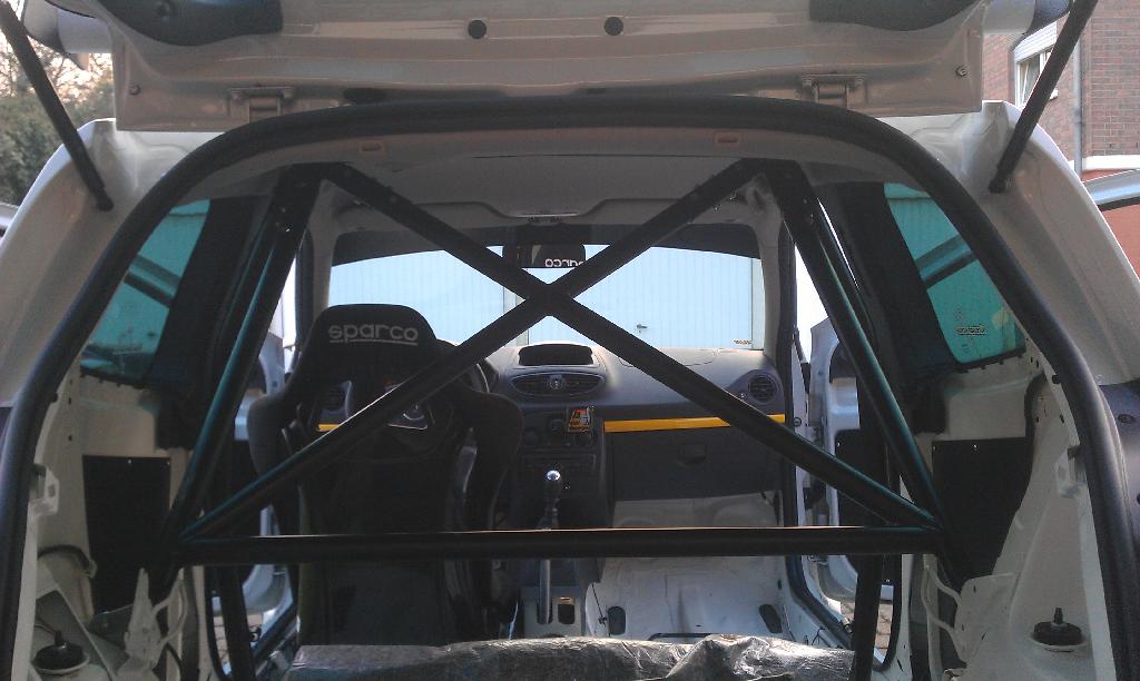

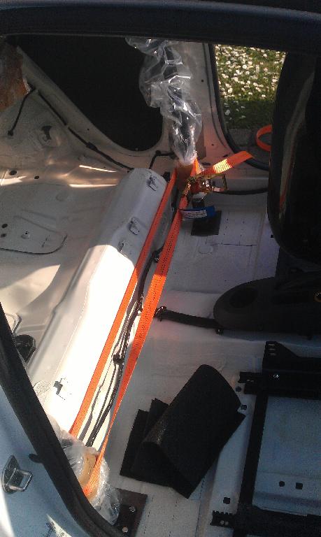

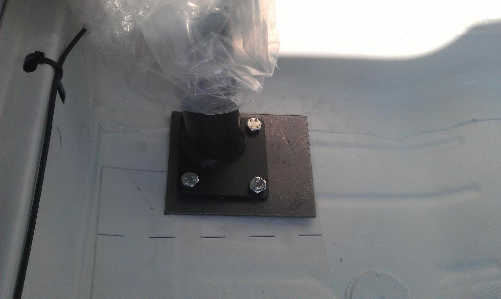

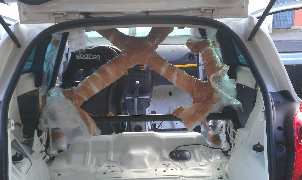

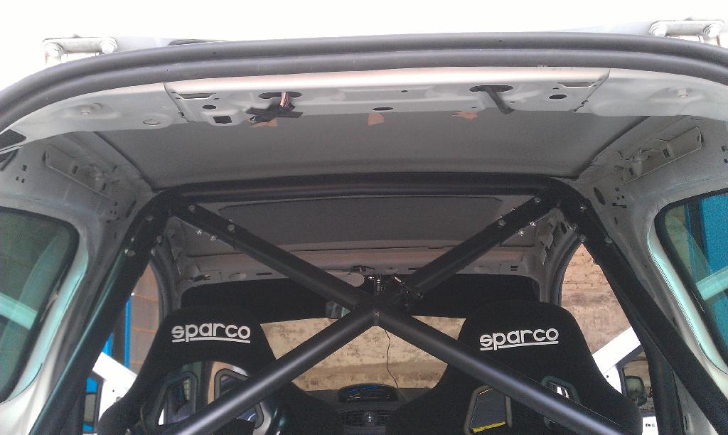

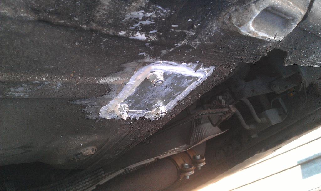

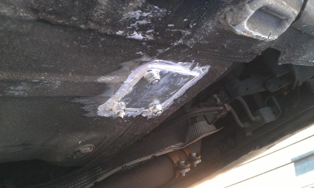

Now we went off the yoke finally installed. At the same time all holes were drilled for the straps. From the bottom of underbody protection was removed and everything sealed airtight with construction adhesive.
Then came again underbody protection.
The straps came in and thus the car for this season was finished. I was then again assumed the harness everything stripped clean and superfluous brackets replaced with cable ties.

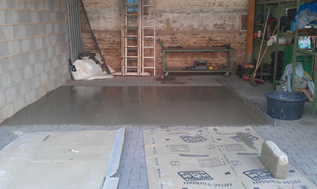

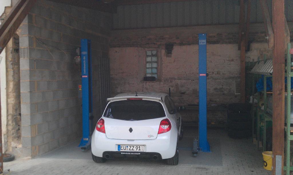

Now that I have completed all the work I've been thinking a stage set ...

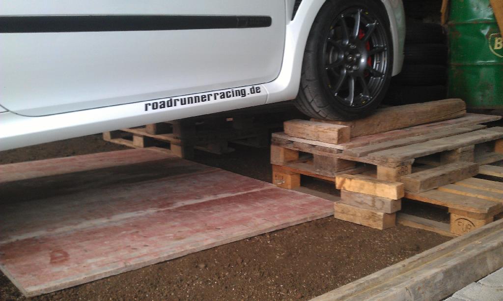

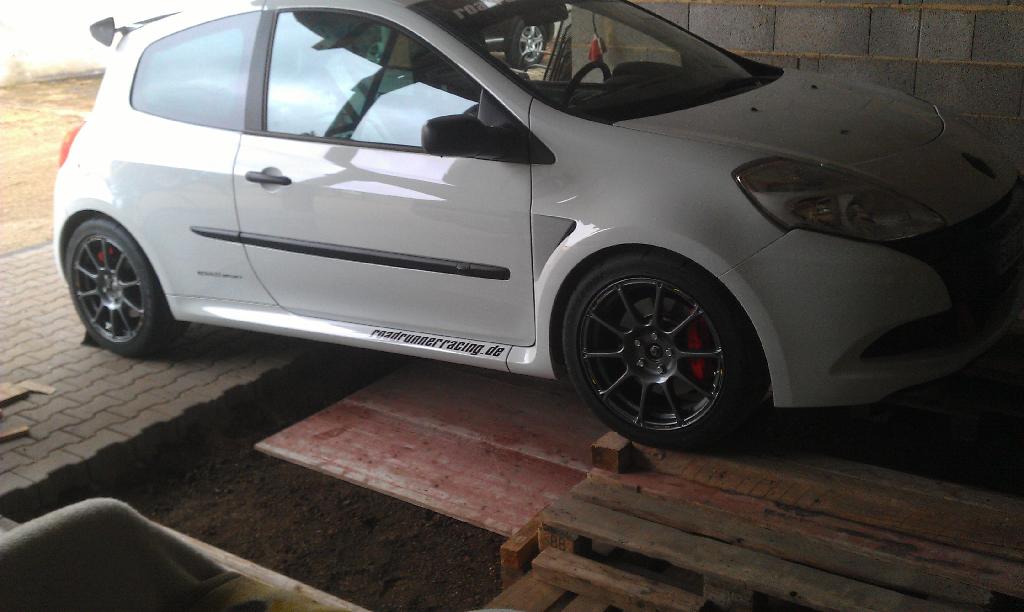

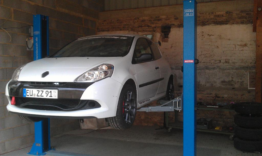

In order to perform work under the car I have also temporarily tinkered a bit. I know it looks from adventurous but unfortunately I need one or the other as for example, save the stage
  Clubsport Clio 3
So after the weekend to see the pads front of a little ****. gucks me again exactly, jeze where the stage is to do it quickly, just awesome.

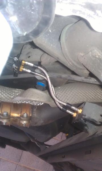

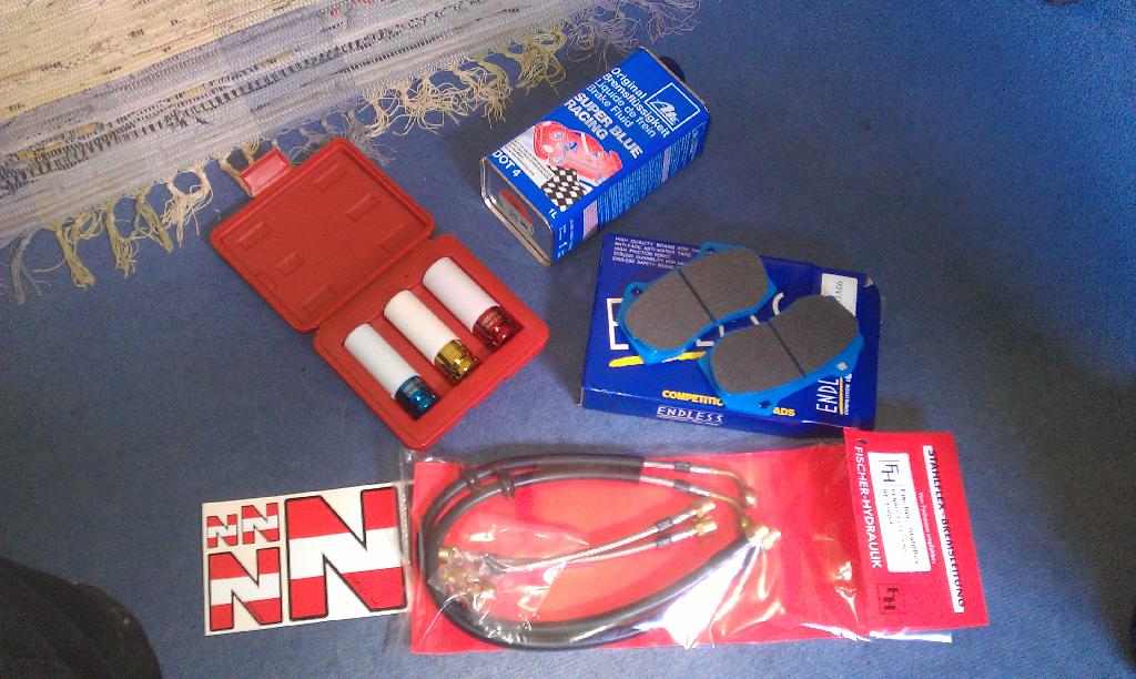

Since I was Friday already stood up again today to so a few little things. Steel braided, Endless pads brake fluid etc came in.

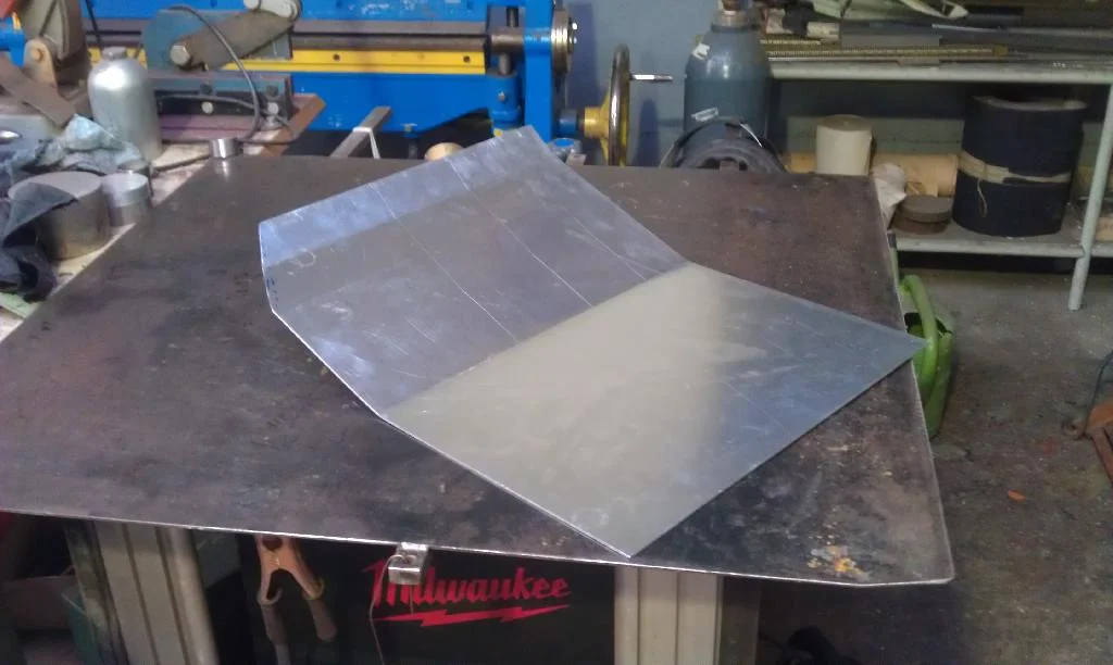

Here again two images of the Twin Busch stage. For personal use, super useful!

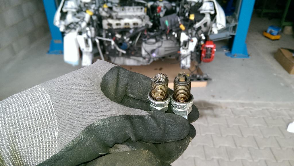

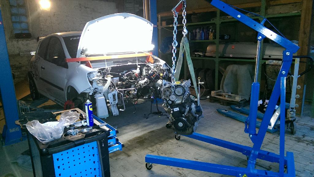

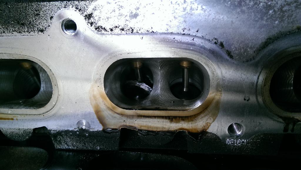

At the end of the season the engine broke...
Now im intaling a new one and a KW Clubsport.
