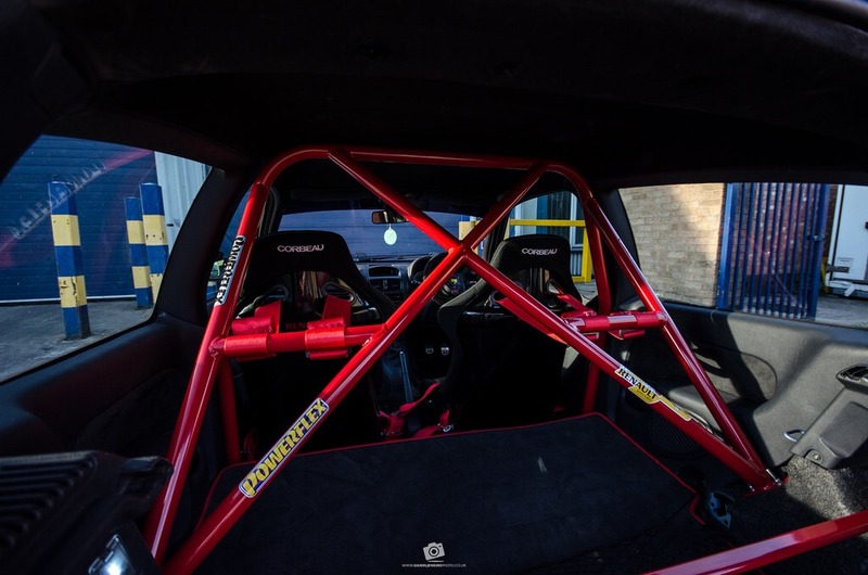

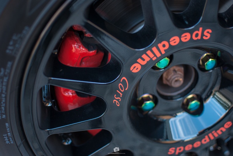

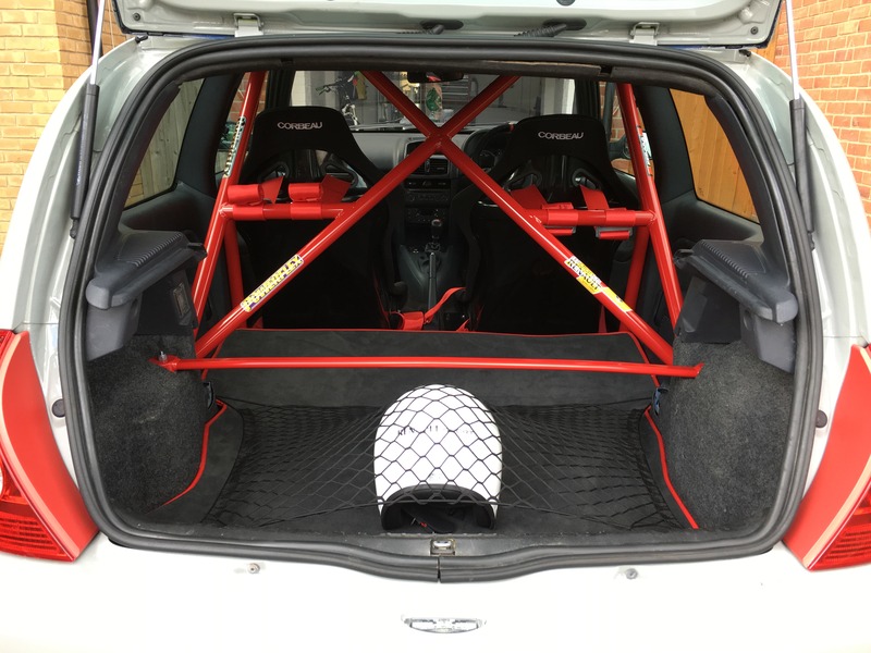

Rear OMP brave s**t blasted and powder coated same red as my cage

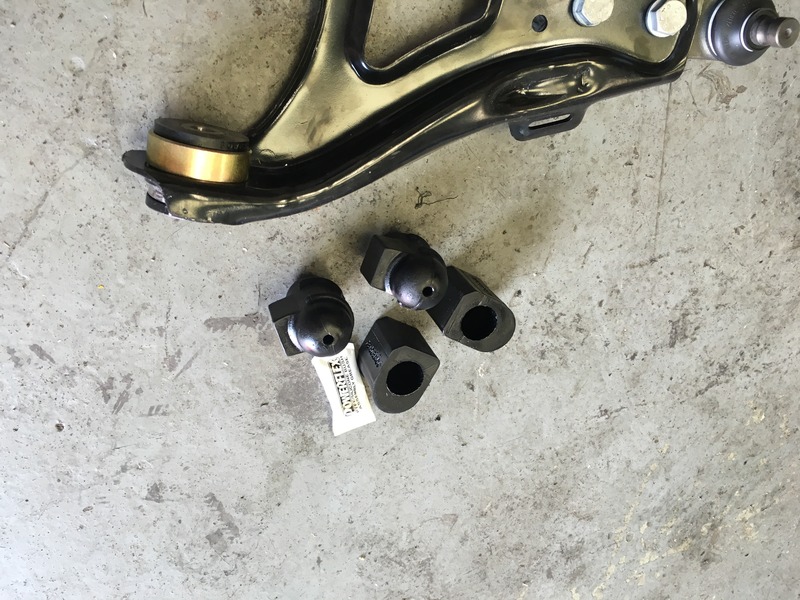

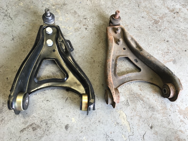

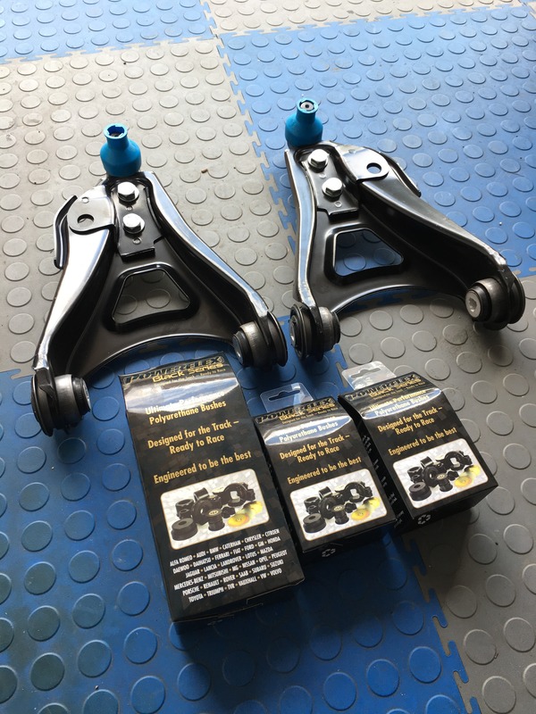

New wishbones bought for powerflex black series bushes and front inner and outer arbs to

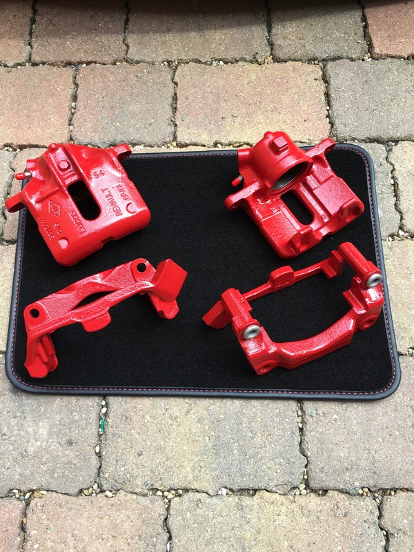

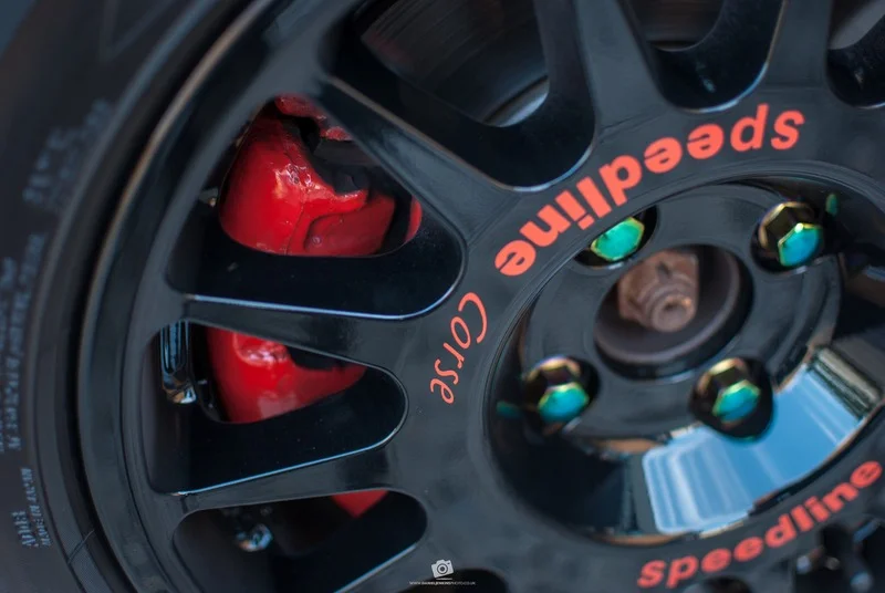

Shot blasted callipers and sprayed capsicum red, ready for new seals and pistons

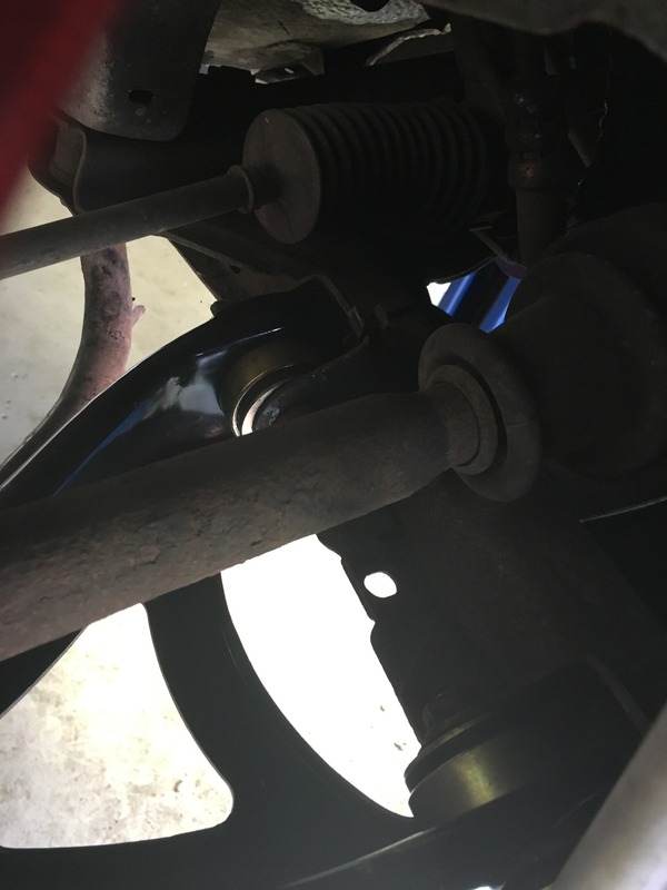

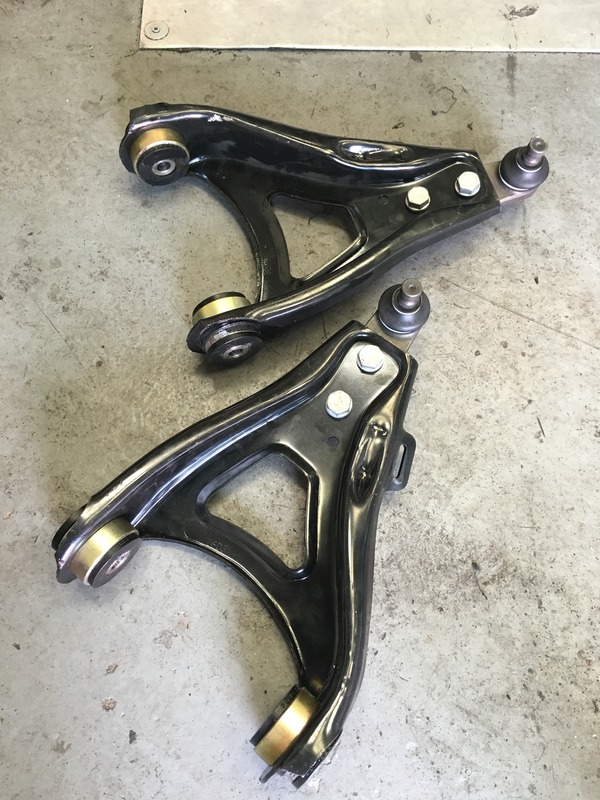

Had issues with the front wishbones as they was for a non sport so no hole for the arb to sit in. So after killing the wishbones to fit the powerflex bushes we realised there not going to fit lol
Got a refund on them as they was listed to fit the 2.0 but wasted some time with them and ordering new wishbones from Paul @ RPD
"Buy cheap by twice"
Had the black series wishbone bushes and inner and outer black series arb bushes fitted.

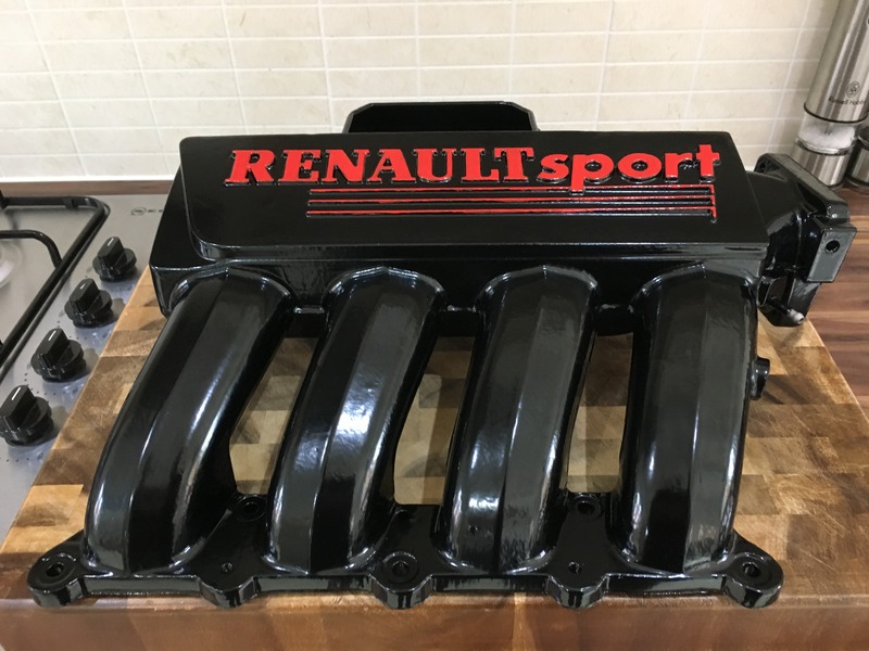

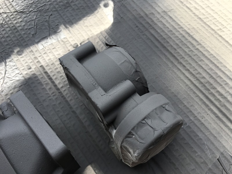

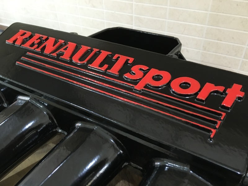

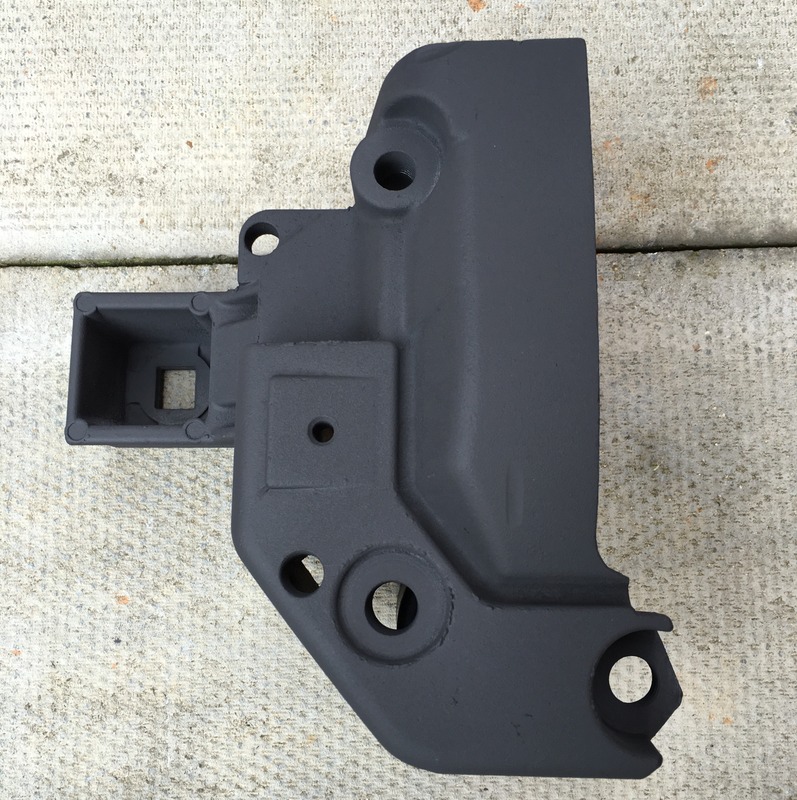

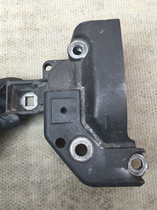

I also had the inlet and injector guard shot blasted and redone in gloss black and I re done the red on the RS to as will suit my car better.

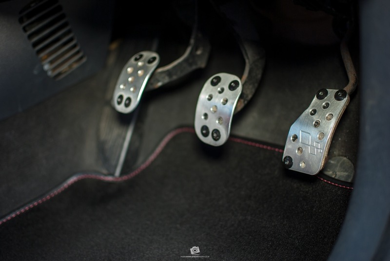

Had my new pedals fitted which I'm happy about as was one of the things I wanted doing since I had the car.

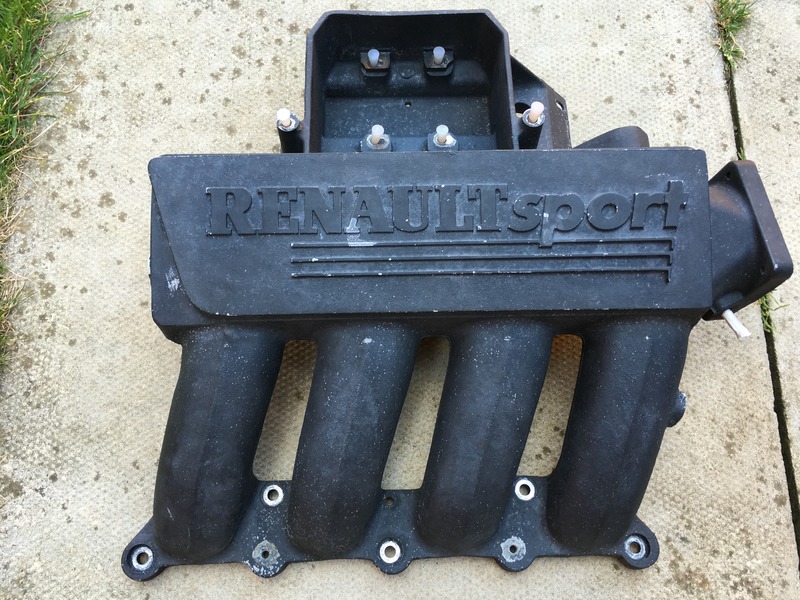

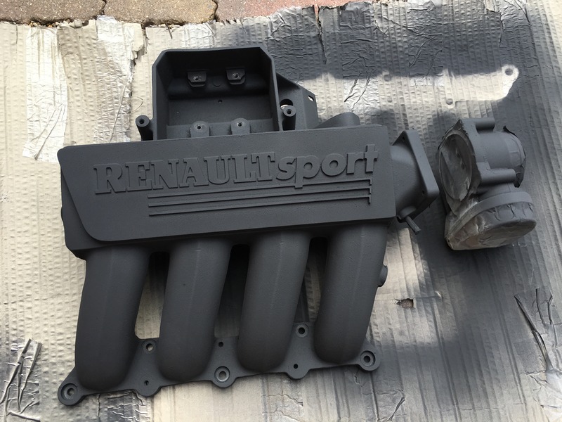

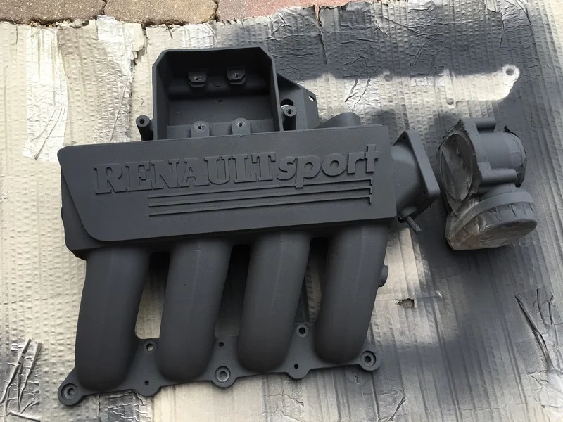

Well fitted the black and red inlet and I recently discovered it was for a 182 and blocking of the "purge valve" wasn't working and was causing the engine to whistle on idle so I gave up and sprayed my one on the car with matte black VHT paint and done the cambelt cover and throttle body to.

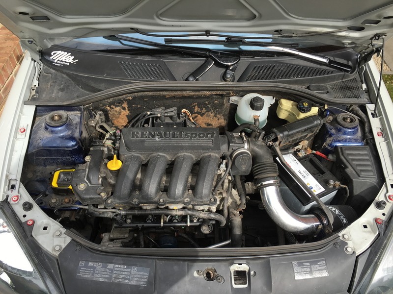

Bay needs cleaning up so ive started to clean it up and looking half decent.

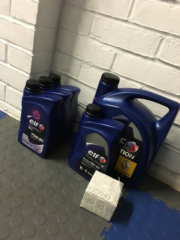

Refurbished callipers and oil/gearbox oil getting changed Wednesday.

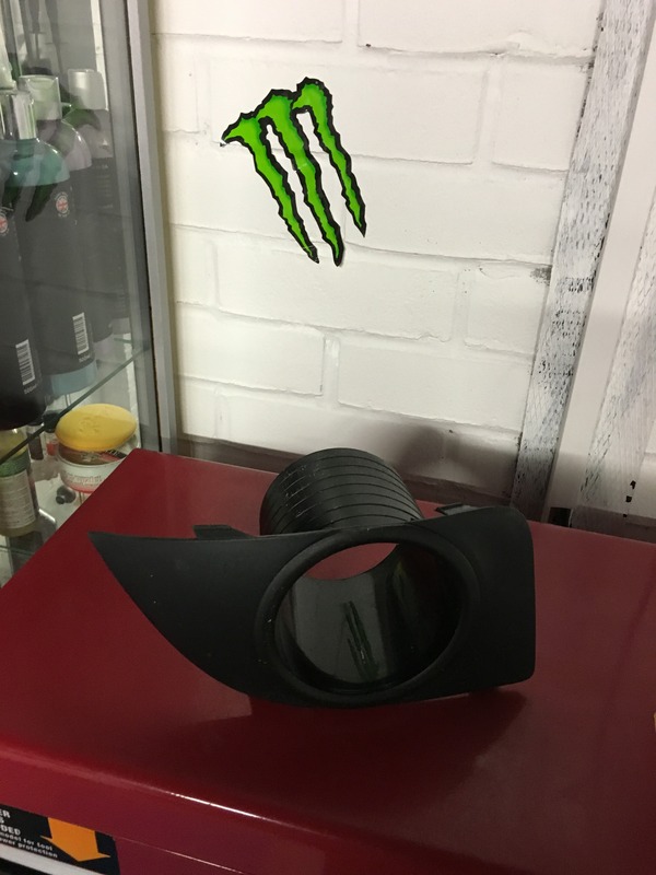

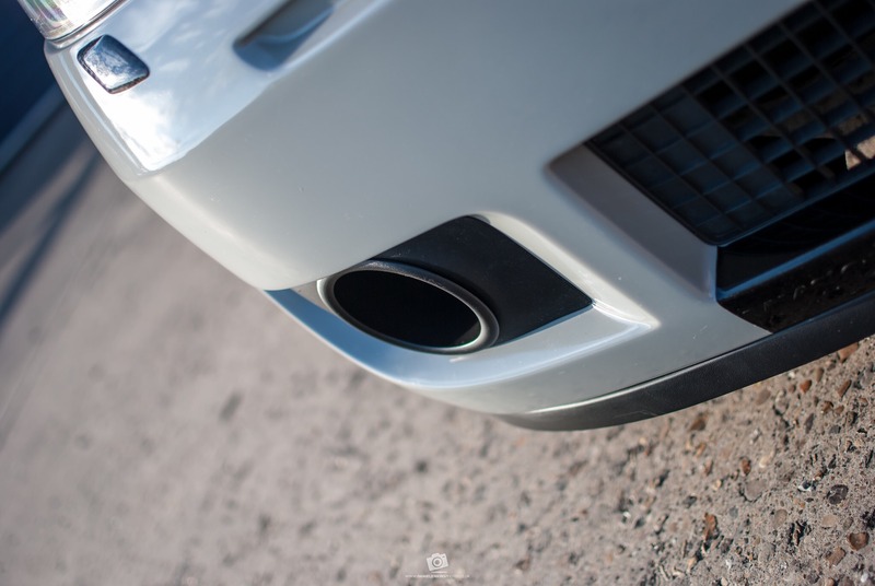

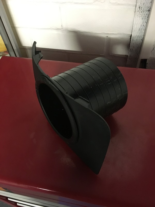

Today I fitted the air ducts to the fogs. Gives the car a better looking front end and I will route piping in time to.

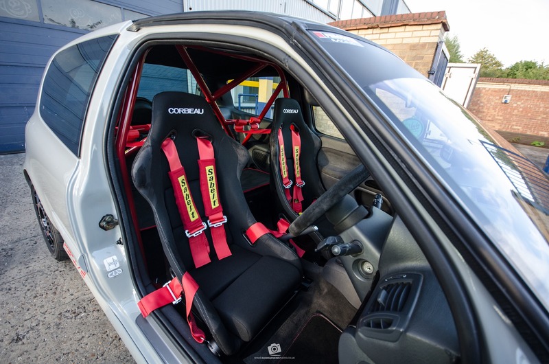

Just had the shoot with Daniel Jenkins and got some great shots.
And my favourite pic (sorry I love a few pics)

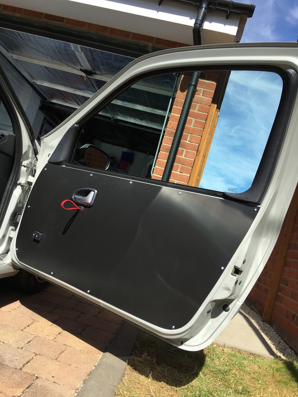

Fitted a door blank to drivers side as once I lowered my frames using the X-low's my elbow is hitting the door card rest

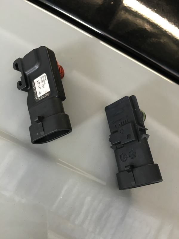

So my on going issue with the engine is nearly closing I hope. It's with RS Tuning next week to see if the can sort it and map it too.
Fuel trims are out as the ecu is holding fuel back as its running rich and the manifold pressure at its highest is 429 so to high.
I've got a OE map sensor from Renault to fit to rule that out.

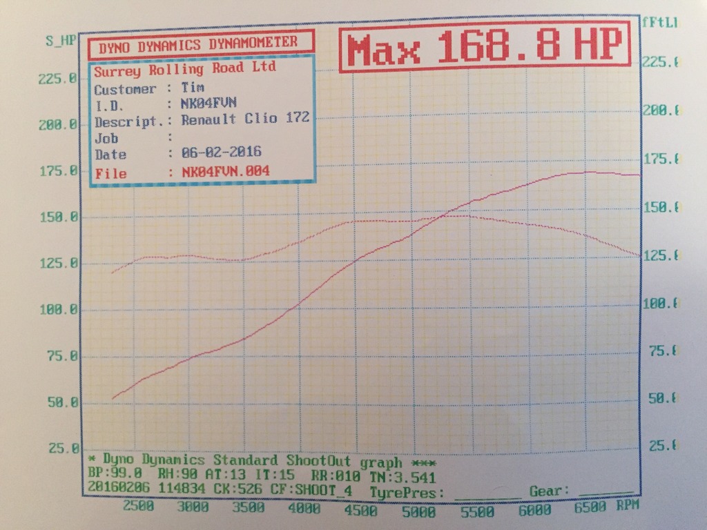

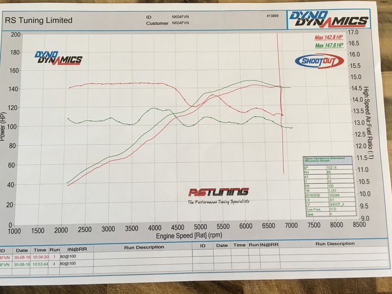

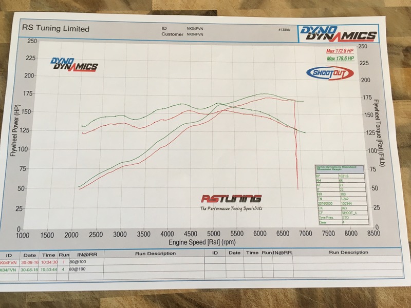

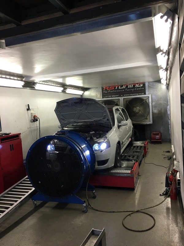

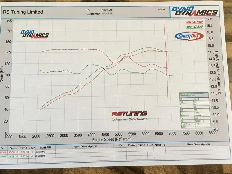

So finally got the car on the RR to see how it would perform as had a few issues with it not running right.
Was RR by previous owner @TimR26 when he had it at Surrey RR I believe.
It ran 168.8 which is good. Since then it's had new injectors, fatty induction kit and a new OE map sensor and also the timing corrected as it was out quite a bit.
Today it run 172.8 with above corrected. I was pleasantly surprised due to the engine not running right and having near 100k on it.
Then after Paul at RS Tuning played around with it we see a figure of 178.6 which I'm more then happy with and the drive is so much better and more punchy and pulls much better.
Cheers

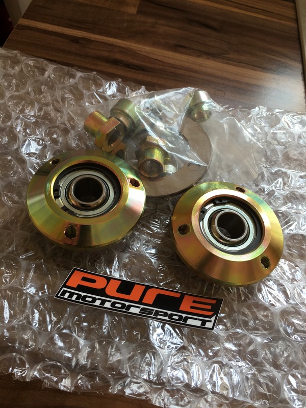

I have a clunk and squeak when coming of my drive so ordered some PMS solid top mounts to cure it hopefully

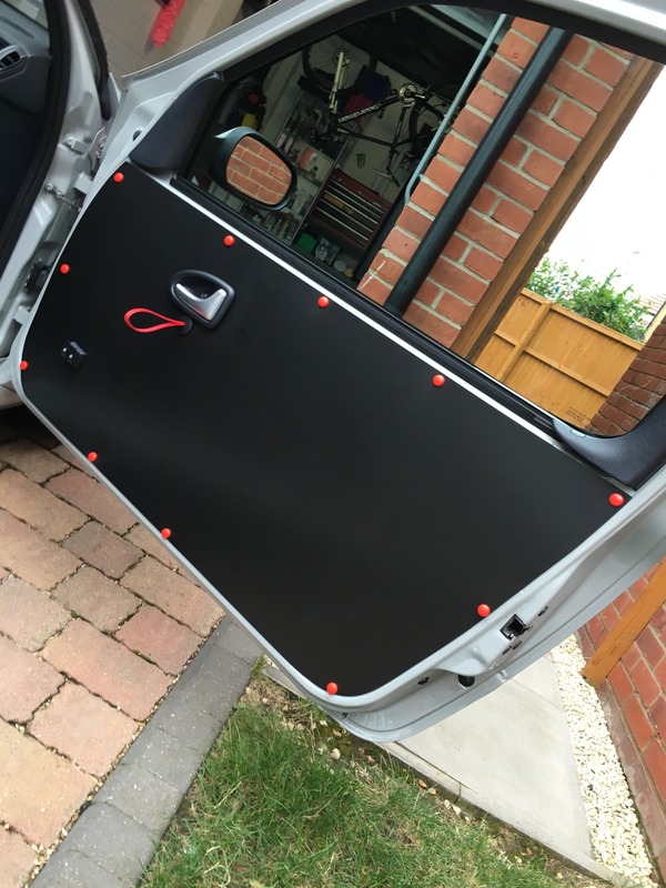

Fitted some red caps onto the self tappers on the door cards
