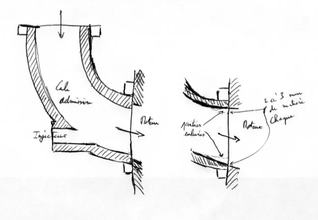

I'd like to know the truth about this. In the picture is a drawing of how the original (172) inlet is originally a little restrictive.
How about the rs stamped ones? Do or don't they have the restriction?

If your engine has standard inlets and you want RS inlets. Do you have to get them matched to the head or to just the upper inlet ?
DaveDreads
What does that concretely mean, a better casting? Better flowing, less restrictive..?
Yep, less restrictive, better airflow.
Getting standard inlets 'matched' does the same thing,
I already have an RS inlet so having mine matched did sod all apart from making me £170 quid worse off.
