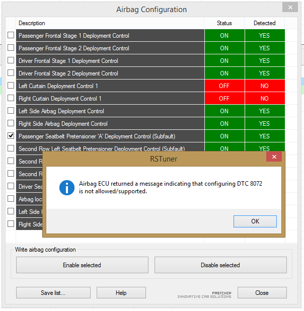

So I've plugged my new RS Tuner (with the Airbag module) in and it confirms my Airbag light is on due to the pretentioner cables under the passenger seat.
However if I lock and then configure the Airbag ECU, it won't let me disable the Pretentioner causing the issue. It says the "Aitbag ECU returned a message inndicating that configuring DTC 8072 is not allowed/supported".
Any ideas? I'm a bit peeved as the only reason I've bought an RS Tuner is because I was told it could disable Airbag components. It does... to most bits, but specifically won't disable the bit I need it too!

And if you read this thread properly you will see that I can't alter the configuration on the pretentioner, the ECU won't allow it. Locked or unlocked it makes no difference. I can disable all other parts of the airbag system, just not the 1 part I actually need disabled.

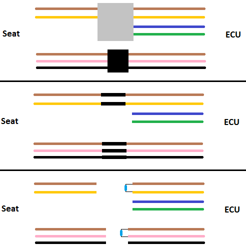

This is the 3 setups I've so far tried, all suggested on here, to get the light out, with no success. (stock setup, then joining the wires bypassing the connectors, then using resistors)
So if I am reading your suggestion right, I should disconnect everything so the wires aren't connected to anything, then try disabling the sensor in the Airbag config? I'll give that a go, but how is this any different to my current situation as the fault that is showing is "Left Pretentioner (open circuit)"? The ECU already thinks the circuit is open, not an out of range closed circuit.

Oh and MickPM, your suggestion about disabling the sensor when it was disconnected still doesn't work. Even when the Airbag config showed "No" in the Detected column for a pretentioner (once I dissconnected everything and cycled the ignition, and locked the EC), it still gave the same "not allowed/not supported" error message when I tried to disable it.
