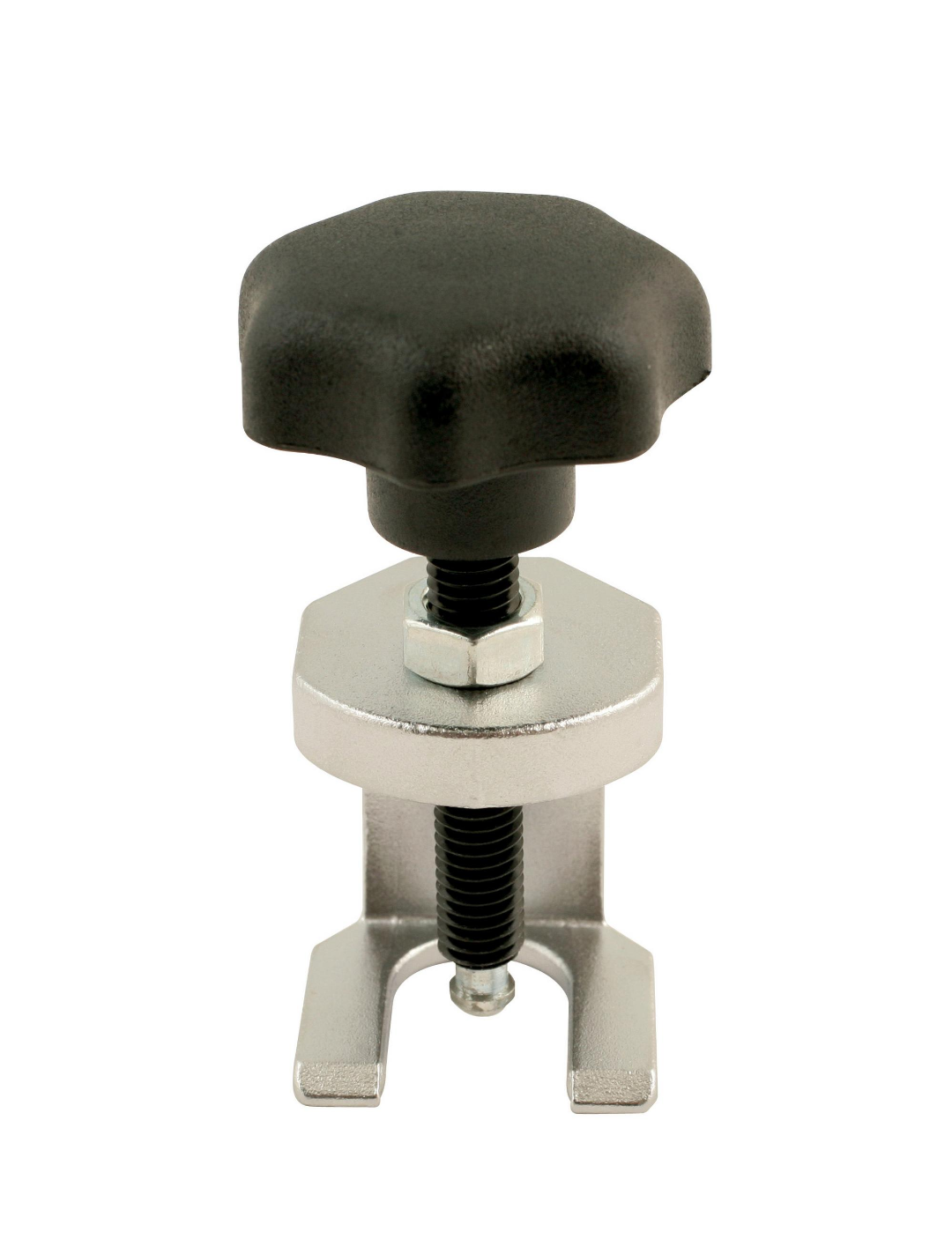

Done a few things this past few days.

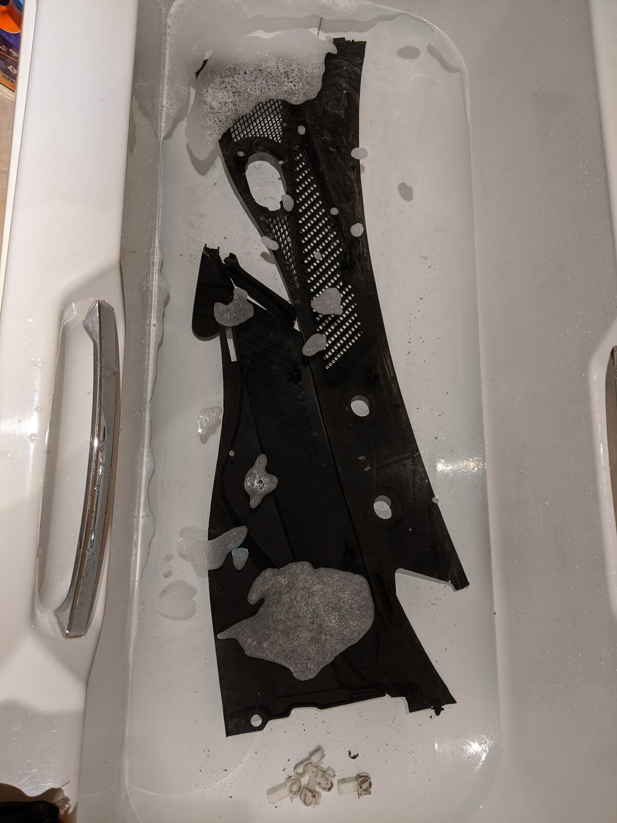

I wanted to check the drainage holes as my window keeps steaming up.
So I bought a lazer wiper removal tool.
Even with that what a s**t job.....
Especially the passenger side which i tackled first as I heard it was a ball ache.
Unfortunately it got to the point where I could actually grip the black turning devise on the wiper removal and it was really hurting my hands, I tried rubber gloves and a towel but it wasn't having it.
I was trying to find somthing like an oil filter removal tool to wrap around but went one better and used my belt.
Once wrapped around the two buckle bars fitted in to the grooves of the black hand turner wedging the leather of the belt in which made it grip and made easy work of getting it off. Hopefully you can see what iv done below.
Once arms were off I took the scuttle out and washed it in the bath with some Feynlab. Rinsed and dried it with the Mrs hairdryer so I could apply some C4 Plastic restorer.
That was left over night to cure as it has a 12 hour cure time.
Unfortunately I forgot to take some pictures of it before and after but the after results made a huge difference and IL be doing the rest of the plastics at some point too.
I also removed wiper arms and washer bottle and checked/Cleaned them and underneath them. Didn't remove the heaterbox but cleaned the bits I could see and managed to see enough to check the drainage hole.
I even did the secret middle hole that alot of people forget apparently because let's face it, what a stupid place to put one.

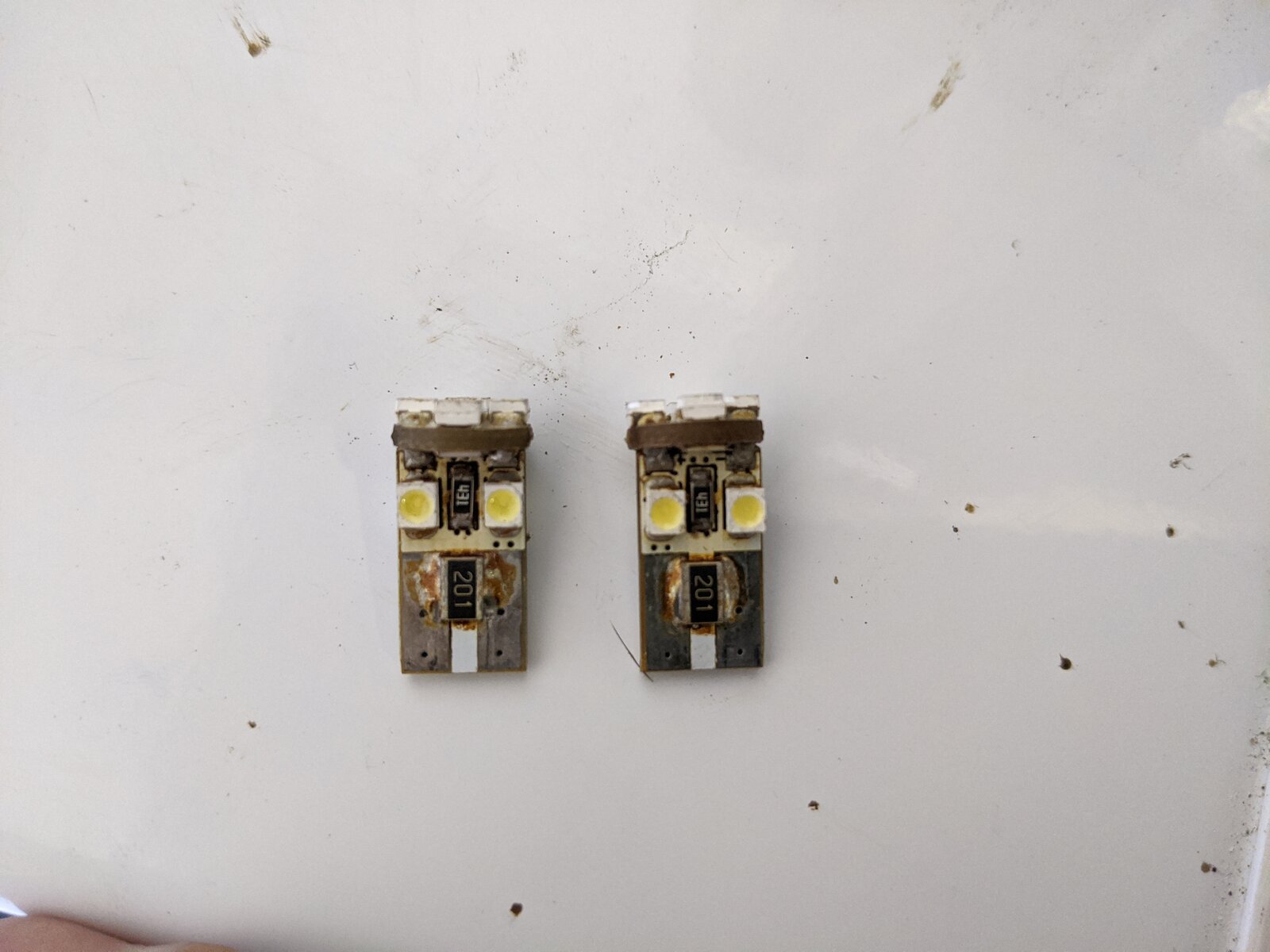

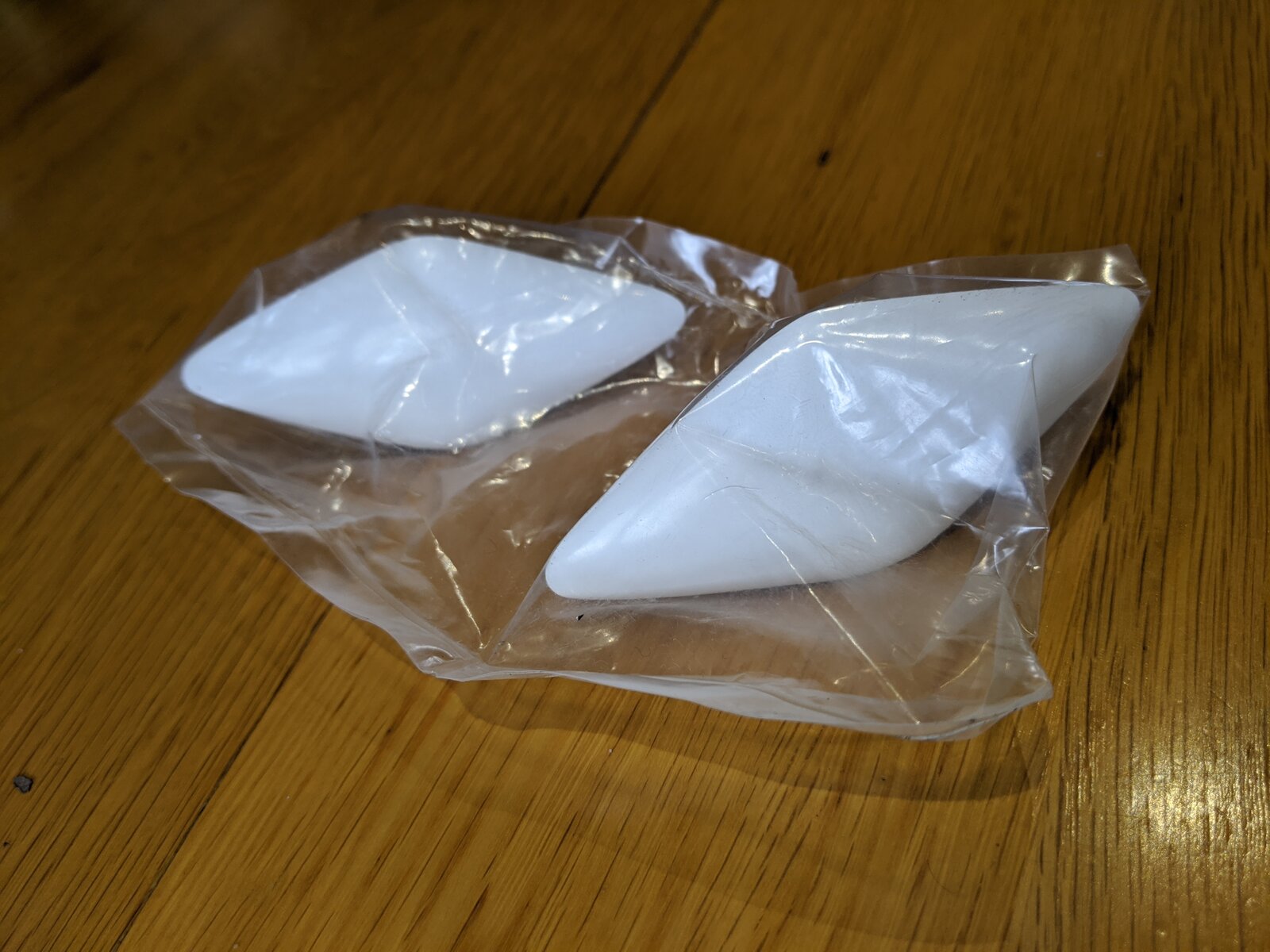

Another little job IV done is change my side lights as the LED ones I had in when I bought the car were flickering.
Replaced them with some Osram LED's.
Safe to say they needed doing.
New ones.
There a pretty good colour match to the projector lights but my god what a pain in the arse to get them out.
Now I have small hands and struggled so for you guys/girls with bigger hands good luck.

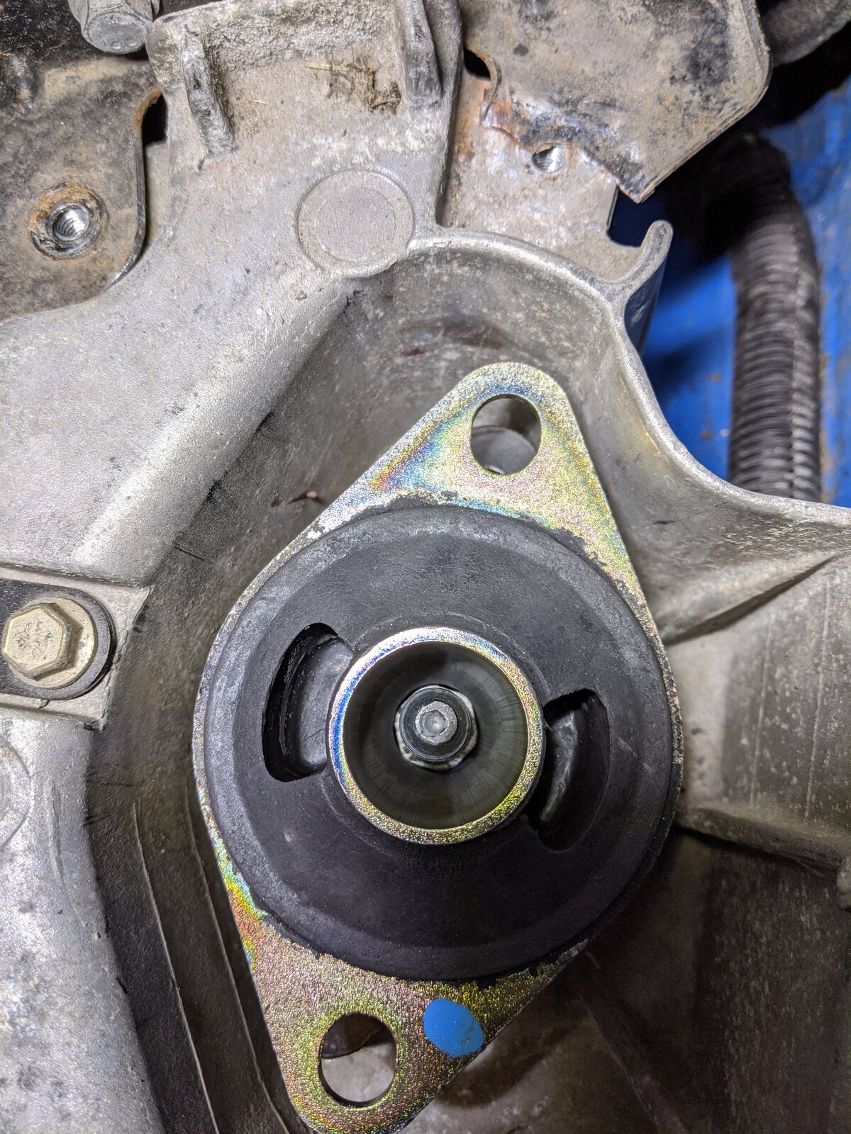

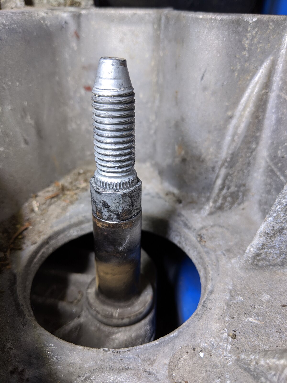

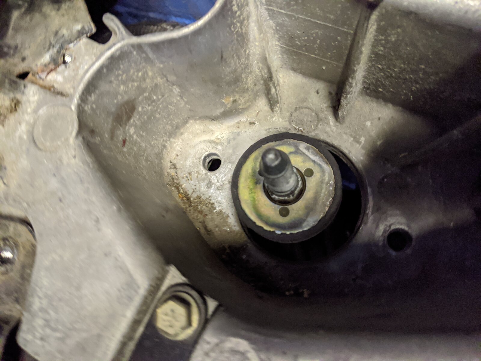

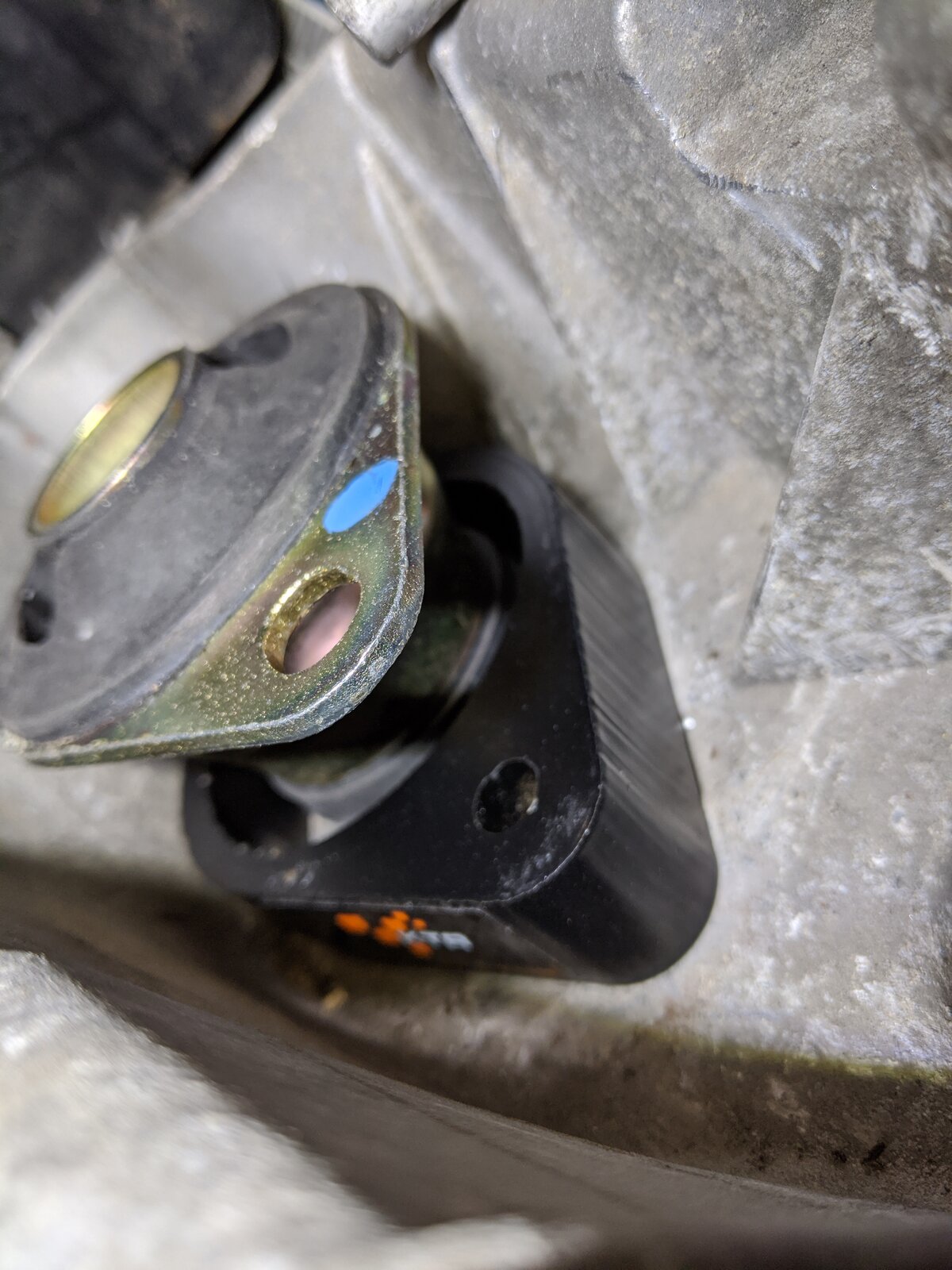

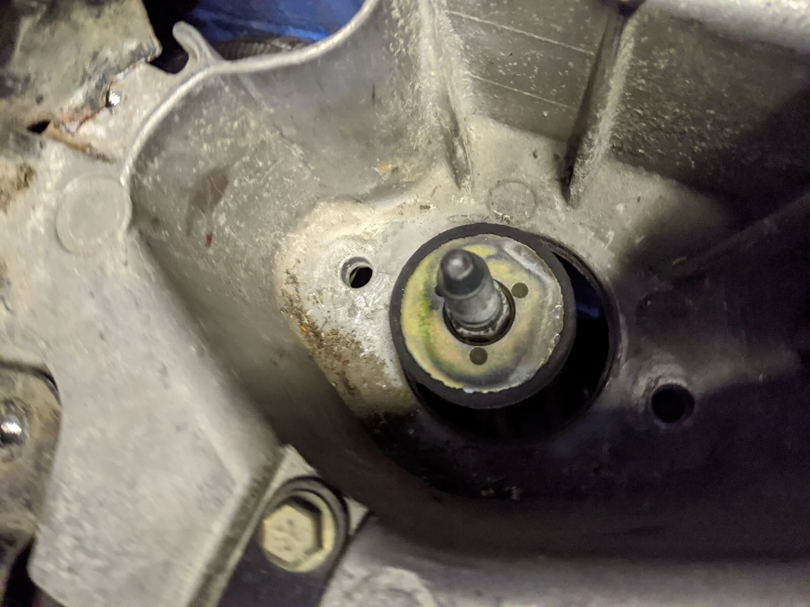

IV taken the plunge and bought some KTec engine mounts, they came last week.
Today I tried to fit them, well the gearbox one as I knew it was going to be a pain in the arse.
And it was, the mount dose not fit over the gearbox pin correctly and I have been talking to KTec most of the day.
Here are some Photos.
As you can see from.the thrid picture the new mount will not fit over the hex on the gearbox pin. But also the washer type part won't go far enough down in the first picture.
Ktec are ringing me tomorrow as they think that the gearbox pin is incorrect.
So IV had to out it all back together tonight as I need the car tomorrow.
I'm really cheesed off if I'm honest.
Everything I try and do with this car to make it better seems to turn in to an issue and I'm starting to get disheartened by it.
It runs great, it's nippy enough and looks good, I just want to make it better.
Maybe I should sell it tho.
Pez
RSPez
  Clio RB 182
Update on gearbox mount.
So after chatting with KTec some more and a close friend of mine who works at a garage and deals with TVR builds I decided to use a small socket to bang the mount over the pin.
It's gone on and it's all back together gearbox side. Drivers side is easy and was done with in about 10 mins.
Had a quick drive and can confirm the vibrations are a little bit more but not much more than before and I'm sure it will settle a bit in a few days
Gear change feels more direct and changing down is much better for revmatching.

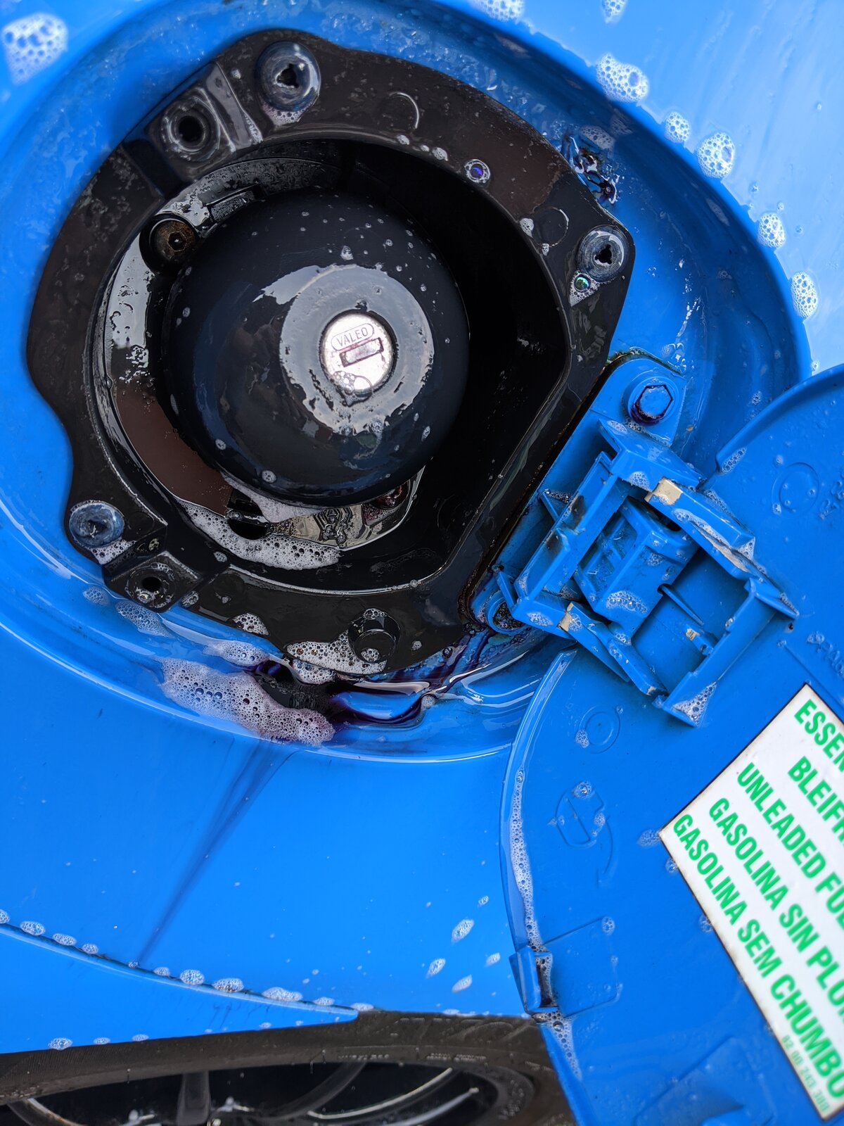

There is however a few spots of rust around the rear arch and under the fuel cap which will need sorting soon.
No pictures as it brakes my heart.

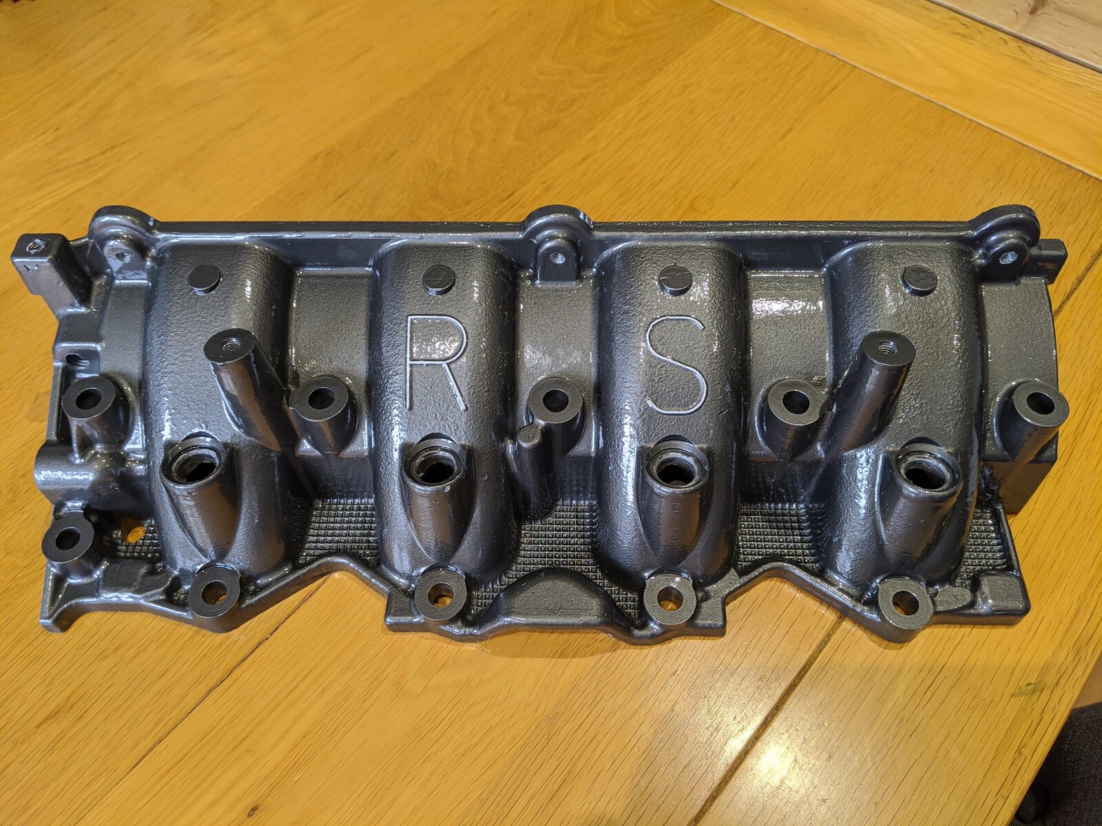

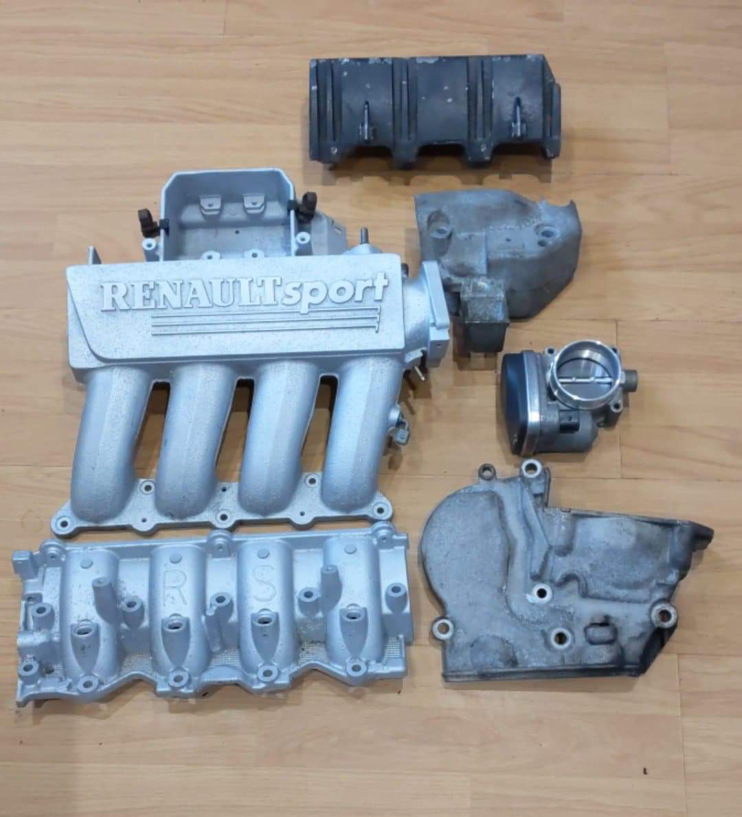

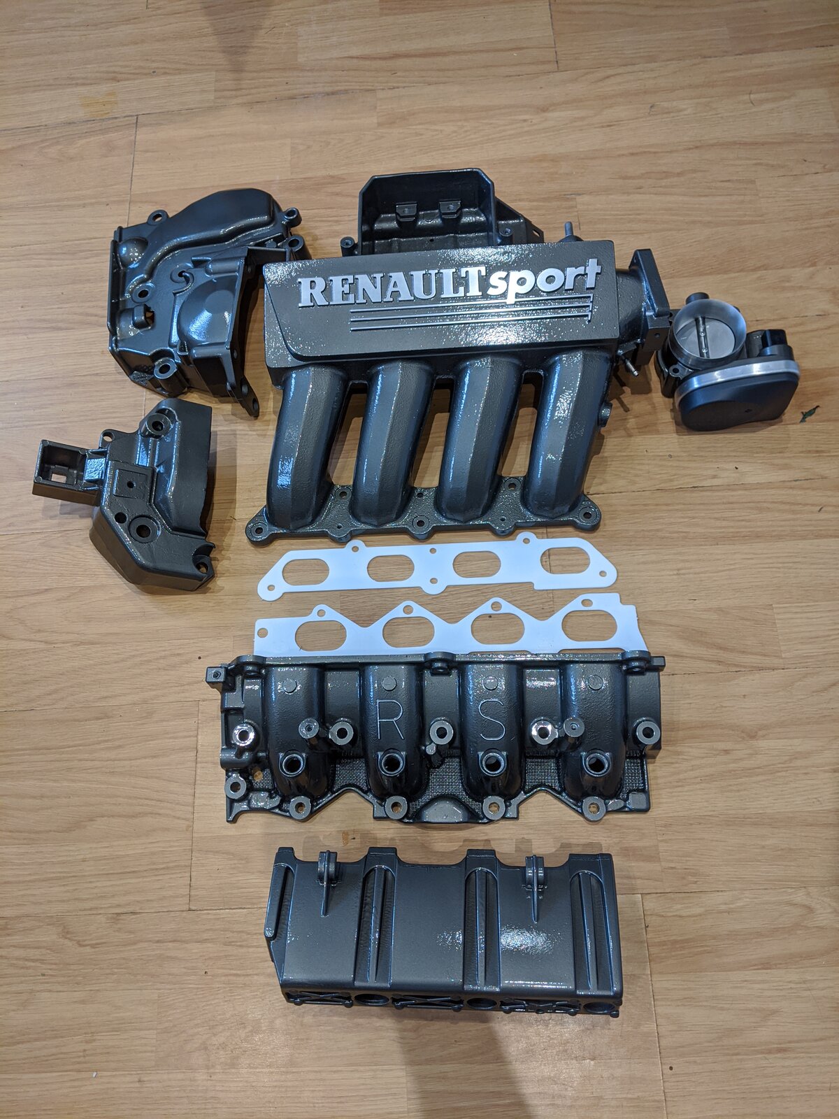

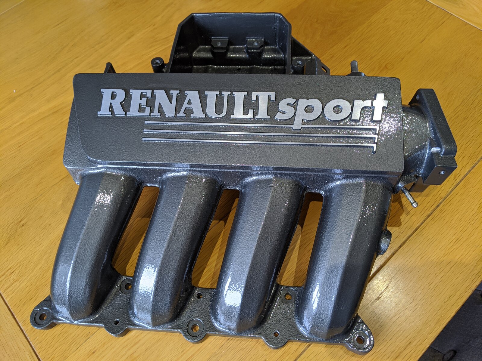

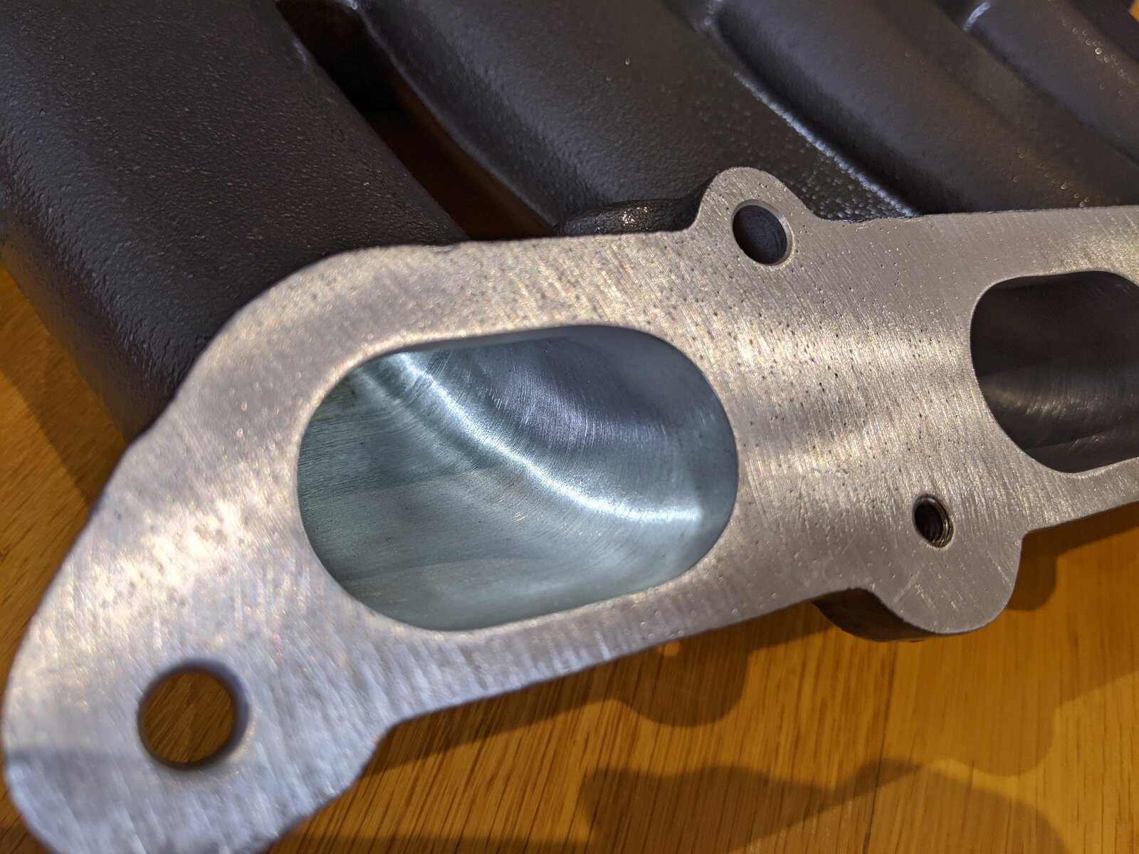

The bits I sent off to Max at MS custom engineering have come back.
I'm really pleased with the results to say the least.
He's a top bloke and his customer service is A1.
I was going for black but changed my mind at last min and went for Anthracite.
Work done as well as the colour change is

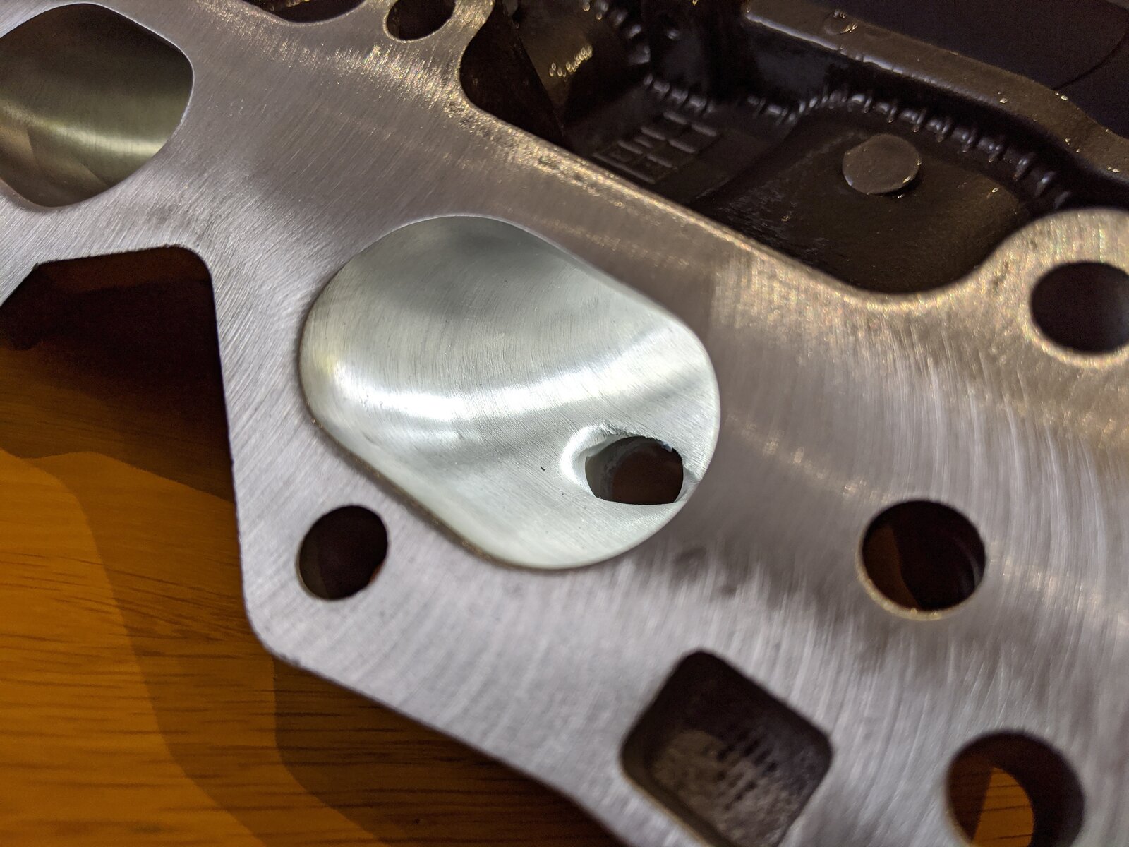

Port matched and flowed inlets and throttle body.

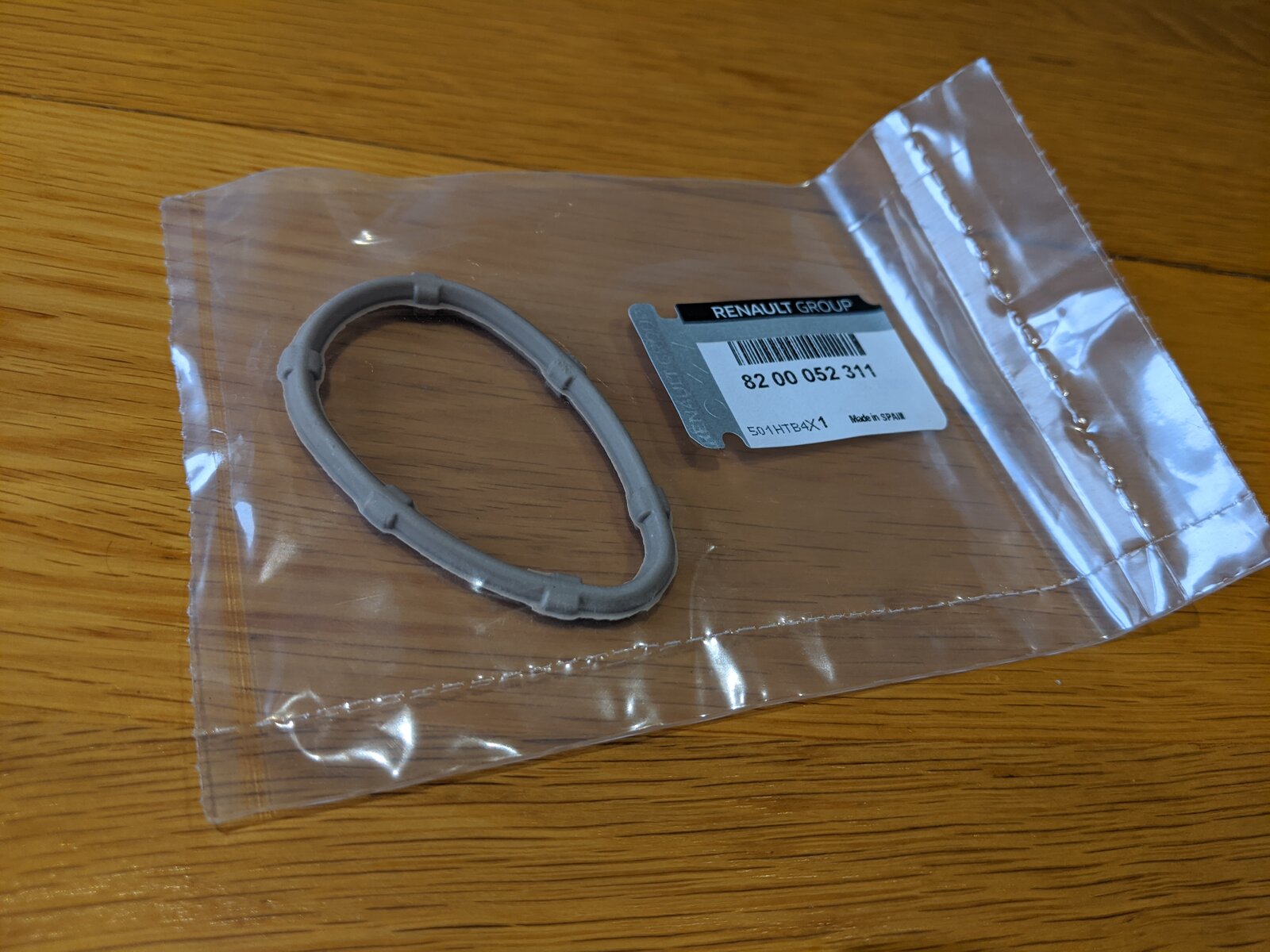

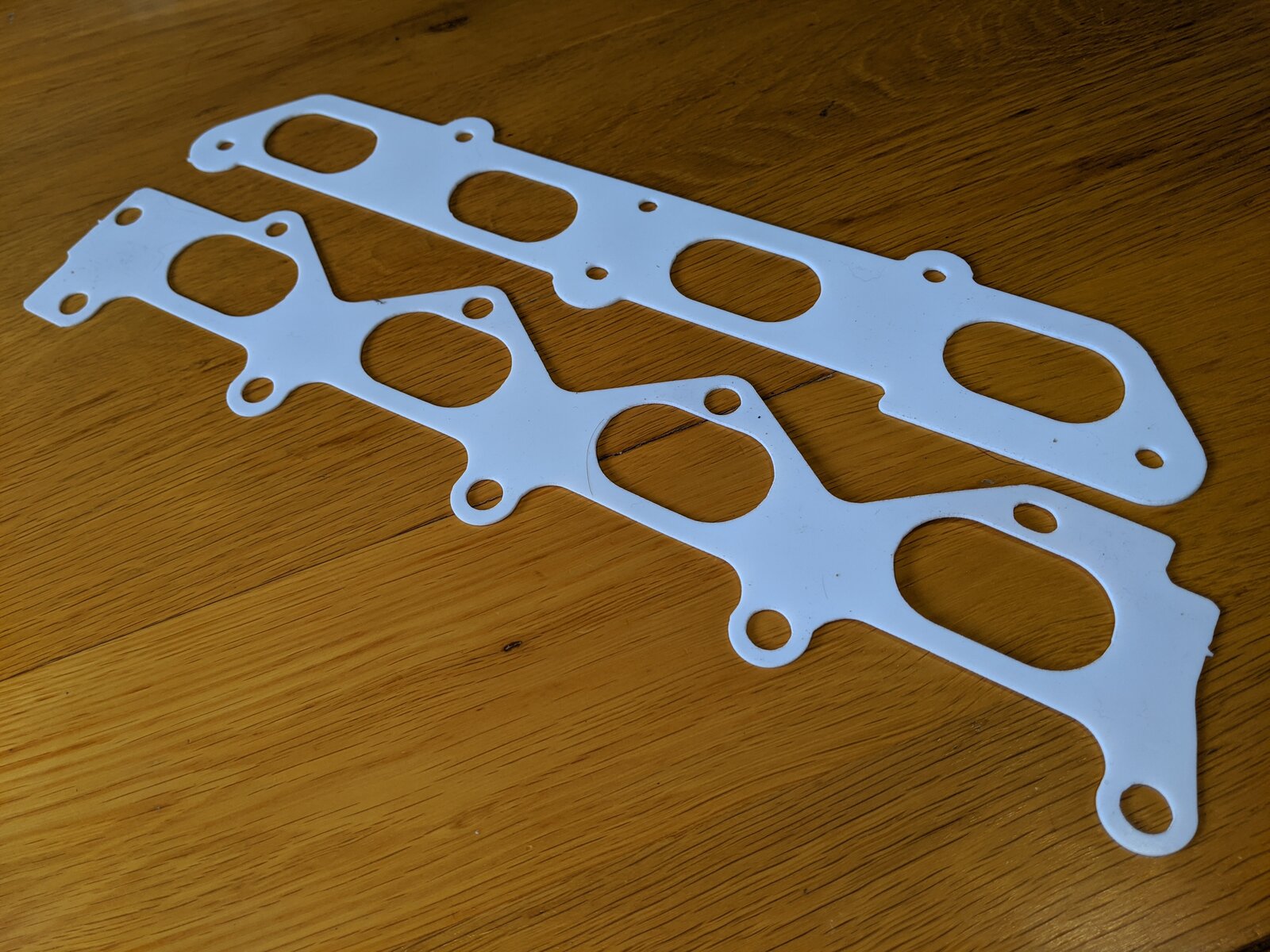

Also I picked up some PTFE gaskets and a new manifold to rocker Gasket.
Won't be fitting these for the time being as I need to have my rocker resealed when the belts get done (who knows when that will be now) but will give me a chance to get some 197 cams and sort out money for the timing and map to be done

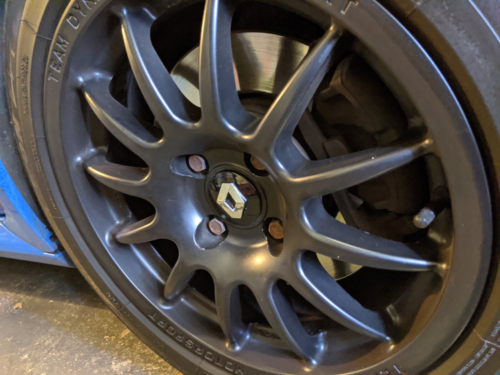

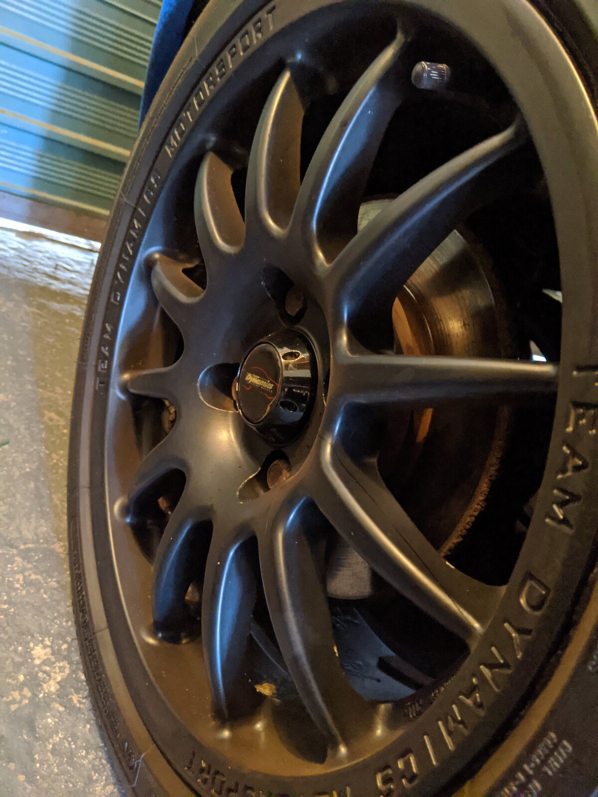

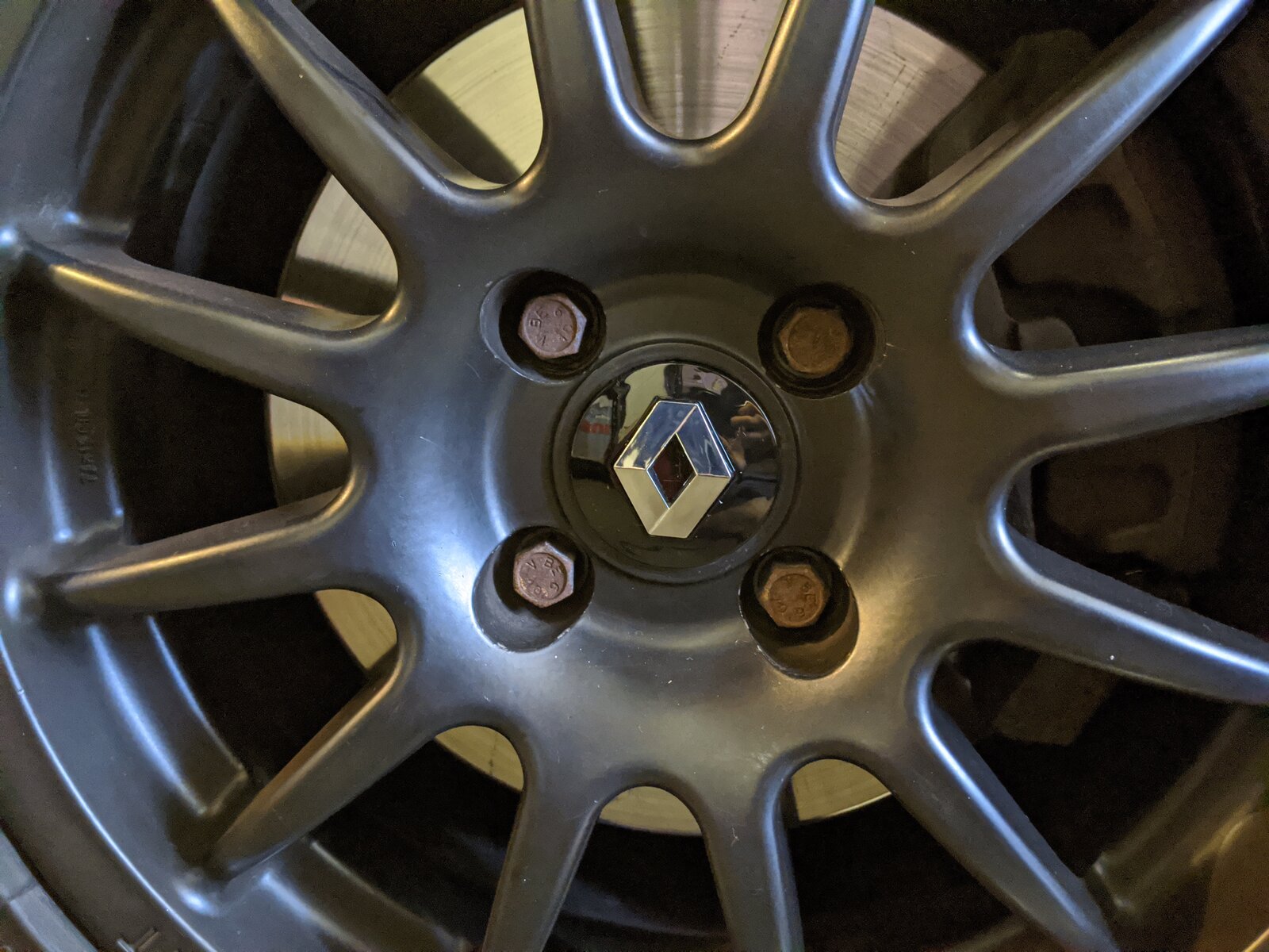

I really hate the Team Dynamics center caps they are almost an after thought and are bulky and ugly.
I bought some Renault ones to replace them, they were to small but with a bit of modding I have manged to get them to fit and they haven't come out yet.
In my opinion they look a lot more sleek and sit more flush in the wheel.
Before:
After:

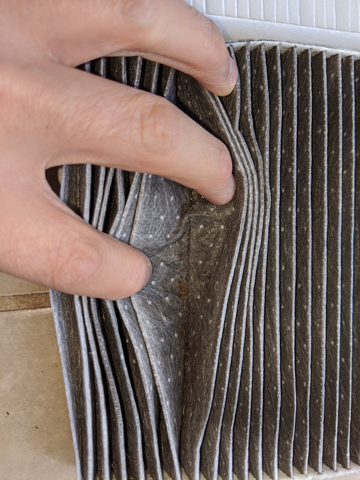

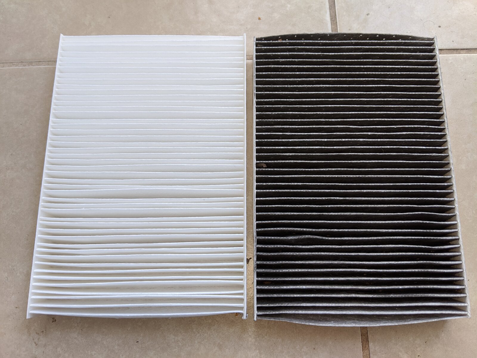

Next little thing was the replacing the cabin filter. It's been on the shelf for ages and IV just not given it a thought until I seen someone else had done there's on a video.
Looks like it's Done its job well :)

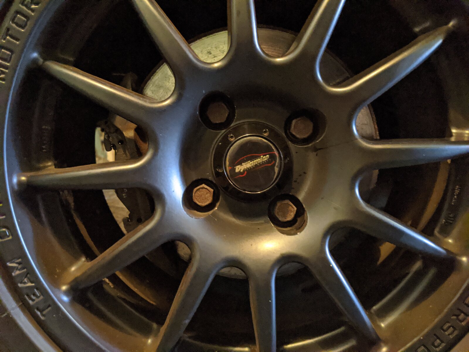

As above you can see my wheel nuts are looking a bit grim. So is it better to replace them for new and put some cap covers on or
Put some cap covers on what I have as I want to do a stud and but conversion later on down the line?
Dose anyone have any links for some decent nut covers?
Thanks

If your going to do a stud and nut kid, why not just leave the covers for now?
Also, using a DA is easy, especially after watching some YouTube videos. Clean your car have a decent starter kit and is great for beginners.
Center caps look a nice touch and better than the bulky TD ones. Like you say, seems like a after thought with the TD caps.
RSPez
  Clio RB 182
Thanks for you kind words Mark.
I will have a look at that link now.
I will order some caps tonight they freshen it up for the cost of a few quid :)

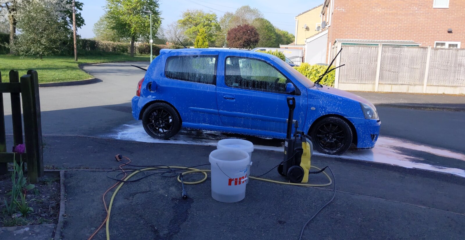

Considering all the time we have had I decided to do a full clean on the car.
This consisted on
Body:
Rinse
Snow foam
Wash Feynlab
Ferrum
Rinse
Wash
Clay with soapy water.
Blacklight
Feynlab detailer/seal

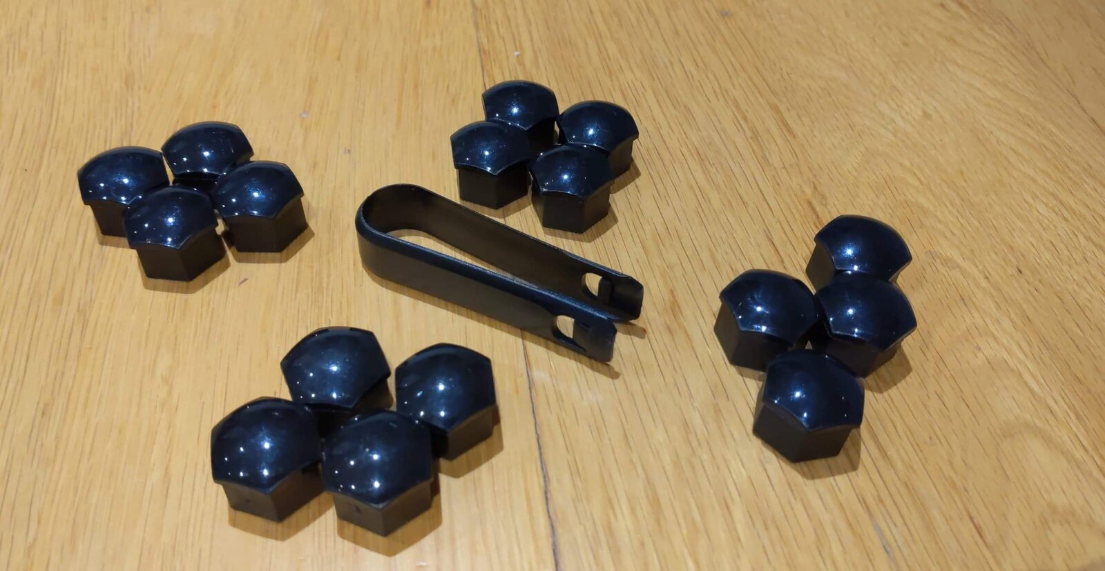

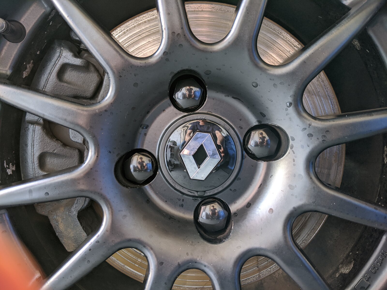

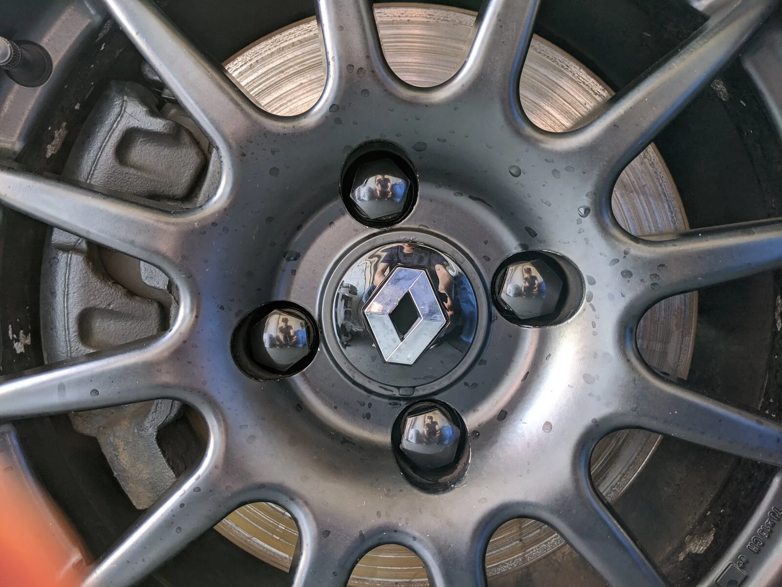

Nut caps also turned up so they are now on. Think they were £6 posted and looks loads better for the time being.

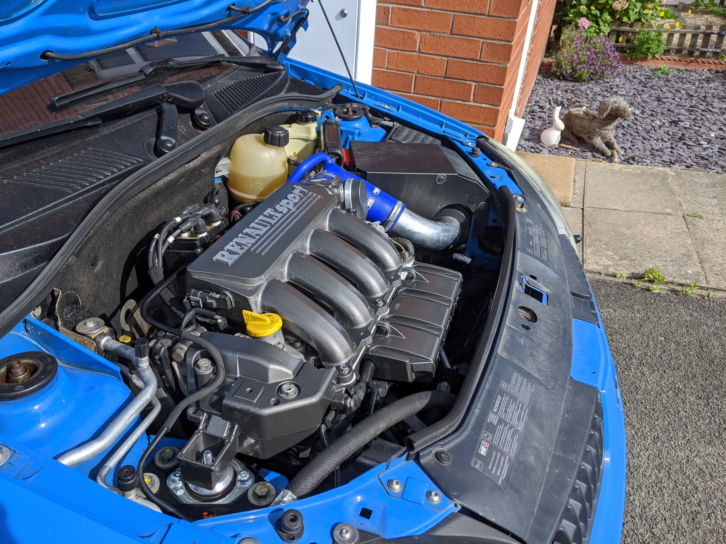

Still not had the belts done but iv swapped over all bits that were sent to MS customs apart from one part (The rear upper cam cover).
I will ask for this bit to be fitted when the belts get done.

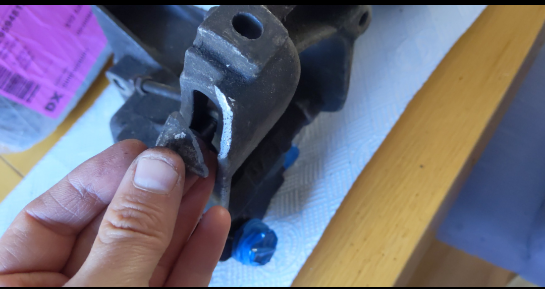

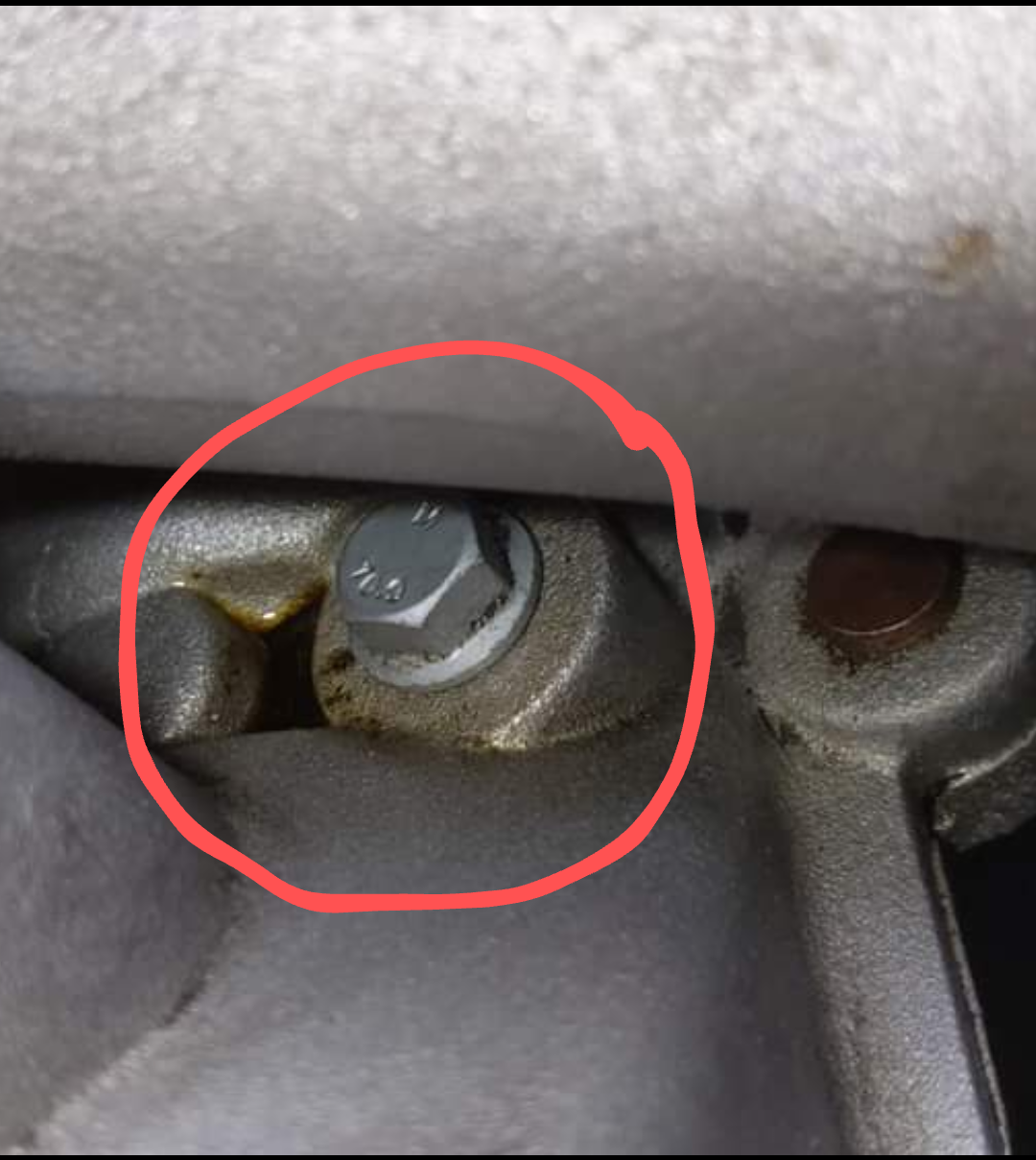

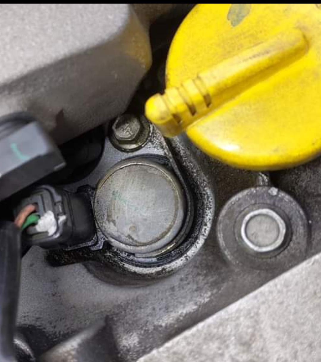

I mentioned that I had an oil leak coming from the seal on the rocker cover in previous posts.
While the inlet was off i had a bit of a tidy and found out it was actaully a rocker bolt, I have sorted that now with some thread lock.
( I really want to have the rocker painted the same colour as the inlet)
I am also going to replace the Dephaser seal when belts are done.

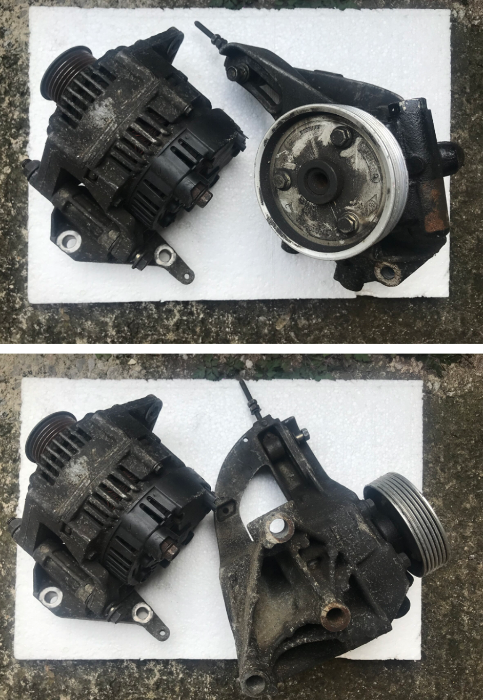

I have also just got my hands on a 172 cup alternator,Power steering pump and both brackets. So I can do an air cone delete.
Unfortunately a small corner has chipped off in transit so I try get that glued back in to place before they go off for cleaning and paint.
Any way Back to the inlets.
I'm happy with how they have come out and the car feels more responsive not that it wasn't anyway.
