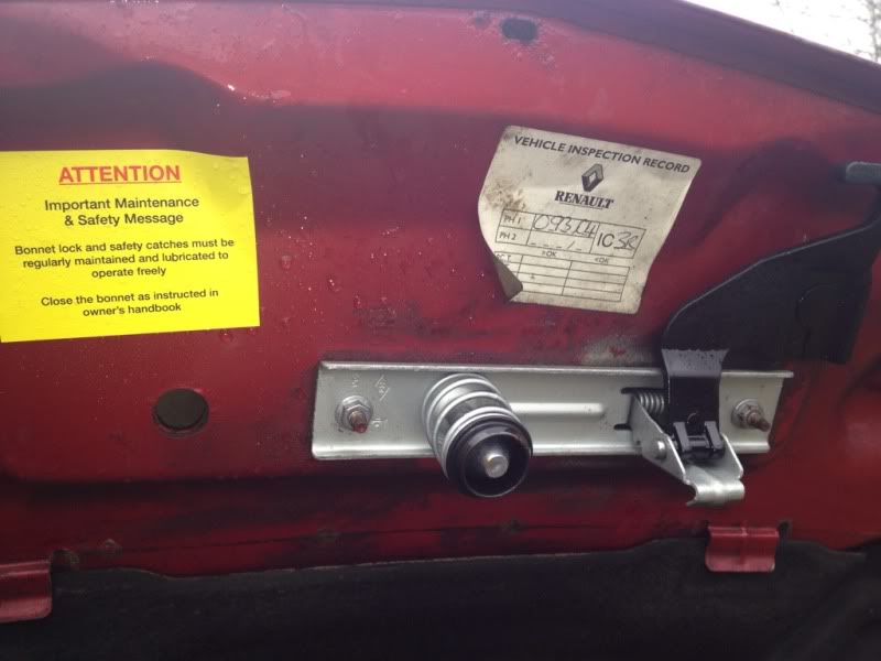

wheres this sticker found when i bought the car last wednesday he said it had already been done but seeing as ive only had the car a short amount of time im guessing i wouldnt get one of these letters

I rang up about the catch on my derv as its rusted pretty bad. They tell me it's been done and it £59 if its the bottom part and £89 if its both. Fixed prices apparently.
I have had a letter today. It says i can get it checked for free but it will cost £95 max inc VAT.
I got my original recall letter back in 2008 and just ignored it , i've always kept it well lubricated myself . I got another letter on Thursday saying take it to a dealership immediately . So i bit the bullet this time and rang up and booked it in . The corrective action might only actually be that " they " lubricate it " , not replace the catch . I rang RUK just to see what they said and they cofirmed this . They'll check if the bonnet catch is working properly , if it is the dealership will lubricate it . They'll only replace it if the find that there is an issue with it . Whatever action they do take , either lubricate it or replace it will be free of charge . As i've never had a problem with mine ( touch wood ) i'll put money on it they just lubricate it .

renault didnt change mine and just said they would charge me £59 + vat to get it replaced. I said no and took it home. got some degreaser and a wire brush and set to work on it. after i lubed it up and it seems to be mint now :)

It's not a matter of the panels lining up nicely . I didn't think there was anything wrong with my catch , it wasn't particualy rusty , i'd always lubricated myself . But now having a new one fitted FOC a few weeks ago i realise it wasn't performing as it should . When i used to pull the cable the bonnet wouldn't always pop up , i had t put my fingers under the edge of the bonnet to lift it . Now when i pull the cable it pops up as it should , just like it did when it was new .
If you've received a letter stating any correctve action which includes replacing the catch at a cost of £95.00 plus VAT will mean a previous owner has already had the catch replaced when the original recall letters were sent out back in 2008 . So it's doubtful that they'll replace it a second time , they'll probably just lubricate it for you and advice you it needs replacing .

If your letter states there will be a charge if it needs replacing then its not a recall, they are just asking you to come in and have it checked out. If your letter states no charge for replacement parts then its a recall (yellow OTS) meaning the catch hasn't been changed at the last recall in 2007/2008.
