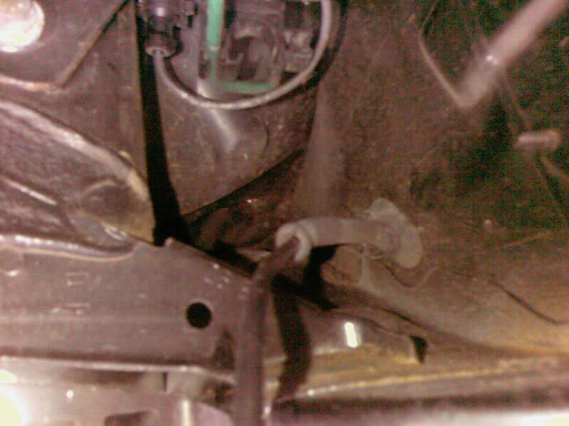

I just had a look at my bonnet release cable and it looks like this:
How do you get a power cable through that?

i got 4awg through mine no problem. slit a hole in it with a stanley knife. vaseline up the cable and poke it through.
