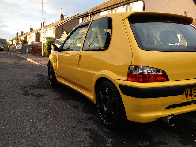

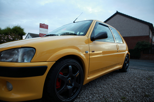

IMG_1104 by Richard_Gibson, on Flickr
IMG_0006 by Richard_Gibson, on Flickr

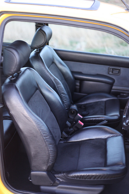

After a couple of weeks I bought an interior which had only done 10k! as the other was slightly worn, sprayed the mirror covers to match the alloys….also a few things started making noises, wheel bearing decided to go, exhaust bracket snapped and found the cat on the car - the elements inside were shot at, also was making a whirring noise when the clutch was disengaged.

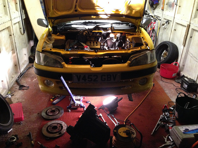

I removed the knackered wheel bearing and decided to replace both, to which things started to turn sour… both drive shafts where different (one was tapered and the other straight cut where the bearing sits) I ended up buying two brand new ones.

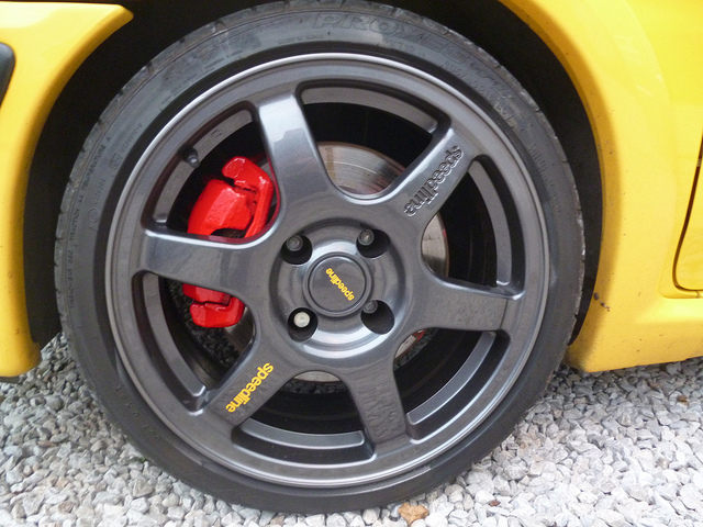

I was attaching the calliper and noticed one wasn't retracting, took a closer look and noticed it was f%%cked.. So I bought a set of GTI-6 Callipers.

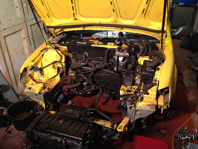

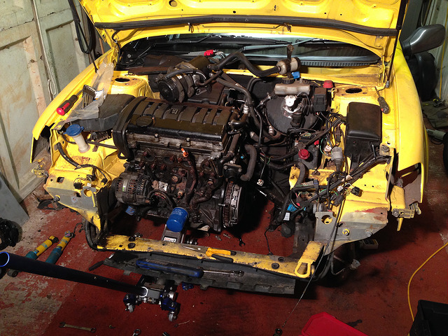

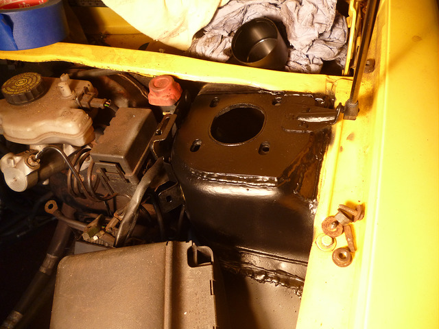

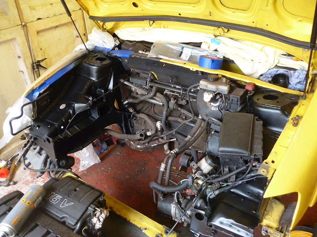

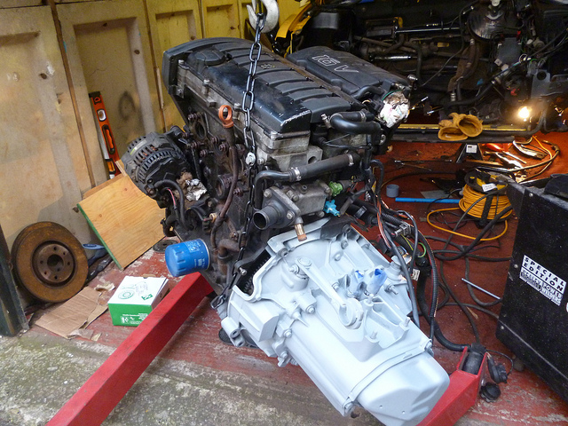

Since the engine was partly in bits I thought I may swell clean the engine bay up as there was some surface rust in some hard to get areas. So out came the engine!
The surface rust turned out to be rotten! so I ended up cutting a patching in parts. While the car was up on stands I took a good look underneath only to find that rust was hidden by underseal! The grinder came out and removed all the underseal around the rotten areas, I had to make some chassis parts and weld them into place,
In total the car was off the road for 7 weeks - now I have no rust (from what I can see) which was always in the back of my mind.
While the car was off the road I bought some bilsteins B8's, Pugsport exhaust and refurbed the callipers and painted them red.
Here are a few pics from the build.

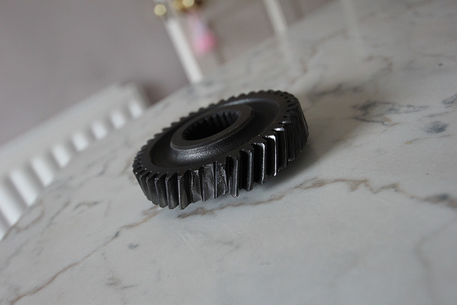

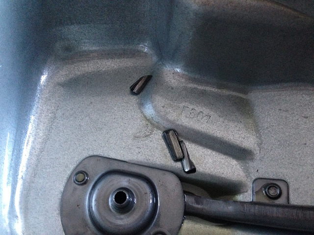

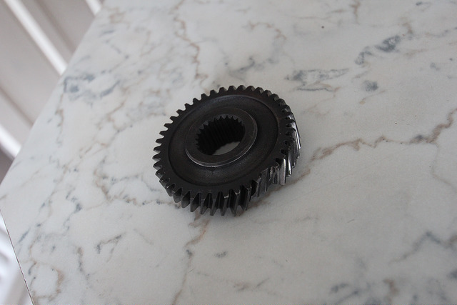

When I got back home I decided to have a look at the gearbox…. Upon removing the end casing this was what I found! :eek:
IMG_1585 by Richard_Gibson, on Flickr
Had a closer inspection and found the input shaft gear was FUBAR!
IMG_0003 by Richard_Gibson, on Flickr
IMG_0002 by Richard_Gibson, on Flickr
Lucky for me the old gear box I removed was sat there doing nothing so managed to remove it and use that! The car is fully up and running once again, also treated myself to a pugsport 3" exhaust system!

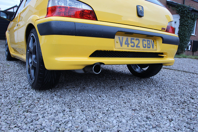

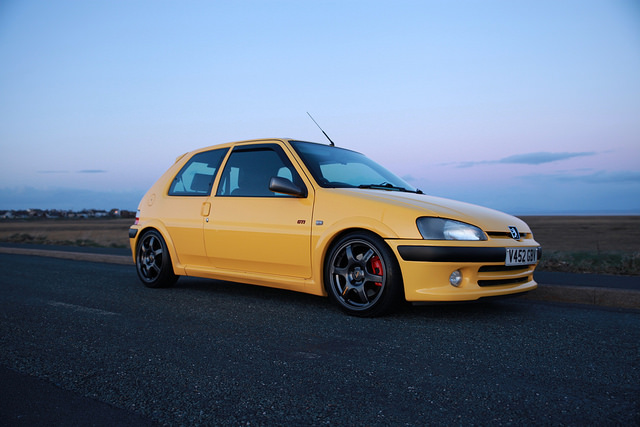

Haven't updated in a while, mainly because I have been putting all my money towards the new house.
I have recently bought a couple of things to help improve a slight knock which started to appear a few weeks back
Should be getting fitted next monday. Also bought a sport cat to go with my pugsport as everyday driving is very loud! so thought it will quieten it down but still have free flow.

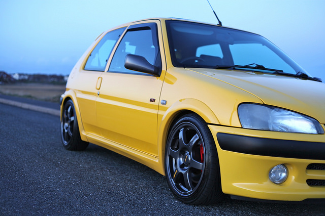

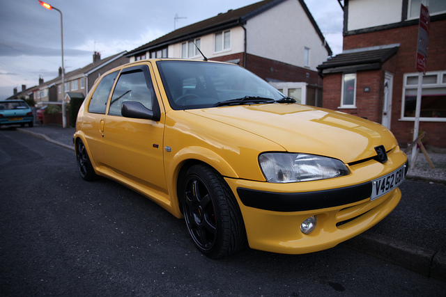

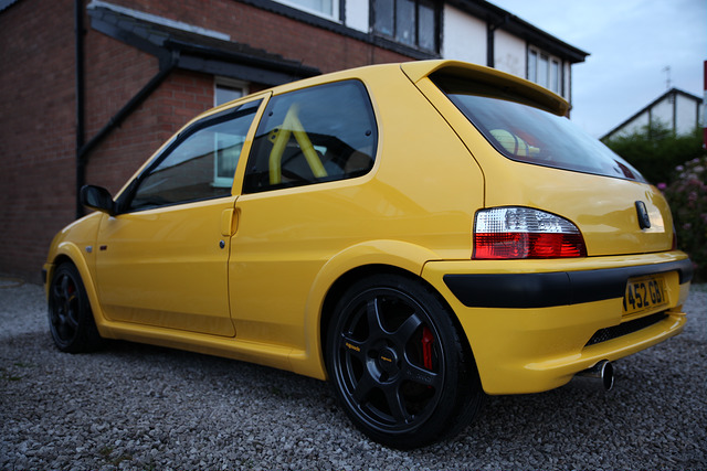

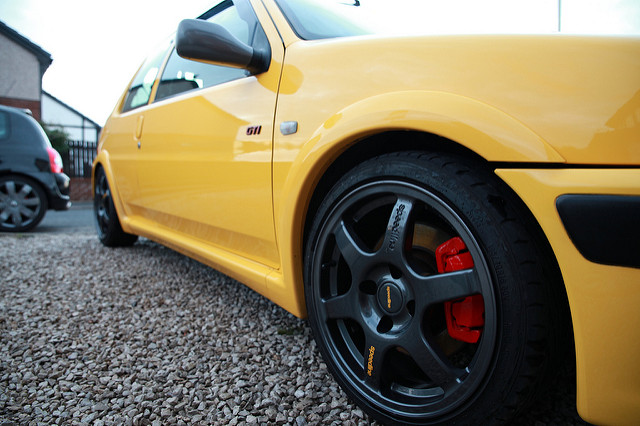

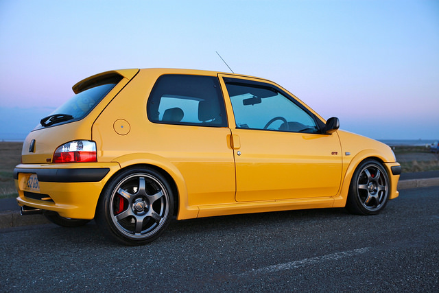

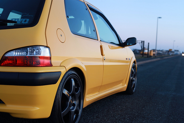

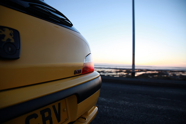

Few pics after I detailed it over the weekend.
