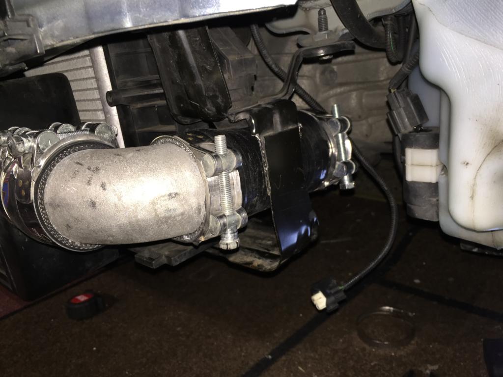

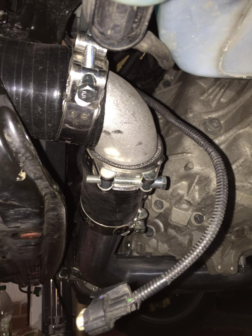

OK - quick update. I wasn't happy with how one of the intercooler pipes was sitting. As i'm not running the std intercooler (or one specificly for my car) one pipe was slightly too short meaning it was on at a funny angle.
I ordered 1m of 63mm silicone and had a spare 90 degree bend so had a go at re-routing it. It shouldn't be a problem now!
Much happier with how it is now, so shouldn't experience any issues.

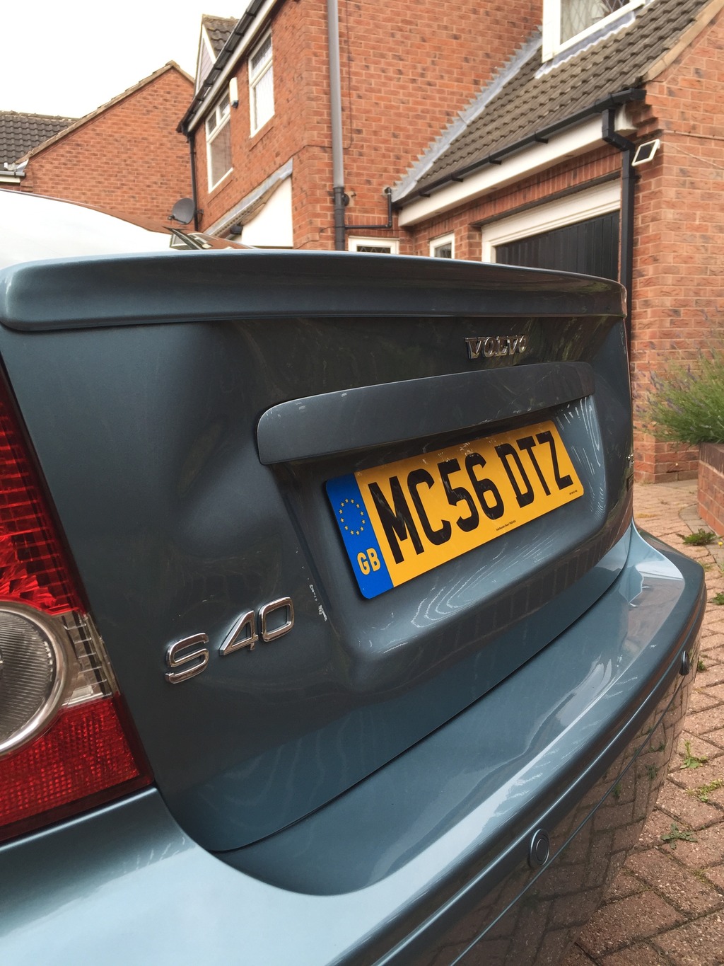

1 very small update - i've pranged it! lol
Backed into a metal gate, in my defence i've never known this gate to be closed and it's at a funny height. I couldn't see it in my rear view and the parking sensors didn't pick it up!
No big deal, just needs a boot lid - i'm keeping my eye out on eBay for one in the right colour.
