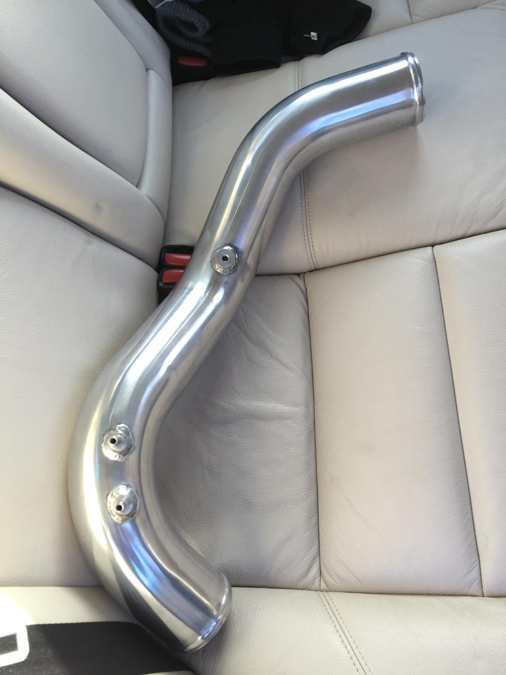

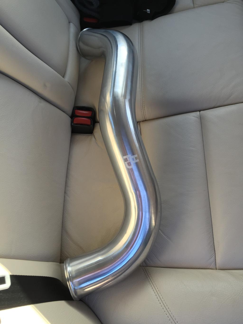

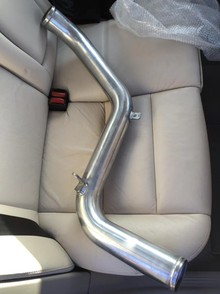

So, my pipework has arrived - i'm yet to fit it though.
Here's the intake pipe, looks like a very well made piece of kit and has both connections.
Here's the hard pipe for turbo - intercooler, again looks well made, nice finish and has the appropriate hangers.
I've not taken a picture of the silicone, but we all know what black silicone hoses look like!
More pics and feedback once fitted.

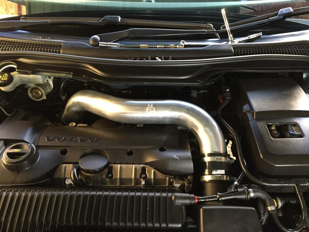

All fitted now too
Noticeable difference in intake noise, turbo whistle, etc. the exhaust not has changed a little - deeper.
It feels a bit more urgent too, 2nd gear actually caught me out a couple of times last night. Boost comes on harder and sooner than I'm used too!
Overall, very pleased!!

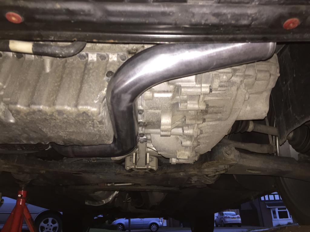

I just meant it running along the sump and snug between the gearbox. Nice warm route..lol
Chrisgti6
  Too many
Heat rises though, so it stays pretty cool, that's the standard pipework route. Also it's pre intercooler so doesn't really matter. I've checked and my intake temps are nice and low (last time i checked it was 6 degrees ambient and 9 degrees intake, so working well!)
