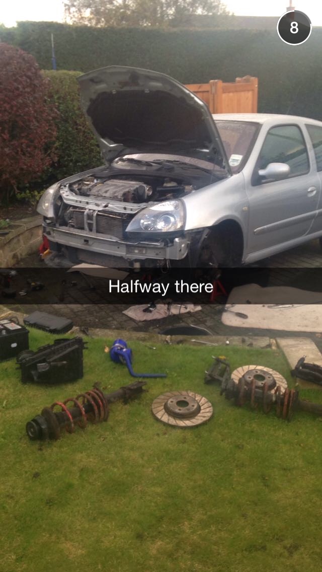

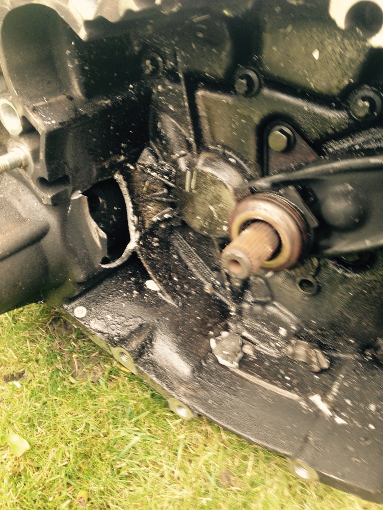

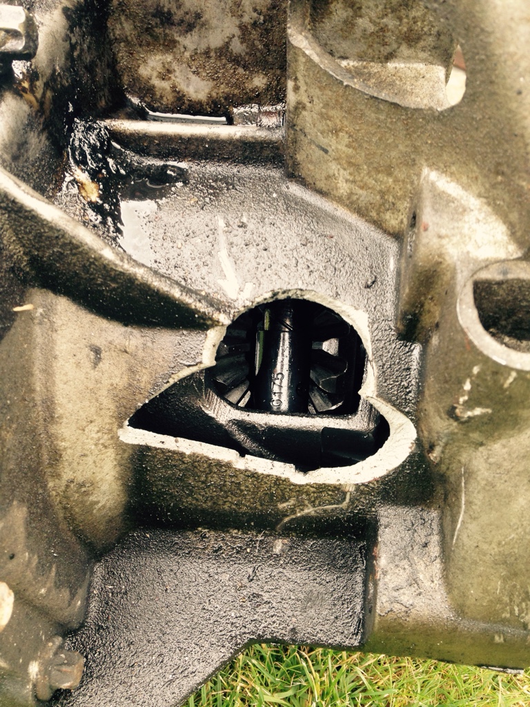

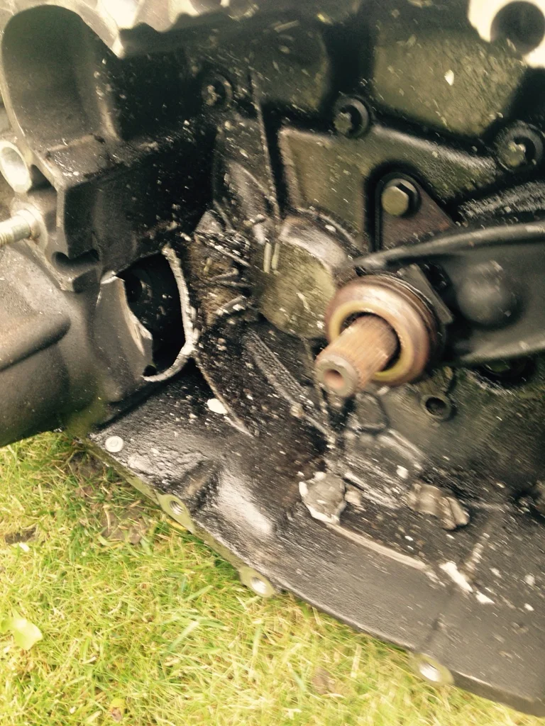

Unfortunately on my drive home I realised it's much more than a drive shaft and definitely diff related, nursed it home nervously then the next day floored it down the road to see what would give and as thought the diff blew out. So started to remove box etc...

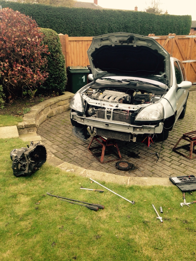

Was the first gearbox I've ever removed, would have been easier on a ramp but did it in my spare time over 3 seperate days and didn't struggle too much, here's the damage

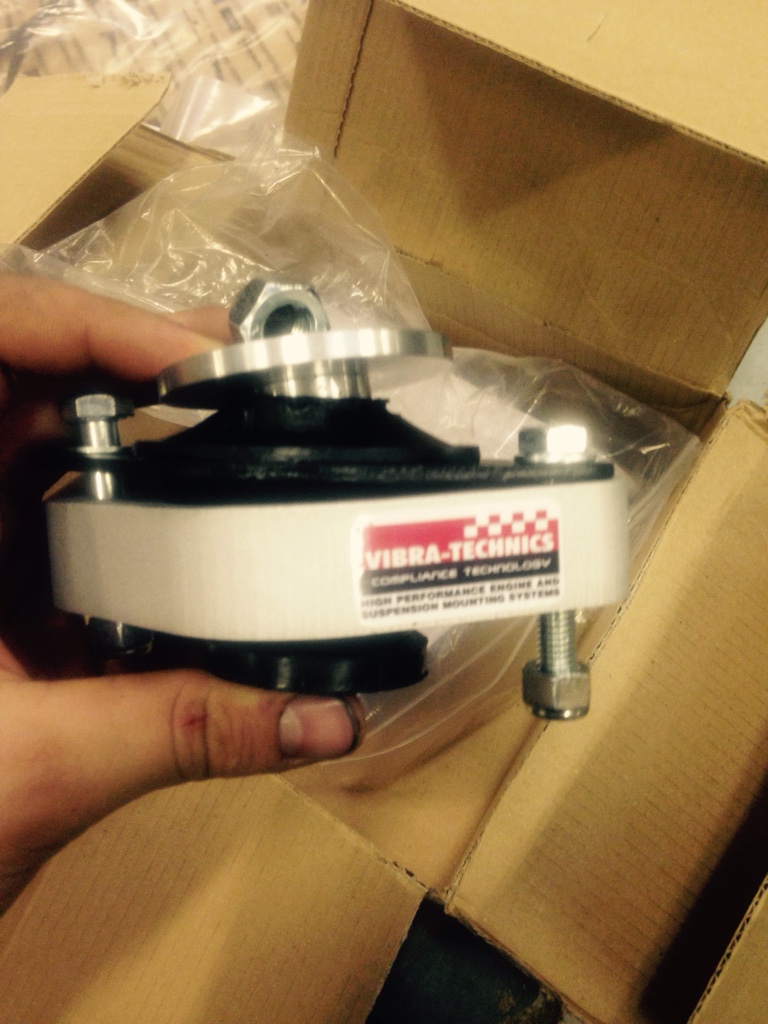

Bought box on eBay and a brand new luk clutch. Decided to install a vibra techniks upper gearbox mount too and found it had already got updated dog bone mounts.

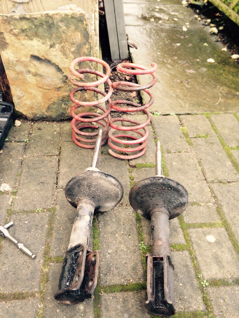

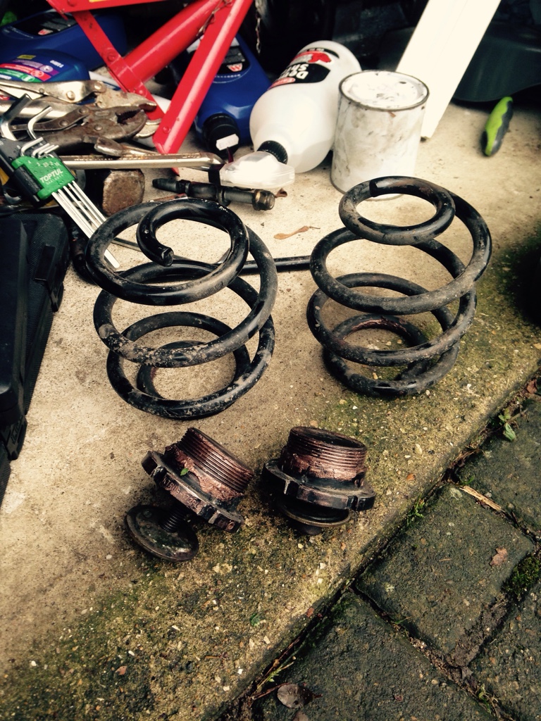

I replaced all cv boots as they were all split but only to find out the left hand drive shaft was pushing the gearbox\ engine side to side so bought a new left hand shaft. Finally car was all back together. Took it for a drive and the handling was terrible, dangerously bad. So bought a full set of new cup shocks and cup sport springs, here are the old ones, one tear shock had no damping or oil at all (forgot to get pics of new items)
Right handling is 1000 percent better, sits nice too. Car had brembo pads all round and new discs all round when I bought it, some sort of grooves /slotted front discs too. For some reason abs/ esp /Serb lights were on ever since I re connected battery. After searjcing on here I bought a new brake pedal switch which didn't solve it straight away but after a day or two of fiddling they have gone out and everything works. So handling and braking for now is sorted, has hel braided lines too.

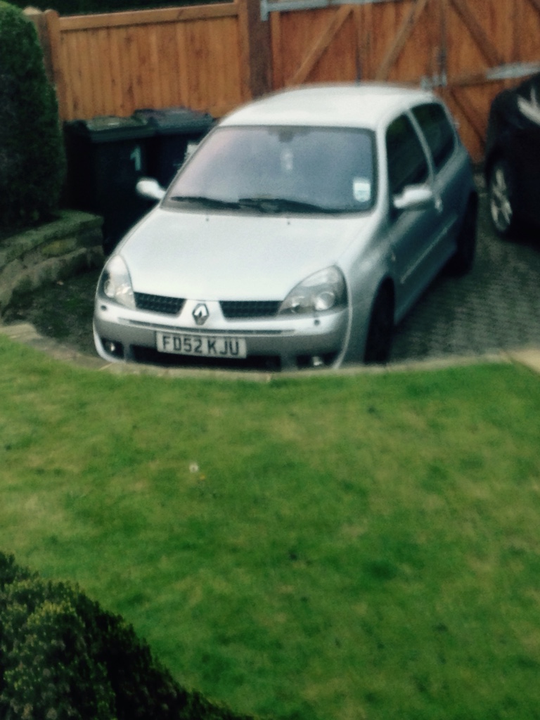

Here's the car now, not the best picture and exterior has not been cleaned or attended to cosmetically and on the to do list

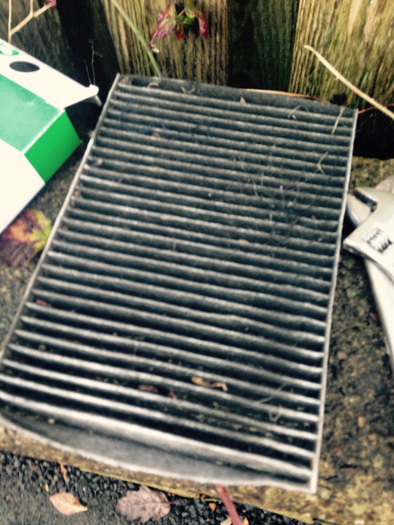

Forgot to mention anyone with bad inside steamy windows and condensation check the cabin filter. Here's mine that came out on Saturday..,
Put new one in and not had any issues since.
Hi mate, great read up, brave man on the gearbox job, where do I find the cabin filter as I currently have this problem.
Thanks. I'm a bike mechanic by trade so sort of knew what to do but cars are so different and awkward in my opinion haha.
Right if you pop the bonnet and look at the black plastic scuttle panel at the bottom of the windscreen on the drivers side. You can actually grab hold of it and pull it up and put from the bonnet side. Then you will see an upright sort of flat box with a little bolt holding the lid on. Just undo the bolt and swap the filters over . Make sure the arrow on top of the new filter faces towards the passenger side of the car, it shows the air flow direction. Hope this makes sense, if not let me know and I'll take some pictures for you.
