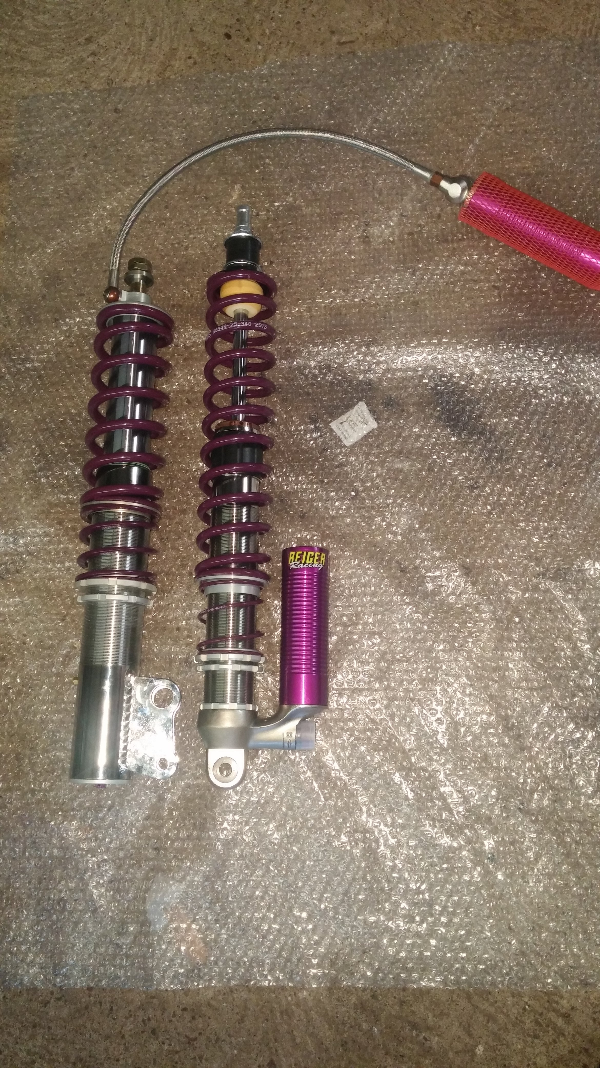

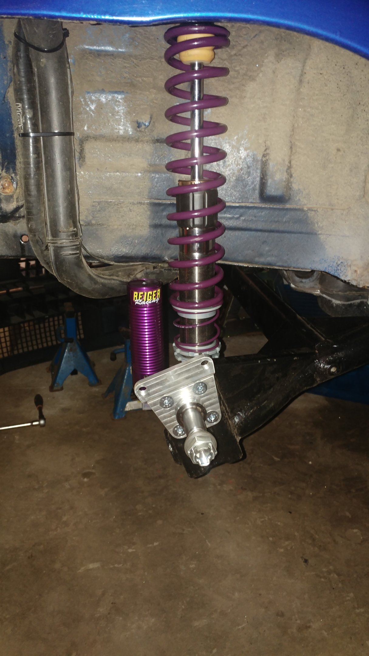

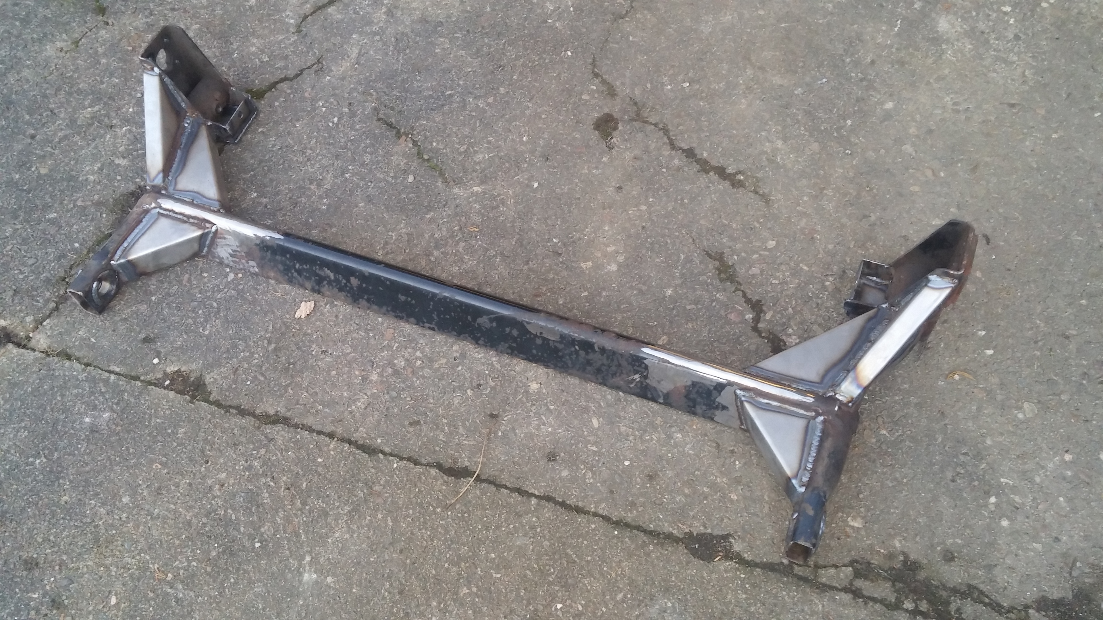

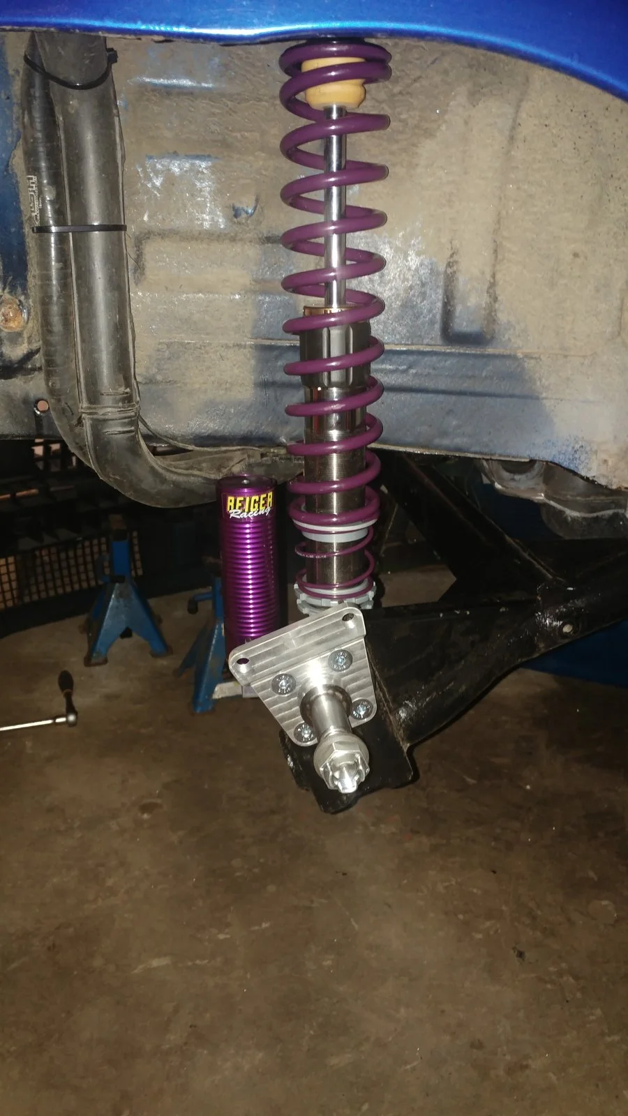

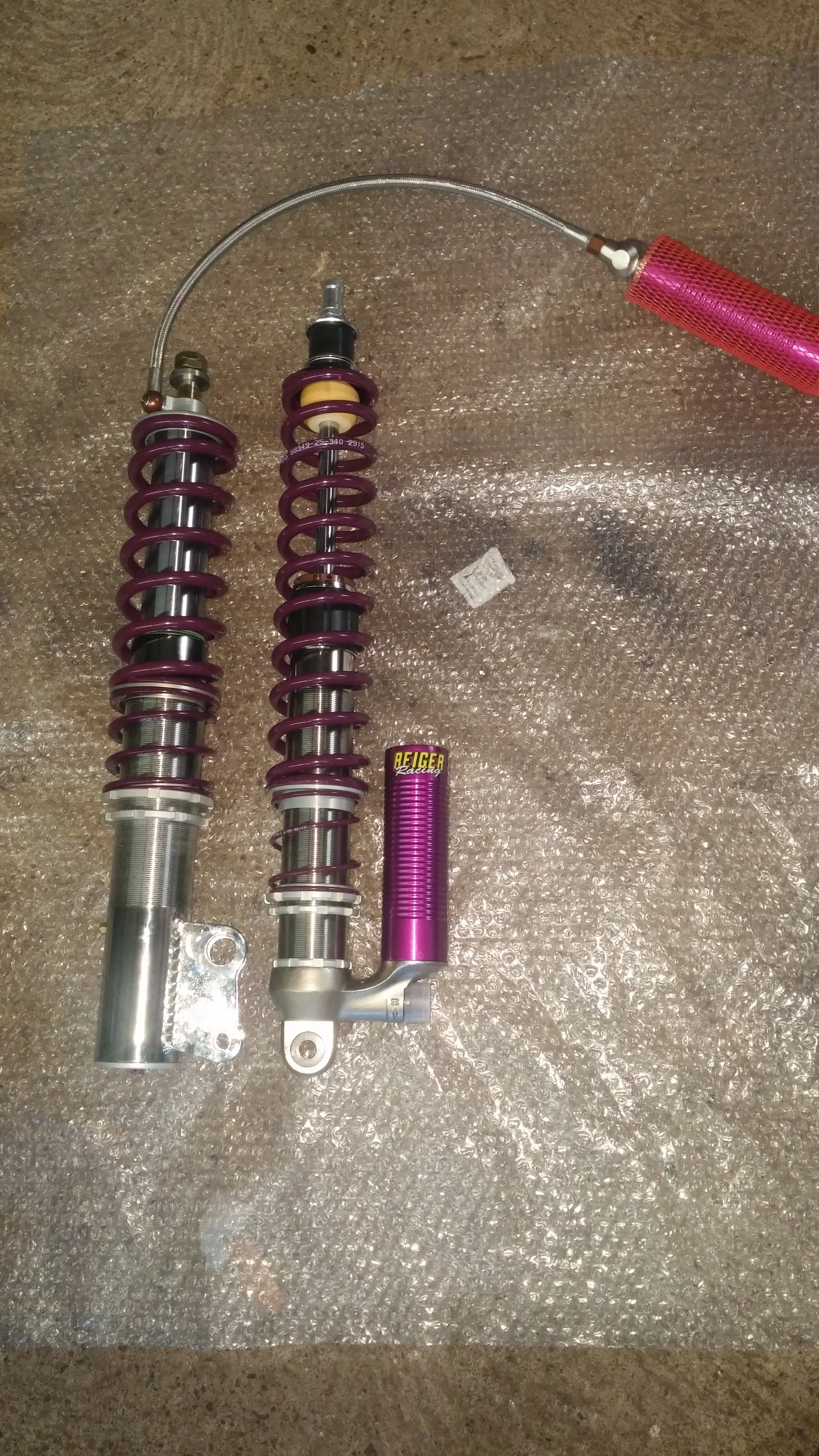

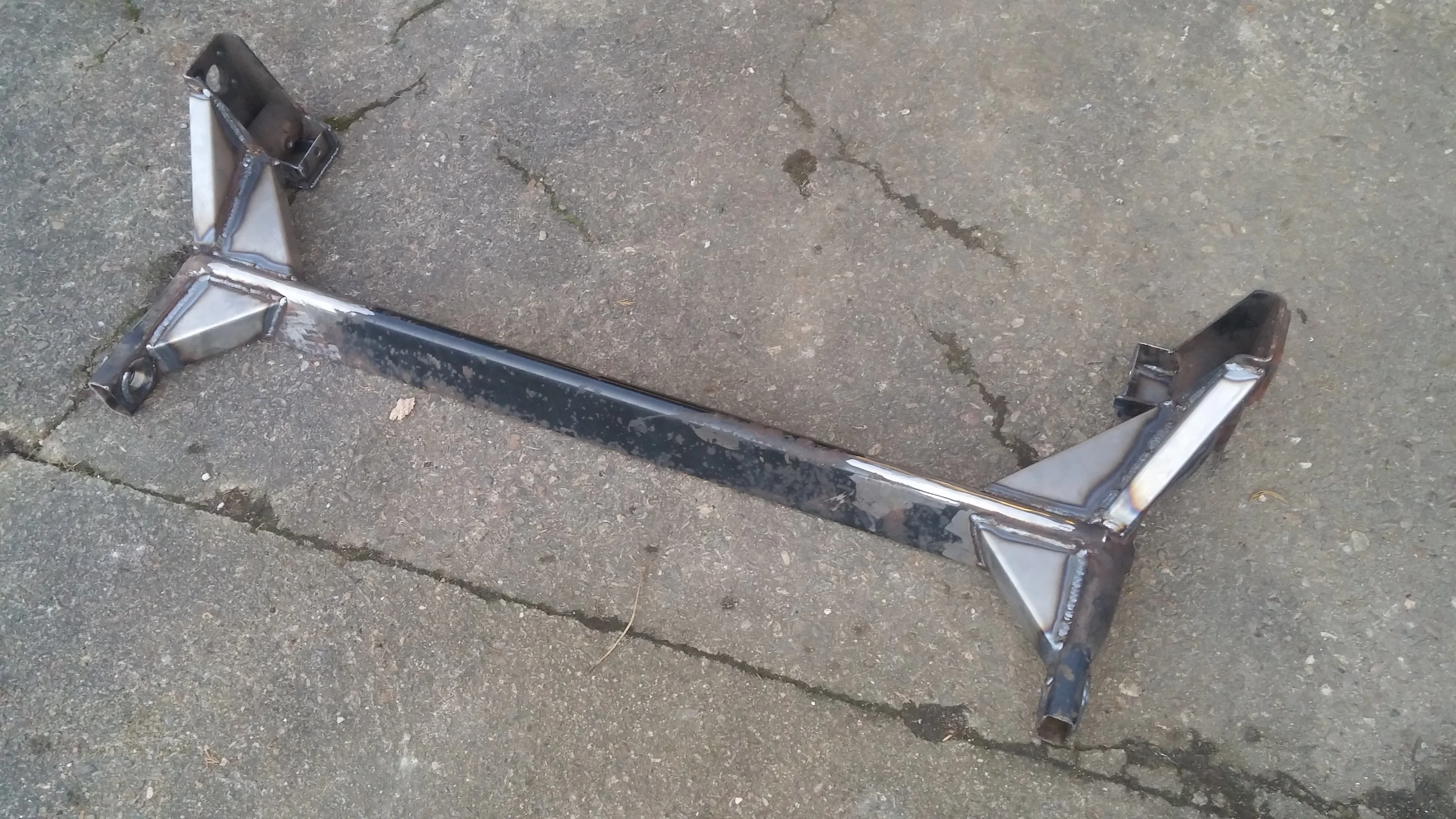

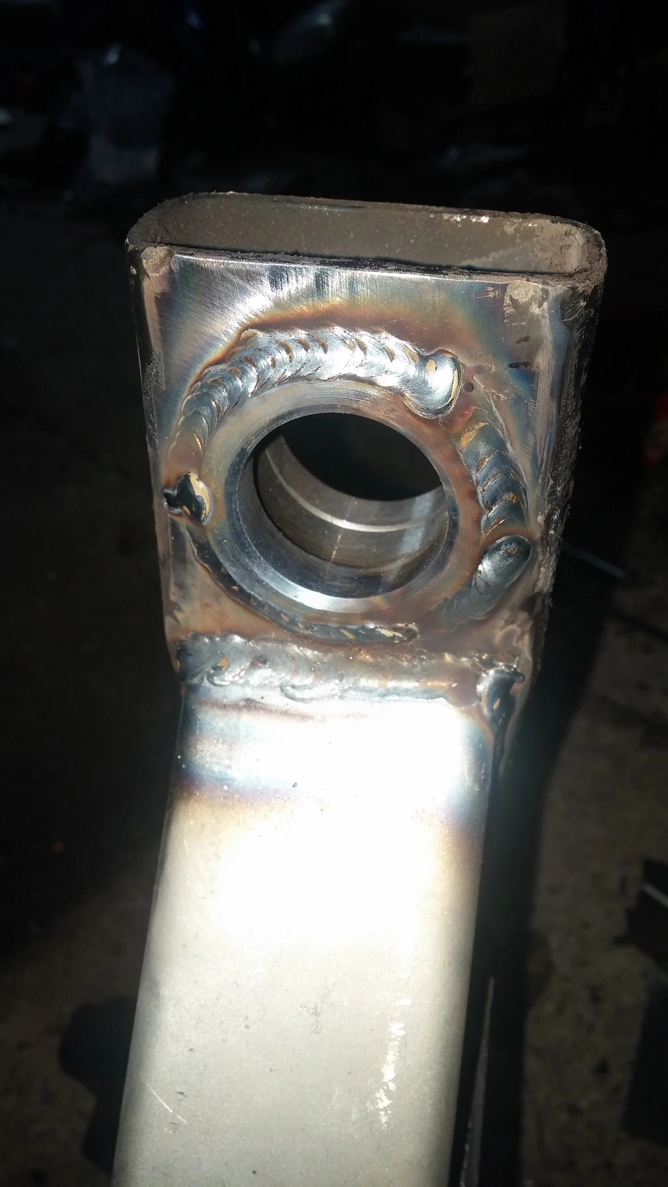

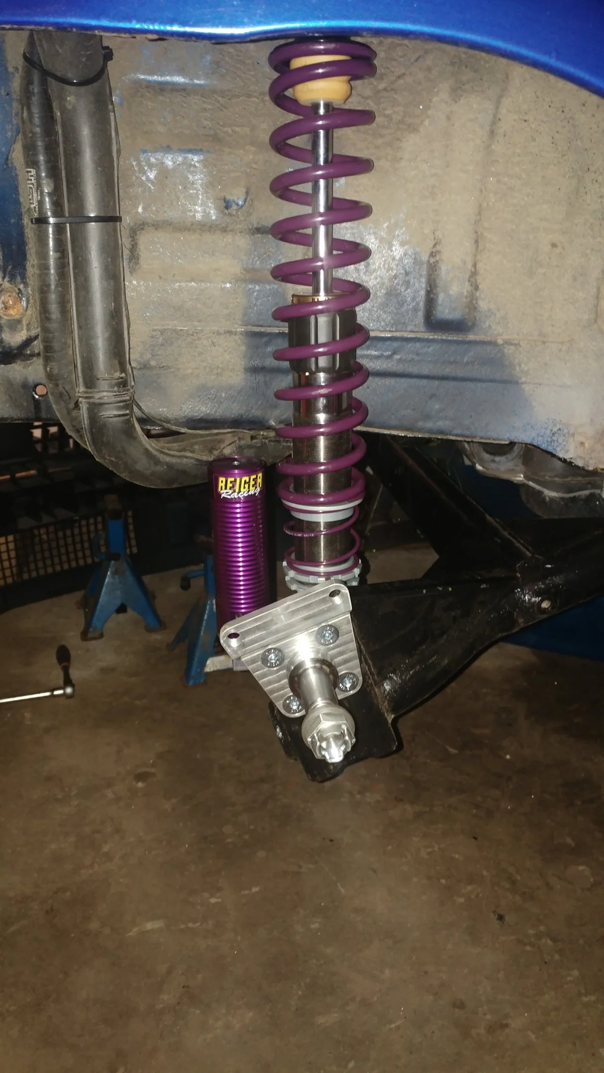

Love to have reiger but way out of my budget, just going to use Bilstein b14 with pms solid mount and brace and pms reinforced rear beam.
What box are you using?

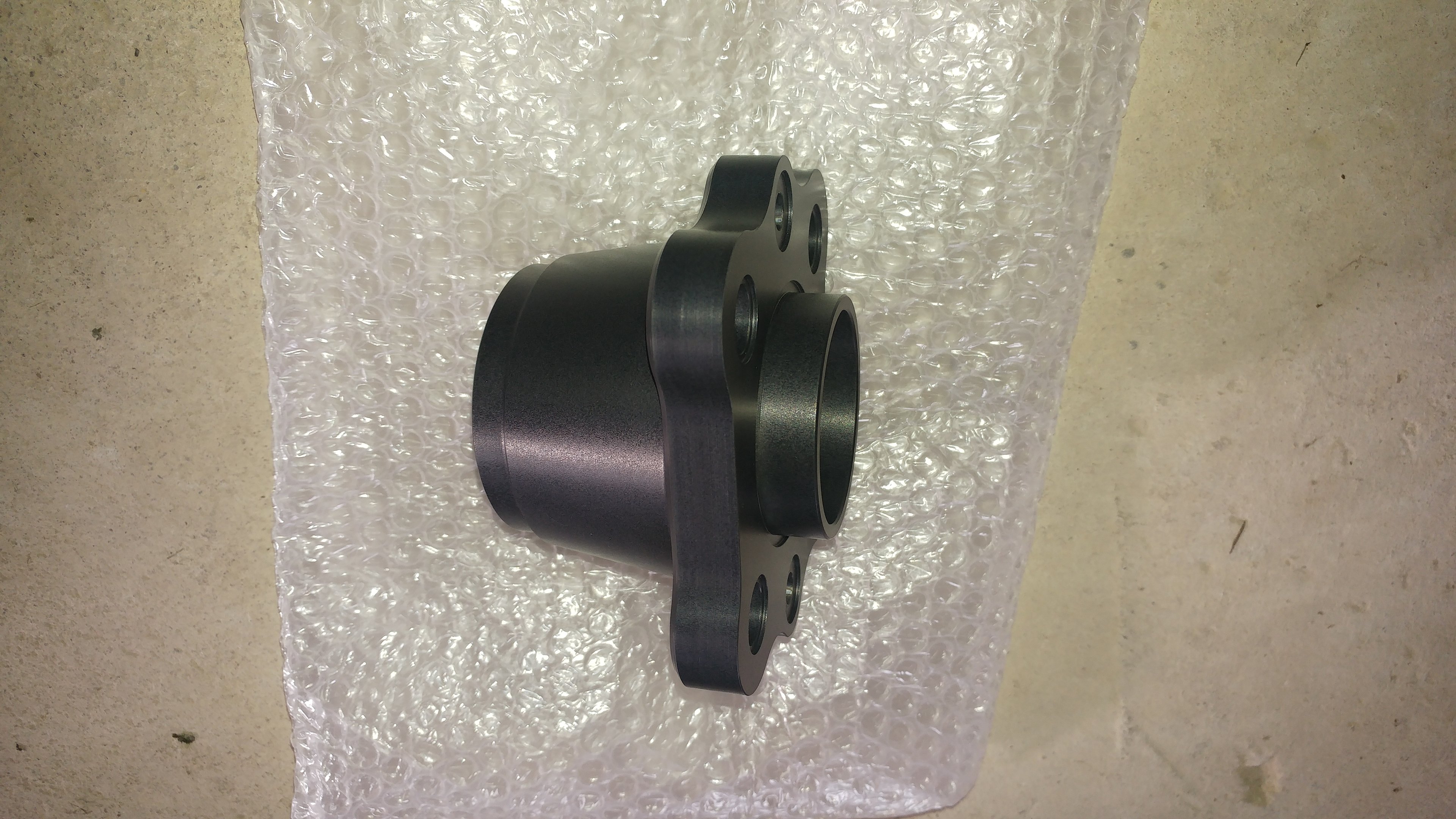

Hi, Are you using the pure motorsport stub axels for the bigger bearing discs ?
Hi
Yes sort of

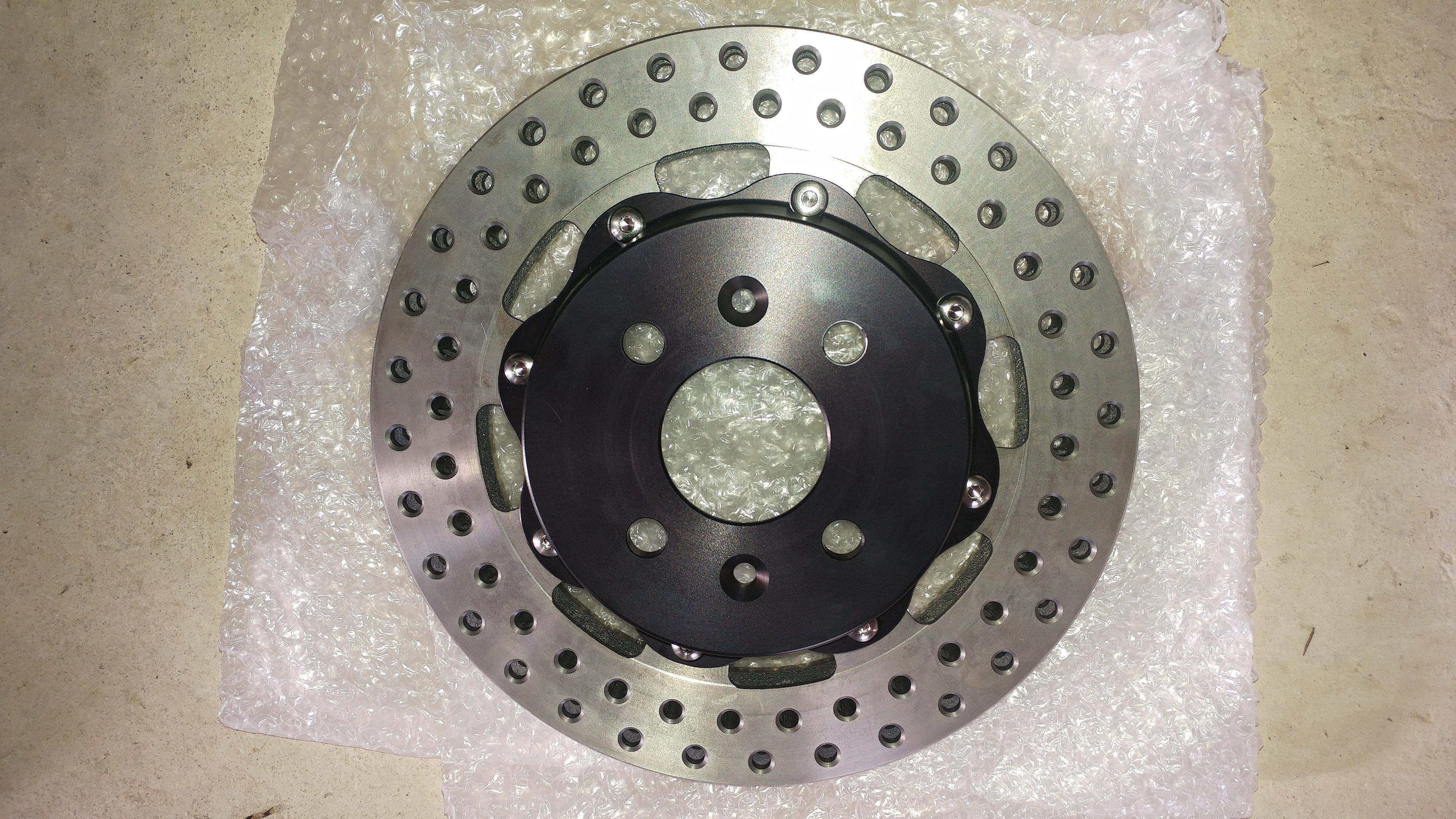

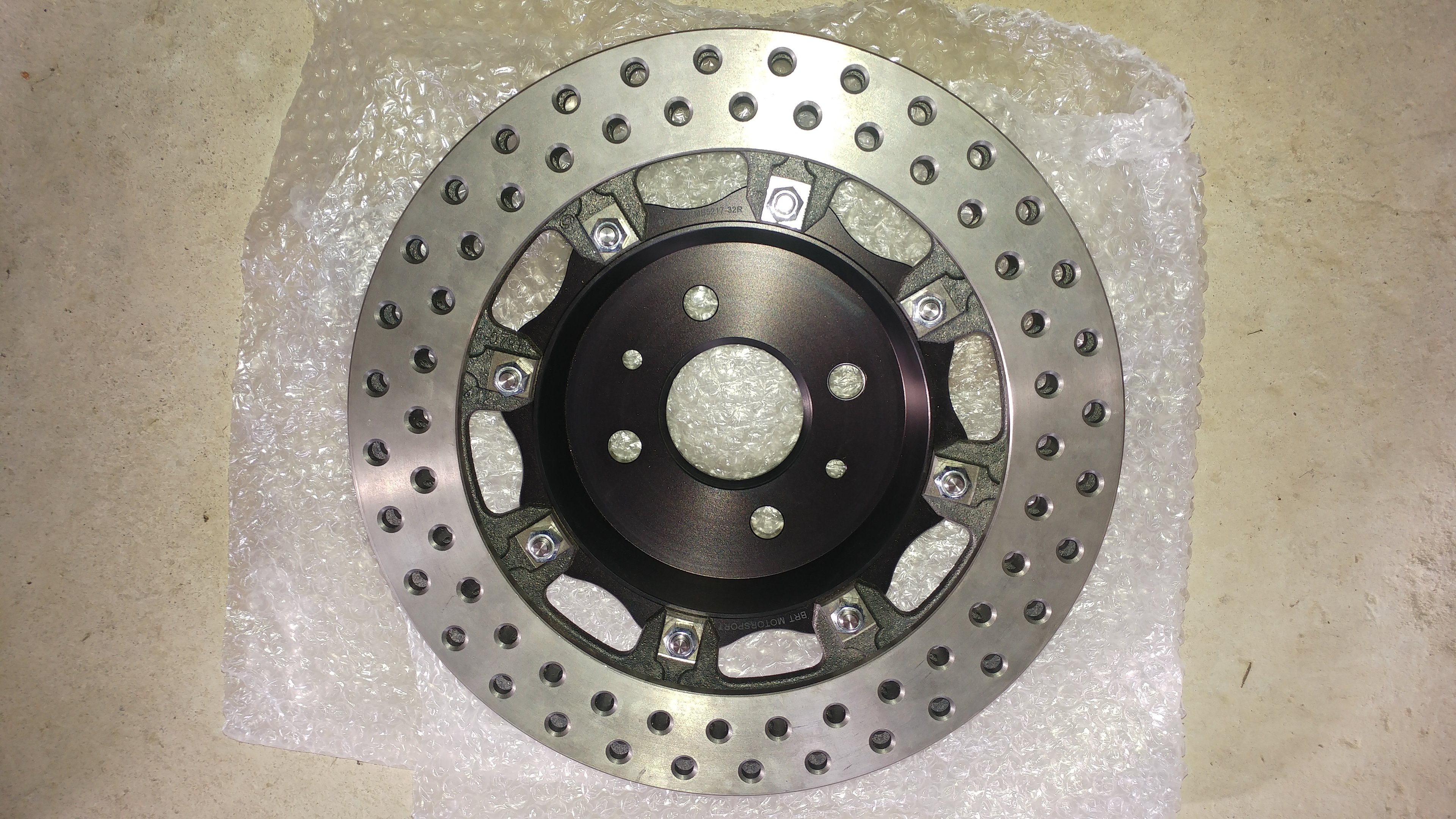

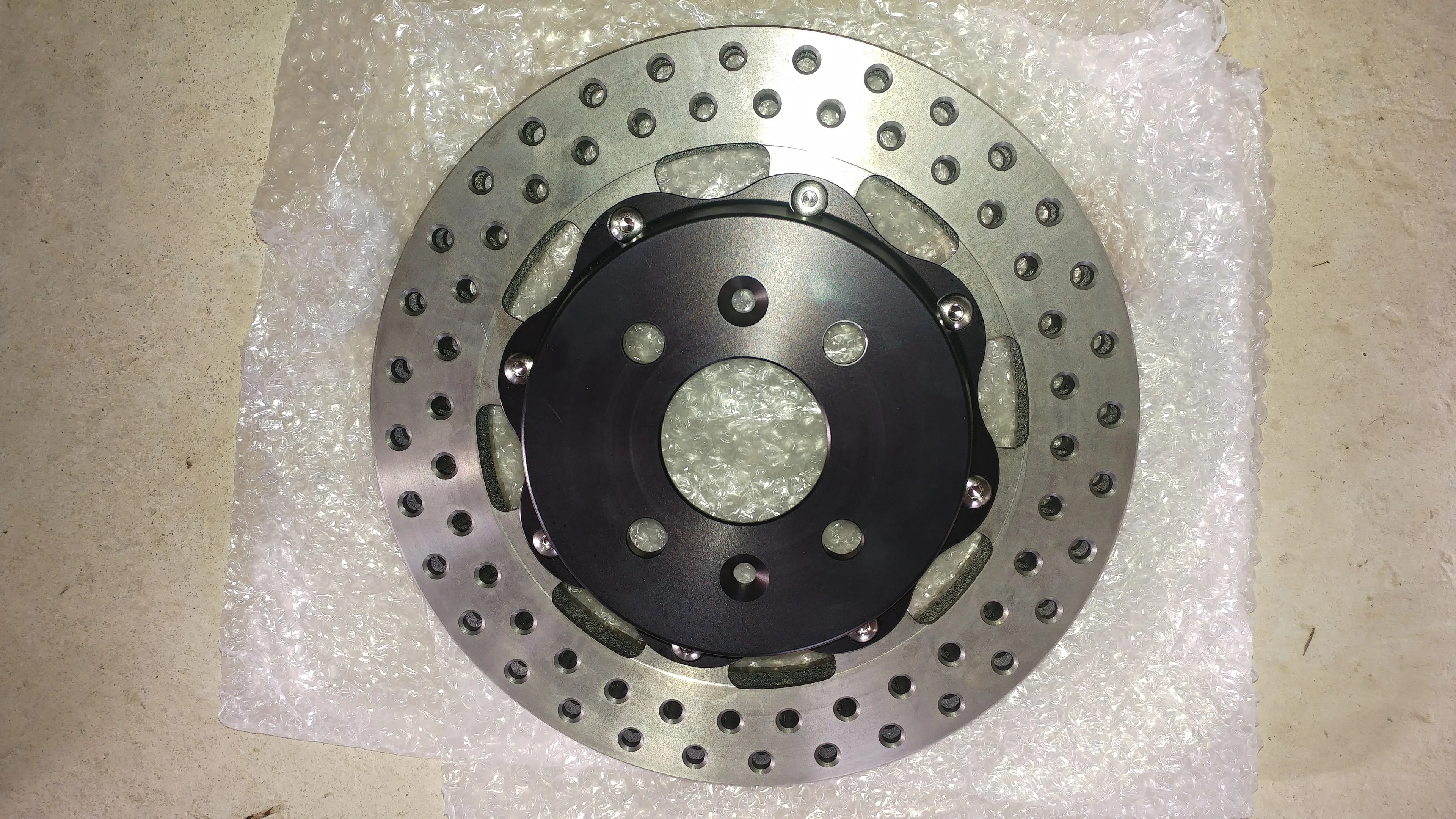

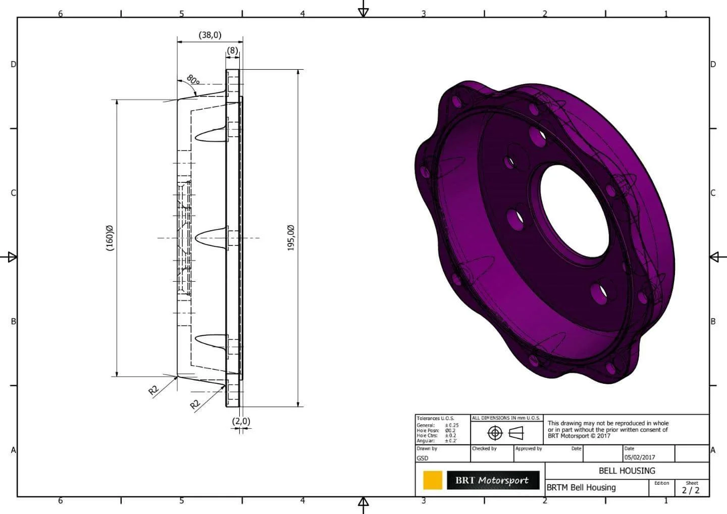

Not using standard rear brakes

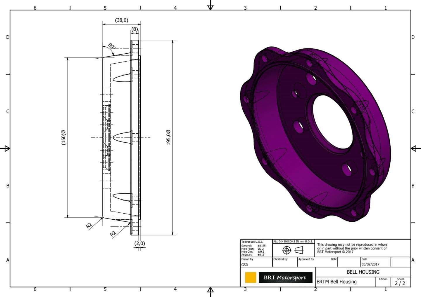

Using alloy hub brake rotor and bell

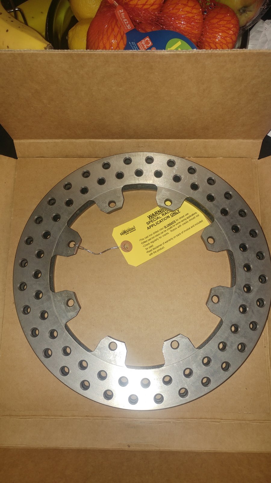

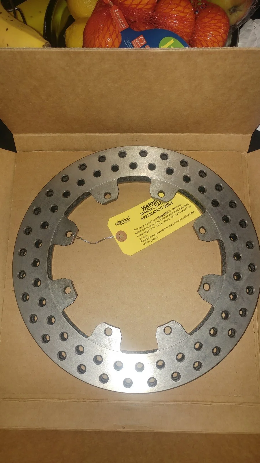

I originally had AP calipers and 295 - 300mm rotors under my 15" wheels. (I turned them down slightly) They have worn a bit too thin so I went back to standard and did a deal on some ds1.11 pads, brembo high carbon discs and have had no issues. Thought it would have had a bit of fade on the Manx but they were great.

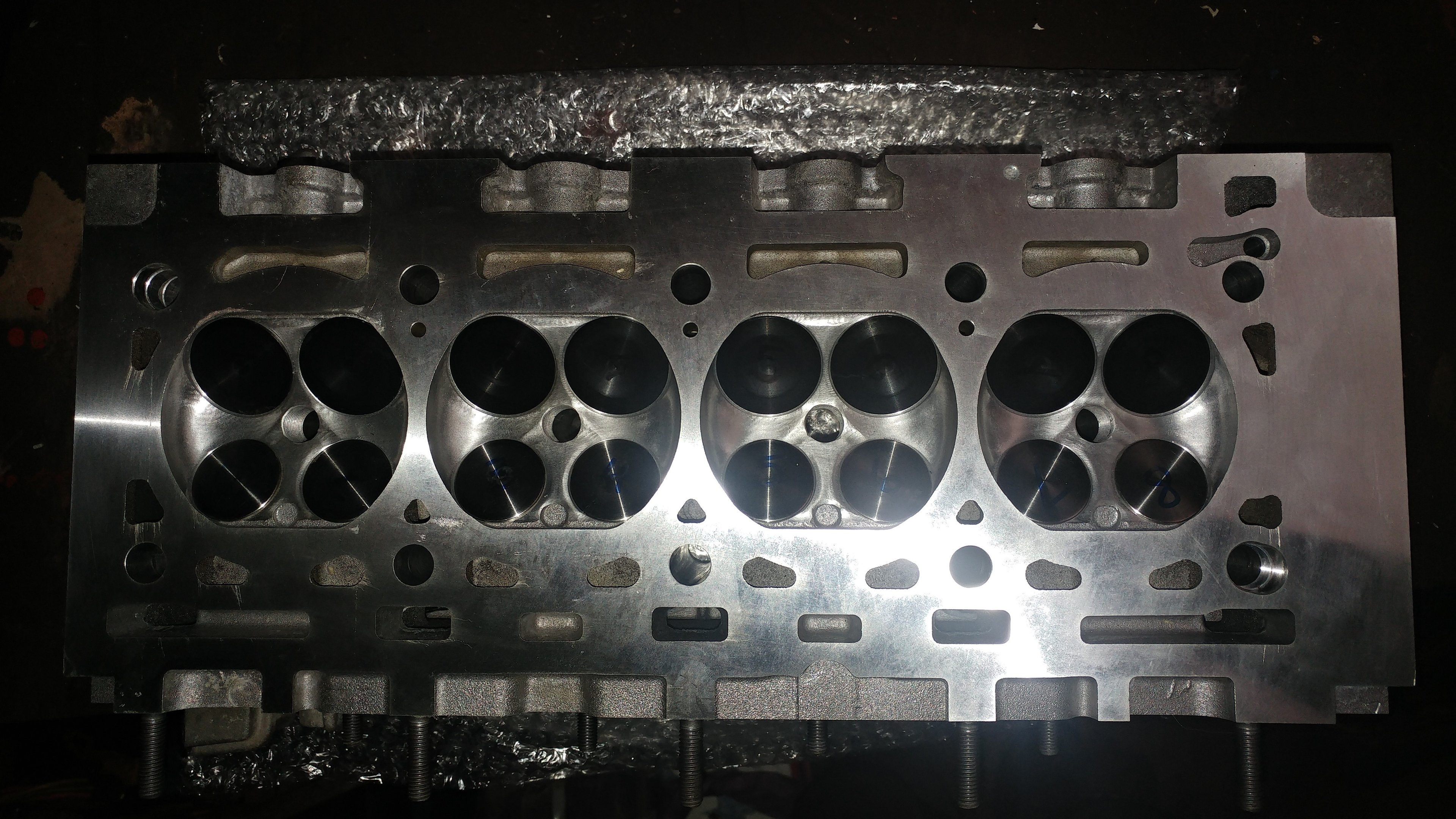

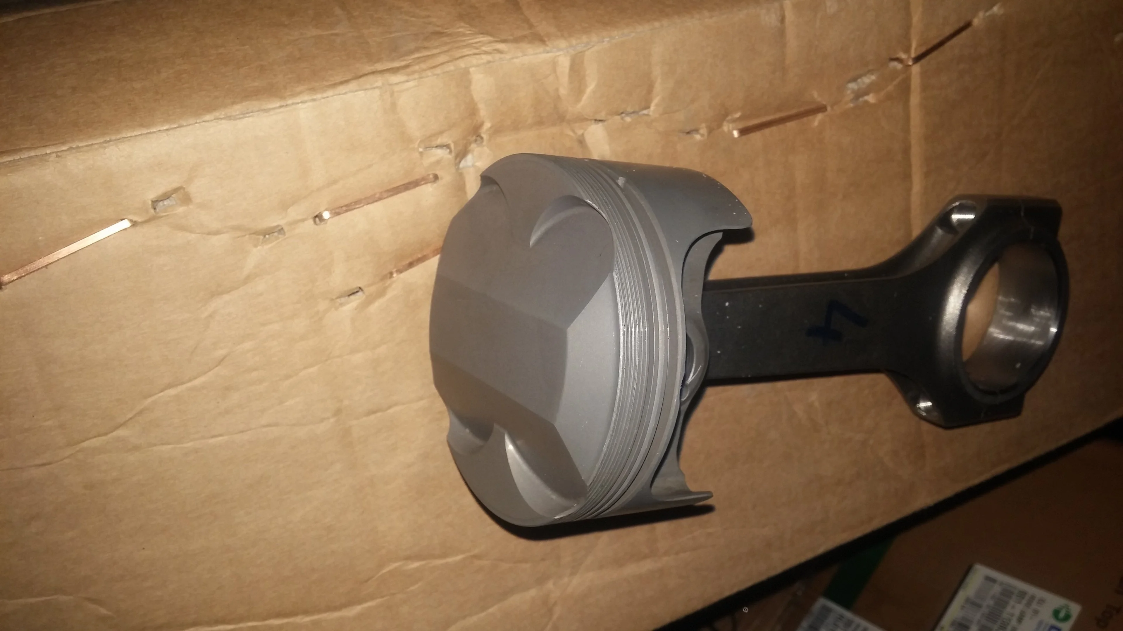

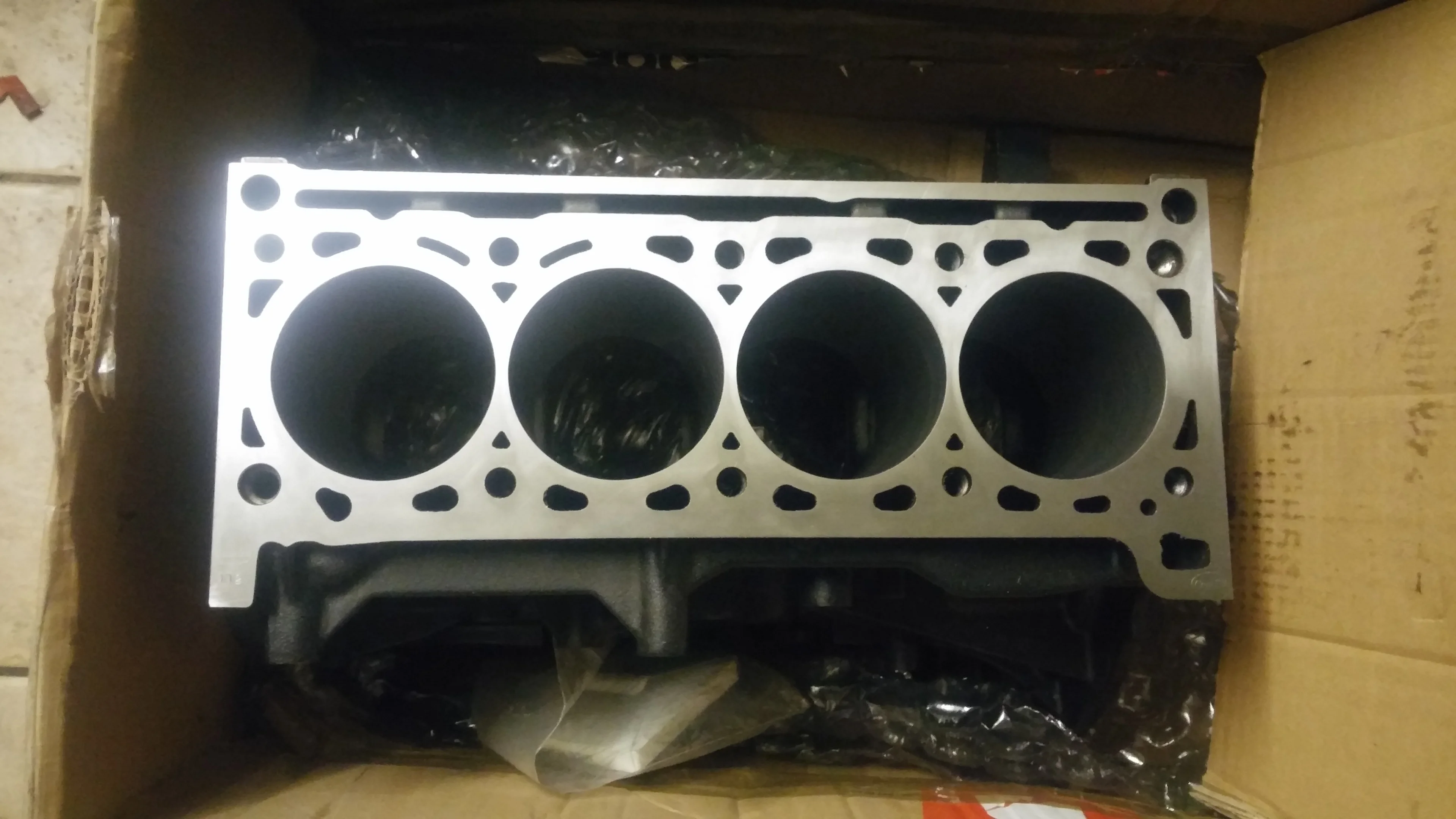

got some more work done

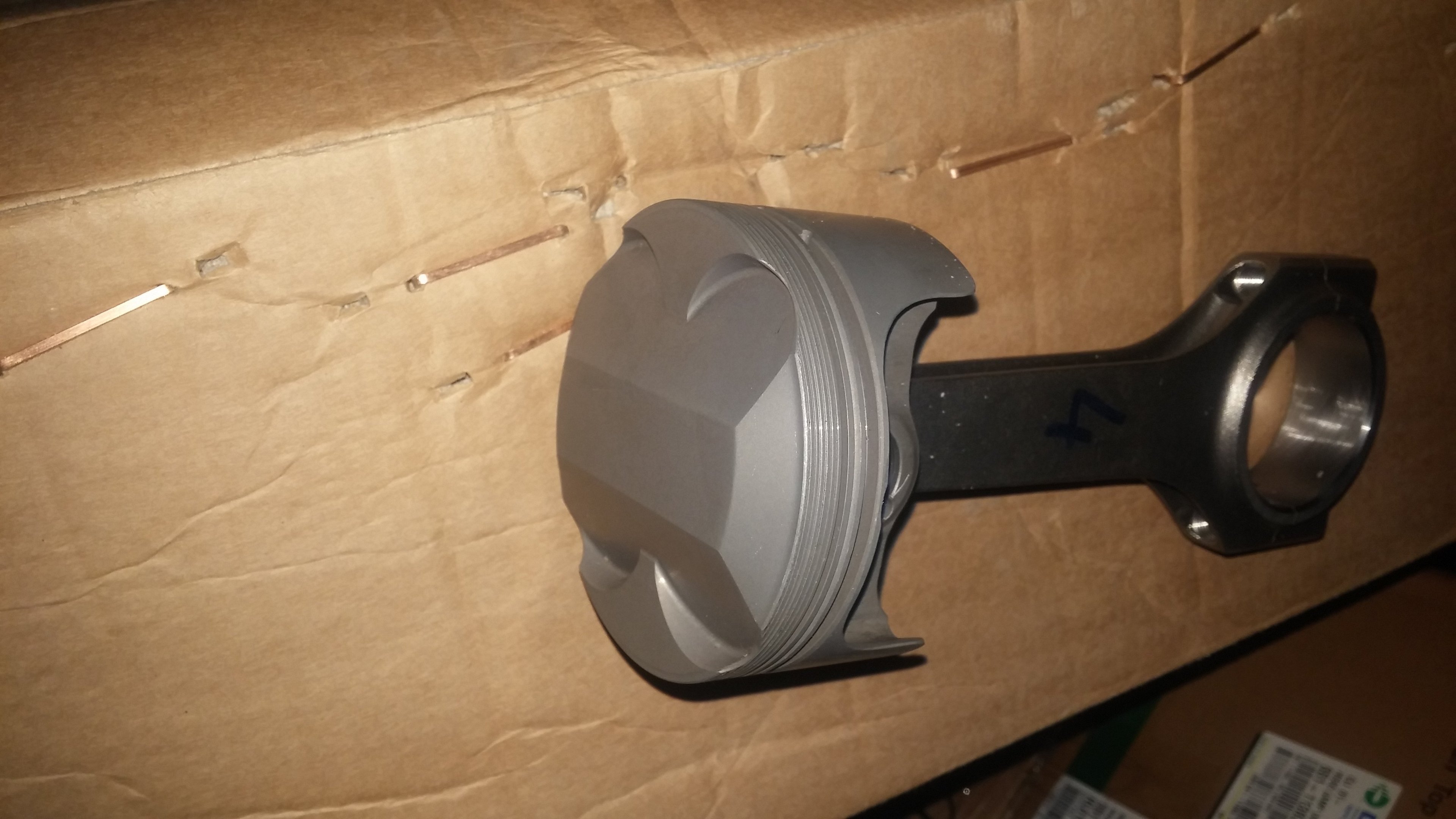

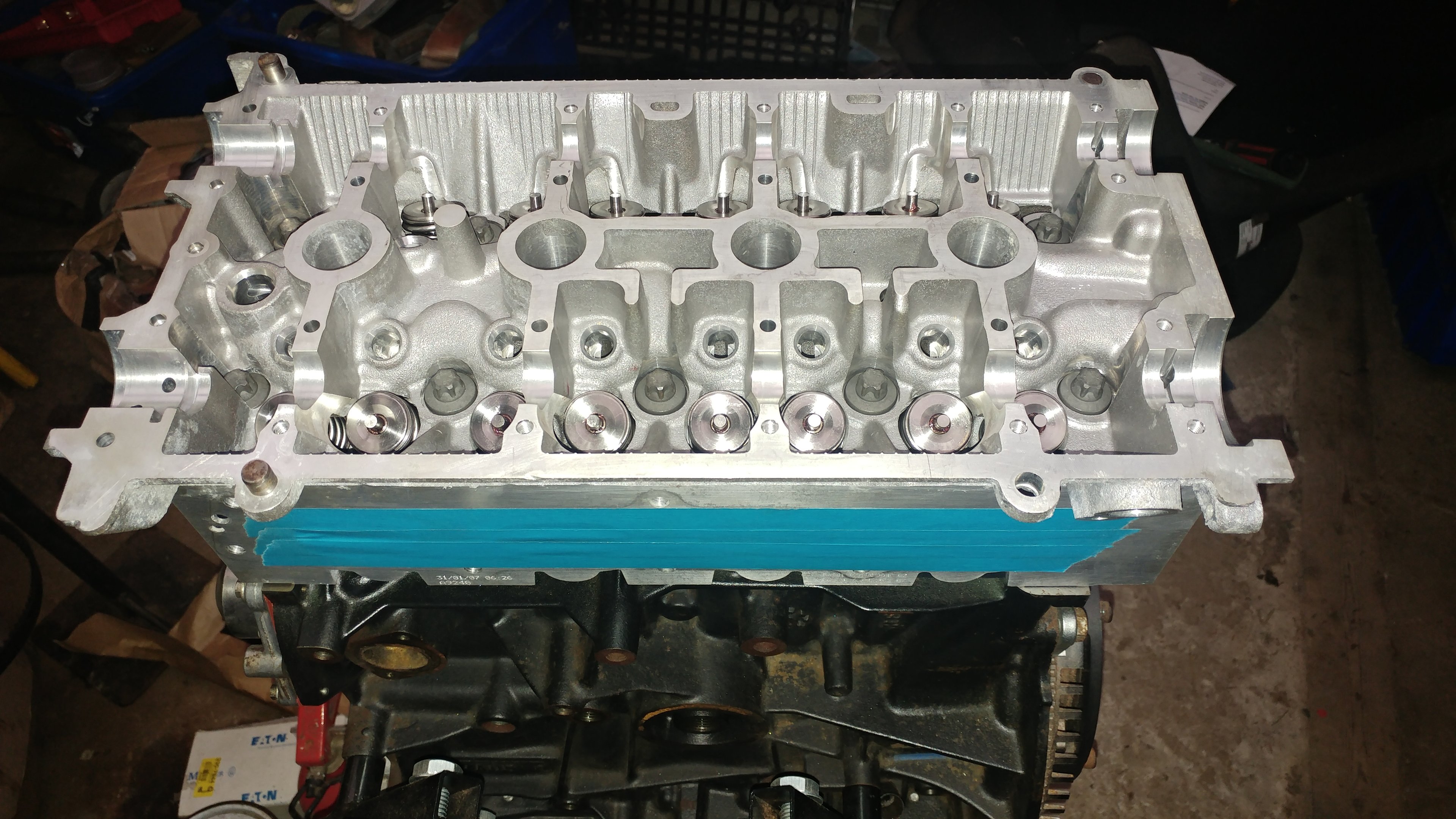

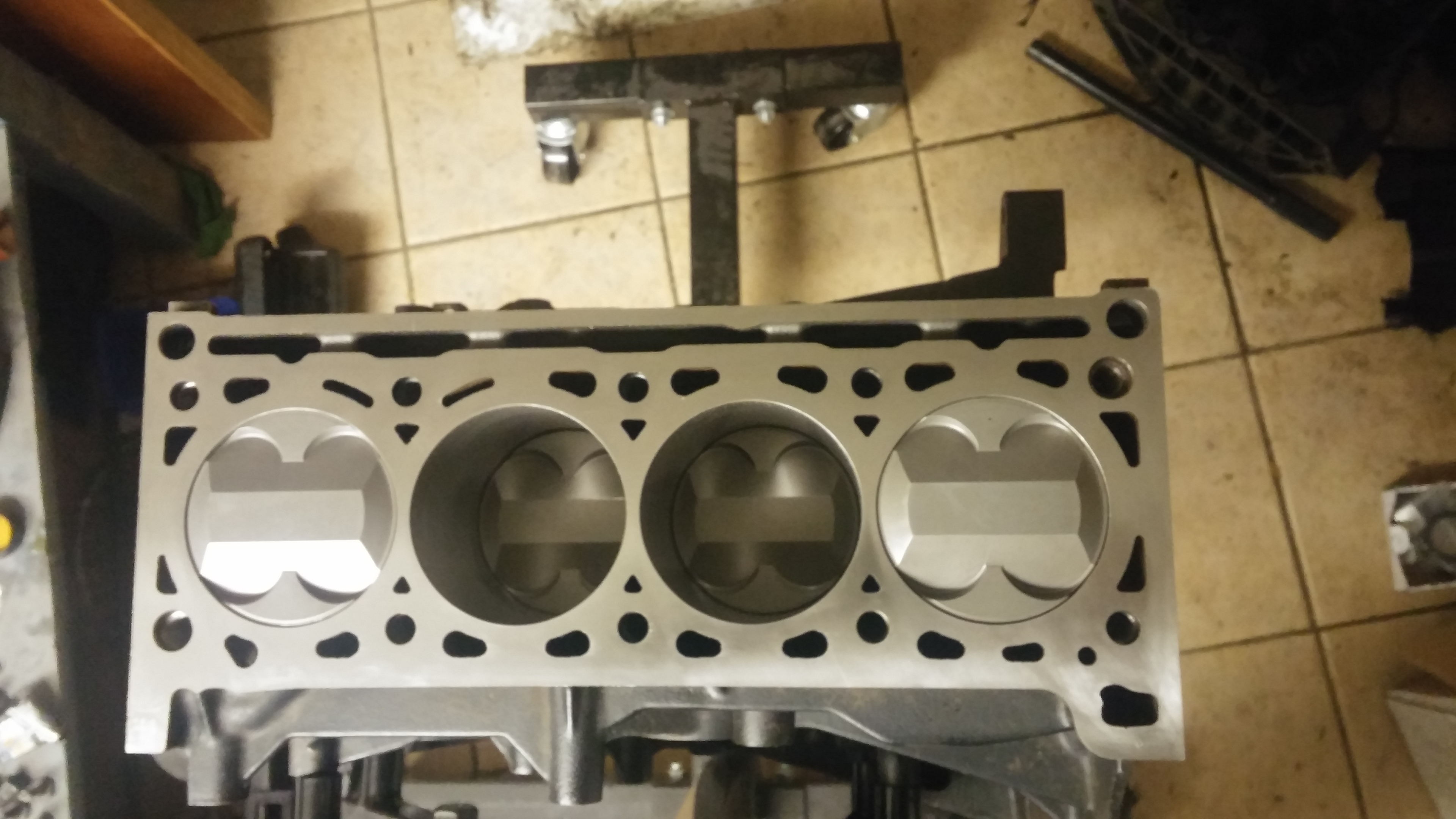

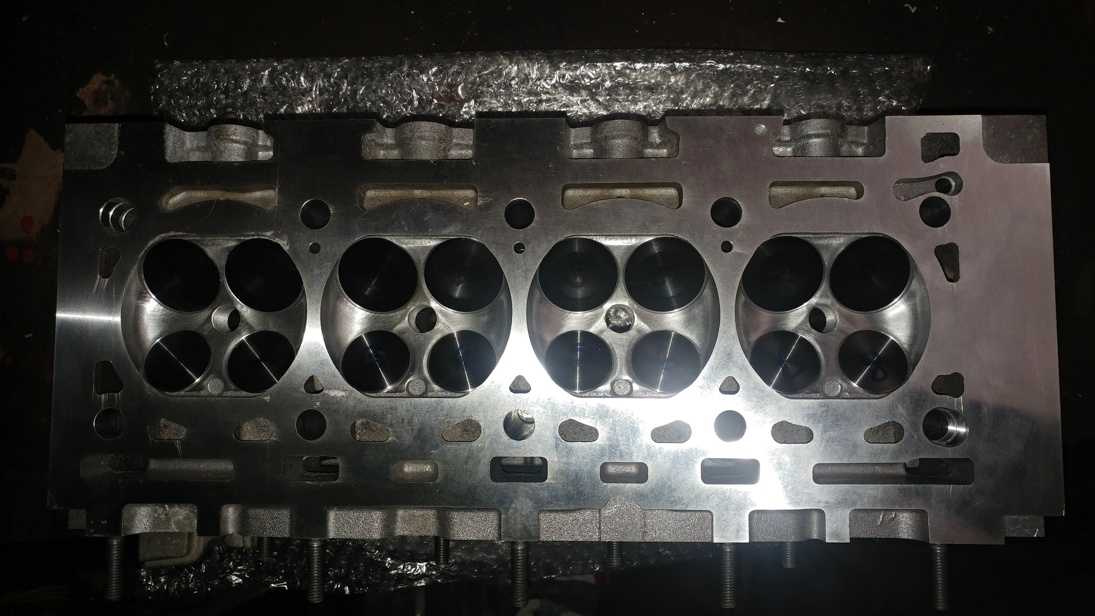

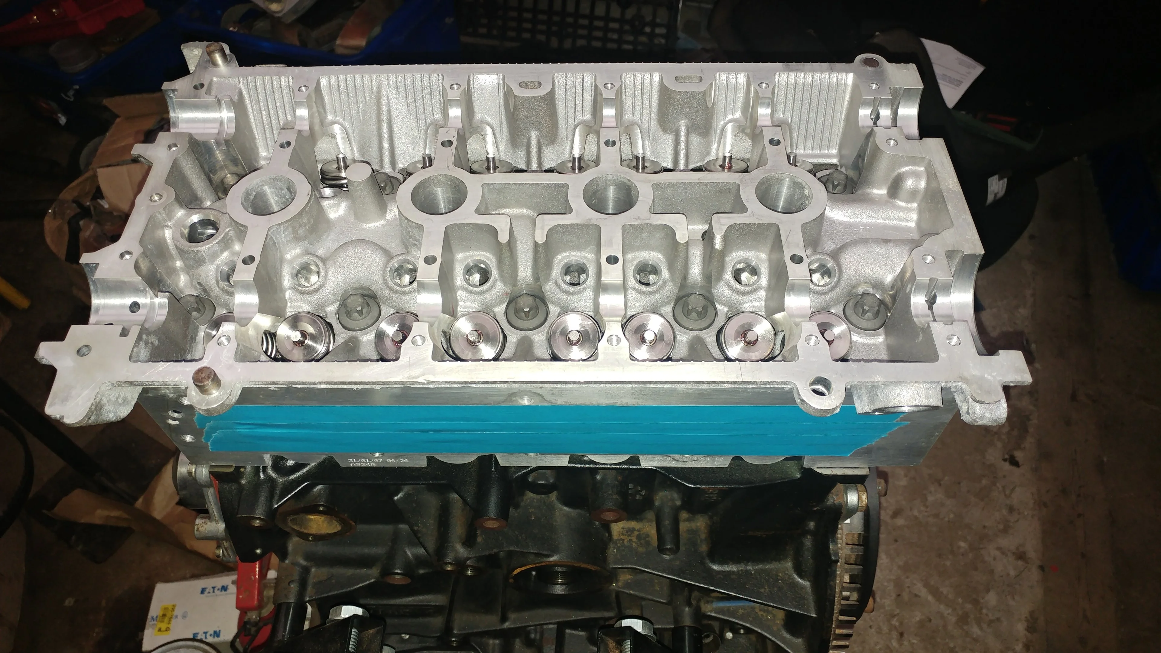

big valve head fitted, next to sort out some cams

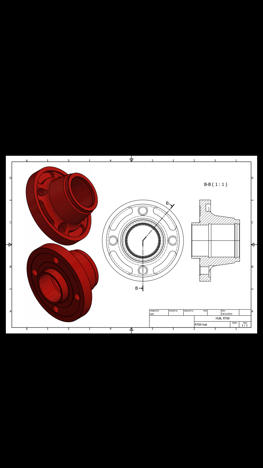

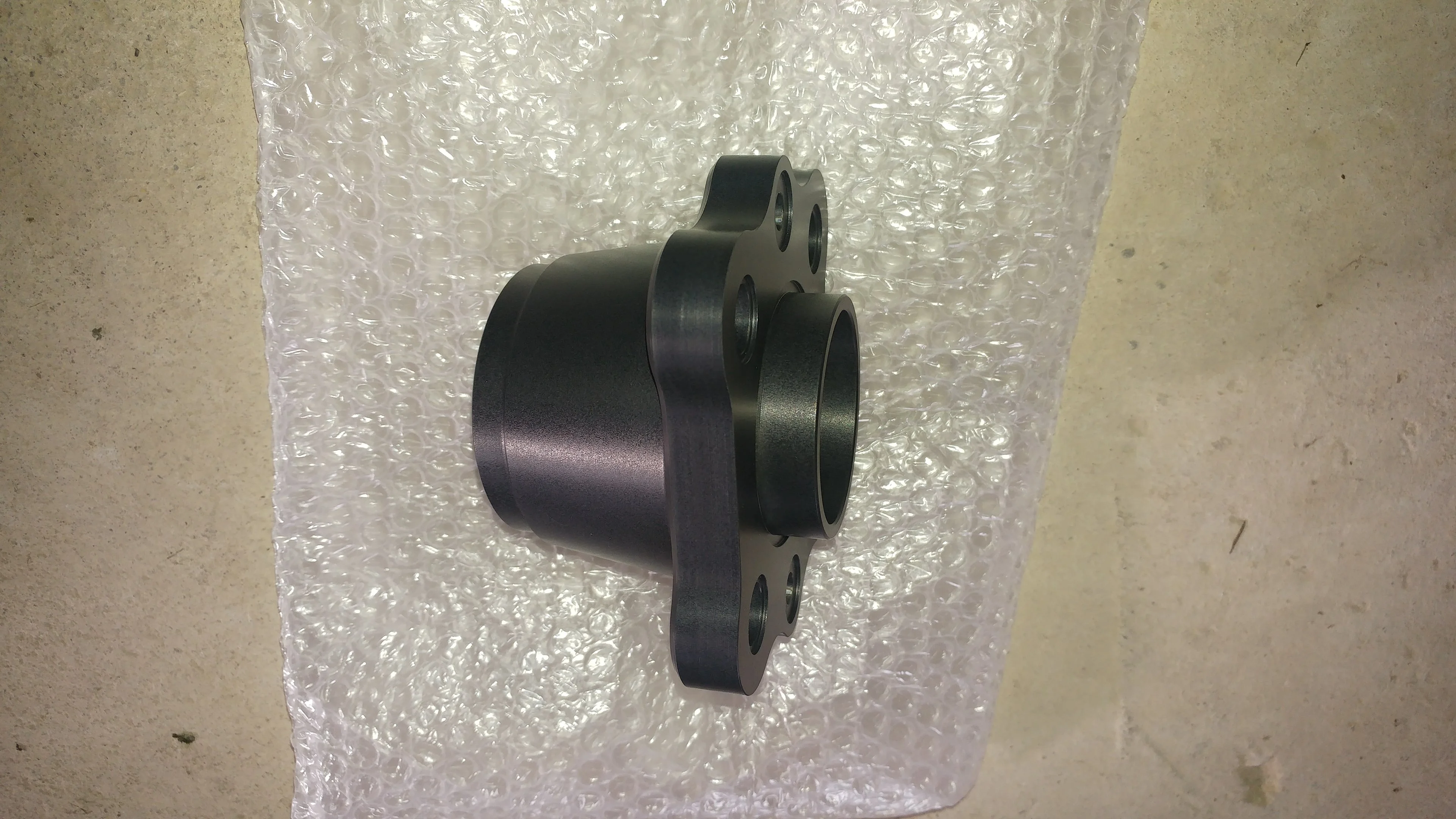

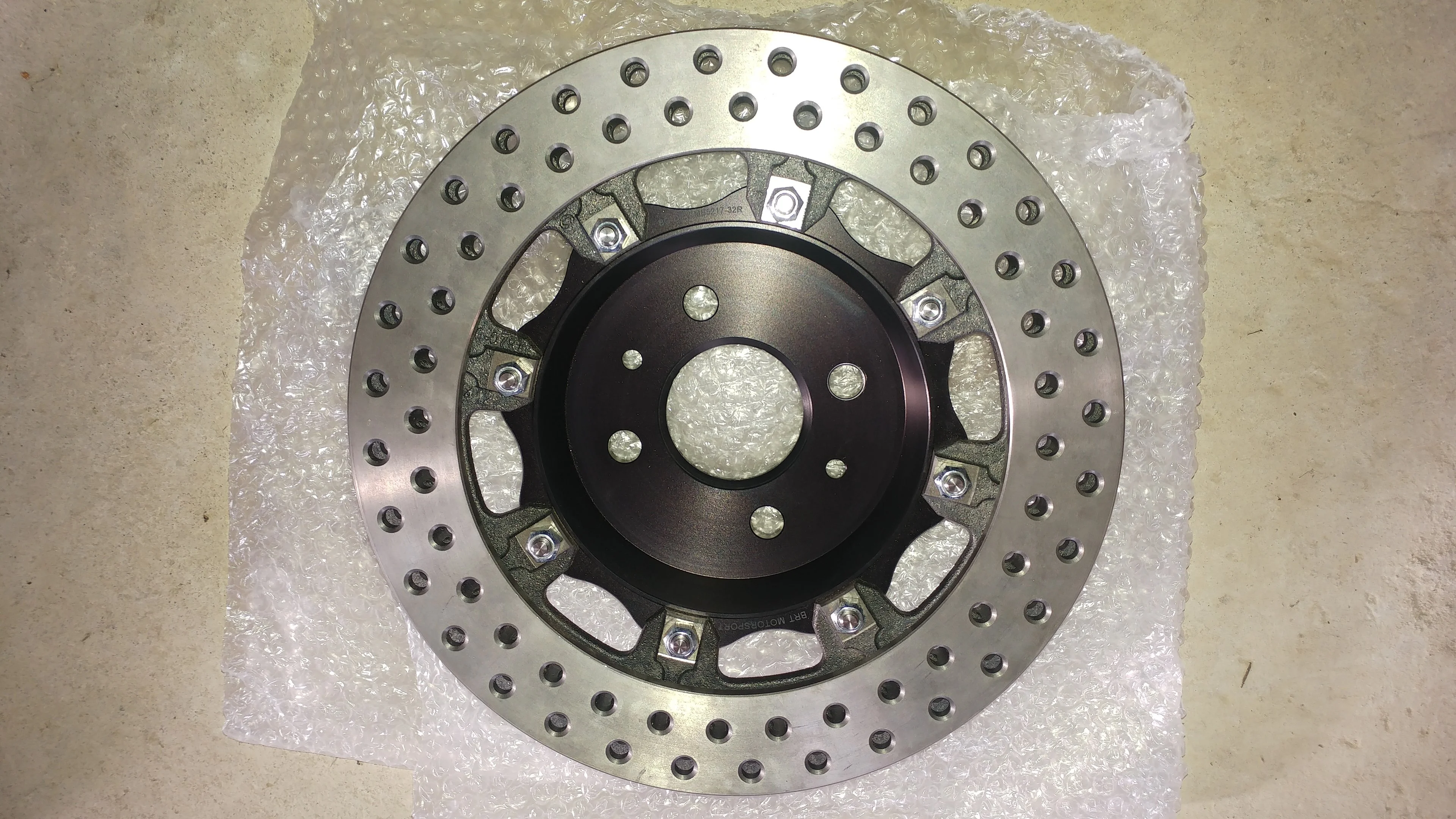

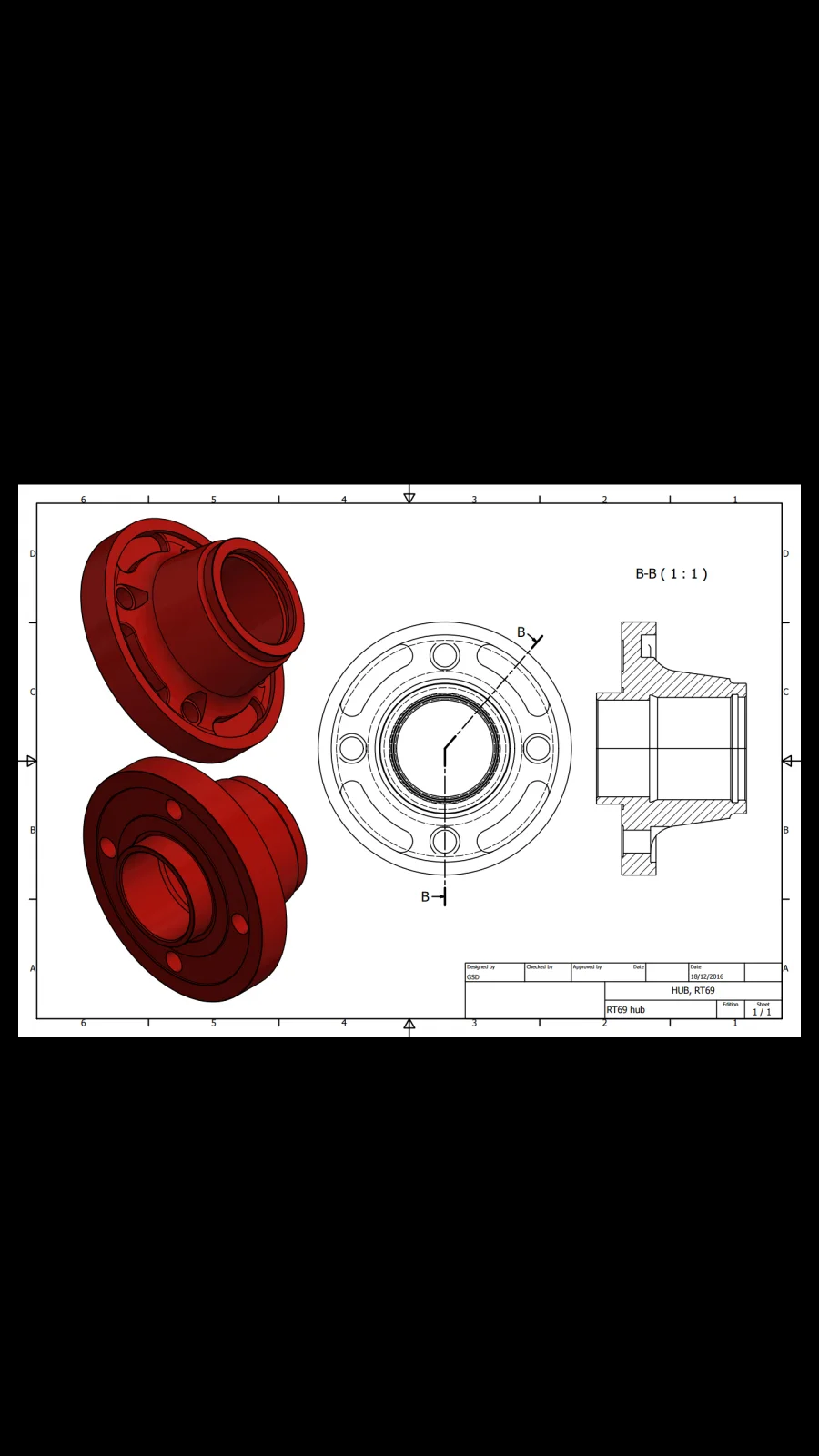

light weight rear hub and brake set up
I take it that is a bespoke setup your running?
Is it for under a 15" wheel..standard rear clio caliper ?
