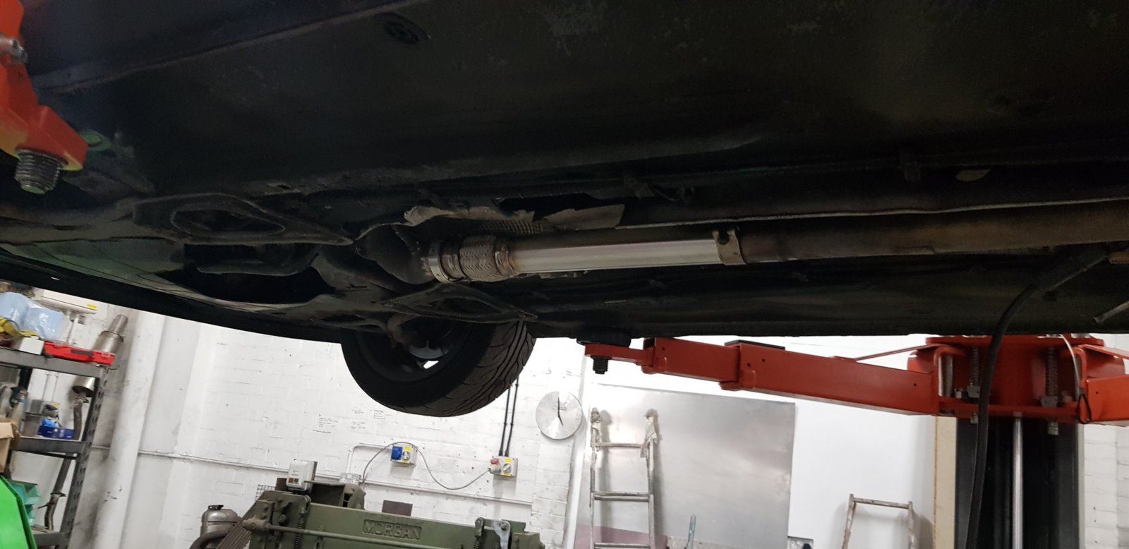

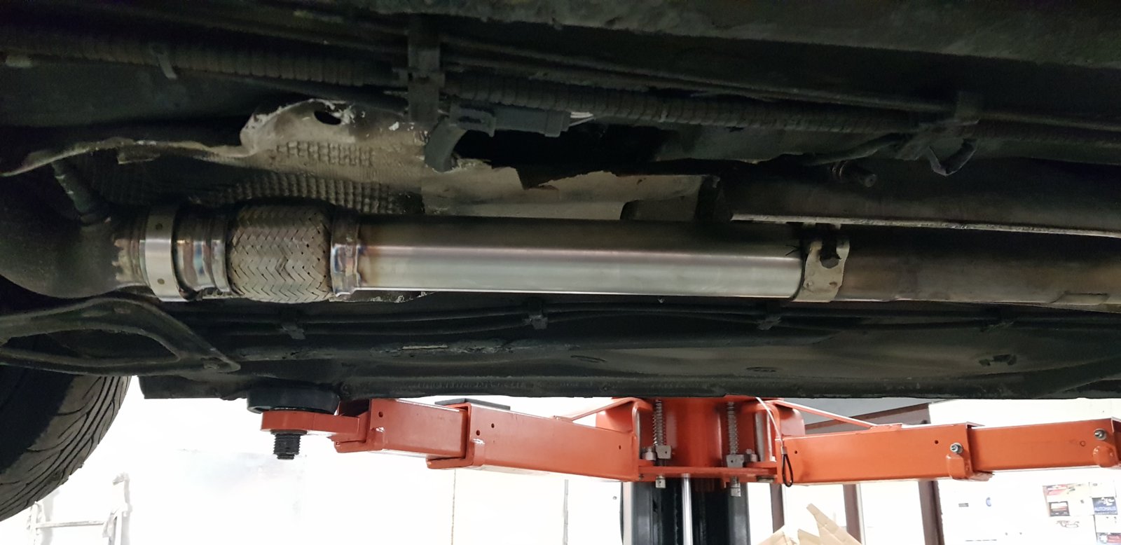

No cat and the system is pretty high. Its catching at the end of the centre section where it flares out to join the backbox (Milltek 2.5" system).
I had something similar in mind! I'll get under it today and have a proper look. I do run a proper flexi rather than the oem spring bolts so that gives me more room for manoeuvre but then the rest is polybushed

It could just be scraping on the clamp which is less of a problem.
I cracked the concrete on the first day as the bolt from the clamp was pointing down lol
