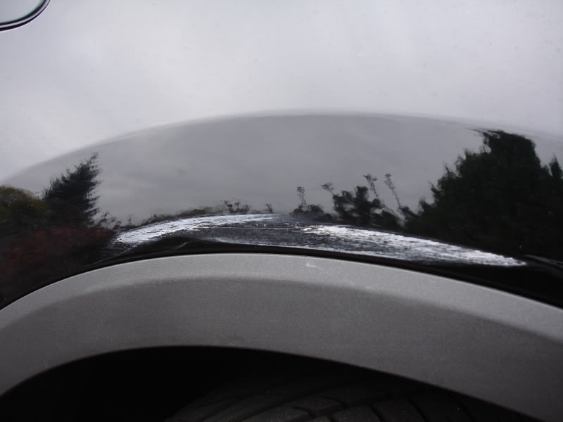

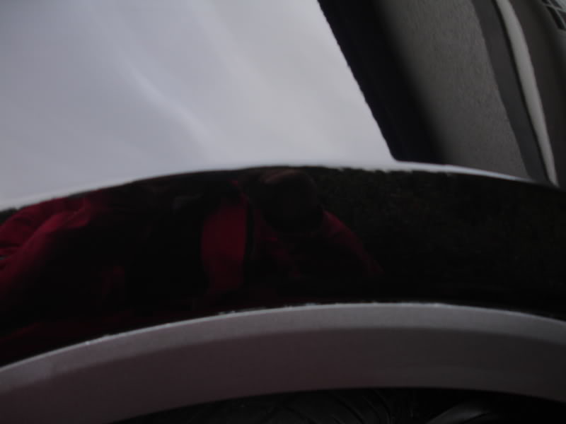

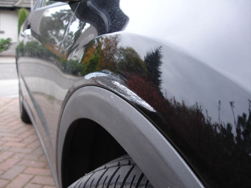

Your not using it right. I got this mark out of my Gran's Civic with it no bother.
Before
After

***** and holy s**t how are using it to get that sort of scratch out lol????????
'scratches' like the one in that picture are easy to get out - that's just paint transfer, from having rubbed against something painted white
if it's a true scratch (ie. has cut into the surface of the paint), the only ways of sorting it are by either adding paint and levelling the surface, or by lowering the surface of the surrounding paint so that it's at the lower level of the bottom of the scratch (if that makes sense)
if the scratch is of any decent depth, you've had it. you can often soften the severity of the appearance of a deep scratch using a machine polisher, but you'll be at it for hours by hand
t'is a satisfying relief, taking something like that out, as they tend to look quite bad.
